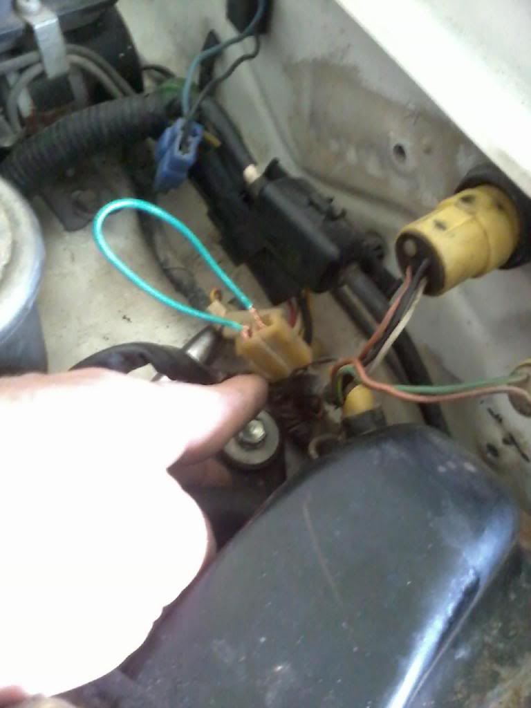

Today I put some fuel in the tank and checked for leaks. No leaks and I let it sit for 5 minutes with the jumper in and the key on and not a drop. That is the good news. The bad news is it is not getting fuel THRU the injectors. It is getting fuel thru the rail and back to the tank. The Cold Start Injector is getting fuel to it as well.
Here is the fuel pump jumper for 85/86.

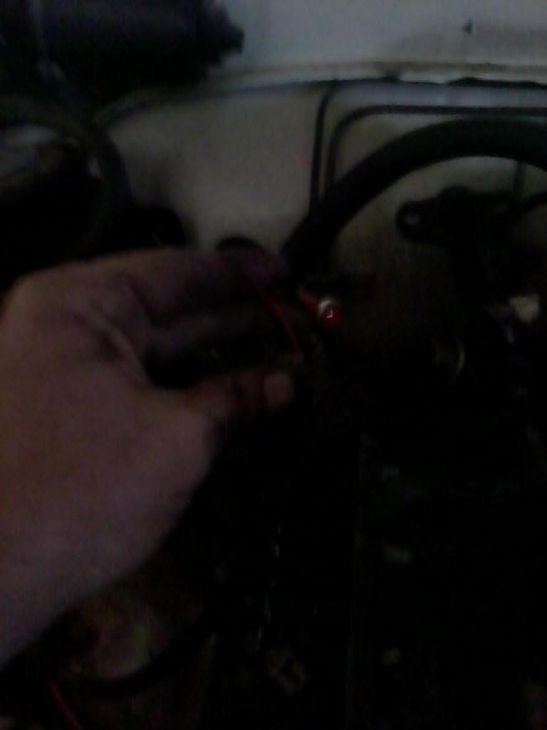

I then got the $3 Noid Light out and after removing the Plenum and disconnecting the fuel pump power plug at the tank, I got the best picture of it as I could. It flashes fast and bright and if you look closely you can it is dimming. Now I suspect the injectors just arent firing or clogged or something else. I have another set of injectors. The other possibility is the crimps in the harness is not letting enough power thru to fire off the injectors themselves. Either should be an easy fix.
You can see the dim filament barely glowing. It is bright and fast. I have the $3 Noid Light in my Tips and Tricks in the link below if needed.

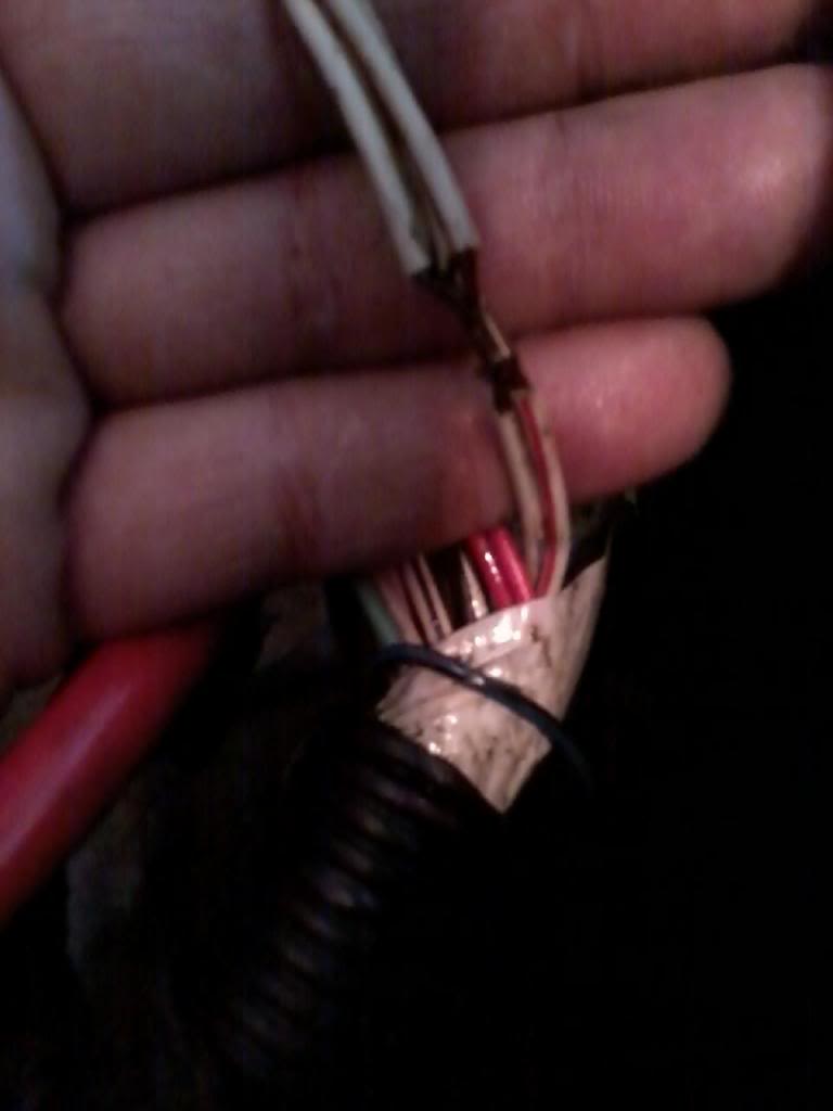

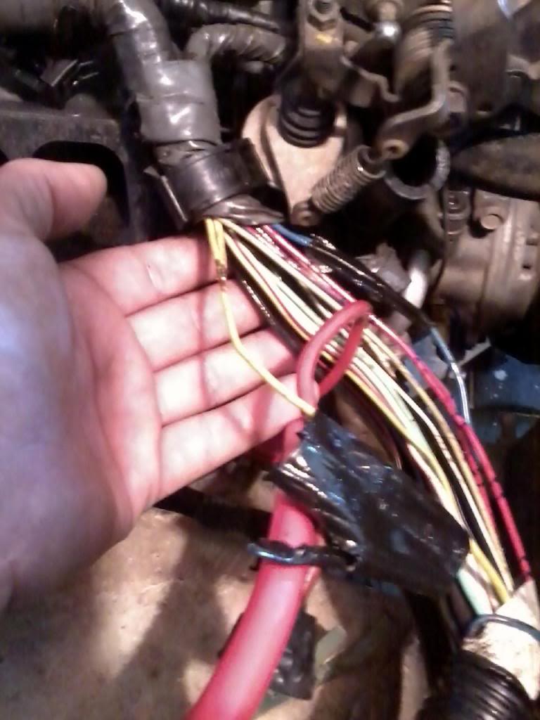

It is alive on it own power now. It gave me a work out. It would run on starting fluid but not on its own. That had me thinking that it was on the injector side. I used my $3 Noid light and I could see the computer was telling me that it was sending a signal but still not fire. I removed the crimps in the harness and still it would not run. So I switched out injectors and it fired right up. My guess is the injectors are just frozen. Talked to Cyberhorn and will see about getting them working later on. Thanks cyberhorn!!!
Here is where I removed the crimp on the yellow wire. The blue wire runs two other injectors.

Here is the two ground wires that all come together. I wasnt sure I could get all 4 soldered together so just cleaned them up and re wrapped them.
