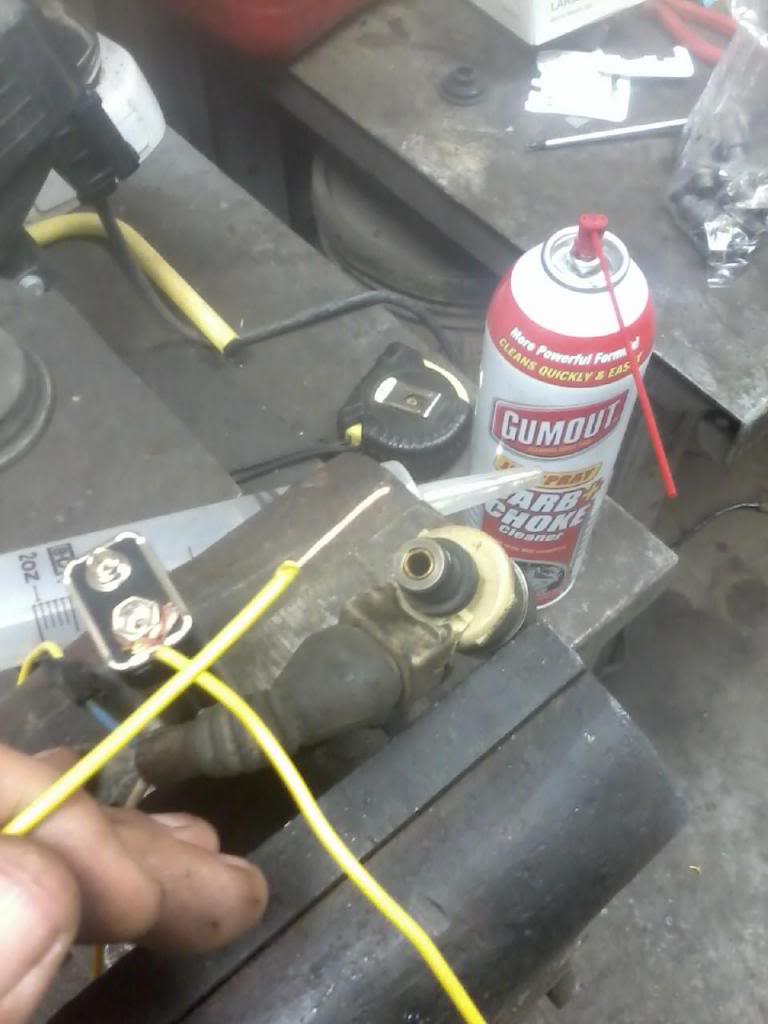

I had a spare set of injectors so got the truck running. Jason in tn and I are eventually going to get together to work on his runner. He is having issues on his and I want to have a set of injectors ready just in case his are bad. These have been sitting for a while. I have 6 injectors and only one will click when I hit it with the battery. I am betting they are gummed up. I have them soaking in carb cleaner and will work with them again after soaking for a while.
I have a bad harness so I just clipped one of the connectors off and spliced some wire to the connector and that frees up a hand to operate a syringe and to do quick touches to a 9 volt battery. Always nice to now how to test and clean your parts. If I was going to replace these injectors, I would go with Flame Throwers. I have a set in my 86 that I got to be a test subject on. I am very happy with them. They are cheaper then sending them off to a injector service as well. But I will get these working. I mention the Flame Throwers. If you have an 89-95, he is offering them for testing purposes again. You wont be disappointed if you have an 89-95.
My new test equipment. Spliced injector connector and battery.

next upgrade to your test rig terry is a momentary switch for clicking
an good news on getting 2 working

Thanks cyberhorn... I got 3 working and the push button will make it easier to work on. I will be getting one soon.
Thanks Gizzler..Always enjoy trying to fix or clean one myself. This is a very easy thing to do and the nasty stuff that came out, I am sure they will perform better then what they did.

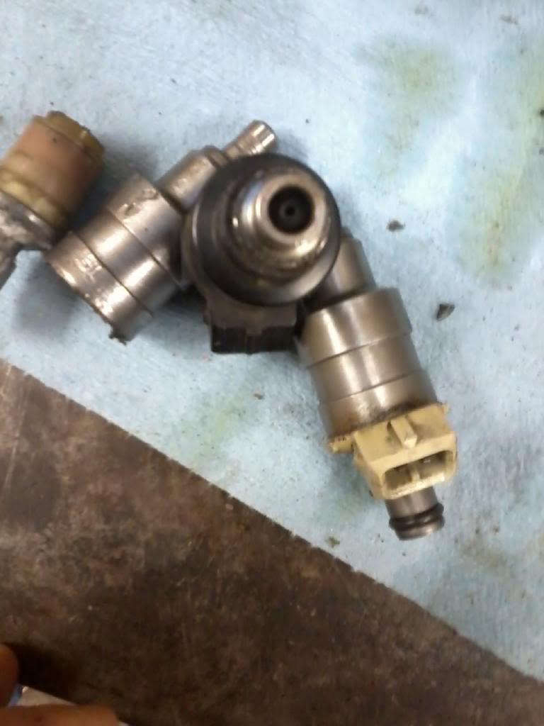

I got 3 injectors working and 3 injectors the coils just will not work so basically aren't any good. I took one apart just to see if there was more that you could do and with out special machinery I don't see it happening. You can remove the screens, and flush them out well and can get them flowing better.
I took one apart and I had to grind off the electrical connection, and from what I can tell when they rebuild them, they must have a machine that reproduces the electrical connection as I just cant see any way of disassembling one with out taking the connection off. The edge of the injector is rolled on to the top to seal it.
I have an injector off of a junk motor and it is for the 85-87 EV1 style connector. My guess is it is from a parts store. I wish I knew the brand as I feel it is a better design then the factory one. It is a direct replacement for a EV1 injector. The one in the picture below is NOT a Flamethrower but is probably a better design then the factory and probably not as good as a Flamethrower.
Factory they come white in color, this one is a black one. The body and all is identical to the factory one with exception of color and how fuel is shot out of the injector. Someone probably just replaced one injector on the motor and left the other 3 factory.
I like to take a bad part and see if there is more that you could do to it and not much else that I can see other then flushing it and replacing the screens. Here is the black one that is most likely a parts store replacement. Also a picture of what an injector looks like when disassembled.

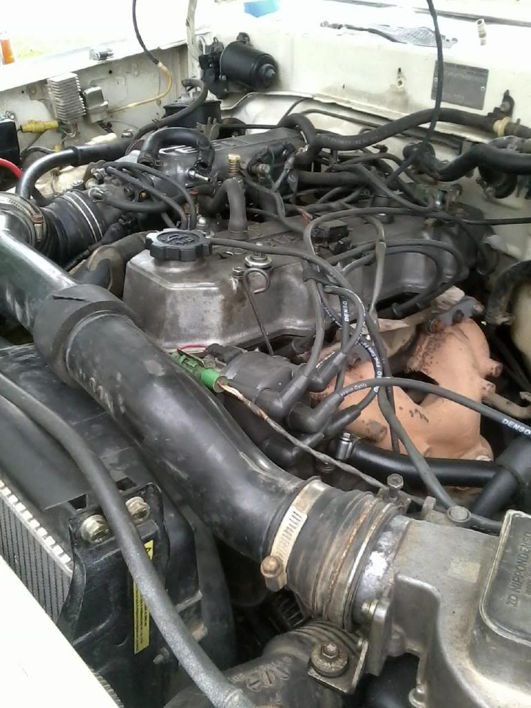

Been doing a lot of work on the 86 extra cab. I can move it in and out of the shop and running on its own. It is all the small details that is getting it finished up. Got the bed bolted down and when to put in the fuel filler hose and had to remove the bed again to get the clamps onto the tank. Doh!!!
Had to repair some wiring that goes to the tail lights, getting the seats installed and getting the rest of the floor cleaned up. What surprised me, is this truck has the rubber floor mat in and still how much stuff got past the floor mat. I have seen stuff get thru carpet but would think a rubber floor mat would stop stuff like that from happening. I always am shocked at what comes out of a carpet when I take it to the carwash for a good cleaning. Yucky stuff comes out.
Planning on this week to get it on the road and make sure all of the bugs are worked out. So far things have been looking great and has given me hope again in getting my 85 running. Don't know why it is be so stubborn. I got a feeling it has been the distributor on it the whole time but will wait and see. The 86 pickup is starting to look like a truck again. I need to update my 22r to 22re thread. I see all the time where someone wants to convert one and don't think they realize what all is involved.

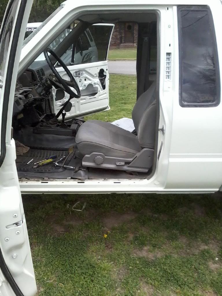

Got quite a bit done today on the 86 extra cab. I will try to start a separate thread on it tonite to show from start to finish. Still have a ways to go but getting there. Justin was going to show me how to get it done today and he helped for a couple of hours. I was teasing him that it still wasnt finished. I guess in a kids mind a few hours should get everything done.
He did find a broken wire while putting in the tail lights and we had to do some wire tracing and trouble shooting to find the broken wire. We found some other damage and had to break out the soldering iron. I showed him how to solder and then using a cigarette lighter to shrink wrap the repair. Before I knew it I had five kids from 7-11 wanting to weld wires. What I call soldering they call welding. Guess I learned to weld today as well as them. haha
Justin did do great on getting some of the other parts on and the parts pile is shrinking so he did help make some progress.

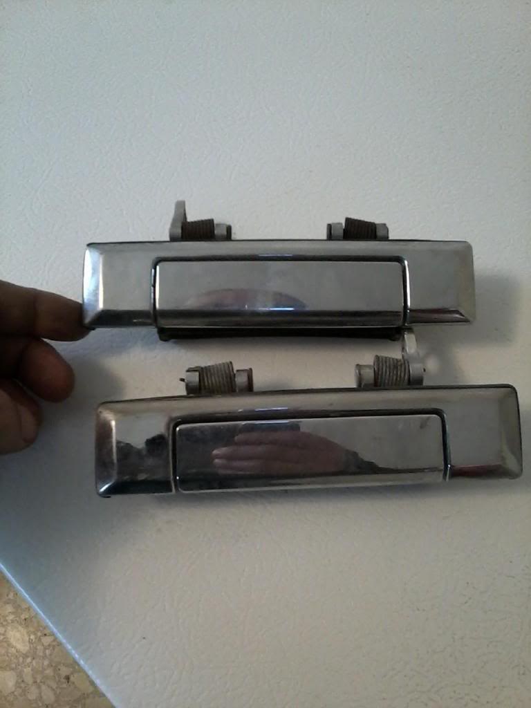

I did get the door handles in. The trim is breaking away from so I used super glue to get it back together. I did notice when putting the handles in the doors, that there is some holes that water can get thru and into the doors. Nothing you can really do about it as it is factory holes or gaps. Just make sure your door drain holes are clear and it wont be a problem. Most likely to get water in the door when at the carwash.
Some how I seem to get more super glue on me then I do the trim. It is the trim on the very outside edges of the door handles. This truck came with black trimming and is getting switched to chrome trimming.

terry them chrome handles are they plastic too or potmetal?

Hello cyberhorn..They are made of pot metal. I did have to oil the springs on the handle that you cant get to without the door panels off or having them out of the doors. Works smoothly now.

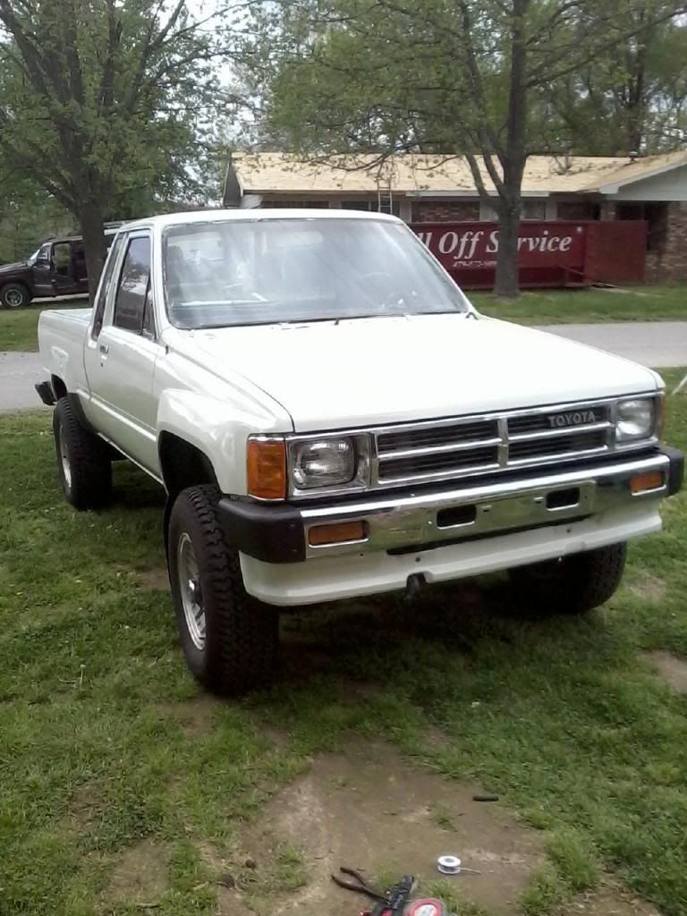

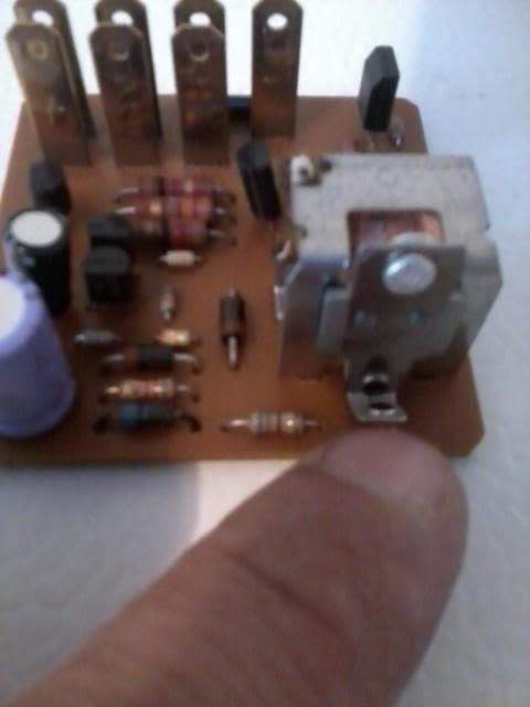

Got quite a bit done today once it warmed up. I was helping junk4u on his buzzer issue and disabled the buzzer on the 86 truck.
Here is the Buzzer Box under the Steering Column.
Just bend the tab out from the bottom a little bit.
Here it is going back together. There are 2 tabs to the cover that I just pryed a pocket knife. Life is good now.

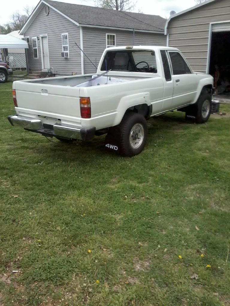

Also got most of the pieces reinstalled on the exterior. Did some other adjustments under the hood and getting things snugged up. I need to replace a water hose under there and will do that when I replace the other 3 injector connectors. There is alot more involved that I did just cant remember what all it was, but it is starting to look like a truck.
One thing I remember is the horn connector was gone. I had a harness and spliced in the connector off of it. Went to hook up the horn and Toyota changed the horn connector or this is the wrong horn. I will get a Toyota horn with this style of connector when I go to the bone yard soon.
Looks like just a paint job and 22r conversion but have gotten several other things taken care of. 100 more details and it should be done.
