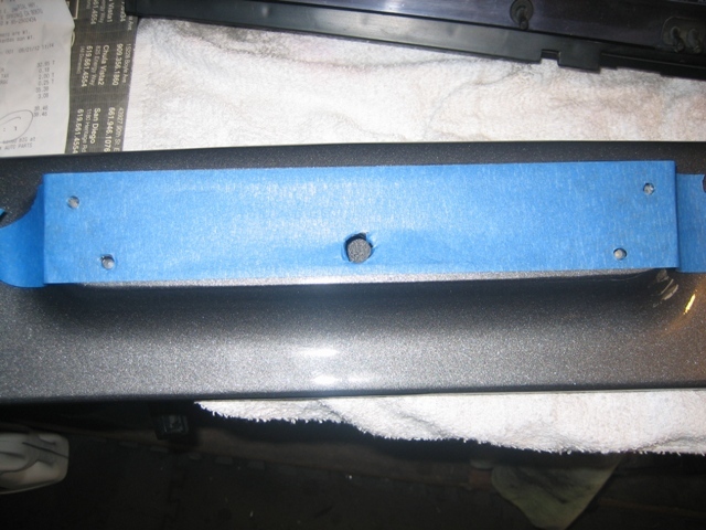

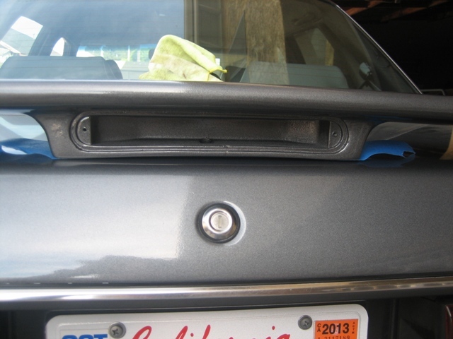

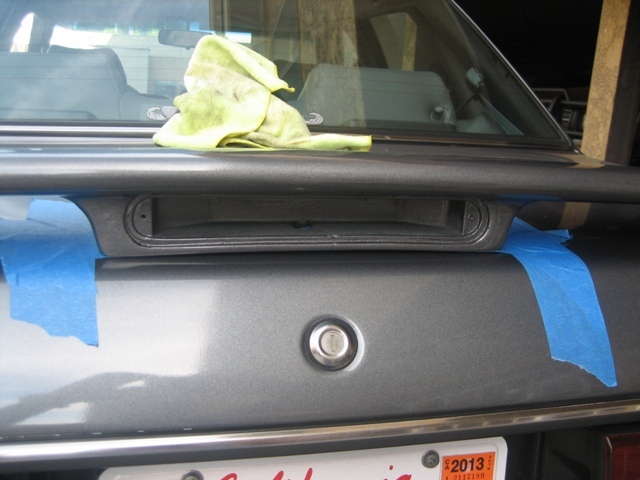

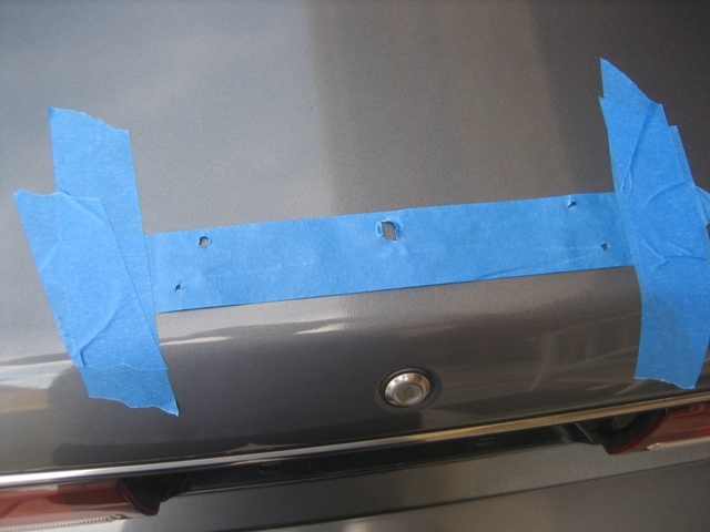

Good job with the map pocket installation. Here's another way to do that type of hole marking for anything else in the future. I did this for a rear spoiler on my camry...more work but less chance of poking yourself
Masking tape over the piece and poke the holes:
Then position it wherever you need to:
Then tape down the excess so it stay in place when you pull off the piece:
Then you can drill the holes:

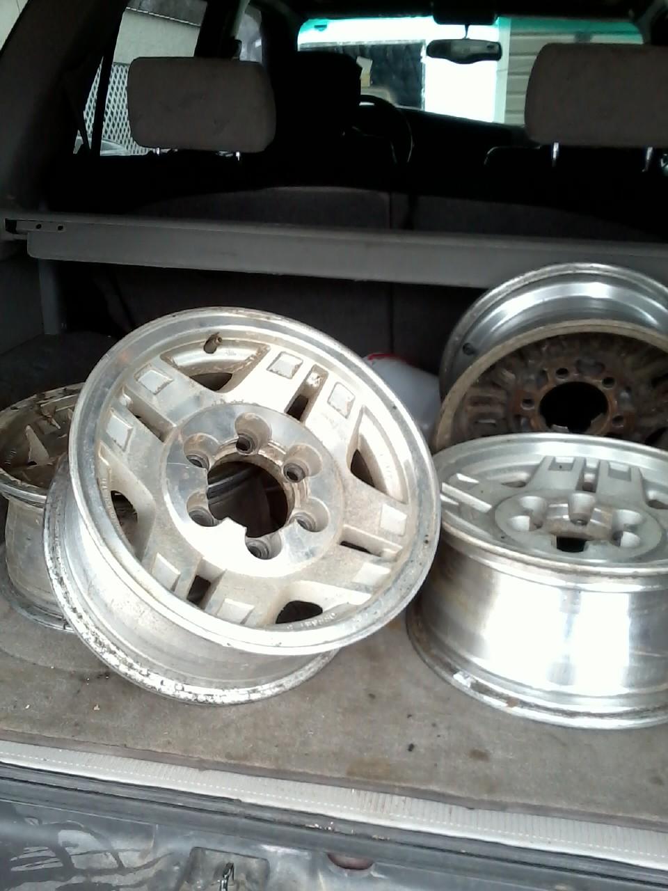

I went to the boneyard and got me a set of SR5 rims for my runner as I have 3 sets of rims but all 3 of them are missing a rim. The ones I have on now are to wide and rub the fenders and knocked off one of my mudflaps when I took the lift off. Stll need to get them mounted.
