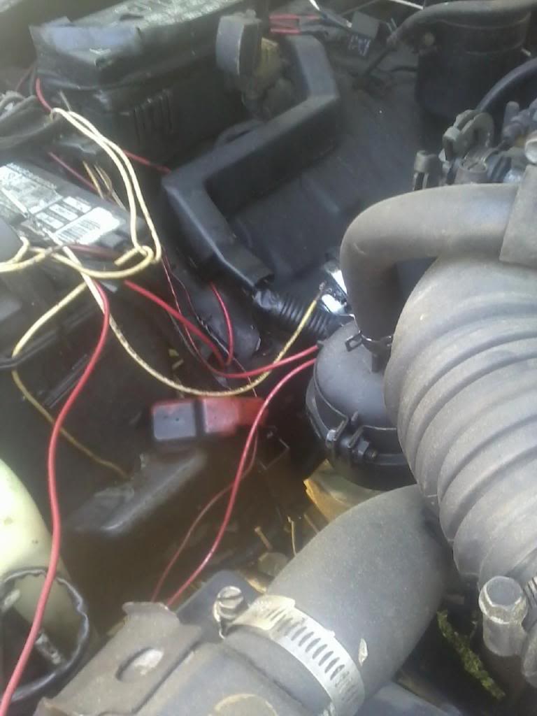

An older guy I go to church with asked if I could change out his clutch slave cylinder and wondered how long it would take. I said normally around 30 minutes but I would not be surprised if it took 2 hours. It took me 3 hours. Whoever worked on it before had wrong bolts holding the slave cylinder on, one was a 10mm and the other is 12mm. They didnt mount the bracket back to the tranny/starter as they should of, but did get creative with zip ties.
I have all of the odd ball parts and basically had to rebuild the line from the firewall down to the slave cylinder. It is a nice truck but some poor workmanship on it. Has a tranny marked with all kinds of salvage yard markings. Nothing wrong with that, but they took the cheap way out and used silicone all over everything and it has a lot of leaks.
The same mechanic that got the silicone on sale, goat a sale on rolled wiring it is everywhere.

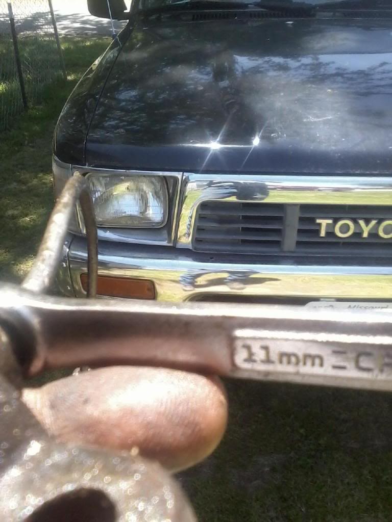

11mm? nut with a completely wrong line.

Another Bubba fix. Drivers side is just as bad, horn, and wiper is fixed just as poorly. Had a special on wire somewhere. Just dont understand the poor fixes. It is fixable but needs alot of work. It is a great little truck and in great condition other then passenger door.

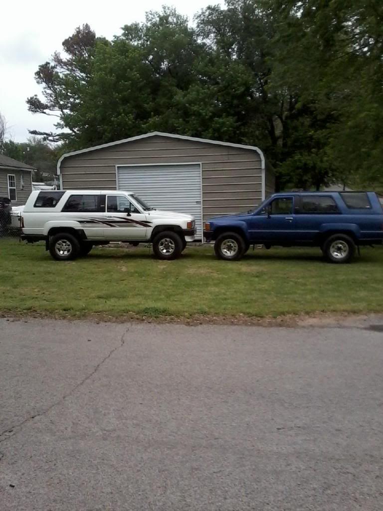

I wanted to get a picture of the runners with their tops on. It is raining and is supposed to stop here shortly. Once it passes the tops will be coming off, if not today, it should be tomorrow. Looking forward to that.

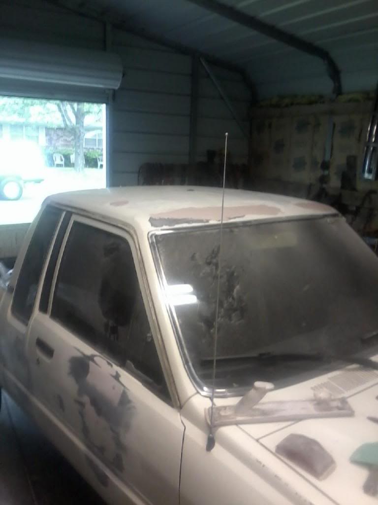

I was in the shop at 5:30 am and came out at 6 in the evening. Doesnt look like much for 12 hours but got alot done as I actually worked on 3 different trucks.
The top and hood will flex easily so that slow down some thing, I have 4 small places to touch up on the roof and it should be done.

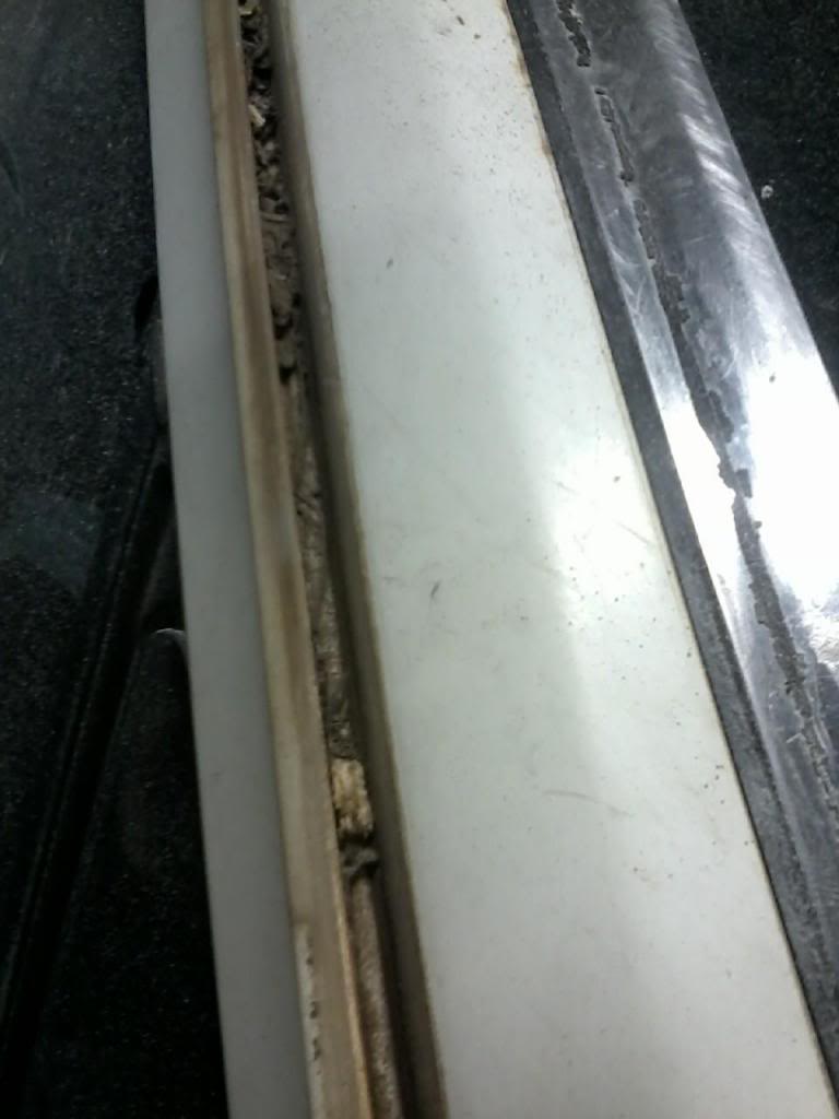

I removed the trim off of one side and found alot of dirt behind the trim. I tried to take an air hose and blow the dirt out of the other side befroe removing the trim and see what I could get out. I then removed the trim and found the same amount. I would suggest using a high pressure hose at the carwash and get behind the trim to keep the dirt out.

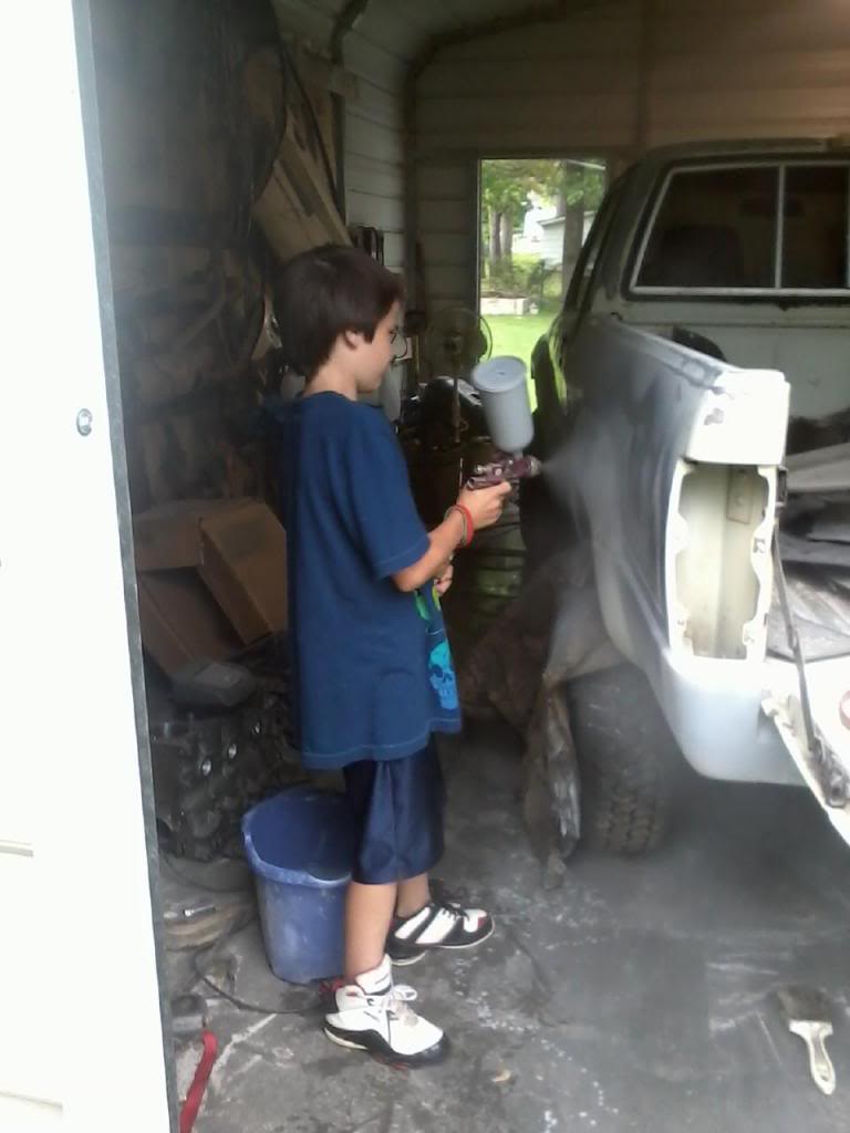

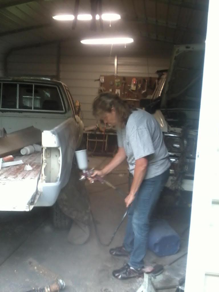

Truck doesnt look much different, but now it is alot smoother. I need to finish the roof cab, tailgate area, and the drivers door. Misty has been wanting to run the primer gun for sometime. I wasnt sure how long she would last out there and what she would remember from the past, but did suprise me at what she was able to do.
Here she is running the primer gun. After she got done priming, I showed her where she had missed by not squatting down and keeping the gun at the proper angle and when she got to far out that she had primer drying in the air before it got on the truck. She went back and removed the bad primer and did a great job the second time around.

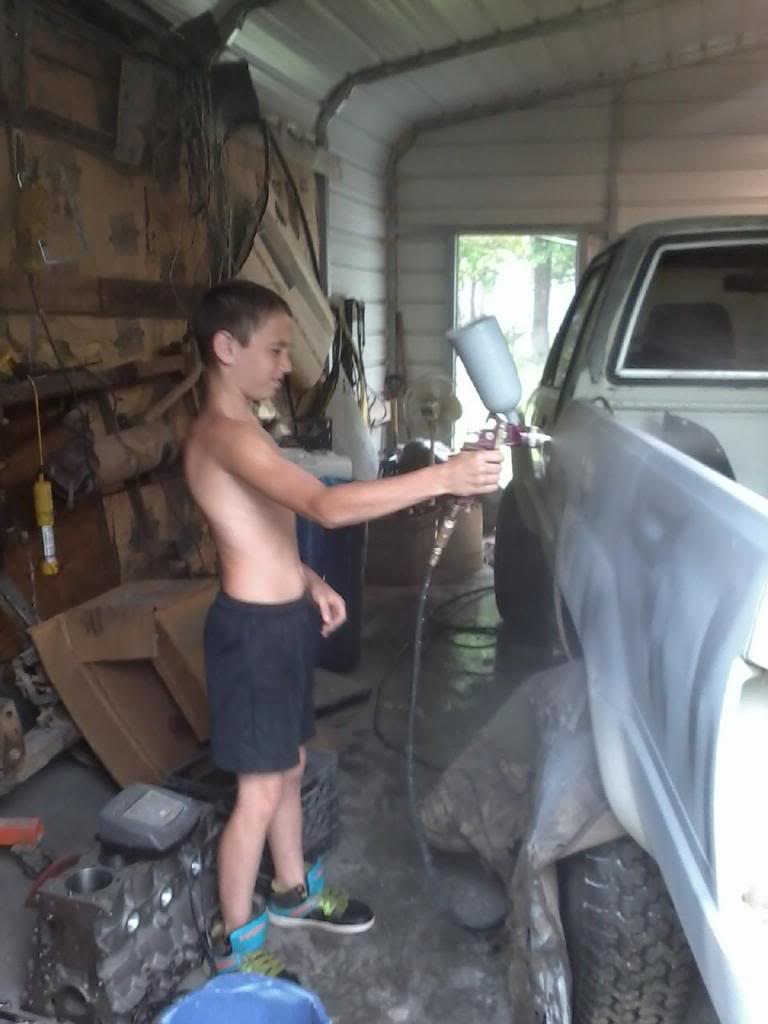

Hunter seen mom priming and wanted to get involved. He stuck around for some sanding. I had some good ventilation going in the shop and for small priming, primer doesnt get in the air as bad. When it comes to painting, it doesnt take much at all for paint fumes to get up in the air and you need to wear a mask for painting. Priming not so much, Painting, wear a mask. Paint will ruin your day if you dont.

Justin wanted to do some priming. Mr. Unambitous didnt stick around for any sanding. Had to spend some time cleaning the shop up. I spend 5 minutes in there and need a day to straighten it back out.
