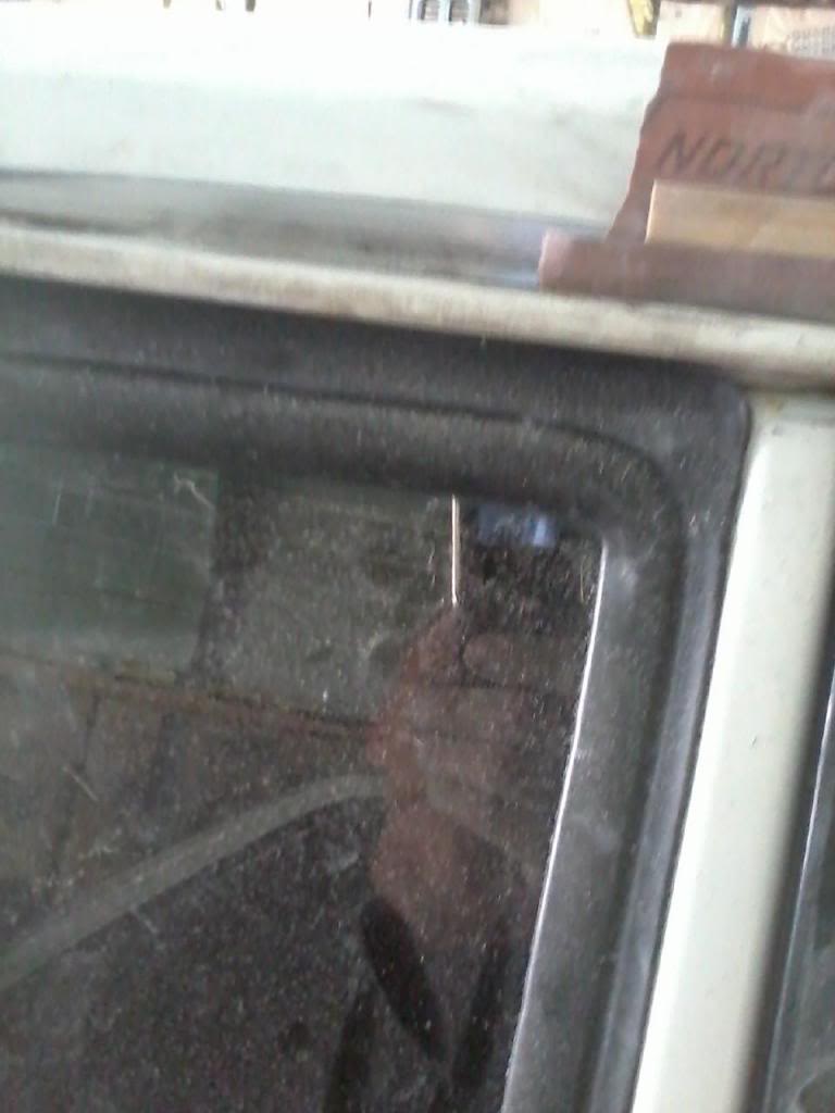

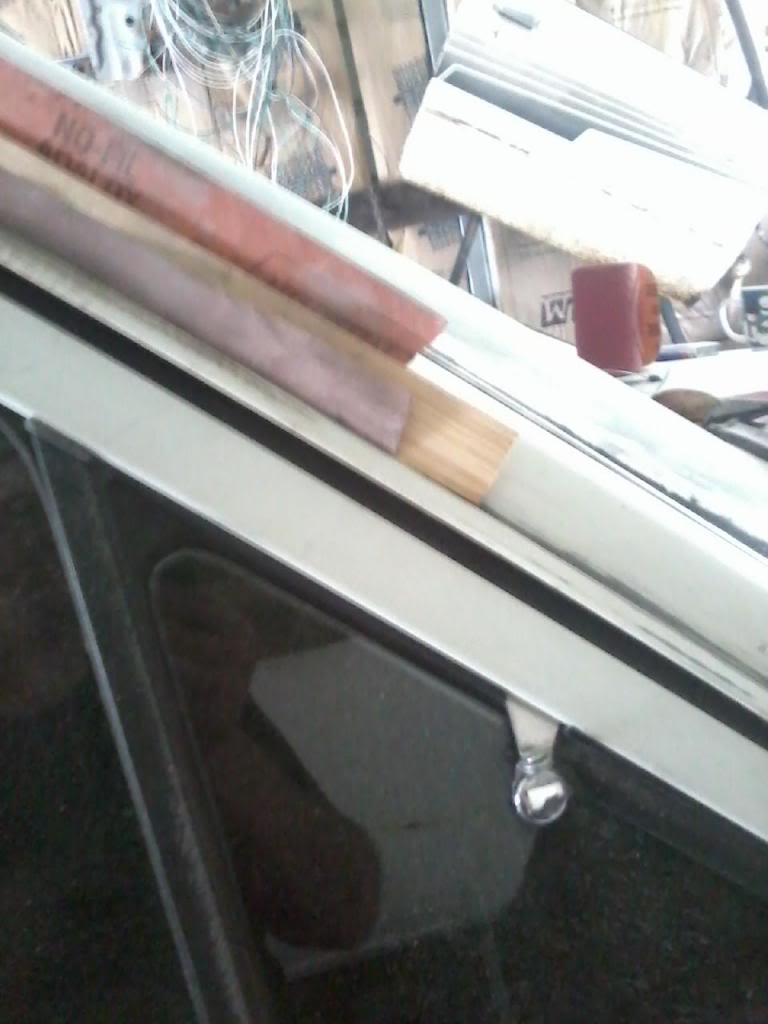

Some tools you just have to come up with on your own. Paint mixing sticks is very common and works great. I got the window channels cleaned out and got all of the rust off. If you look in some previous pictures you will see what I am talking about.
Passenger side of the windshield and door post. Using a paint stick with sand paper wrapped around it.
Above the passenger extra cab window. Got the surface rust off.

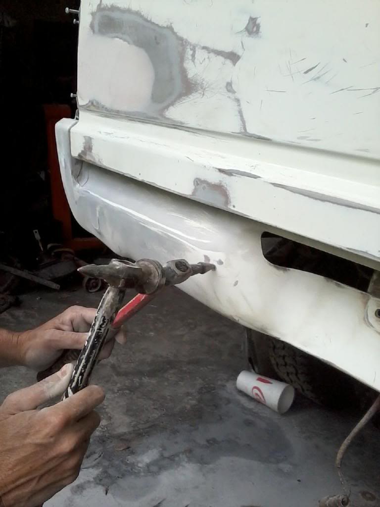

Misty knocking out some rock dings that came from the back side. She was surprised at how little force it took to get the dings back down. She seems to be liking this and is suprising me at how well she is catching on. She is wanting to make the 85 Extra Cab the way she wants it, so I know that is alot of the reason she is getting involved so much. I showed her Grego92 Door Panel repair build https://www.yotatech.com/forums/f116...panels-256546/ and she seems excited to try something like that for the 85 and for her runner. I dont have very many clamps and a Dremel plus a few other tools that might be needed to do that repair so next time we are out and I have the list of tools she will need, that is going to help her with the understanding of even though it seems like I have a thousand tools, I always need more. It will be her buying them and not me. hehehe, She doesnt mind me buying tools but I am sure she wonders why, now she will know.
She got a hammer so I have to watch what I say. Those points hurt.lol She had 3 small high spots and did great at getting them smooth.

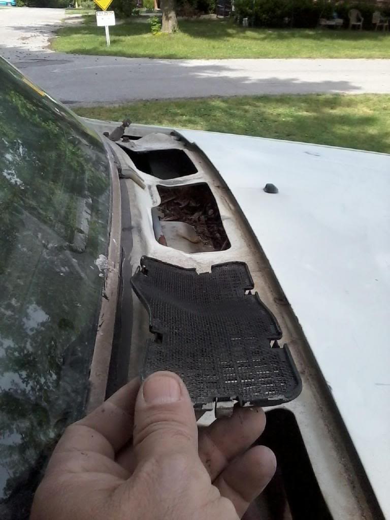

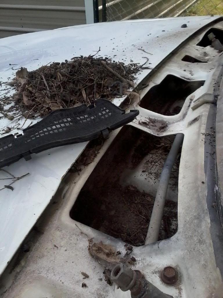

I try to mention in my threads about how dirty it gets under the cowl. This truck and other trucks I have seen dont always come with the black screen in my hand. Then on top of the black screen there is another screen that is the same you find on home windows. My 85 doesnt have these as well. Any time I am at a bone yard and can get a set of these I grab them. They help keep alot of debri from under the cowl.
I tried to get a picture of it, but there is a stovepipe that is on the passenger side and it goes directoy to the blower motor. Sometimes debri can get over the stovepipe and gets into your ventilation system or cloggs up the AC condeser.
This may be half of what I got out. I used the shop vacu and then an air hose to get the rest out. There is drain holes on the far edges of the truck for water to get out, but the drains can clog. Another shot of the cowl screen I was talking about. I also took the truck to the windshield shop and had to them to remove the trim. Even after watching them, I dont think I could get it off.
If you are going to have a truck painted, removing alot of these things will give a better and cleaner paint job, as well as preventing rust.

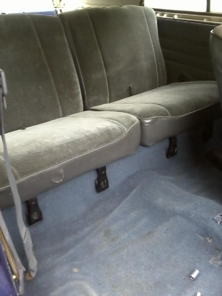

I got my back seats in. I am going to go to a darker gray on my panels. Will need to repair the rip in the front of the passenger side seat. A whole let better then what I had. Will be ordering me some gray carpet soon. The whole interior will have to come out again to darken the panels and replace the carpet.
