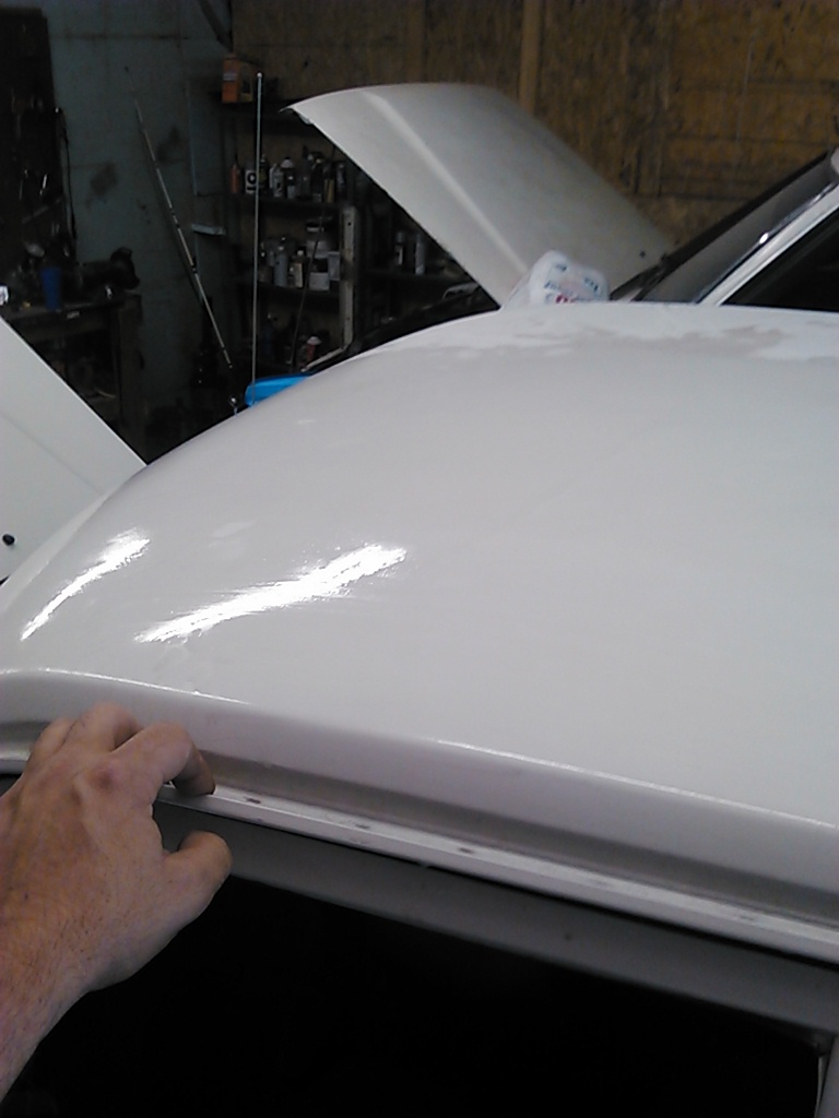

Got the 4Runner seats bolted in. Got the rest of the interior put together. Getting started on polishing out the roof.

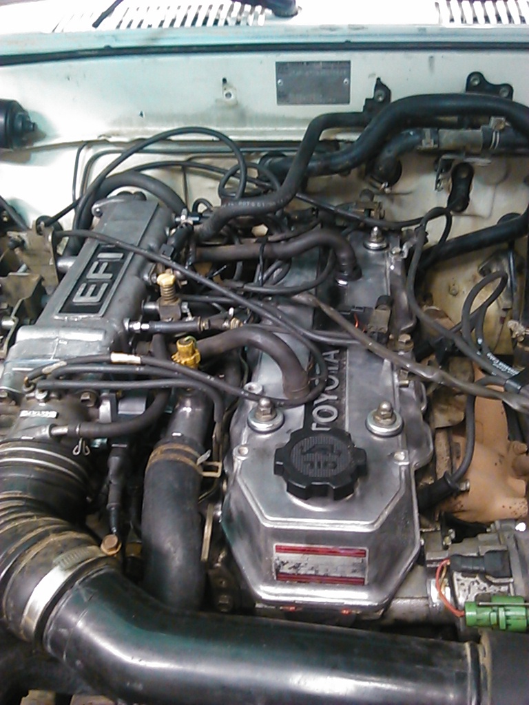

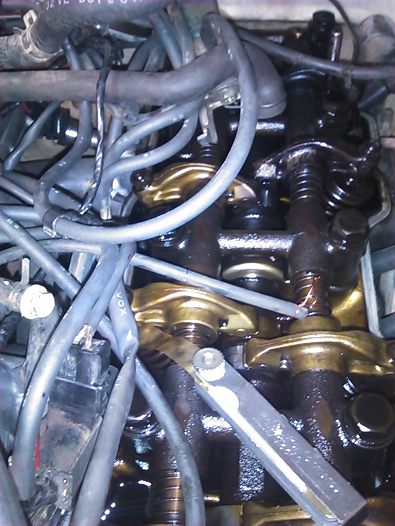

I forgot how fun it is to set the Intake valves. Always a little difficult to get your feeler guage in there. Usually just an 1/8th to a 1/4th turn gets them back in to their proper setting. Not sure what is going on with number 4 cylinder. I have seen some dirty motors from lack of oil changes but this one looks clean. The black stuff scrapes off easily.
Got the painted cover on. I never can get spark plug wires to look a little better then a bowl of spaghetti.

Finally got the roof wet sanded. It is getting toasty outside so will finish polishing tonite or tomorrow. Still need to replace the front transfer case seal.

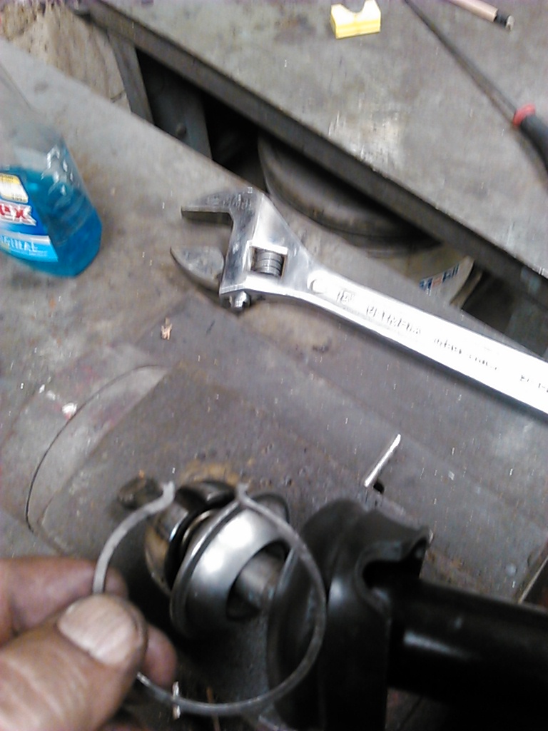

I have been wanting to move my switches to underneath the ashtray for some time now and have been slowly working on that. I removed my shifter sticks to start running wire under the carpet. I got the transmission stick in with no problem but the transfer case stick was being a pain. I worked on it for 30 minutes while trying to get it back in. I took it out to take a picture of it and it went in within 15 seconds. Not sure what I was doing different but it is back in. A friend of mine are eventually going to try to make a 3 pronged screwdriver to push the cup down where you can get this clip in a little easier. Just something we haven't gotten around to yet.
This clip can be a bear to get in sometimes.

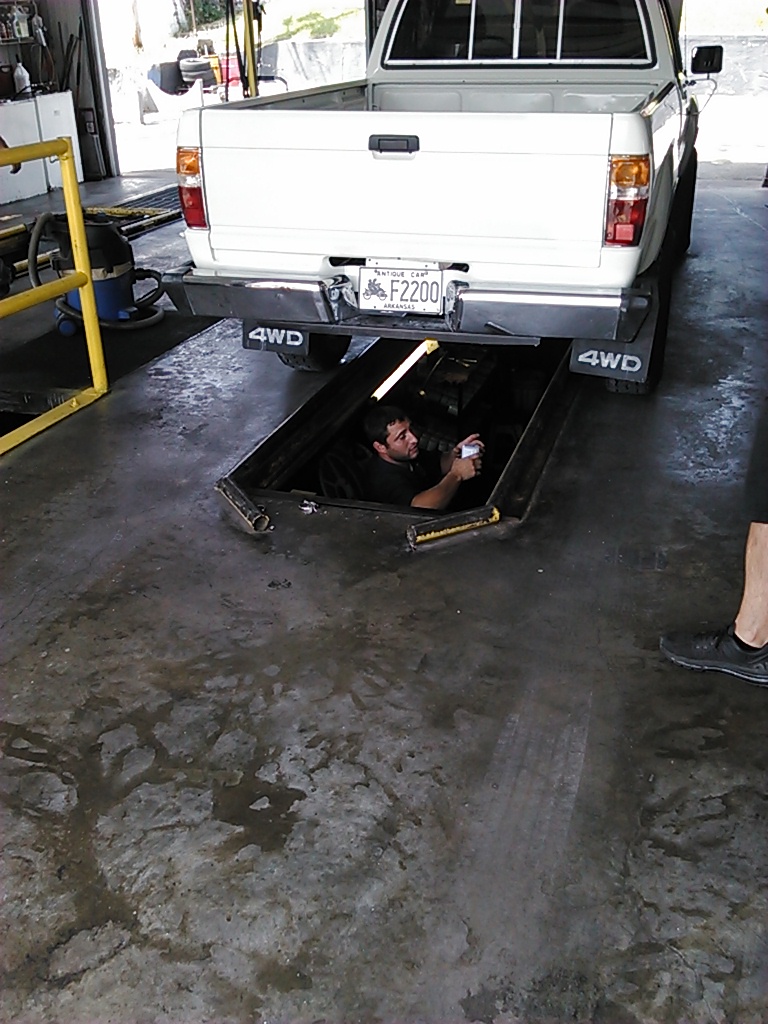

I thought I was going to need to change the front seal on the tcase and got to looking under there and it seemed fine. I did need to tighten some bolts on the tcase as they were loose. I ran it to the carwash and used the high pressure spray to clean off the oil build up. That is some great rust preventive treatment. I need to patent that, lol. I gave it a good cleaning and then took it to lube service to top off the fluids.
One was over filled and the rest was normal level. It was nearly 100 degrees and I figured that would make any oil leaks expand and took it for a long drive. So far I haven't found any leaks.
Wish I had a pit or a lift. Makes doing things like this so much easier. What took them 5 minutes would took me 30 minutes. A friend of mine has a lift and what a difference it makes.

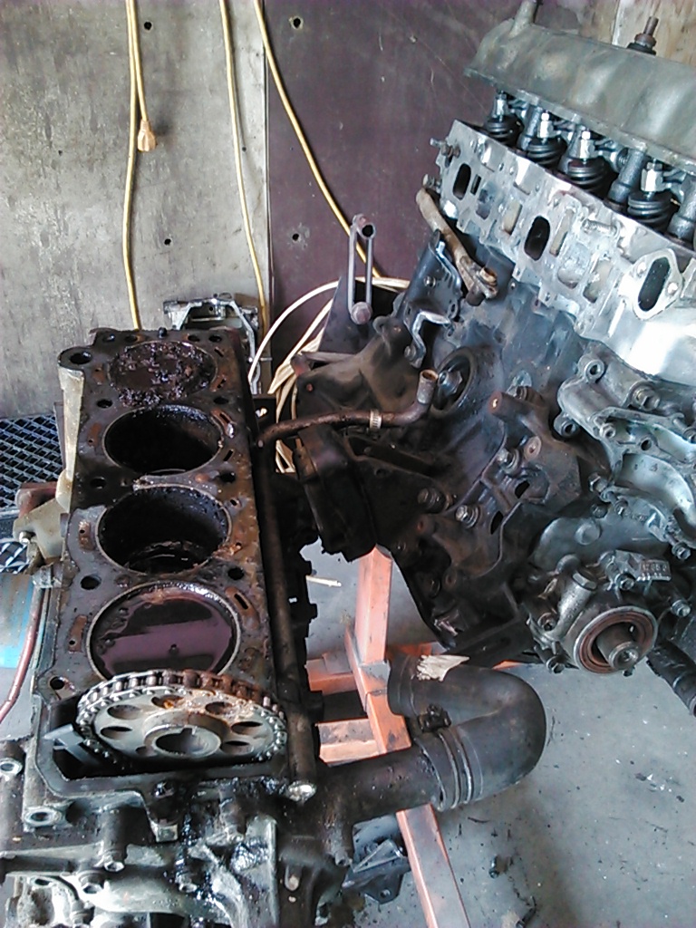

I should be getting another engine soon. Both of these motors are junk, but I like to keep one around to have as a reference and I keep the nuts and bolts in them so when I need one I don't have to guess around. Then later I will replace it for the next time. I am combining these two motors into one. I need to free up an engine stand for later. I tried to soak the motor on the left and tried to free the cylinders up. Even with the head off, it wont budge. Lots of yucky stuff inside. Not sure what happed to this motor.
I think the head might be usable and a few other parts but that is about it. Curious to see what the bottom end looks like. The heat ran me out too soon to find out. We got toasty today.
i have 3 spare t/c levers that still have that clip on them.
I use a pair of needle nose on them to drop into the retainer

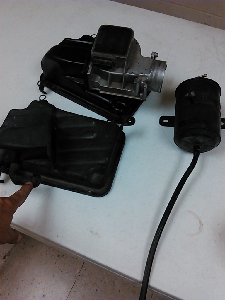

I got a new AFM for my 85. I just move parts from one truck to another. My 86 Runner I used a newer AFM air box and it had the port for the PAIR system. I just plugged it up with a bolt until I come across the correct air box. Now all my trucks have the correct air box on them. Just didn't like the redneck engineering I had to do with the newer style but I used what I had at the time.
I have worked on several trucks and I think only one has ever had the entire fuel system working right. I mention it on each of my builds and is usually one of the first things I start working on when doing a project. I went thru the entire fuel system on my runner and it had clogged lines and everything as usual for a project.
I put 350 miles a week just for work and that isn't counting all of the other running around on every day life, so it isn't like my fuel has time to get old. I really think it is the poor quality gas that we get now a days. I was driving the other day and got a whiff of raw fuel and started looking for fuel leaks and didn't find any. I don't want a BBQ on wheels. So started looking up what else could cause fuel odors and was pointed to the fuel canister. I had went thru it to when I started on this build. This time the rubber line was clogged and some clog in the canister. Got it all free flowing again.
I have seen trucks that were well cared for have clogging issues. I think some of it is the humidity in my area but still most is from the poor fuel we get. Usually when some one has a fuel tank issue on the home page and they get to looking into it, they have a bad situation on their hands.
It could be just the canister is 28 years old but think it is more from the poor fuel.
