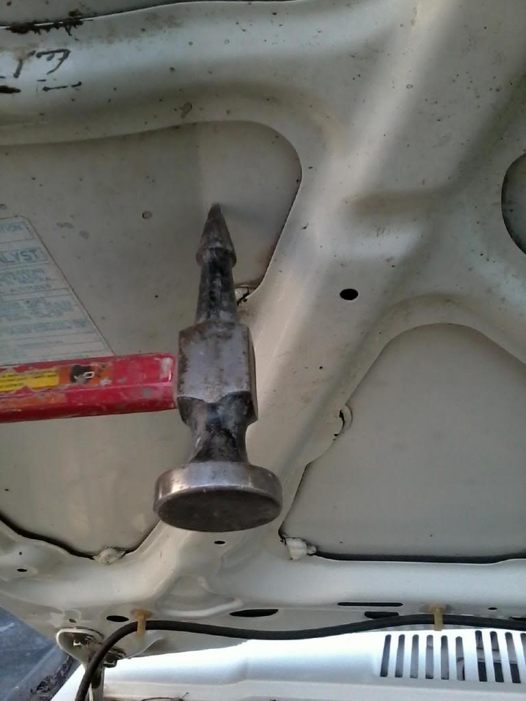

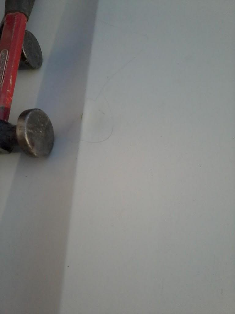

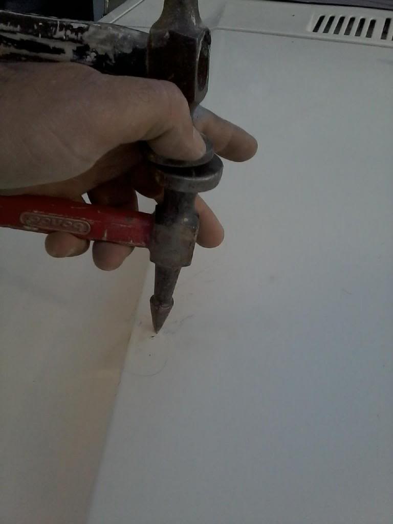

Doesnt really show in the picture, but this is the infamous hood dent that you will find on alot of these trucks. Not sure what causes them, but this one is deep.
Here I was able to tap it out from the back side.
Since this was on a curve a crease, I had to hit it had enough that it left some dimples on the oppisite side. Curves and creases strengthen up metal alot. What I am trying to show here is with the sharp tip on the dimple and using my flat tip pecking hammer, I was able to tap the dimple back down. I will still had some filler to smooth it out , but got the dent nearly level and think this is the worse and maybe only part of the hood. Havent really looked at it closely just yet.
Doing the hood and cab top is the toughest as the metal will flex alot and you cant use as much pressure on it as you can on the rest of the body. I plan on showing at a later time of wet sanding and there you can use alot of pressure to level out the body filler and primer. Wet sanding is what really makes the big difference on the leveling. At this stage of sanding, the primer is itself a leveling material. You are working with less then the thickness of a piece of paper and that thickness or less wll stand out bad.
Controled use of tapping dents, not the best picture with only two hands, but hope to get the idea across.

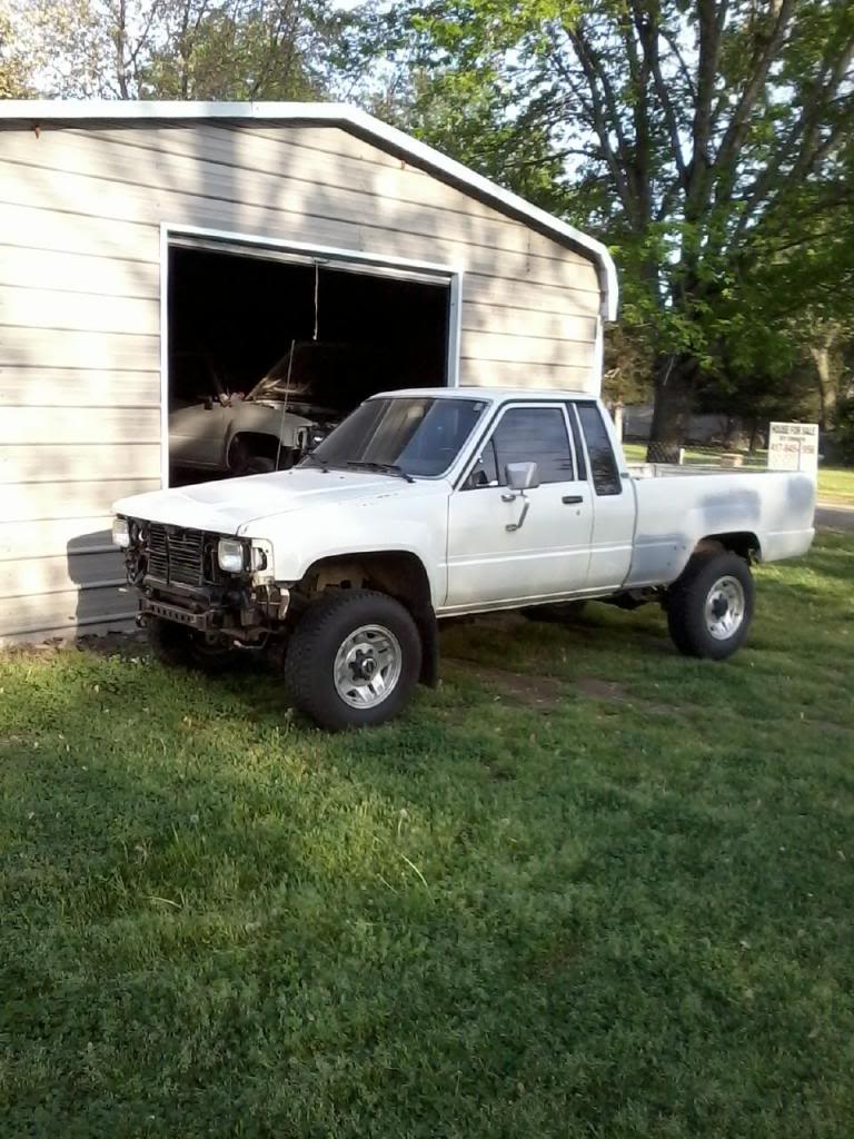

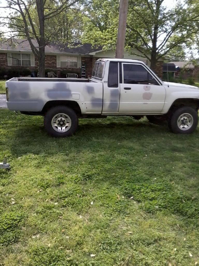

Photobucket quit responding last nite so here is some of what else I got done. I did have a tough tiem getting the fuel filler neck loose and still need to remove a few more pieces of trim. Hoping today goes well. Still have a ways to go before paint, but it is getting closer.
Still have hood to do,roof top, doors still have some dings but they are getting fewer.

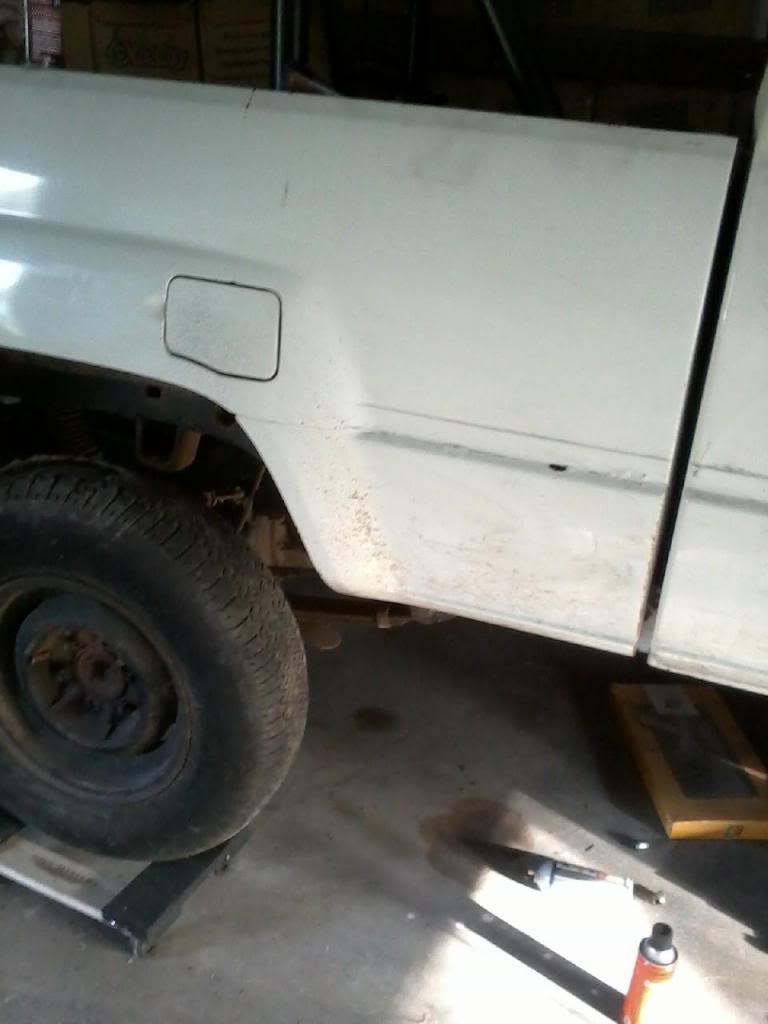

Showing both sides. This truck may look like it has alot of repair but is actually in great condition. Mostly just door dings and 20 plus years of being on the road. I have seen new cars with this much damage. Wife and kids dont like it when I park out in town. I park out in the far corner of the parking lots, next to curbs as close as I can to protect at least one side and anything else I can do to prevent dings. No front row parking for me.

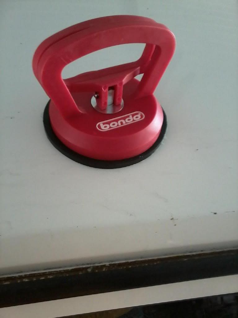

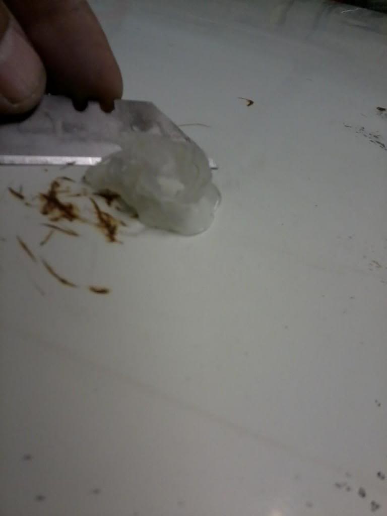

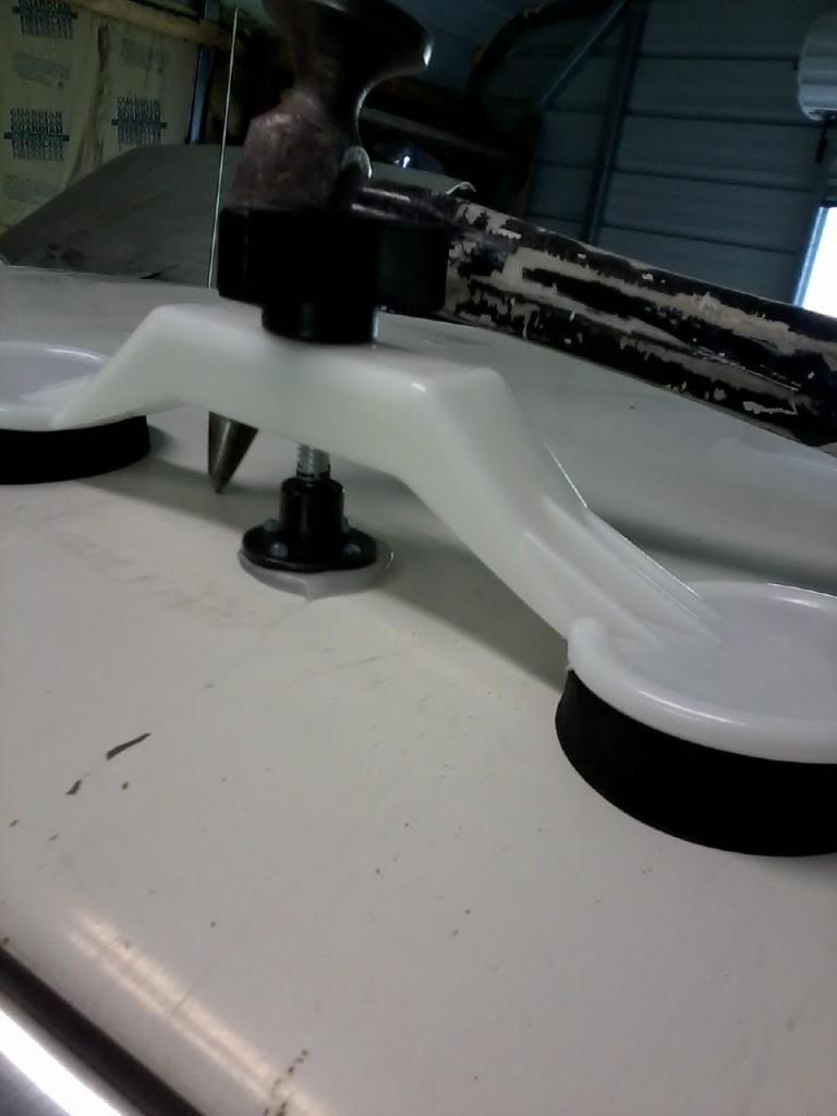

I am working on some roof dents. When I cant get behind a dent, I try everything I can to get the dent out as best as possible. I dont have a stud welder so I have to do the old fashion way of drilling a whole and using a slide hammer to pull the dent out with a screw.
There are several different sizes of the suction cup dent pullers. They work well on a large dish dent. There is also the Pop a Dent. These tools do help pull out several dents but usually will not pull a dent to where it is absolutley perfect that it may seem in advertisements. But they will do alot and sometimes a few other tricks, they will do a good job.
Works on larger dents but comes in smaller sizes.

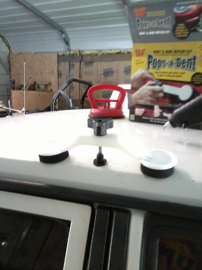

Here is the Pop a Dent. It worked well on one dent that was the largest. I glued the tabs and let them set over nite. Instructions says to wait about 8 minutes. I will be repainting so I wanted them to stick on really well. The Pop a dent can cause dents where the pads set so it isnt exactly as advertised. Just dont want to crank it so hard that you cause two dents where the pads were at.

Getting some of the old glue off can be a pain. I use a razor blade to get most of it off. What doesnt come off I use an old piece of sandpaper to get the rest off as it will clog the paper. Razors can scrape paint but I will be doing body filler on a lot of small spots and since this is such a large area on the cab, it is real flexible and you cant use much pressure on the cab or hood. For the cost of a glue gun, you can get a Pop a Dent for a few more dollars.

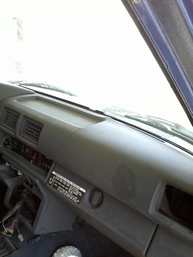

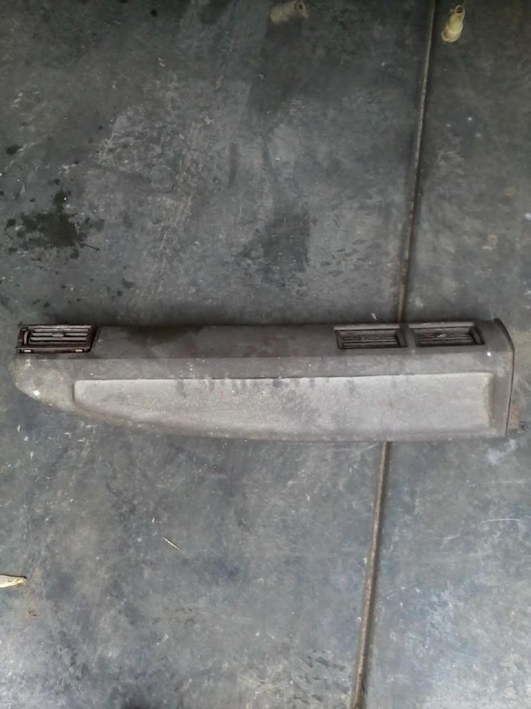

junk4u..Here are the differences between the dashpads. I am not sure which year is which, but they are interchangeable. The one in my 86 is bad and eventually I will get mine swapped out with one that has the longer indentation.
Long indentation that is going into my 86 eventually.
Short indentation. It was in bad condition, but I used what I had until one came along. Just have to be patient and the parts will come.
