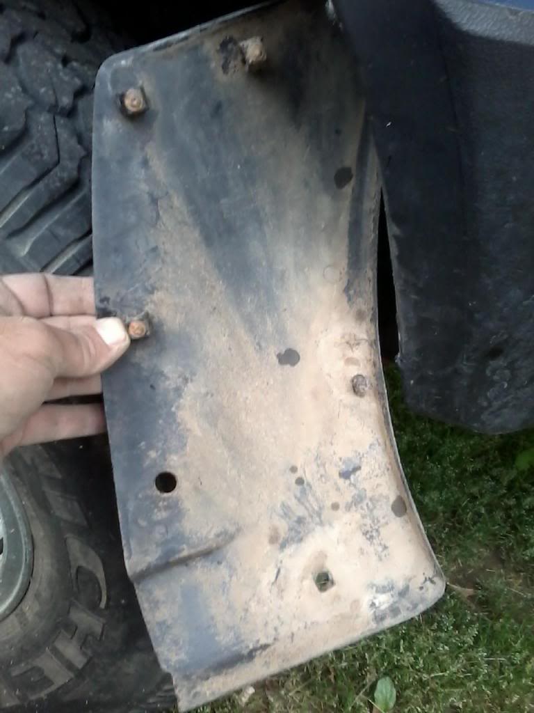

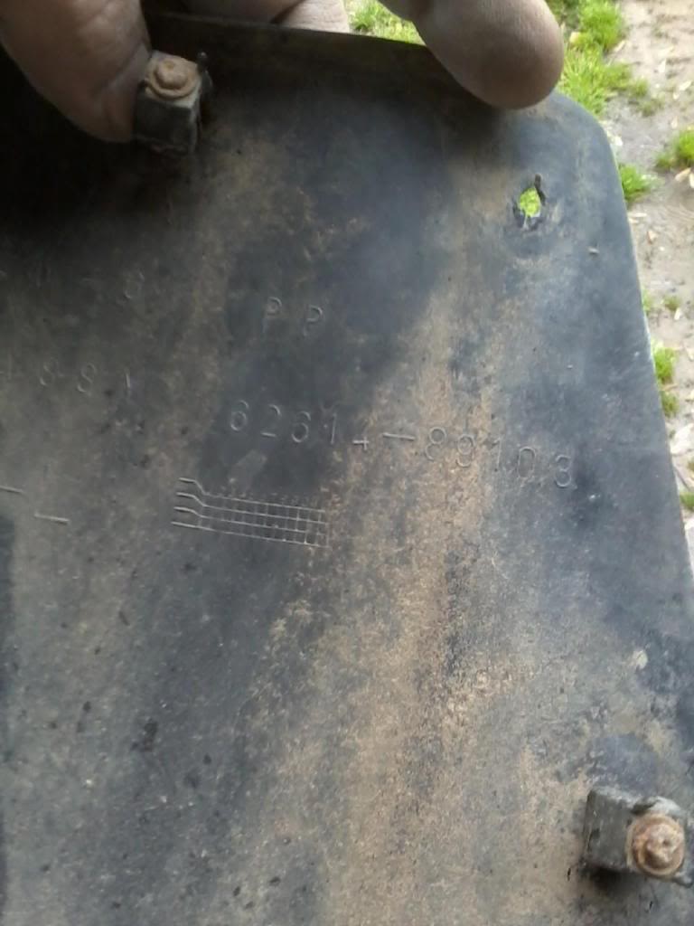

4Runner and Truck rock guards look the same but are different. Truck is in my hand. A 4Runner only has 2 tabs on the out side and some screws on the lip of the fender. A truck has 7 fasteners.
Some more differences.
Trucks have 7 locations. Screw at the bottom is another one that is showing in bottom of picture.
One broke in this one. The screws are usually difficult to get out. I normally have to squeeze the tabs to get them out. Not the first one that I have broken in the past and sure there will be more in the future. The other side came out fine.

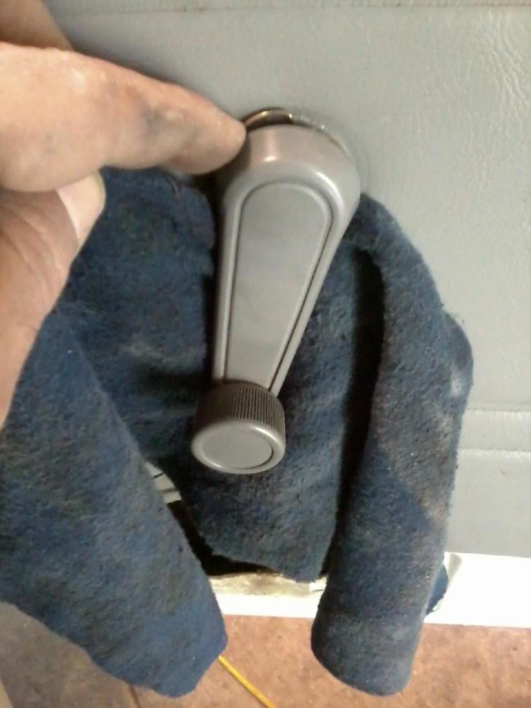

A cheap interior improvement. The top side is usually in bad conditon. A cheap fix is to swithch the passenger side to the drivers side and vise versa.
Top/bad side.
Put the bottom side up and makes a small but noticeable improvement. Just posting this as I had to take interior panel off to get to a dent on door but wanted to give some ideas.
Top/bad side.

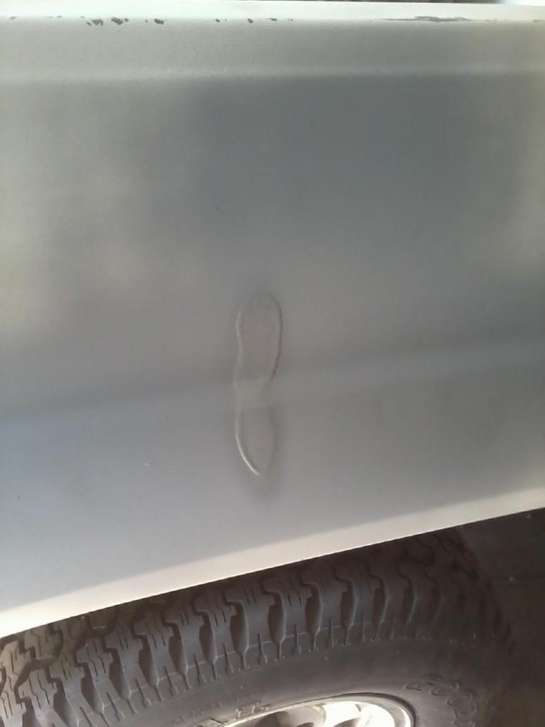

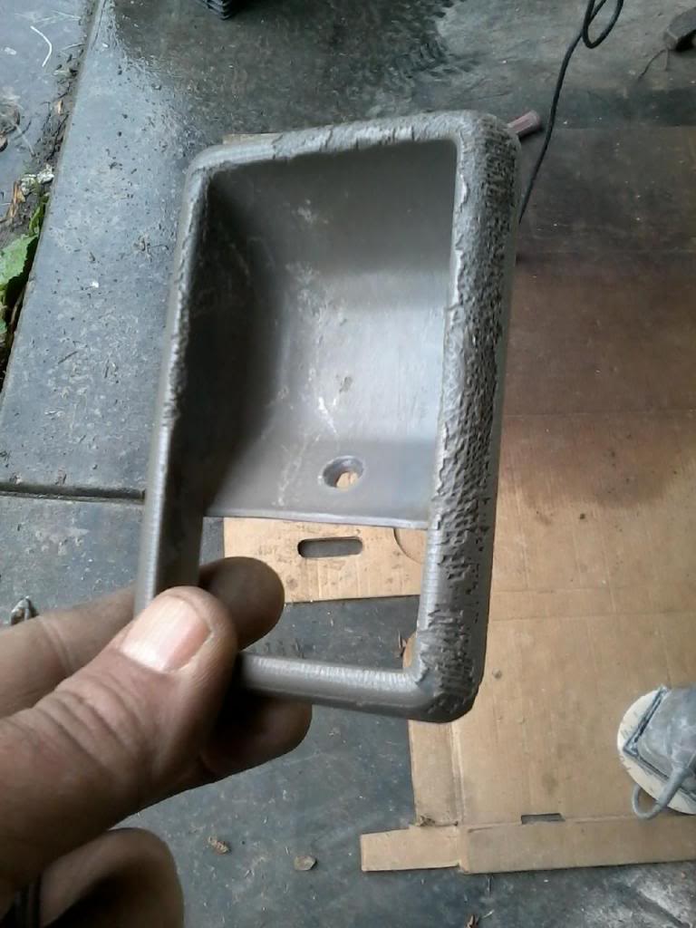

Before.
After. Photobucket quit responding.
Here is the panel I first showed on this truck. Got a pinhole and 2 small spots to redo, but it is alot smoother now and with another hour it will be nearly complete for this stage. I will go back and add more info to this post later tonite or tomorrow.

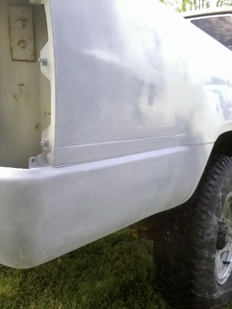

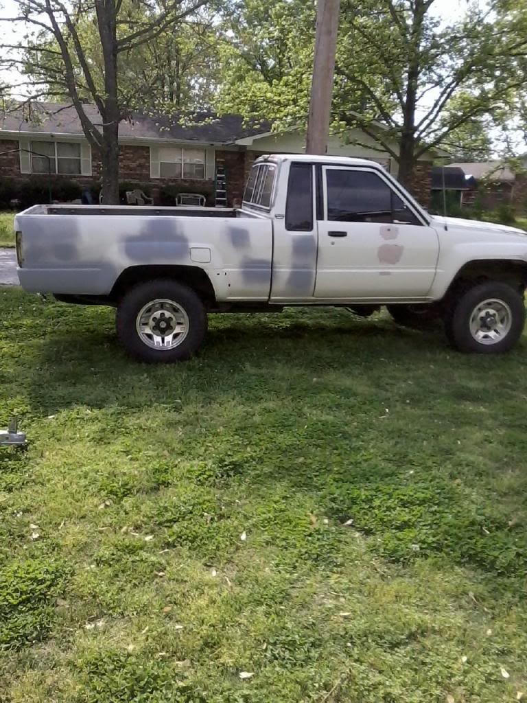

When I show someone how to paint, the first thing I do is to intentionally run the primer. It helps to take the fear out of operating a paint gun. This is a bad run that took awhile to get it this bad. Just trying to show it nothing to afraid of as there are several steps of sanding to do before getting to the paint stage.
If you are going to run on any steps of primer,sealer, paint, and then clear coat. Run on anything but the paint. The primer,sealer, and clear coat are easily sanded and repaired. I have ran paint before but it is usually clear coat that I have the biggest problem with and you have to color sand it anyways.
No fear of Runs while doing bodywork and hope this shows it isnt as bad as thought to be. It took a long time to get this much of a run intentionally. The above pictures shows it is sanded out.

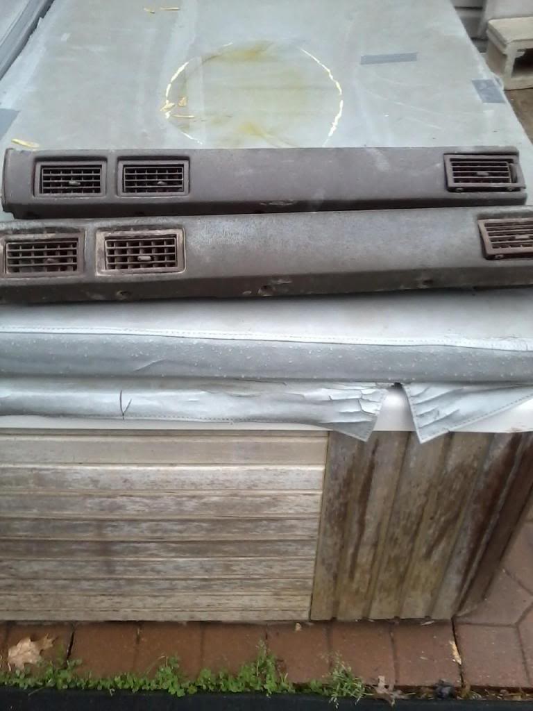

Hey Terry, Since I haven't gotten to my 86 4Runner yet and you are working on a 86 4Runner, do you know if the dash is one piece all the way across of in 2 parts? I've read that the dash for the 86 is a single piece all the way across and the 87 was 2 pieces.
#1116
Posts: 11,787
Likes: 28
From: Anderson Missouri
Thanks junk4u..It is alot smoother then what it was. Still got a ways to go. On the dash pads, they are all the same. The indentation goes the full length on some and half way on others. I will try and post pictures of the two different styles tomorrow. Here is a link on dash pad removal>>> https://www.yotatech.com/forums/f199...l#post51778558 The bezel comes off first and there is a bolt under there. Then the passenger vent and the PE pipe under the dash, above the PE pipe is the other bolt that holds the dashpad.
#1117
I noticed the different length dashpads in a pickup I looked at the other day. Also saw one on the local CL one day, it kinda threw me off I have the small indention, but the one I was gonna buy on CL had the long indention....I thought it was aftermarket and passed on it haha, nice to know that they did vary, I wonder why though?

Yes there are alot of parts for runners n trucks you think would be the same but small details like youve stated make them a little different, AGAIN!! you are a body man magician!! your ex cabs are going to be awesome. That rear bed corner looks great!

Hello dakotawho... I not sure which years had the smaller indentions and which had the larger. I am thinking 86 and older had the larger indention and 87 and newer had the smaller one but could be wrong. I still have a ways to go with my runner but it will get there. I am enjoying more each day.
