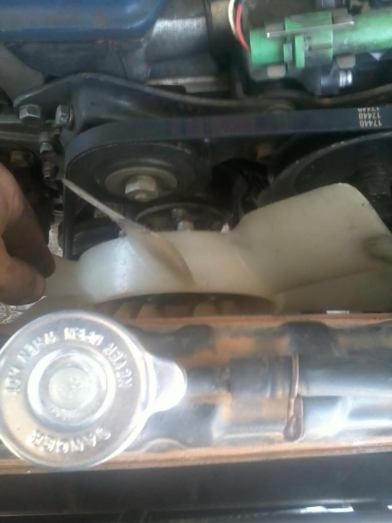

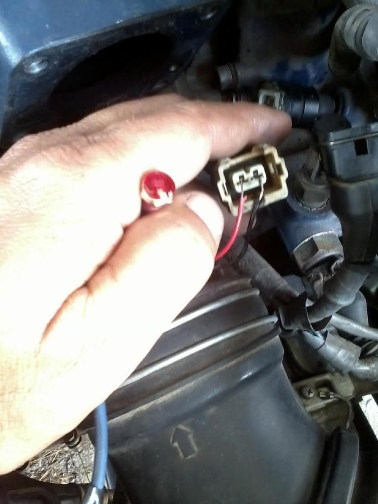

Having a big air leak in the air system will cause you problems. The runner would start and die like the AFM wasnt hooked up. That is normal what did and should of happened. I didnt take the air pipe off as that was the least likely area to break. WRONG!!! Just before we went wheeling, I checked the air filter, oil, and just a once over. I must of leaned or knocked the air hose down on the fan. I could not hear anything with the top off and I am not sure I would of heard anything. The fan just barely made contact with the air hose.
Here you can just barely see that the fan was hitting the air tube. Sure it didnt make much of a noise at the time and with the top off I may of not been able to hear the fan rubbing. Not much signs of rubbing on the fan.

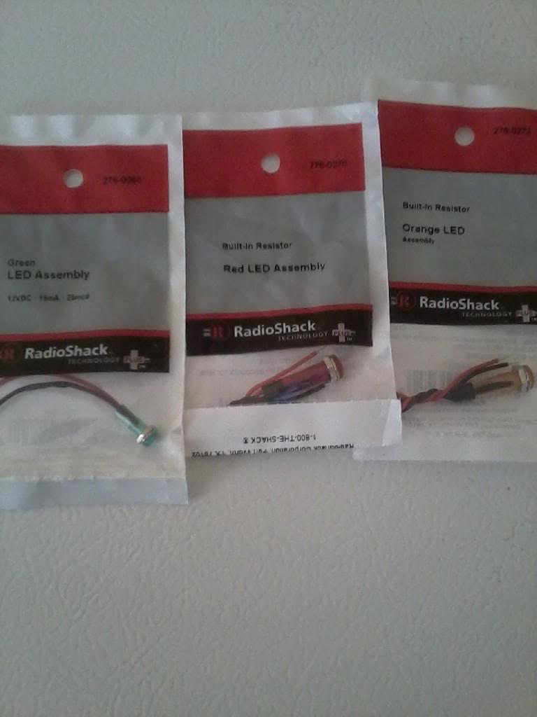

My $3 noid light. I wasnt able to find one anywhere and this worked great. It flickered each time I cranked it. I just couldnt get any pictures of it lighted.
I used the 12 Volt red one. Radio Shack Part Number #276-0270

well good lesson learned check the air pipe for any breach past the AFM when the engine wont run yet starts
