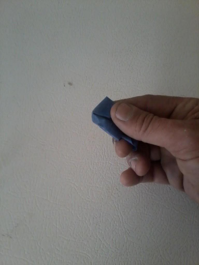

Here is how I get bugs off when they land in paint. It takes a steady hand.

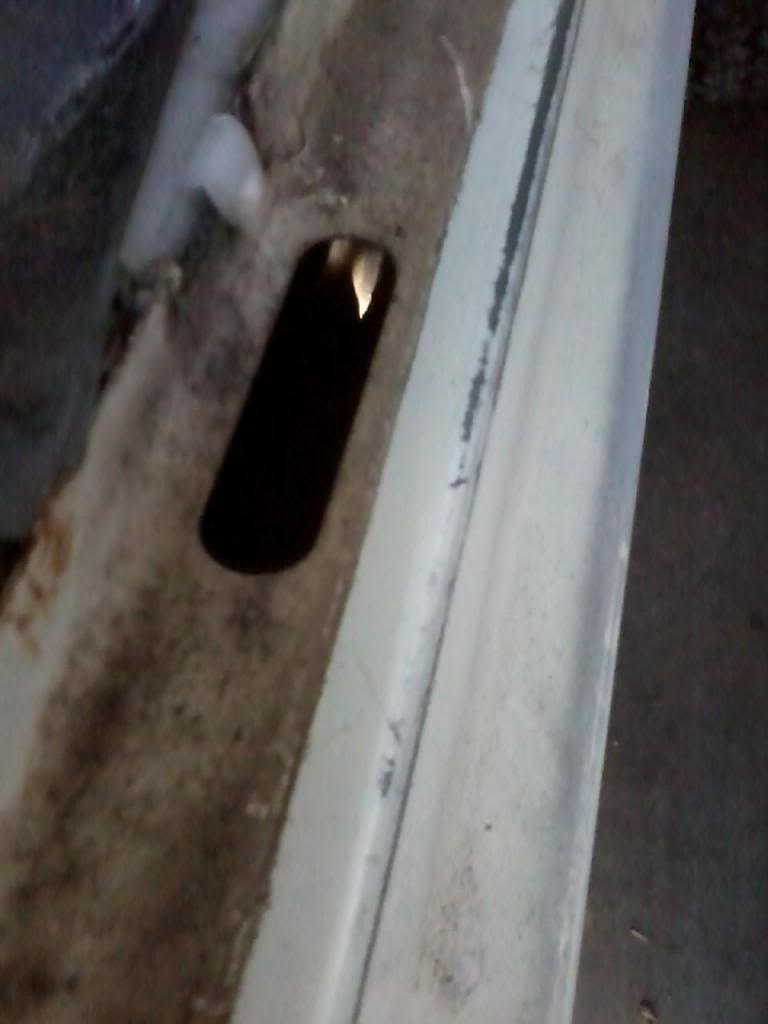

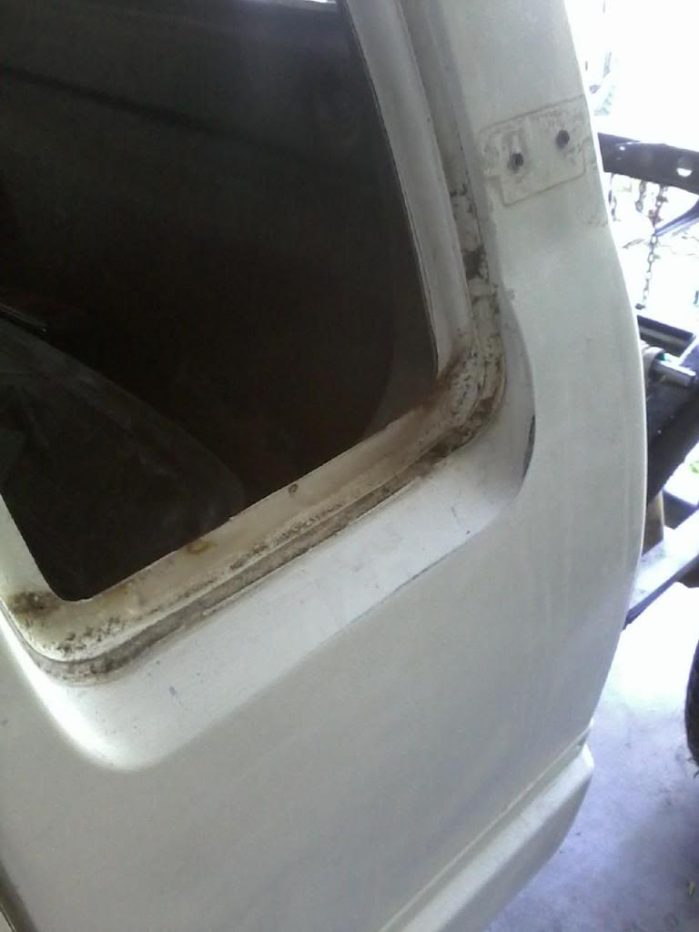

I prepping for paint the jams, I cleared the drain holes. Just remove the door sill and a clothes hanger and an air gun works great. Also there is a hole in the back of the cab for pickups that works great. I will post a pic of it tomorrow. The light at the bottom is the drain holes that tend to get clogged. There are 3 or 4 of these holes on each side. You can tell by the little "v" notch on the rocker.
I remove the door seals to save on masking and a better coverage.

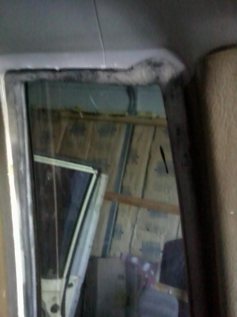

Side windows remove just like the back glass. From the inside lift up on the rubber seal and start pushing it out.
Trying to show what I am talking about in the post above.

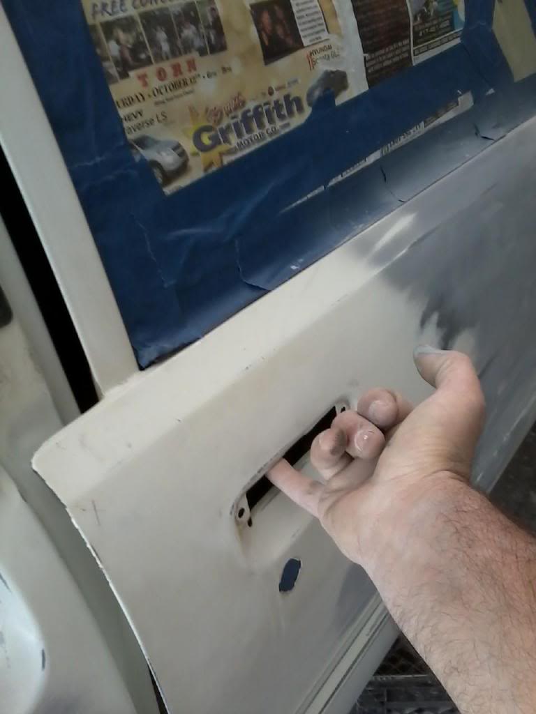

When painting, I will open the door with my finger. What I touch is covered by the door handle and will never show. It is actually on the inside of the door. When I close the door, I will actually push on the glass where it is papered.
This picture is the reason I paint jams and body all at once. I had the door closed when I primed this area at an earlier time. You can see the primer made its way past the door gap. If this was paint, it would do the same only have an overspray look to it.

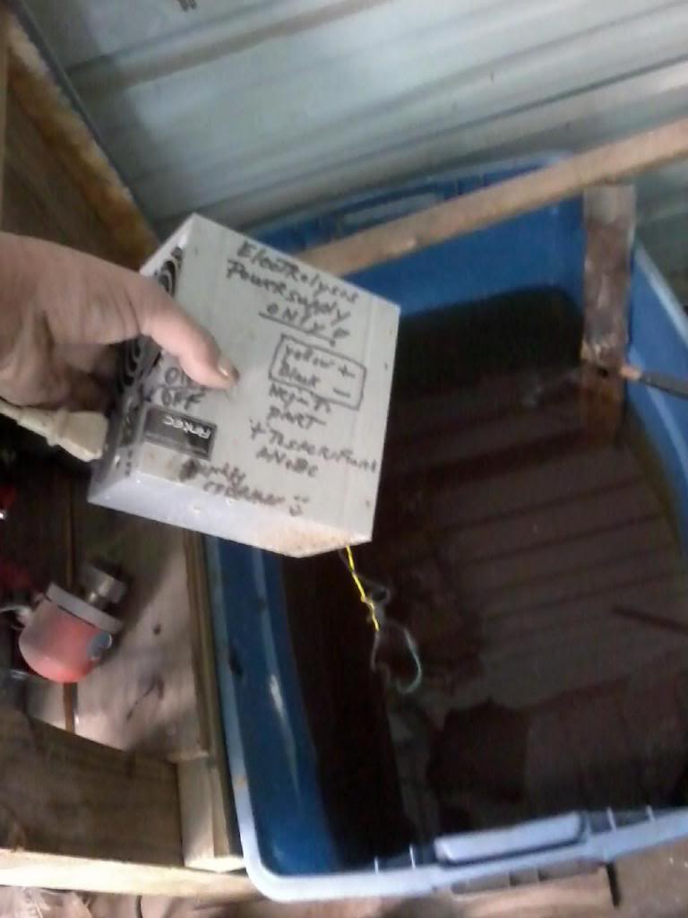

Here is a cheap Electrolis Cleaner that makes life so much easier. Cyberhorn has it listed on his thread on how to make one. Works Great!!!

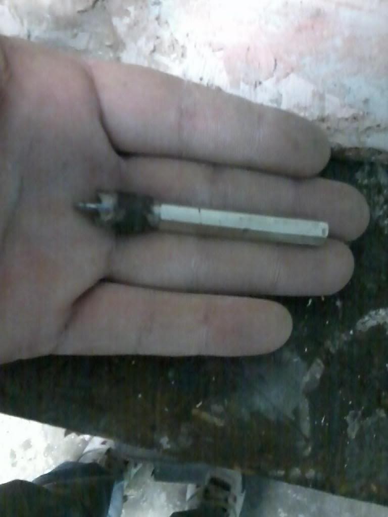

Someone was asking for a picture of a Spot Weld Cutter. These are ten times better then using drill bits and I got this at Harbor Freight for about $7. Saves alot of time when cutting spot welds over drill bits. I had to replace the Core Support on my 86 and it is just bolted on. I have no intentions of evr having it welded back on. Makes removing the entire drive train a piece of cake and I can have it out or in within 3 minutes once everything is disconnected.

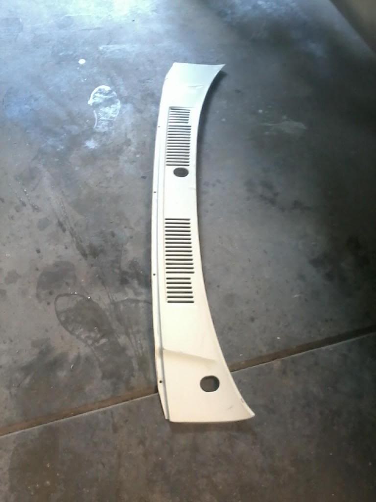

This truck came from the factory with it blacked out. Trucks with chrome usually have the metal painted to the body color. I am removing the black trim and installing chrome later on, so I am painting the inner fenders white. I washed it and just wiped it down with a thinner soaked rag and hit it with primer.

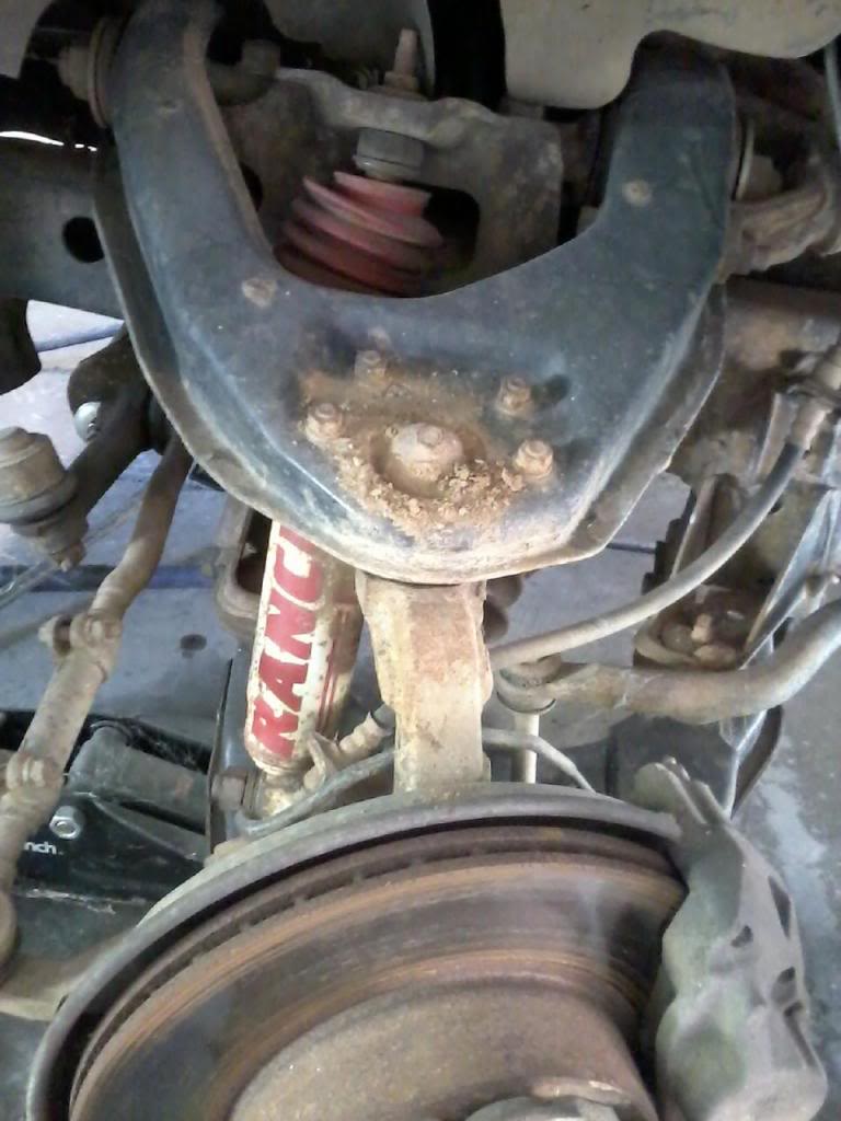

Hello Mark...I just found a text from you last nite about an ECU Part Number. I dont have any 87s but have a couple of 85 and 86s and can look at their part number.
My truck came out of Florida and the sand was everywhere. Since you dont have IFS, there are probably fewer places for it to get into, but in some ways can be more expensive on a solid axle. I would suggest getting a high pressure air hose and clean out the frame and then follow it with high pressure water. That sand is a nite mare. I have since replaced the carpet in my truck, but I took my old carpet out and washed it several times, air hose, and beating it with a broom and still never got it out.

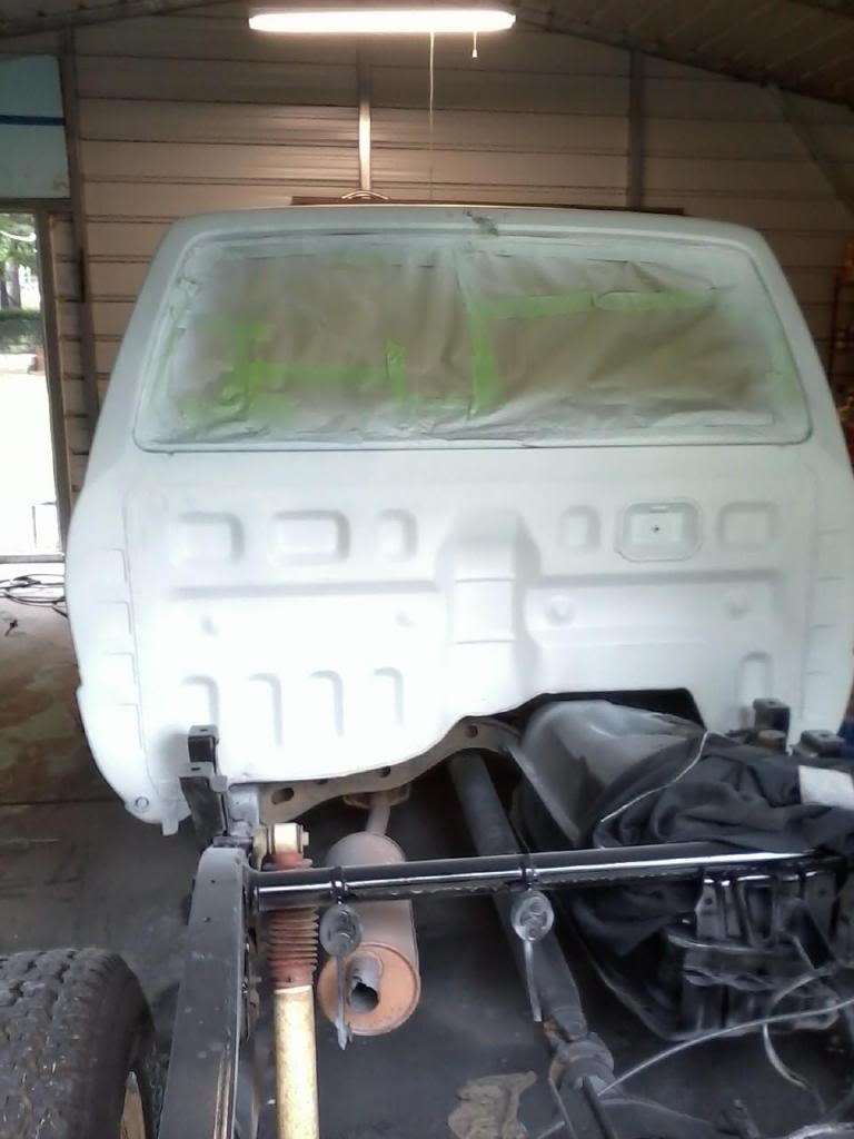

Today wasnt what I expected. I ran out of sealer and had to go get some more. By the time I got back from the store, it is just later then what I want to start painting. I have got it in sealer so when conditions are right, which is looking like Sunday afternoon after church. Then possibly more rain on Monday.grr. It worked out as the painted probably needed to be reshaken anyways.
If I started painting, besides the humidity, the bugs would just be to much to mess with. It is in sealer completely and I did have a couple of spots to rework. All work is now completed so literally, I just need to mix paint and spray.

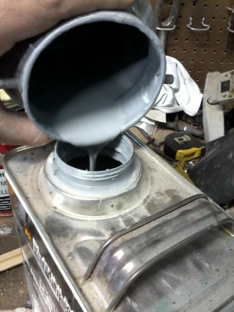

I used to use or waste any excess primer I had left over. A nephews teacher told me to just add it back into the can instead of wasting it. Just something I never thought of.

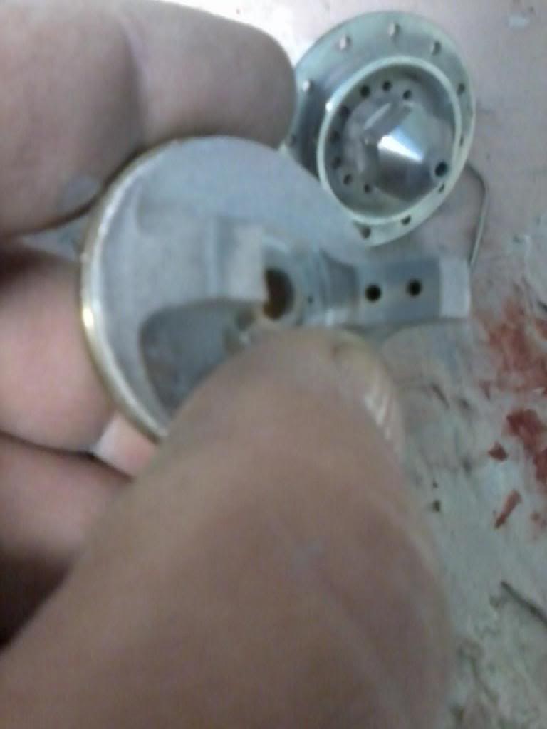

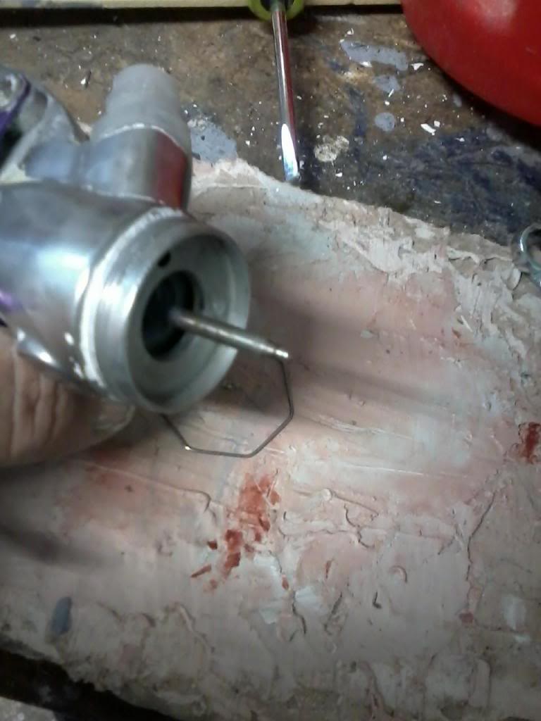

Before I start, I always clean the gun. This needle will come out, but it messes up my spray settings, so I dont take it apart unless just absolutley necessary. Getting the spray pattern is a little more difficult then what it should be to me it seems.
The spray nozzle come off, the part that is attached to the gun with a 10mm wrench, and the other piece where my finger is at likes to get clogged. I soak these two parts in a can of thinner. I need to get a welders cleaning kit to clean the holes out that would work for cleaning as well.

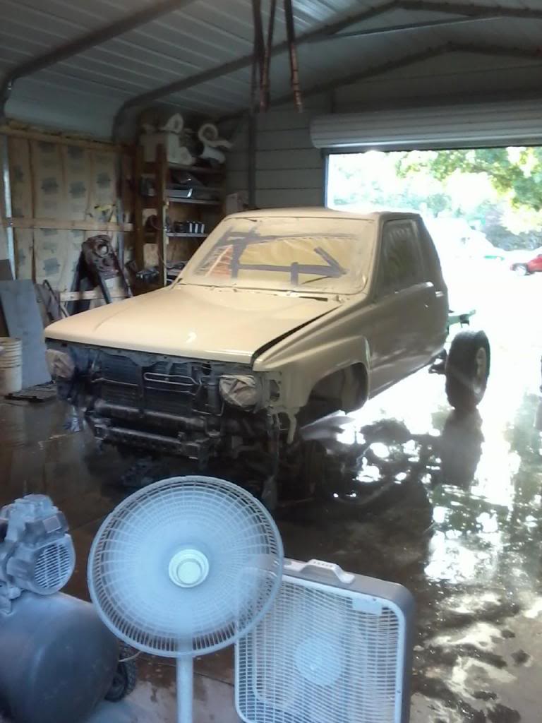

It is in Sealer.

Had changed my mind several times today and got to paint today. Weather was finicky. Before it looked like a salvage truck getting ready for paint. Now it is a shiney looking salvage truck. I have already started working on the mudflaps so hopefully it will start looking like a Toyota soon.
After a day or so I can start putting all of the pieces on. That doenst take long, so maybe tomorrow nite it will look more like a truck again. My biggest concern is hoping there is minimal orange peel. Paint always goes great for me, it is the clear coat that is the biggest problem.
So much for the painting the rear of the frame. I got quite a bit of over spray on it, but it will clean up fast as well. Dont have pictures of the rear or passenger side yet.
