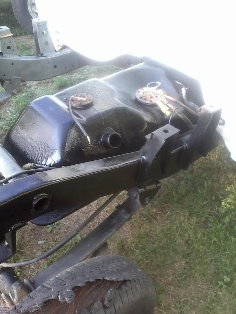

From: Anderson Missouri
Got the bed done. Will see if I can get the cab done tomorrow but it isnt looking to good right now. I have to go to town and take care of a few things. Going to get an early start and hope for the best. It only takes about 10 minutes to get a coat on but some how it still takes a while to get one completely painted. I always allow 4- 5 hours for painting. Doing the bed, there is No Masking. Doing the cab, even as bare as it is, still alot of masking and that takes time.
I did have some excess clearcoat so where I had the frame cleaned an painted on mine, I cleared the gas tank an frame. No sense in just dumping the excess.

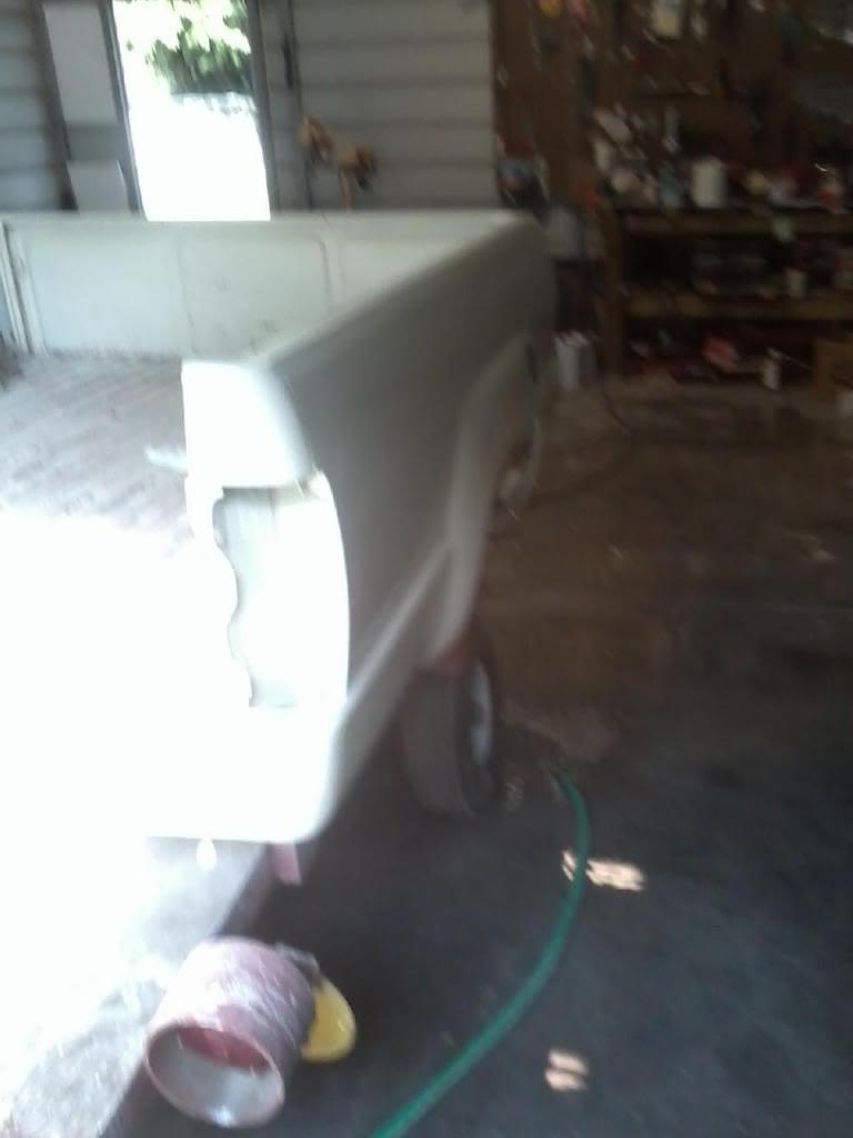

I have been checking in on the truck bed. Really happy with how the clear laid down. One small run and it will take about 5 minutes to get it smooth. Couldnt be happier with how all of that has turned out.
The one thing I am worried about is I am not sure it is as white as it should be. To me it is more of a tan color. I am hoping that it is the flourescent light that is giving it the tanish look to it. I am eagerly waiting for daylight to see its true color. If it isnt the white that I want, it will be getting sanded back down.

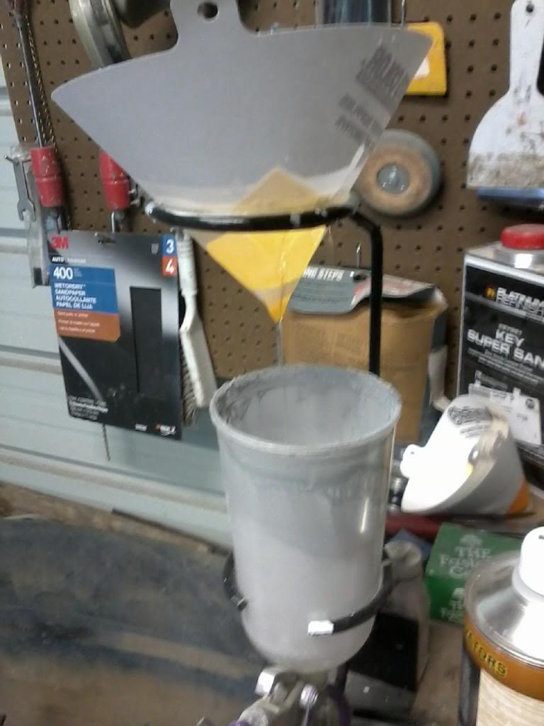

I primed, painted and clear coated Toms frame. Trying to get it ready to put the bed back on to save space. I can just cover the bed when I paint the cab. I was really concerened that it was to tanish in color, but after getting it out in the sunlight, it is more white then what it looked like in the shop. After looking in places on the truck where the paint was faded, it is maybe one or two shades off and maybe it if it was waxed would look really close. Wheww!!!
When painting, after mixing your paint and activator, always strain your paint. The paint shops mixes it well, but it still will want to clump up after setting for a small amount of time. Clear coat looks about like water. I never see clumps in it, but I still strain it just for good measure.

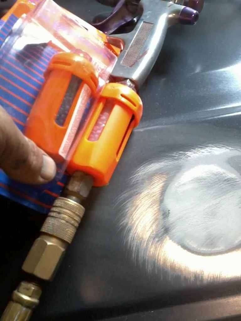

In between paint and clear coat. I drain the air air out of my tank and switch out my disposable water filter trap that I have attached to my air gun. The ones I use are orange and works great for me. Your tanks water trap alone isnt going to keep it out of the gun. This is great painting weather and less bugs in my area. Also the temperture stays more consistent. Try to pick a day that is going to stay about the same for painting and clear coating.
Paint isnt so bad in my opion, it is the clear. Make sure you use an activator for the temperture range that you are going to be clear coating in. It makes all the difference in the world in getting the smoothest clear coat down. I can PM you my number when you go to paint and answer any questions you may have when you do go to paint if you like. I am sure to think of some more tips and pics so keep checking this post as I will add more. Redeth is wanting so tips as well and I am eventually going to combine from start to finish in one post on here.

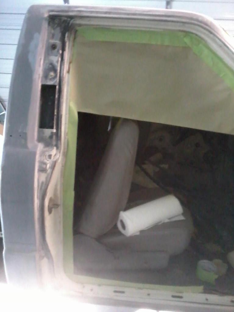

Masking is a pain in the rear. Try to remove as much as possible to avoid masking and overspray, is something else I would suggest.
Here is a link to one I painted before that might have some more tips befroe and after this link>>> https://www.yotatech.com/forums/f199...5/index14.html

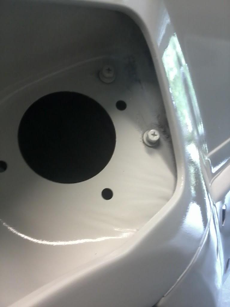

Here is how I mask to avoid the overspray look in between the door andbody. It avoids over spray and gives a cleaner look when opening the door. When painting, I close the door nearly shut, but not latching, after painting the jams. I remove the pinch weld trim and mask the paper to the pinch weld. When I reinstall the pinch weld trim, you cant tell where there is two different paints.
Here is how I paint the inside of the door so as to make it blend in a little better with the exterior. I remove the trim and then run tape where the trim was on the inside. Then I paper against the exposed tape and run another strip of tape on top of that. Top has been taped again and still need to run tape down the left side.
Not to worried about the center as it will have a door panel covering it and I will cover the seal as I just now seen that I didnt mask it off.

Water Seperator. Blue is good, Pink is not.

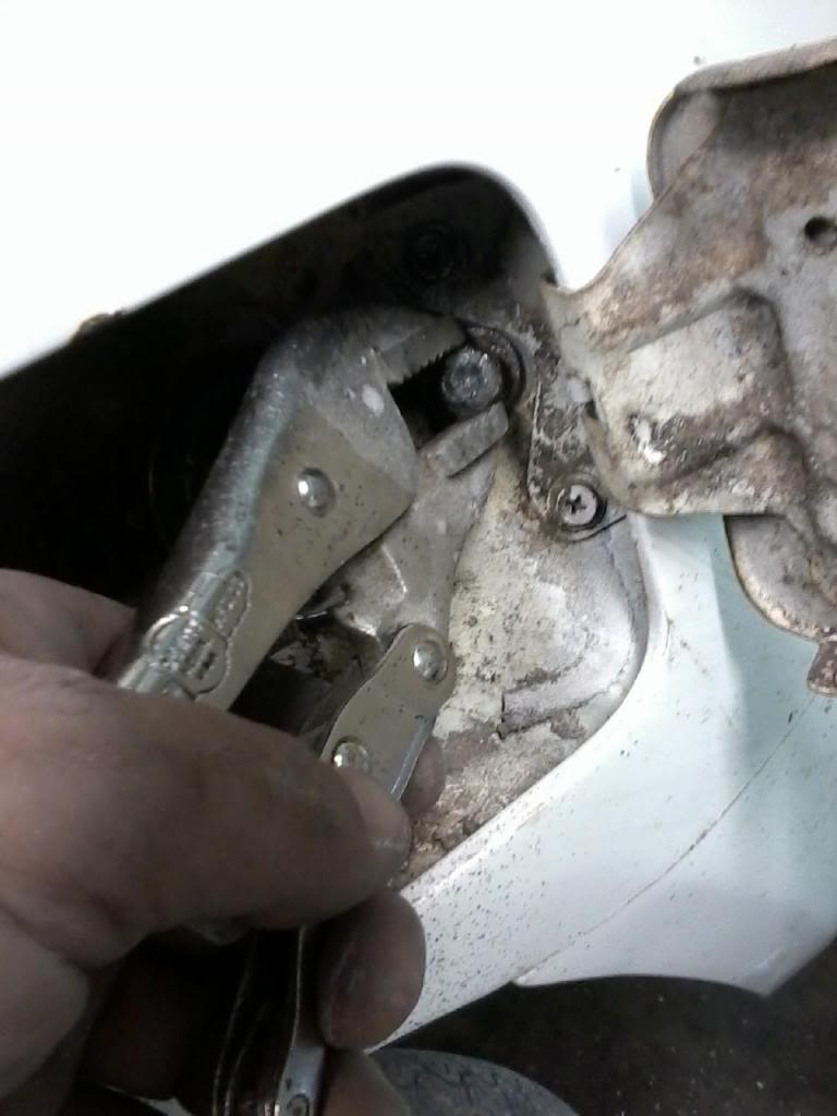

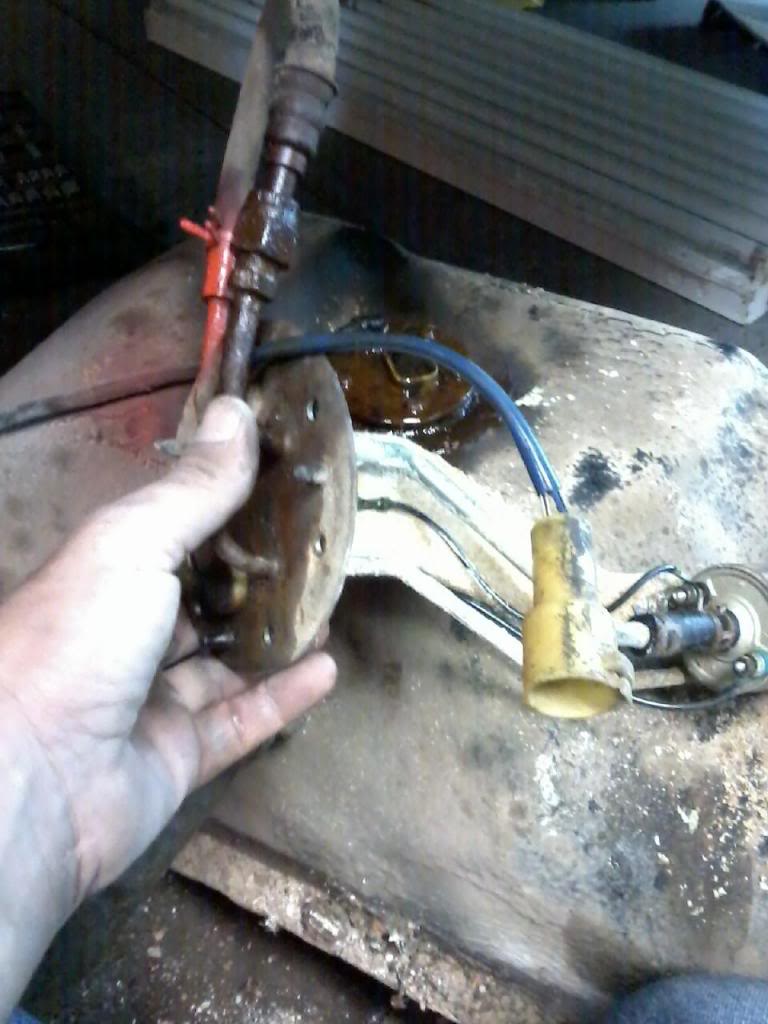

I am posting this picture up for Tom. The 14mm nut is stationary and the 19mm is the one that needs to turn. This is the metal line that will twist and possibly break on it. Be very careful when trying to seprate the two lines. If you cant get it to break free, I would just leave it attached.
There can also be bad looking rust on the pump assembly. It will clean up nicely with a wire tooth brush. If your fuel pump looks bad, I get mine off of ebay for around $30. Parts store wants $150ish and Toyota around $300. I have never had a problem with ebays pumps.
The bottom picture is usually how I have to break the screws/bolts loose in the same way as I do the gas cap door.
Copied.......
A big problem with the pickup assembly is the 14mm nut that attaches to the 19mm hose fitting is stubborn to come off. This can easily twist the metal pipe. Some of these pipes rust up bad and can break. This is a hard part to find and when found is expensive. Seems like around $150 on ebay. Dont get in no hurry trying seperate these two pieces. If I have to, I will clean it on the truck instead of taking the chance of breaking it assembly. The metal line is the supply side and is high pressure. Also the oprange is just a quick reference for me to remeber which line goes where. I will mark them better at a later time.
Getting this one screw out took along time. I have been working with it for some time. A while back when I got all of the bed bolts off, I was trying to lift the bed and it was being difficult. My youngest son would of said I earned my Der patch if he had been out there. I forgot about the fuel flll pipe. Doh!!!
