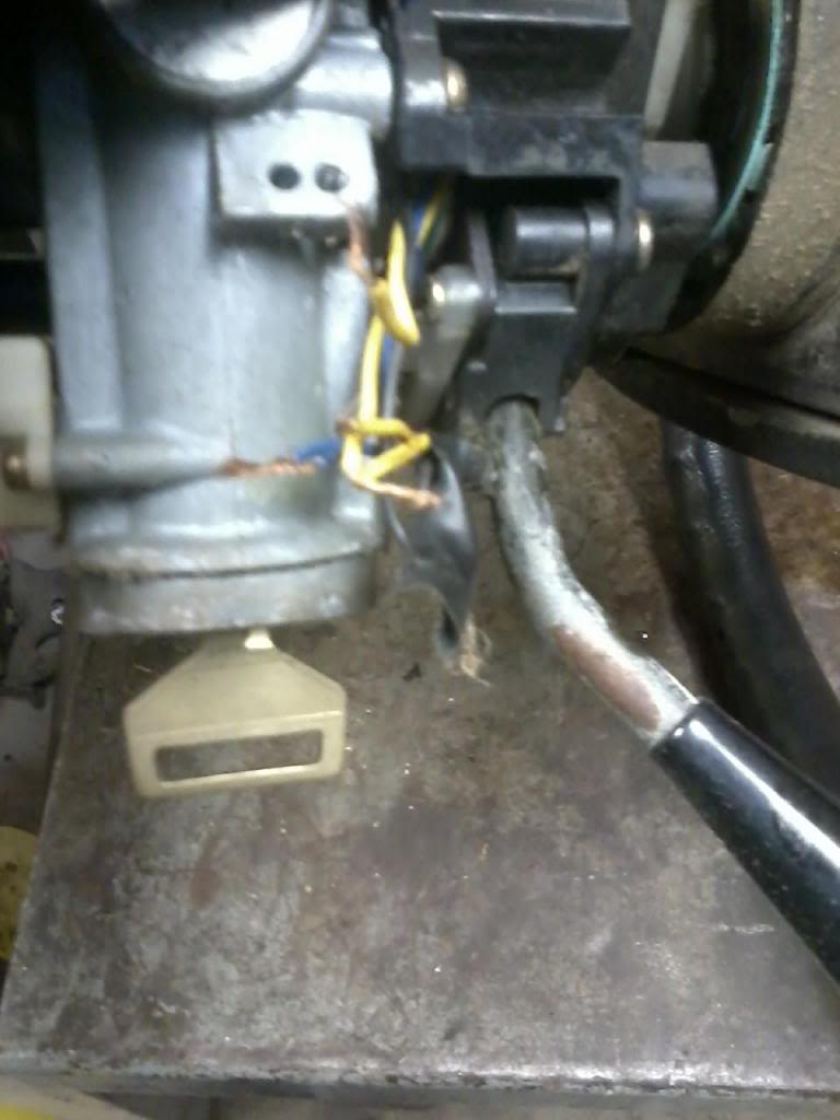

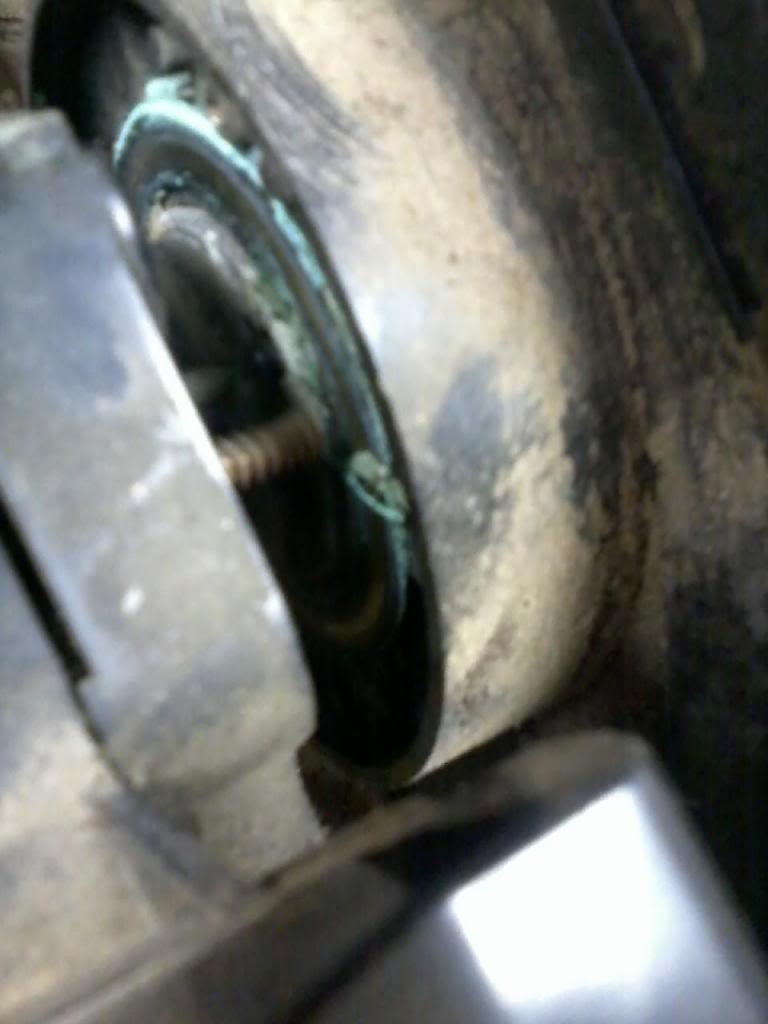

Found 2 problems with the Steering Column that I will be putting in. The horn contact is damaged fairly bad. I got a spare colmn that should have the part to fix it. I need to rent a steering wheel puller. I will do that on Monday and pull the wheel. Not showing in the picture to well, but it is far from making contact.

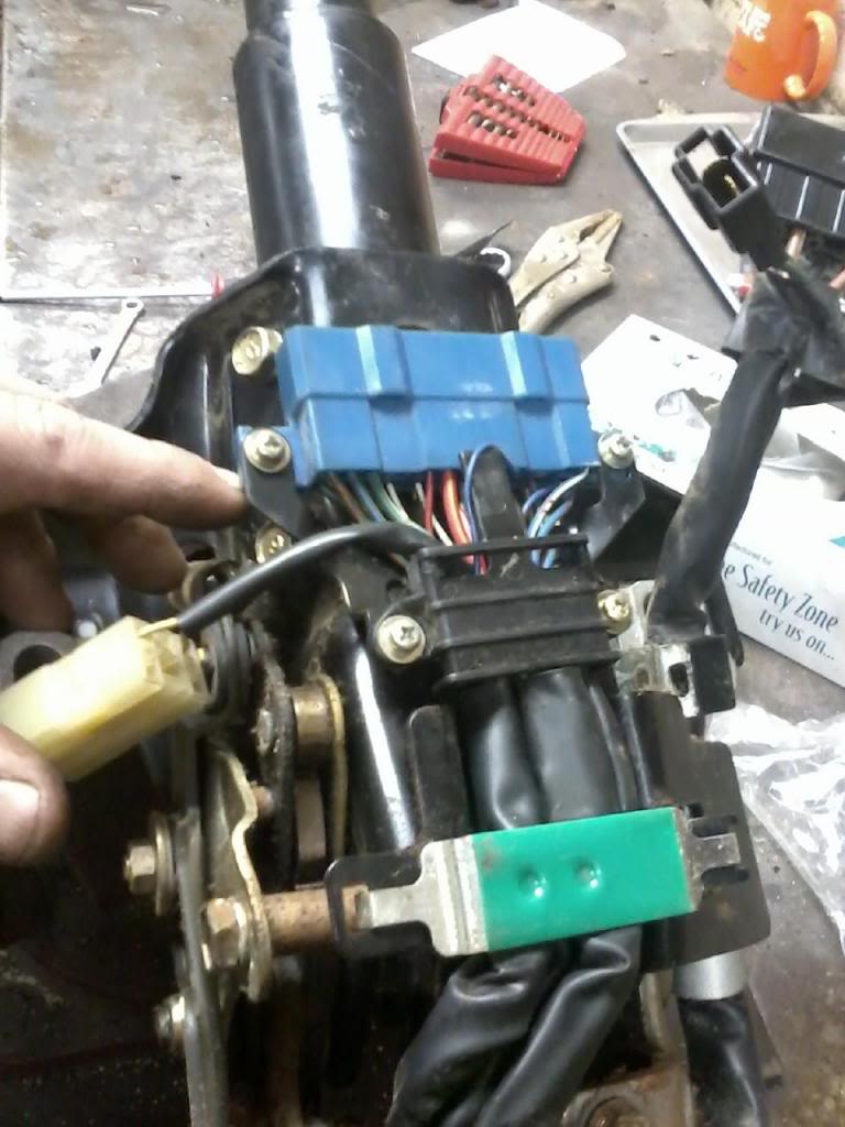

Someone has messed up the wire to the Wiper Control Arm. I will splice and solder back together and see if there are any other problems.

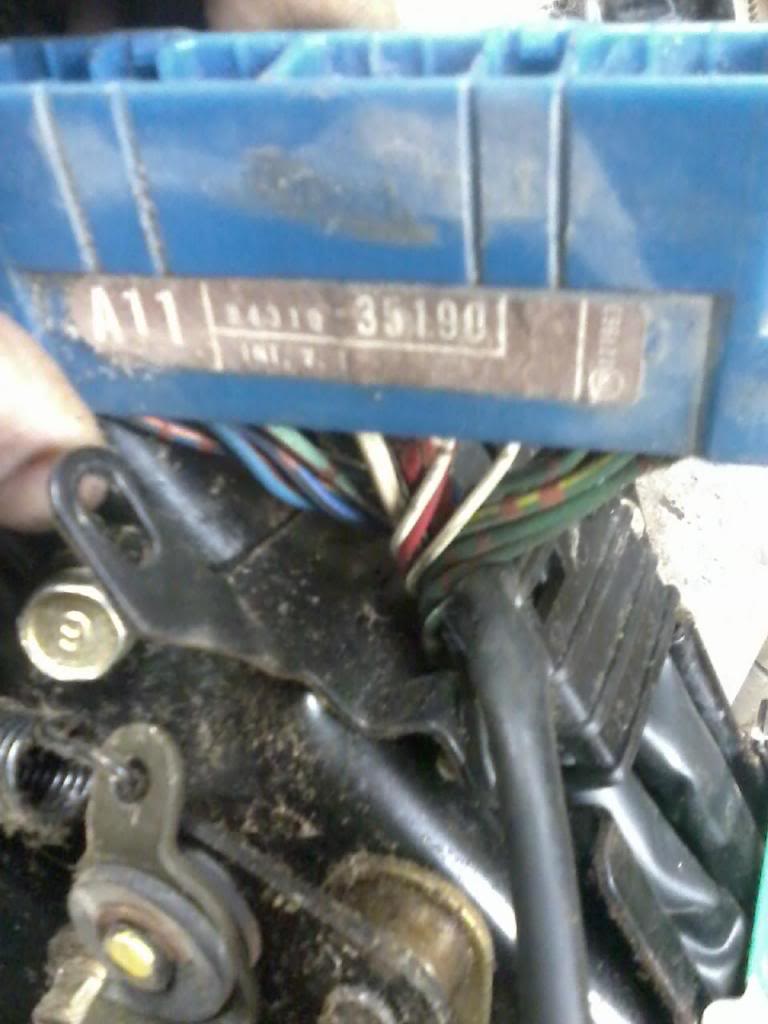

If I have to replace the Combo Switch, here is the part number. Toyota has several different part numbers for these for the different options from what I can tell. They all look the same and will work, just not all options will operate. Been down that road before.
You have to remove these 2 screws and flip it over to get the correct part number.

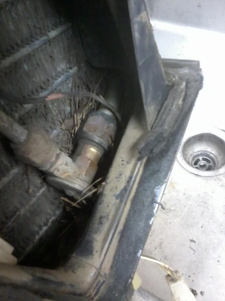

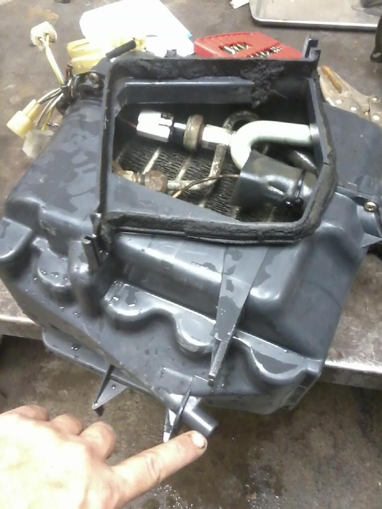

Condenser was dirty. This truck has been well taken care of. It might look like some of the junk trucks I have worked on in the past, but this is common on nice daily drivers as well. It is from not having Vent Screens on the windshield cowl.

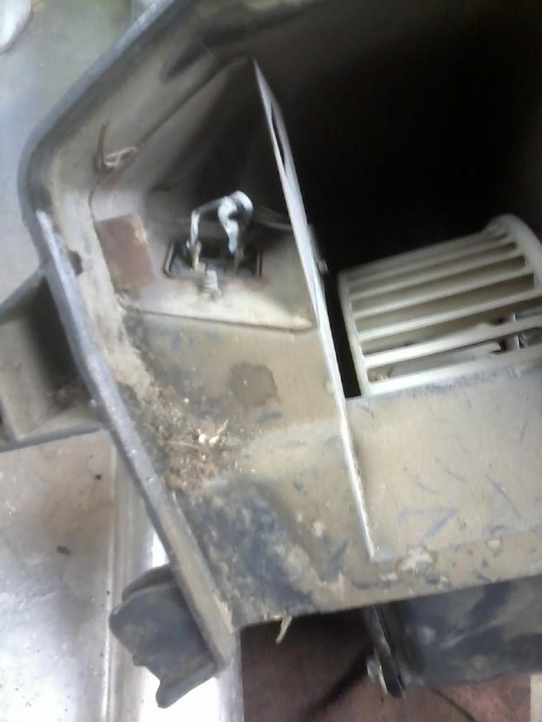

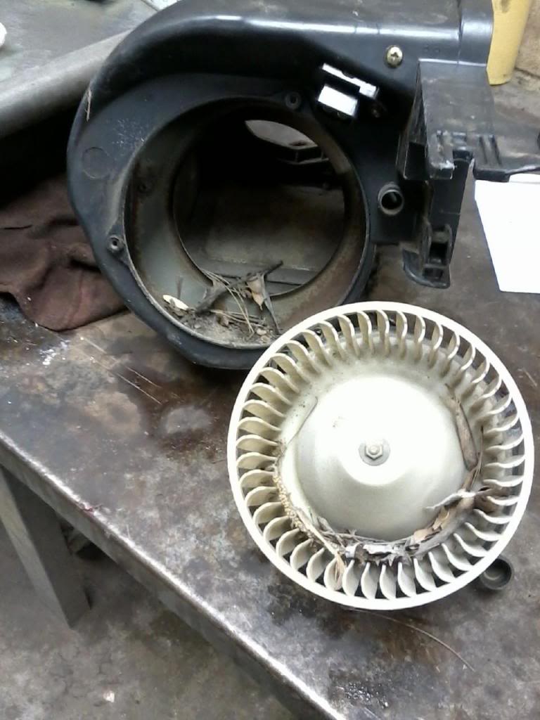

Another common problem of debri getting into the windshield cowl. You can hear the debri alot of times in the blower.

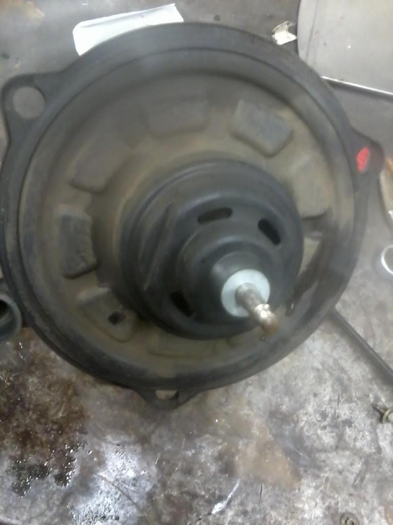

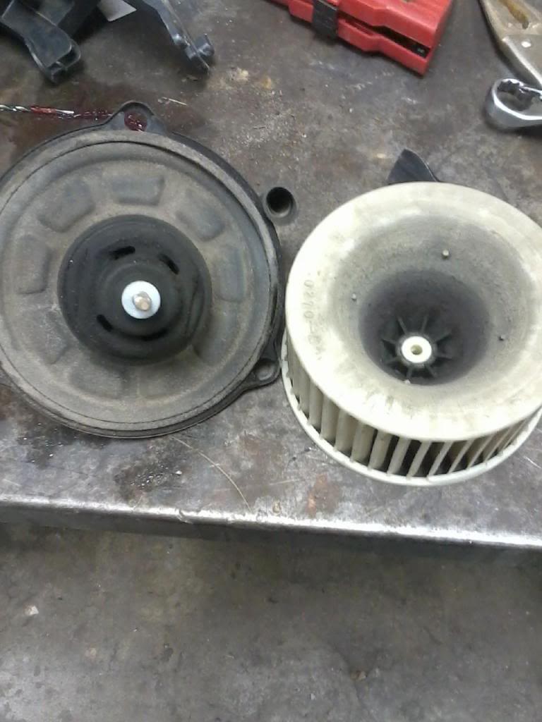

There is alot of dust from the brushes inside the motor. I take an air hose and clean it out. Also cleaned the fan blade assembly.
You cant see in the picture, but you can actually see brass windings in there. It was dusty. Nice and clean now.

Cleaned the Condenser, make sure drain is clear as well. Washing the condenser wasnt a problem as it is always wet. I soaked the coils in Simple Green and then rinsed with water and an air hose. You can see thru it now.

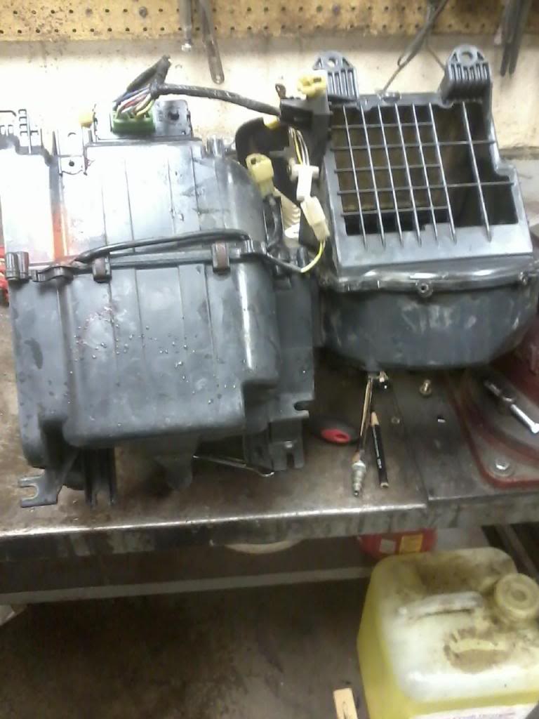

Here is how it sits in the truck. You can take just the Blower Assembly out by its self, but is difficult. If you pull the AC Condenser out, the Blower comes out so much easier. You will need to recharge the system. I dont know if this truck has been converted from R12 to 134. Will need to look and see about that later. Put Blower in first THEN Condenser.
