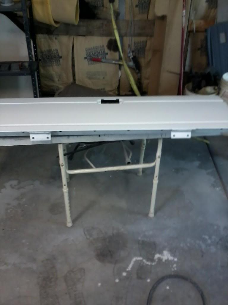

I have finally gotten the roof of the 86 extra cab smooth. It was rougher then it looked 3 small dents just wouldnt get smooth like I would like. I remember when I first started doing bodywork that I would get a dent like one of these and work on it for hours and then the owner of the bodyshop would come over and tap in a few areas with his pecking hammer and have it done in 10 minutes. I gave that a try on one of the dents and it fixed itself, two other dents it didnt work on. I got all 3 of them so it was an accomplishment, wahoo. Just need to do a little work on the doors and then final sand for paint. I am hoping to paint next week.
Roofs are the most difficult as they like to flex.

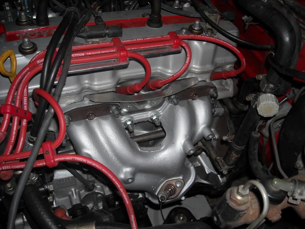

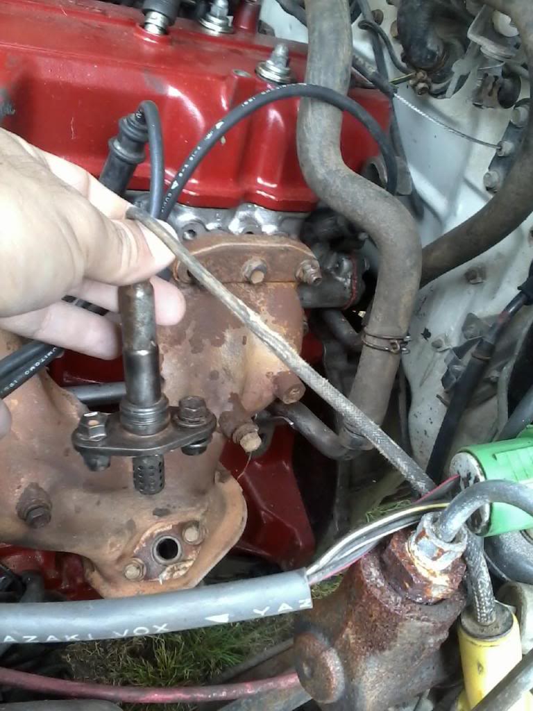

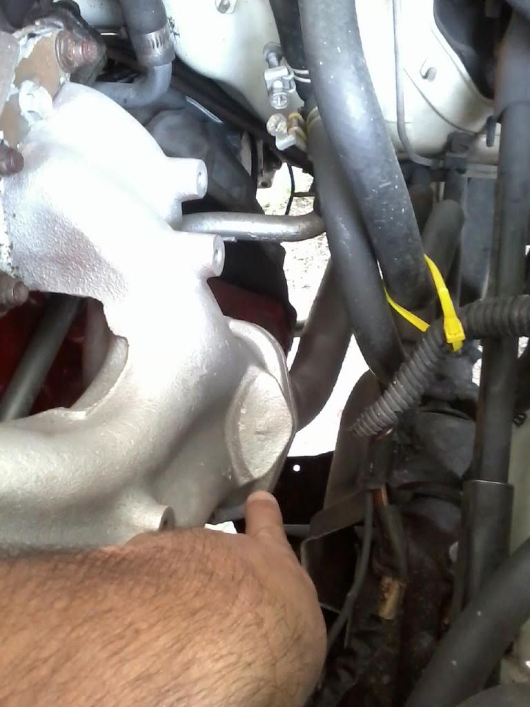

This is for Tom to see the difference in manifolds. This is on my 85 truck and has the single O2 sensor in the exhaust manifold. 85 and 86 have them here.
I am holding the O2 Sensor. Notice the block off plates where yours might have the Air Injection pipes.

I am almost positive that 87 have the O2 Sensor under the seat sticking in the exhaust pipe by the tcase. I know 88 and above have them this way. I will look thru Marks thread or another 87 thread and see.
This is the 88 Runners. O2 Sensor is blocked off and might could be machined but I dont know for sure.

Nope, 87 has O2 on the mani just like the pics, but no PAIR...

Thanks Mark. I was thinking 87 was the O2 in the exhaust. Helping a friend find the correct manifold. 88 is the change over.

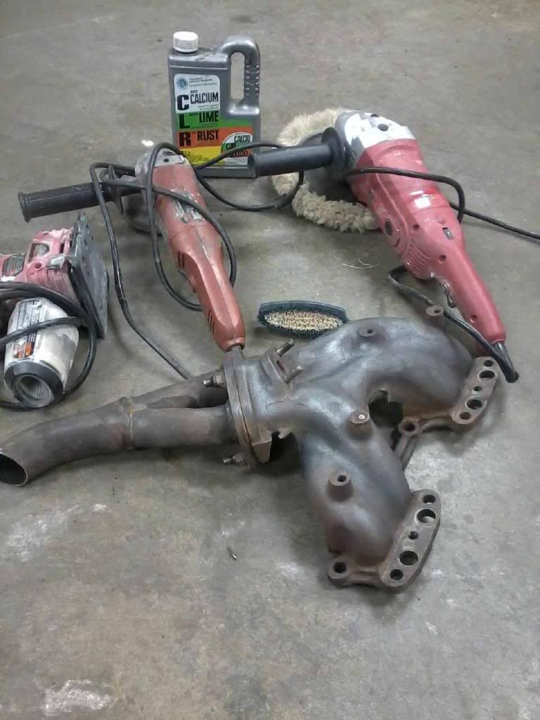

Thought I would post some info as to how I do things for parts and frame. I have some nice air tools that I have recieved for gifts and such, but I still have some of them in the boxs that they come in. I personally like electric tools because I dont have to listen to the air compressor run and the air hose is not as flexible as an electric cord. I dont care for what pawn shops do to people but I will save a few bucks and get my electric tools from them as you can get some real nice tools for less and will last along time.
For frames I use a drill and a wire brush or 180 grit sandpaper. Dont get your sandpaper from the parts stores. They are expensive. If you search around, you will find an autobody shop supply store that is alot cheaper then the auto parts stores. The local bodyshop can locate one for you.
I buy a 5 gallon can and pour it into one gallon cans. The supply store I got this from didnt have any 5 gallon cans of thinner so I asked when he would have the 5 gallon cans, he just sold me 5 one gallon cans for the price of a gallon can.
A gallon of thinner is around $15 a can, a 5 gallon can is $25-$40 a can. I use alot for priming and cleaning up paint tools and for degreasing. I just use a 50/50 mix of water and thinner on a rag to degrease parts. I have used Simple Green for degreasing parts as well. It will work just as good. I usually run out of Simple Green so use what I have on hand.
Here is one of the wire brushs I have used to clean alot of parts. You will see that the bristles go clockwise. This works great on alot of parts. When the bristles are like this, it wont really hurt you or most parts you are cleaning.

Here is the manifold that was nasty. I may have about 30 minutes into it and it is cleaner then what I did to Mistys manifold and it is still looking great and has several thousand miles on it. I am going to seperate the manifold from the pipe as I have another pipe that is better so I will be putting this into the electrolisis tank that I got the idea from Cyberhorn. I can post a picture of it later.
The electrolisis tank works even better and if you are not in no hurry is easy to do. I have cleaned alot of parts with just a wire brush though. My biggest reason for using the electrolisis tank is to free up the nuts to the exhaust stud on this manifold. Once I loosen a stud from the manifold, I have never gotten them to stay tight.
I did put a little CLR on the manifold and give it a quick scrubbing with the hand brush to get it a little cleaner as well.
The buffer and grinder are probably the most expensive tools I have. I dont recommend a buffer for a beginner. It will damage paint if not careful. The grinder is also able to have cutoff wheels on it and is handy. I do have a pneumatic die grinder that I adapted with cutoff blades. The reason I do use it is where the electric is just to big to get into some areas. The die grinder is best for tight spots like bed bolts.
The electric sander is just one of many that I have either gotten at pawn shops,garage sales, or something similar. About the only air tools I use is a die grinder,air gun for cleaning and a impact wrench.
My air tank only goes to 125, but more would be better when it comes to impact wrenches but 125 will take most things loose on a Toyota.

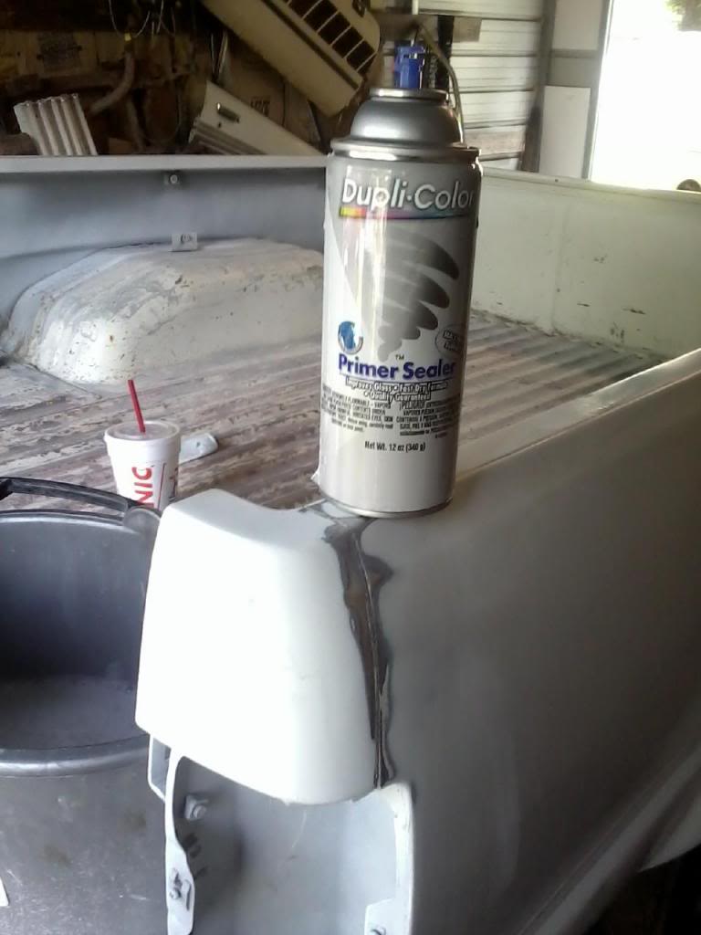

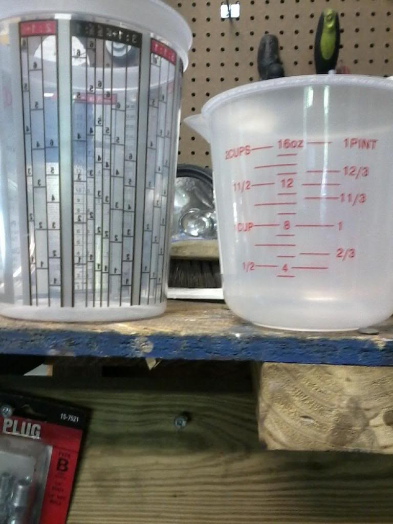

I am waiting on the sealer to dry. I only have a few flaws to take care of. One was where I bumped my head on the rear fender trying to use up the excess sealer on the fender wells. Doh!!! It will wet sand out. The white dot on my forehead should wash off easily enough. Just hope I dont forget about the dot if I need to run to the parts store.
You get mixing buckets when painting. To complicated for me to figure out. Jason suggest measuring cups when we did his runner. Soooo much easier. My mixing is 4:1 on sealer. 4 onces of sealer to 1 ounce of activtor or 8 onces of sealer to 2 onces of activator. Cheapy mixing cups are the way to go.

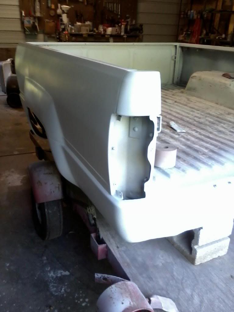

Drivers side in sealer. Should be painting here in a couple of hours. When I start painting, I will have the floor wet. Last time a soaked thre sets of shoes when painting. This time I have rubber boots.

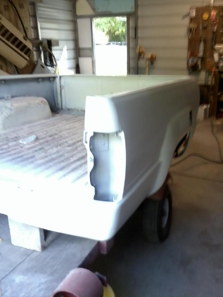

Tailgate and gas cap cover in sealer.
Passenger side in sealer. The inside of the bed is to rough to clean up. I tried, but a roll on bed liner should make a big difference. Will do the side panels a little later on. It gets crowded with everything all at once. Will start on cab in the morning.

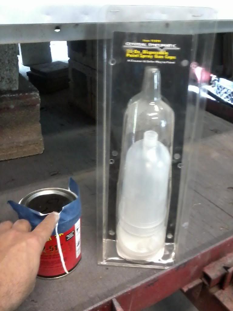

Here are the cups that I like to use. These are disposable and make clean up a snap. These are the next best thing to sliced bread. When pouring from a can, put a little tape around the edge and it pours so much nicer.
Here is a screw up I did. When doing to filling, I didnt put the body line back in. Got it taken care of now. For a quick touch up, rattle can primer sure beats an air gun.

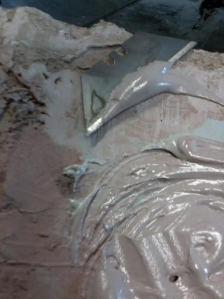

Used the razor blade to fill in a couple of pin holes. I use a razor blade as much as I use a spreader. Saves alot of sanding.
