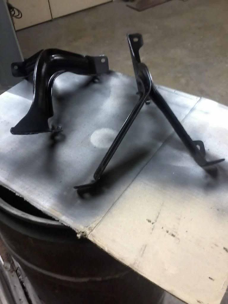

I was out camping and come home to Marks bumper sitting at the house. I will be putting his bumper brackets on my truck and his bumper on Mistys truck. Hers has always had a ding on the passenger side and when her transfer case locked up, the police had to push it off of the road and put some dings in it. I think I can take a block of wood and a sledge hammer and get her old bumper straightened out and get it on my truck.
Her truck is a daily driver so it gets the newer parts and I recycle her old parts to my truck til I find a better part later on. I am looking forward to getting Marks brackets and her old bumper on to my truck. When I got my runner it had a truck bumper on it and it looked tacky and then I was able to get a reciever hitch and still wasnt liking the looks of it with the reciever hitch but I made do with what I had til something came along. I think I can get her old one looking great for now and think either way it is going to make a big difference in the looks of the truck.
Getting parts out of Southern California or the southwest is far better then what we have access to here. I did put a fresh coat of paint on them but the orginal paint was in great shape as well. Thanks again Mark!!!
New brackets. Bumper should be going on soon.

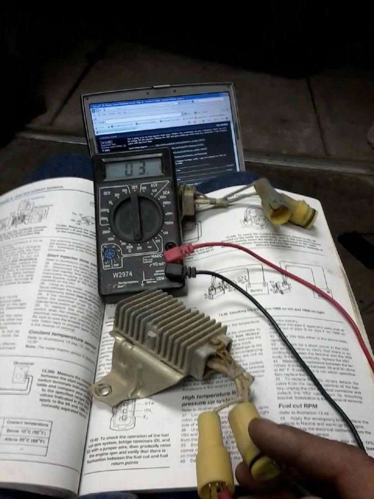

I will do some test as you mentioned. The Solenoid Resistor passed its test. Will post below. Jason mentioned to me that you can rent the light testers from parts stores. I didnt make it to the store today so will give that a try as well soon.
Old Jul 7, 2013 | 02:25 AM
  #1277
Terrys87's Avatar
Posts: 11,787
Likes: 28
From: Anderson Missouri
The Solenoid Resistor passed it test. So I will be giving some of the suggestions you guys have mentioned a try and also start looking into my fuel regulator and dampener. I have been looking at the Haynes and the FSM as well. I like having information from previous problems as a reference as to where to look in the manuals. That is my reference page in the back ground. It actuallys saves some time.

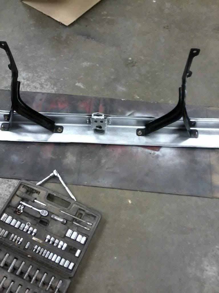

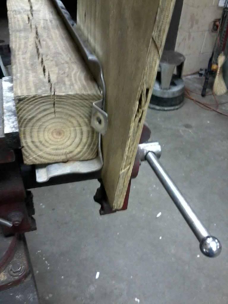

To make my yard ornament look a whole lot better, I took Mistys old bumper and got it straightened out to a lot better shape then it was. Still has some flaws in it , but far better then it was and will work til I come across a better bumper. I just did not like the looks of not having a bumper on it, but had to make due with what I had. It was starting to rust in the back of the bumper. I took some CLR, wire brush and steel wool and got it cleaned up fairly well. I am hoping to eventually get the underneath looking as good in the long run. I am hoping to get the bumper mounted on in the morning if all goes well.
The picture of me using the Big Freaking Hammer didnt turn out, but it helped to get the dents out of the center of the bumper inbetween both of the mounting bolts. Then I used some blocks of wood and squeezed it with the vise. Not perfect, but ten times better then it was. I did get the bumper mounted on Mistys. She helped and likes how much better hers looks.
I went to order my carpet today from stockinteriors.com and they had just closed as they are on east coast time. I am going to go with dark gray carpet and hope to get it fairly soon. Will need to wait until Monday to order it. I have used them in the past and was happy with their carpet.
Here is the back of the bumper. I am missing some bolts and was when it was on Mistys truck. Cant wait to see it on my truck here soon.

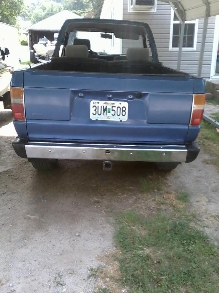

Got all excited and assembled my bumper. Got it to the house and had to disassemble it to get the brackets over the tow hitch assembly. It is not as straight as it looks in the picture but still alot better then without it. The brackets are from Mark and the end pieces are from Cyberhorn. I appreciate it guys. Thanks!!!!

ok so the resistor is good fuel filter is good pump is good WTH? that leaves the regulator or ECU you are getting good spark? AFM checks out COR relay is good... as fuel pump runs
ecu or regulator...
