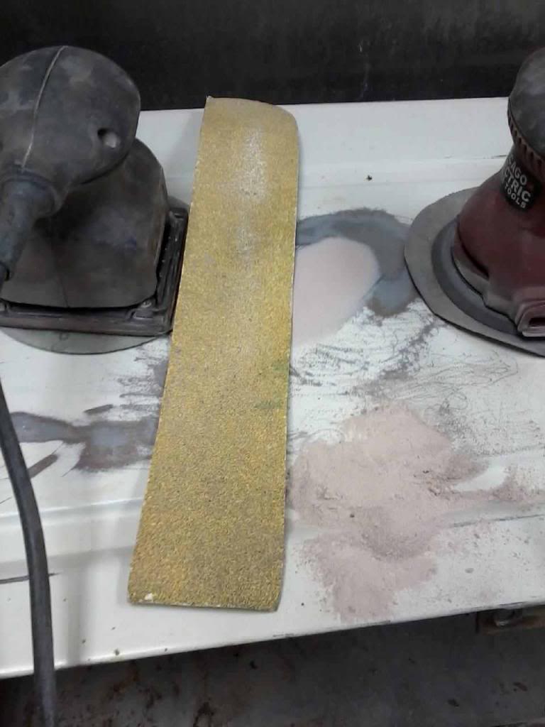

I actually started doing a little work on the tail gate but no picture worth showing at this time. I do have some air tools and if you did bodywork on a daily basis, you might be better off using pneumatic tools. I dont care for the noise of the air compressor and my compressor is too small to run the tools constantly. It works great while painting as you are not constantly on the trigger and empting the tank.

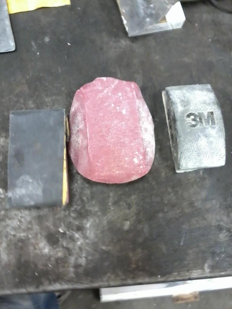

I like the electric tools better as it is quieter and doesnt blow the dust around as bad. Just about any tool that you can get in air you can get in electric. New the tools arent bad, but I have found several at garage sales, pawn shops, and flea markets. They actually last along time.
I use each tool with different grits of sandpaper. The rolls are about $35 if you find a discount place or buy online. The sticky back works great on square or round sanders. I just stick it on. If the sticky gets weak, I put a light coat of the 3M 77 can on and it is some sticky stuff. Really bites if you spray yourself and have hairy arms. So I hear,lol.

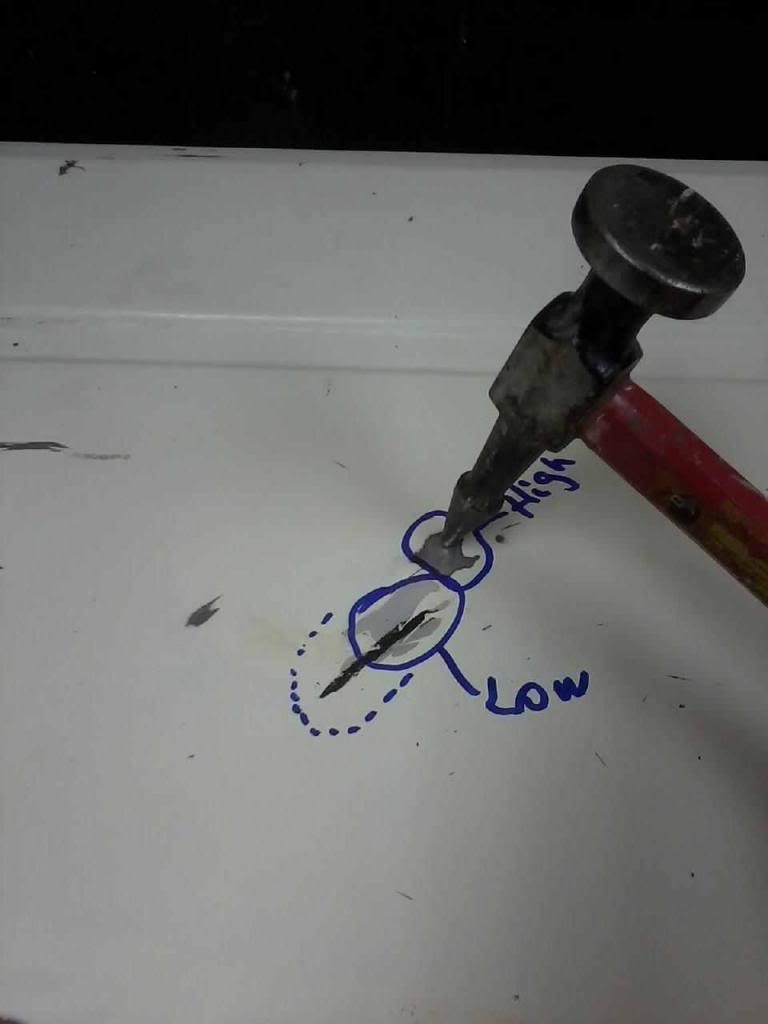

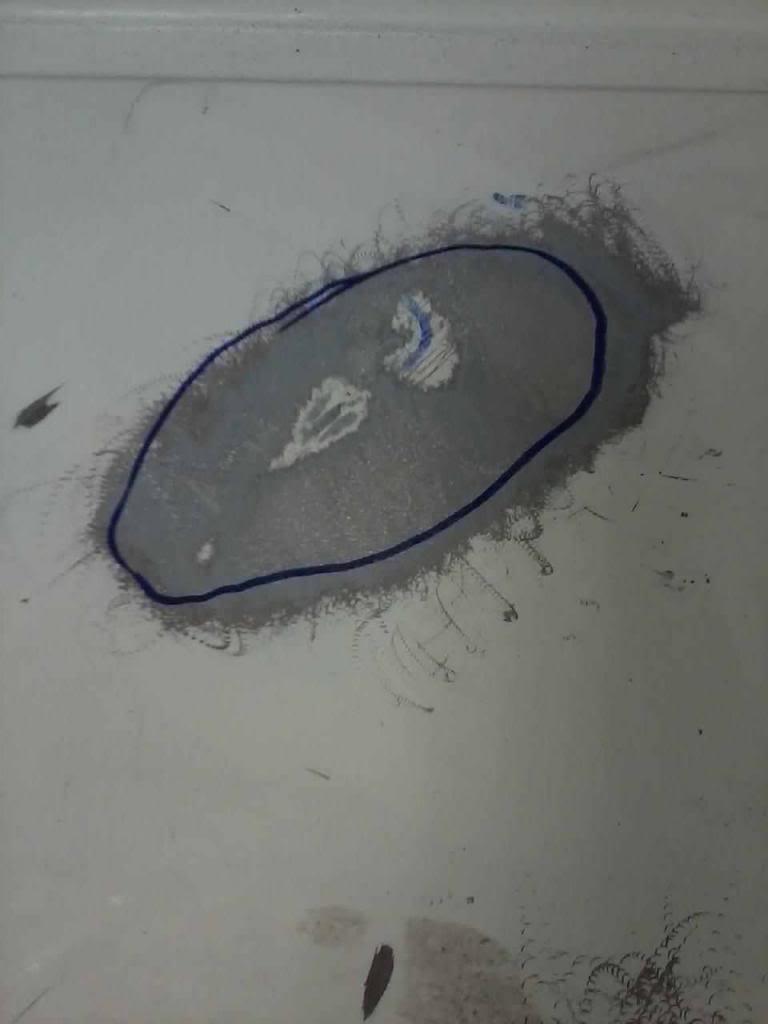

There are 3 dents in this tailgate. I couldnt get a good picture from the back side of me working the dent out but it was deep. Where the top cirlce is with the pecking hammer is to high. With just little taps I was able to knock it slightly lower to cover with filler.
Where the black line is, there is a crease. Looks like someone hit with a pole as it started as a half circle. Doesnt show on the picture but the dent is quite large.

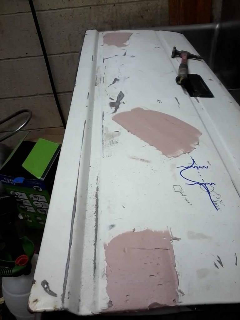

Here I took some 36 grit and got the paint off for the filler to stick. The paint shows the deepest spots. I did sand it out as well before applying filler.
To show the deepest spots and how little filler I used, it is less then the thickness of a quarter. It will look like alot of filler was used but hopefully this gives an idea of how thin it actually is. There is a large gap between the long razor blade and the tailgate if you look closely.

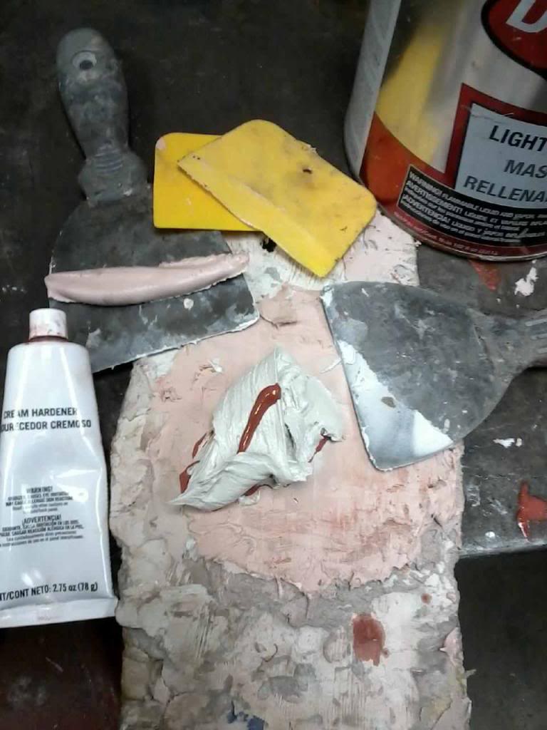

I use about the size of a goose egg of the gray filler and about 1 inch of red hardner. It is cool, I might add a drop or so more. If it is warmer tempertures, I use a drop or so less. The directions say you have about 5 minutes or so to apply it. I am alway lucky to have about a minute or two. Most will get sanded off.
After applying it, to make clean up alot easier, I scrape the excess bondo on to a yellow scraper and let it harden up on it. This was the second batch I mixed as the picture on the first batch didnt turn out. I scrape my mixing plate (cardboard) so it is smooth for the next batch. After awhile it still gets so thick, I have to use a grinder and get my mixing plate thin again.
I have heard of using a frisbee and they do sell a plate that you can mix on. The first truck I did, I just used this piece of cardboard and am still using it. I have used this piece of cardboard for over five years now so have actually became quite fond of it.

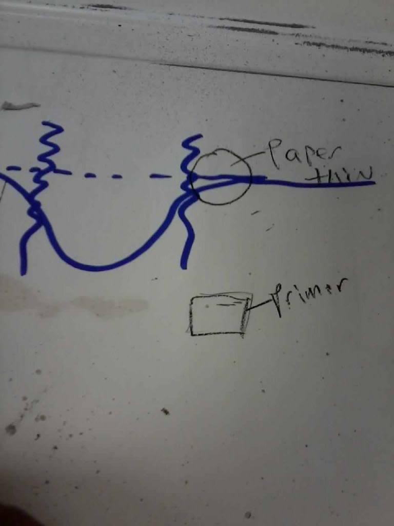

Here are all 3 dents filled. Looks like alot of filler, but most will get sanded off. The dent I showed is the deepest.
The dash line show where leve should be. To the outside of the ziggy lines is really thin. They call it feather edging when sanding it and when done the feather edge is what I would say looks more like a smear or a blur, where you cant really tell where the filler ends and the metal and paint blend in.
The little square is a shallow scratch and I will prime the whole tailgate and wet sand it off at a later time. The primer acts as a real thin filler for scratches like this one. It can not be very deep at all.

Here I used the electric tools to sand it down. I used the left sander of 36 grit just to get the rough stuff off and then went after it with 80 grit. I will need to get my long board which is the yellow strip to match the curve of the tailgate. I left it at my shop. Doh!!! but to show that if I was to prime and paint now, it would look like a big circle dent. There are still alot of steps to go to before prime and paint but to show how much filler and how much is sanded back off.

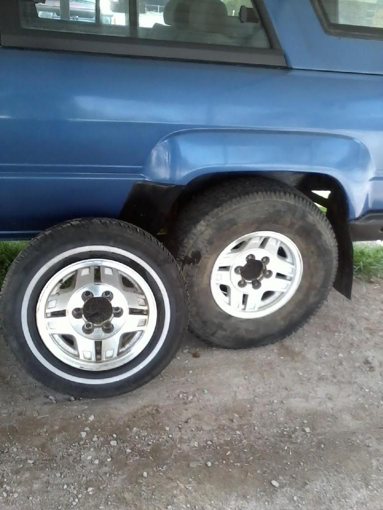

New wheel and will practice on the bleached wheel for painting and see how it comes out. I need to get a center cap for the drivers side still.

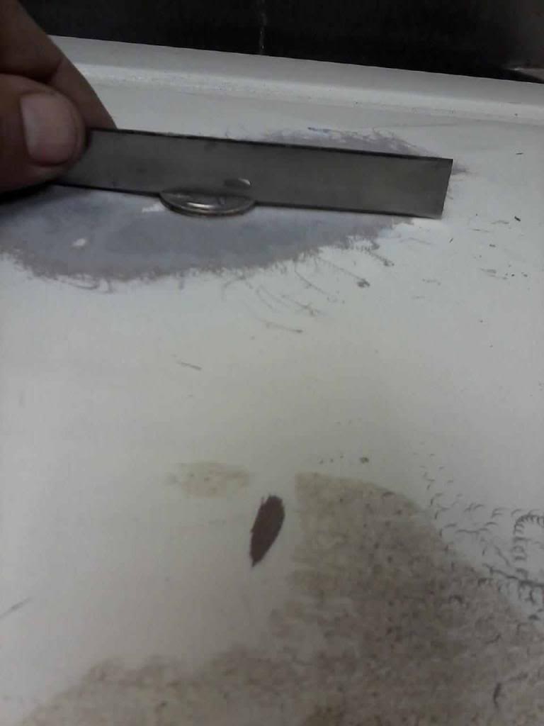

When I come across a hail size dent or a deep scratch. Using a razorblade is on of the best body filler spreaders there is in my opinion. Saves alot of sanding. Usually if I spread with a razor blade, I can go straight to sanding with 320 grit as it doesnt take long to sand off the excess.

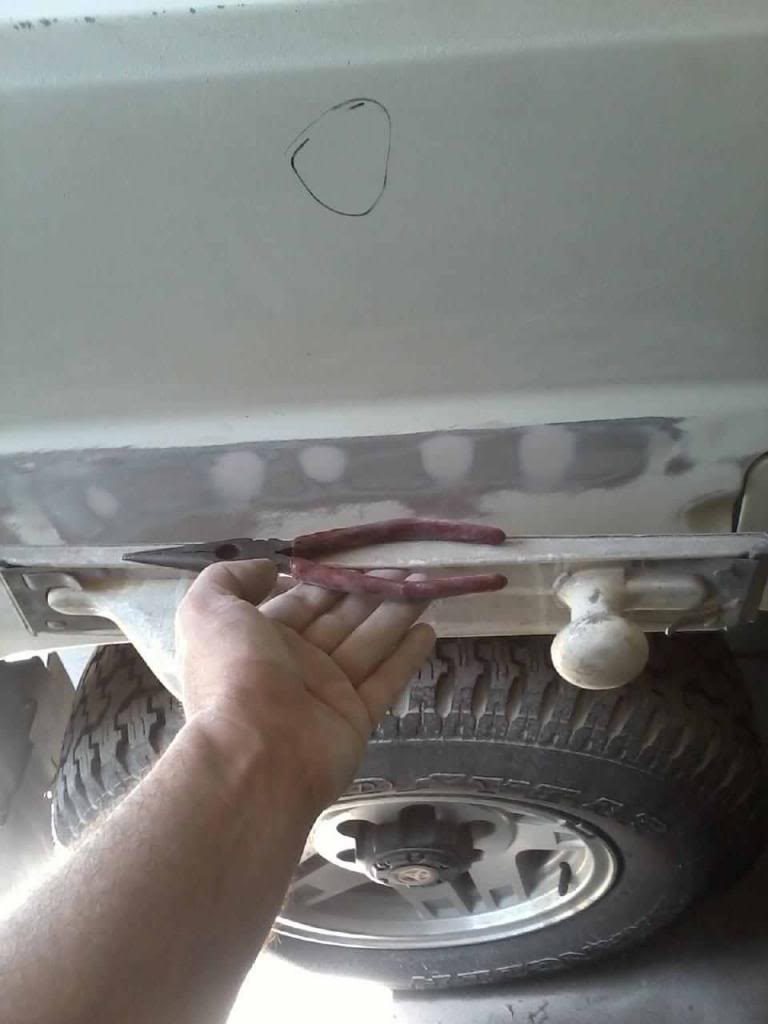

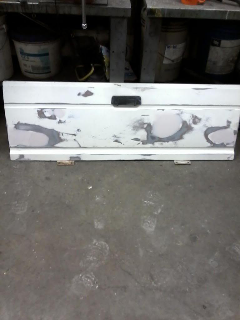

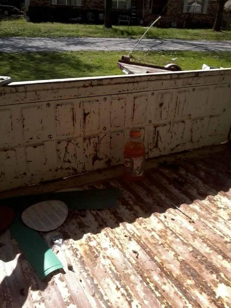

Here is the tailgate I want to use. It does have 3 small dings in it but it has no rust. I say it is in the rough stage. I still need to prime it and then I will wetsand it with 320 grit at a later time. I dont want to mix up primer for just this one piece. Wet sanding will smooth things out alot.

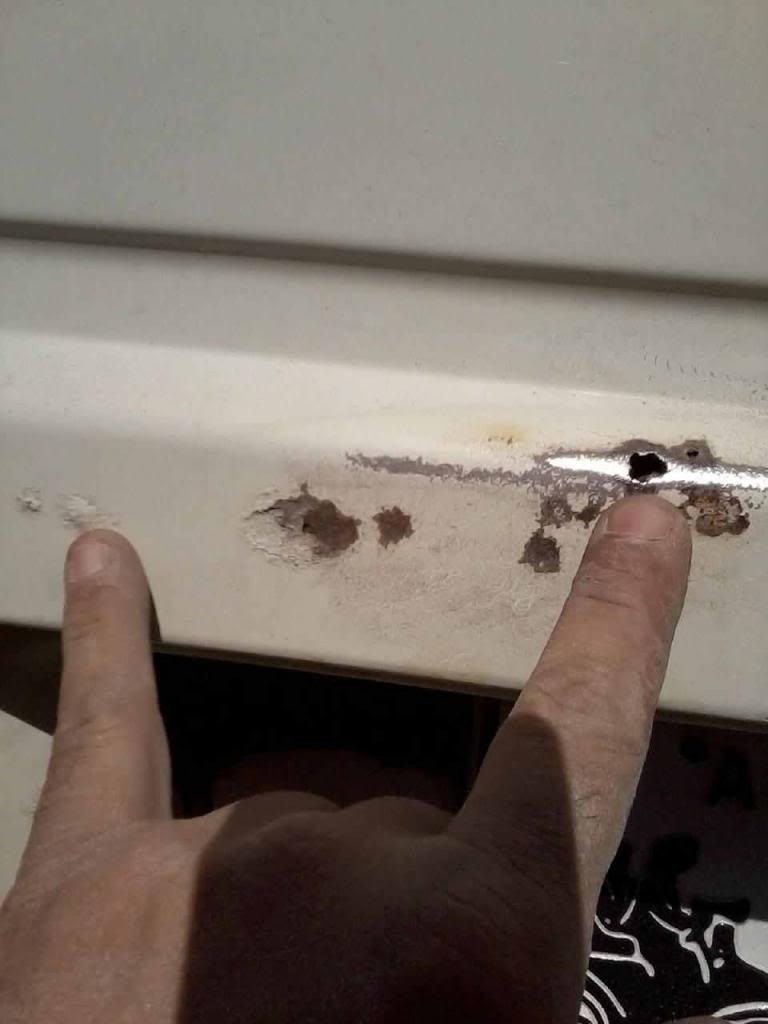

Here is the orginal tailgate. You can see the rust blisters and the holes that are in it. I sanded a blister to show what is behind it and it will be worse then what it looks like. I dont have the tools to put in a patch panel, so I would use fiberglass. Body filler over rust will only come back worse.

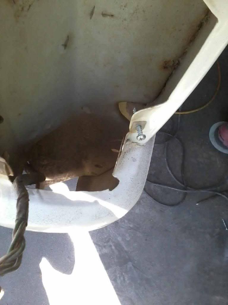

To prevent the tailgate from rusting out. Remove the top panel and vacuum out all of the debri in there. You will be surprised at what all is in there. I have worked on several tailgates and know what is lurking in there. It plugs the drain holes and then the water cant escape. When I take this tailgate off and put on the other one, I will try and get some good pice. You might be surprised. I drink the hard stuff..Gatorade.

Here I am filling in the factory spot welds. Looks like alot of body filler, but it is better then trying to do each spot at a time in my opinion.I used a razor blade to not to add the least amount as possible. Most body filler gets wasted by sanding it back off. While waiting for body filler to dry. To keep me from getting impatient, I clean shop or clean some tools I find at yard sales or where ever. Got these rusted pliers for 50 cents. A few minutes on the wire wheel grinder and they great as new.

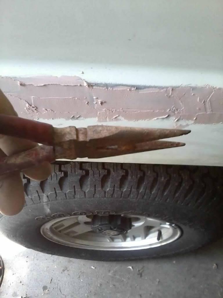

To show how much was sanded off and how the needle nose turned out. The long board will straighten alot of things out that is below the pliers.
Here is some of the sanding blocks I used. I will use the round pads on a block. The left one does have some 320 grit wet paper on it and I will use sheets when I get to that stage. I like the round pads for most of the tools I use. So much quicker and easier to change. I will rotate the pad 90 degrees to get a little more use out of it.
