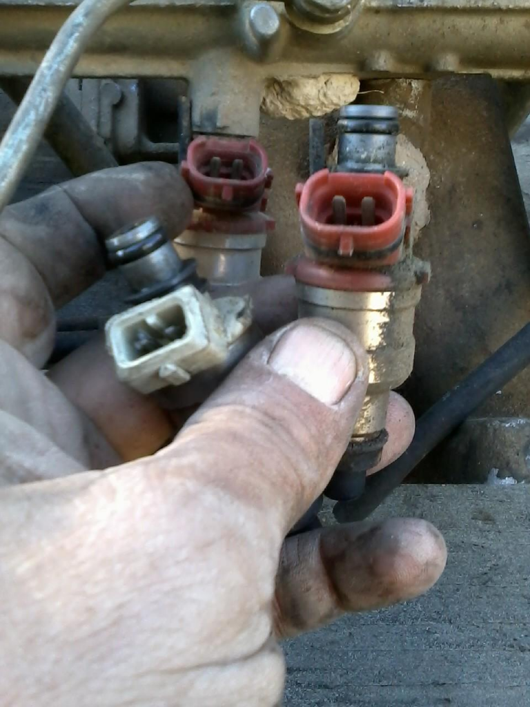

Hello kornhuskerwizard...The 88s are an oddball year. The injectors are a different in several ways,(Ohms, connector,red in color) but I do like how the connectors are on the 88s. 87 and older have a wire for a snap connection and the 88s have a squeeze tab. Since the 88s are a year by themselves, I will have to swap everything. The entire dash has to come out, but it should be an 85 body with 88 injection system. This is going to be an experiment for me to see if the fuel/tail light harness will work.

Here are the 3 types of injectors. The white one is 85- 87, the 88 looks just like the 89 and up but the fool proof tabs are different. I dont remember which one is which but 85-87 is 1.5-3.0 Ohms, 88 is 1.0-2.5 Ohms, and the 89 and newer are 13.4-14.2 Ohms. Do a resistance check to see which ones you have.

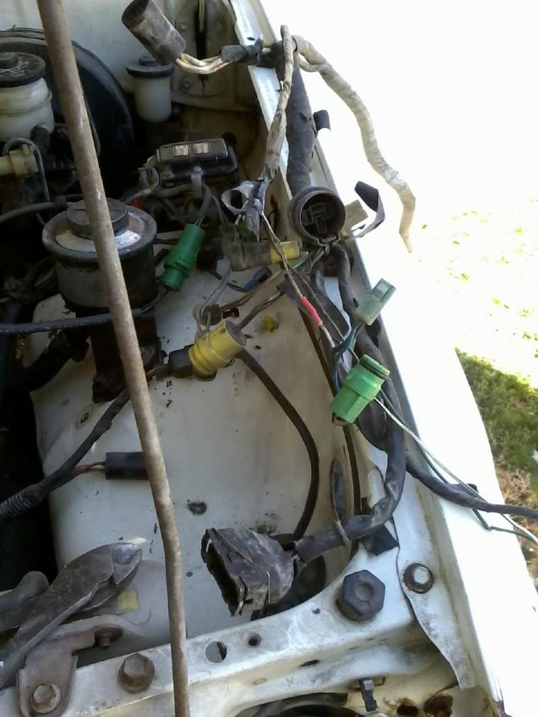

The main harness connects to the fuse box and runs under the inner fenders. I was able to access them by removing inner fenders.

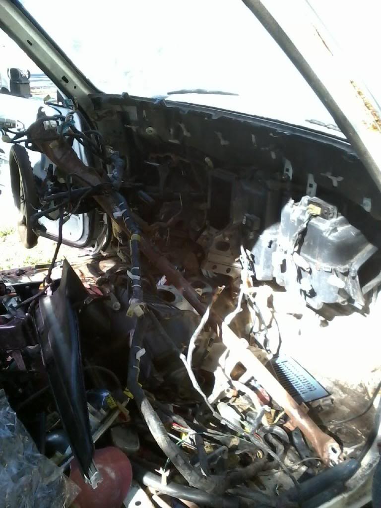

Here it is in its worse shape. Most is put back together, but changing a heater core is about the same from my experience.
