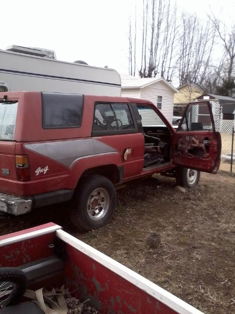

I did run into a bit of a dilema today. I was looking for where the Inclinometer connects to for kornhuskerwizard in the red runner I have out back. Marks runner is the most loaded factory option runner I have seen. I figured it would be hard to find one with all of the options like his. I think this runner is an exact twin to his.
I am a purist/true orginalist car and truck guy. That trumps my building a runner to the way I would buy one. My 86 was junk when I got it so I did not feel bad about changing colors and adding things to it the way that I would of like it to be. Having a rarer truck is over rides the desire of buildiong it to the way I like. An original truck is the hardest to find.
I brought it home and never really thought any more about it as Hunter is wanting to paint it Slimer Green/Incredible Hulk Green with 35s on it. I didnt think it would have as many options on it as it does. Today I seen just how many it has. It is missing the door panels, inclinometer, and SR5 seats. I have everything else to get it running. I would have to use a few parts off of my 86 and that would make it the 4th time it has been used as a parts truck. Two previous owners have used it for parts and I used it for parts for Mistys truck.
The other option would be to take the wiring harness and options off of the red runner and add them to my 86. The red one has a sunroof and getting all of the electric door features to working could be a task. Also 86 has round plugs and 87 has flat plugs. That means changing an entire harness from the headlights all the way to the head lights. This does not concern me as I could do it.
Another option would be to put the red runner body on my 86 frame and use my interior and a handful of other parts to get the red one going. I would really gain anything by doing that, but my 86 frame and drive train look/run great and would save me alot of time getting the red one looking as good. I wouldnt be out alot of cost going either way.
So I am thinking I would keep the red one all together and no way would I slide a 85 frame under it. I would on my 86 since it is pieced together and that would be another way of just making it unique. The 86 wont get junked. I would rather Hunter turn it green instead of one more orginal as the red one. I wont give him my 86. He will have to do all the work to get it back on the road. As of now I am still going to keep building it with the way that I have planned for it.
This is further down the road as of right now my 85 truck is the next project that will get done as I need a truck. I have plans of having the 85 done in the next couple of months. Once I get fire to the plugs, it wont take much to get it finished up.
I am really pleased with how it has started out and where I am at with it and it still brings me alot of enjoyment and satisfaction of what I have done with it. It is a great truck. It is just orginal overides custom builds in my book. Thanks alot kornhuskerwizard, looky at what you started. Just kidding. Either way I go will be enjoyable. Just having fun with you and I will see if I can find where the Inclimeter connects to.
I can only afford for myself one runner and one truck so I am still deciding which way I want to go. It will be awhile before I start anything like the above mentioned.

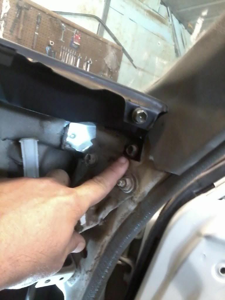

There are 15 different ways to go about and do a conversion. I decided to start installing the main harness. The harness part number is just above the steering column. From what I have seen is each option determines the part number and I have yet to see any two harnesses with the same part number. Here is where I mention about round plugs and flat plugs. 85 and 86 use alot more round plugs.
I started on the drivers side and with the boot I ran the whole harness under the drivers fender up until the boot was reseated to the firewall. Getting all of the plugs thru the hole is a bit of a chore.

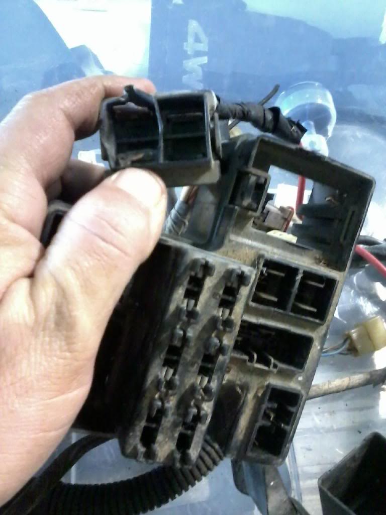

Once you get the boot in, I set the fuse box on it mounting tabs and here you can reuse the dome light plug that Toyota has kept the same thru the years. I didnt have to switch that out.

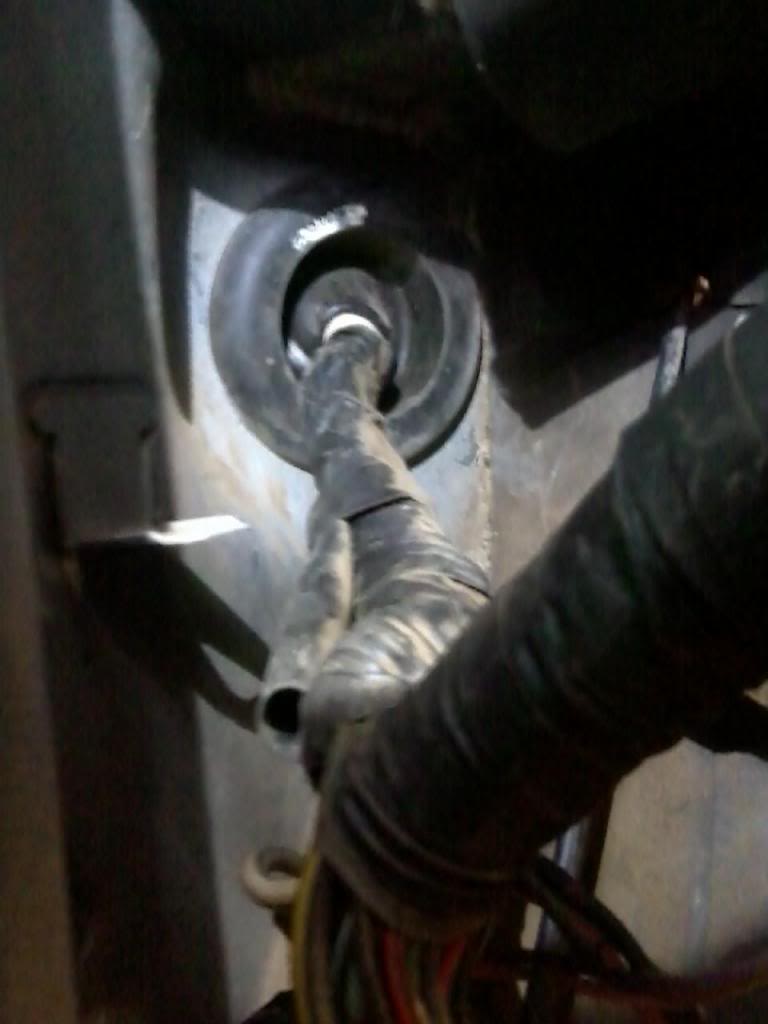

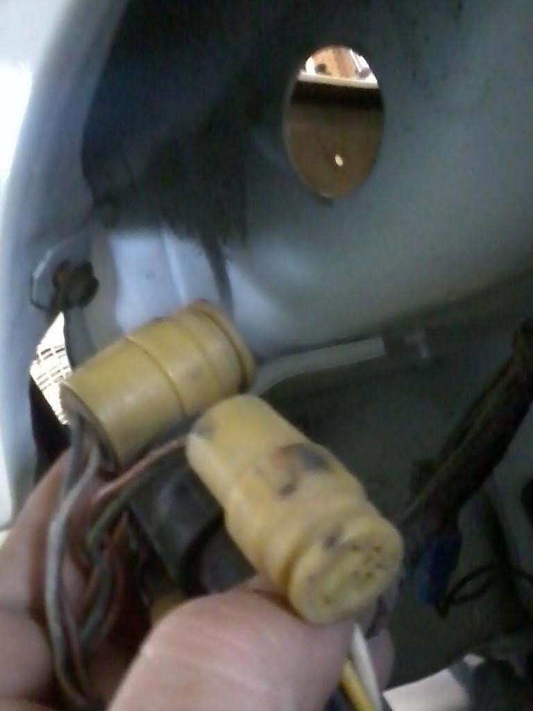

All of the plugs I mentioned earlier have to go thru this hole on the front of the inner fender. All except the blinker connections.

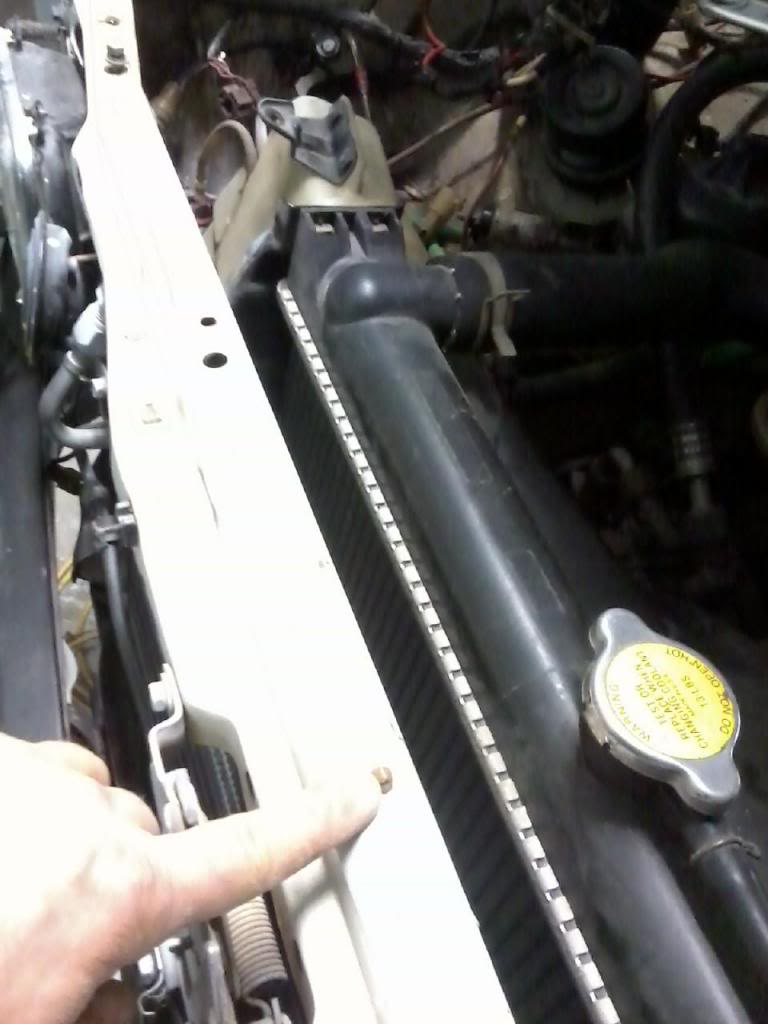

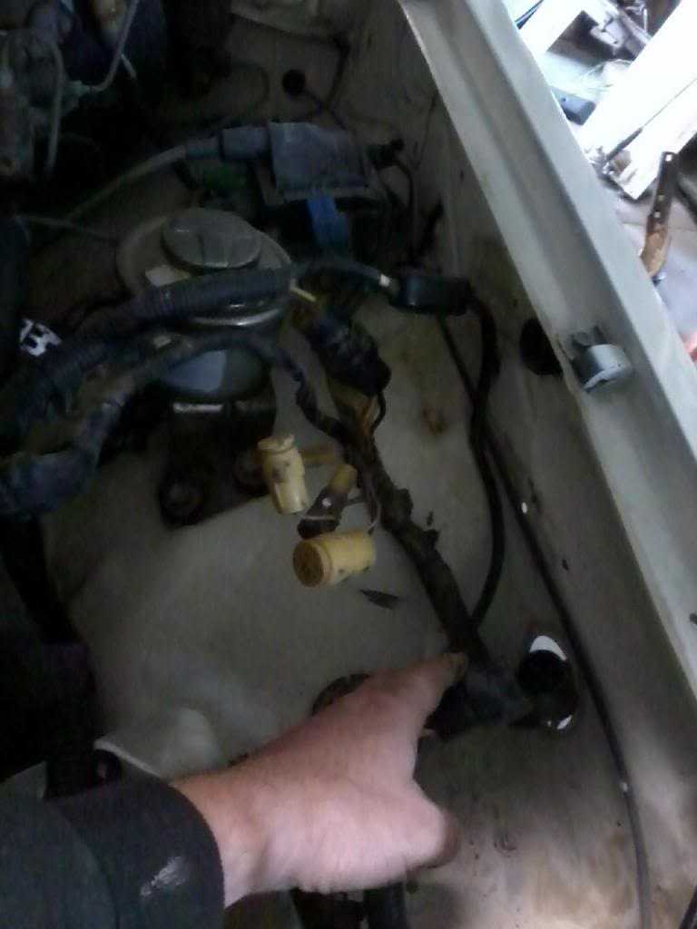

Next I ran the harness along the fender. 86 has the O2 sensor and brake fluid sensor in the same area. This is how to know you have ran it far enough. What I am pointing at is the coil for a 22r. I will swap that out later.

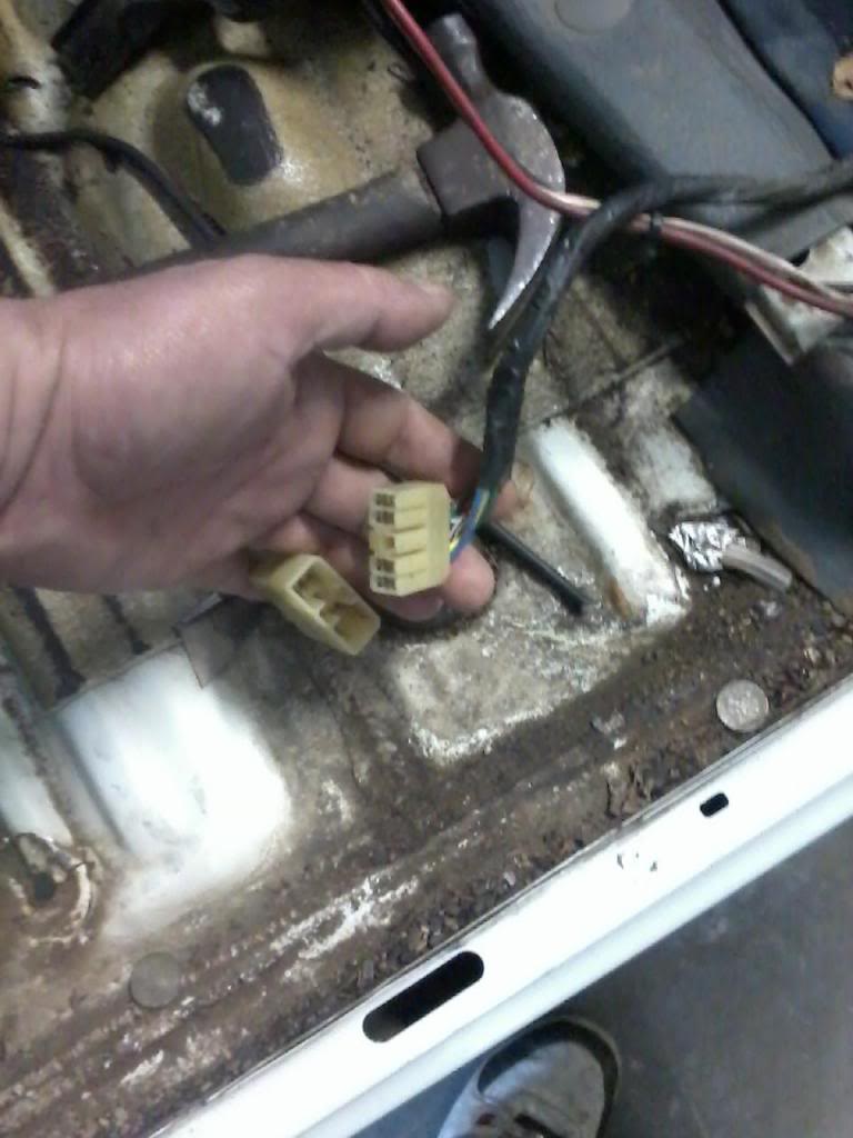

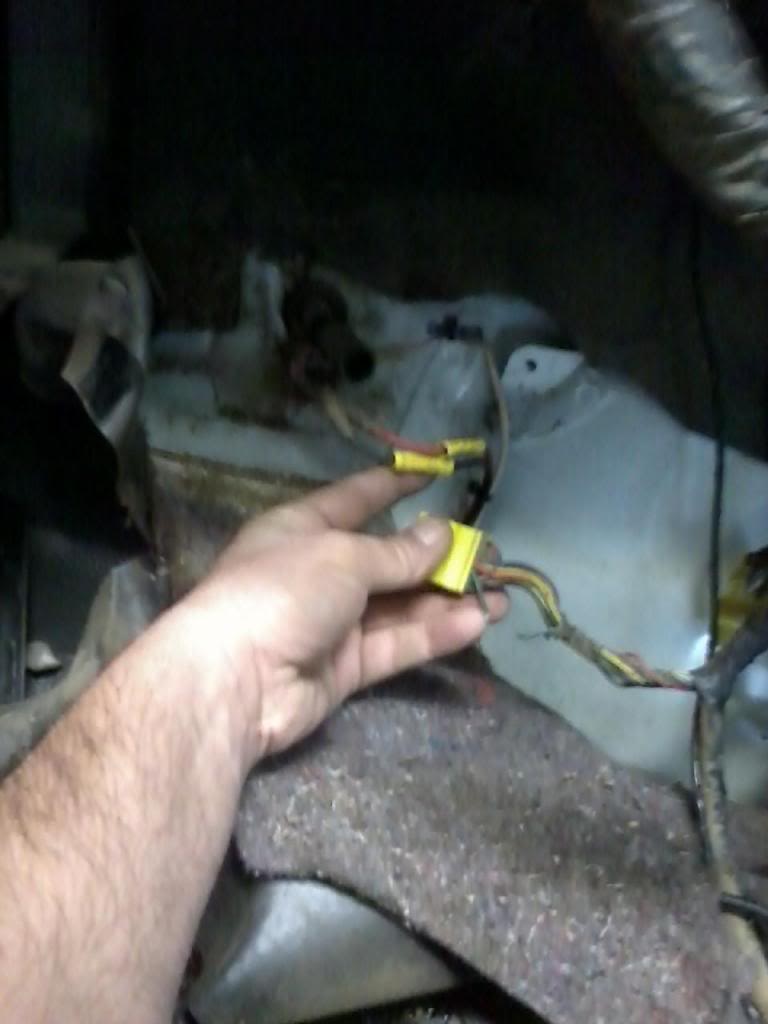

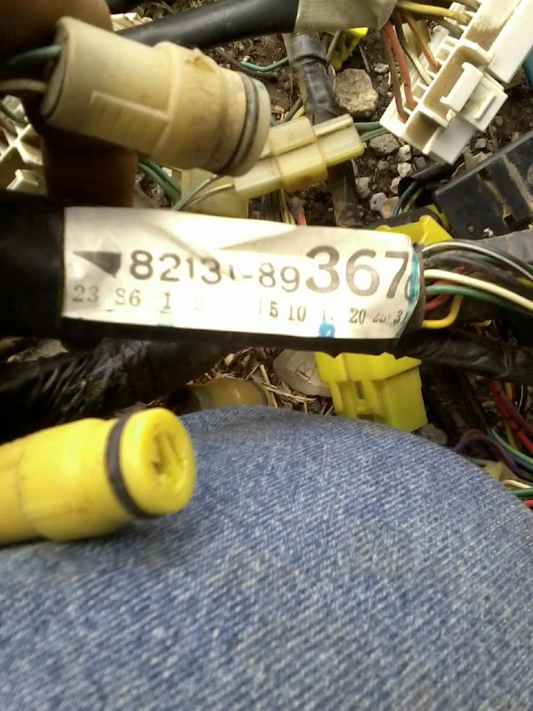

Here is the connection to the tail lights and fuel pump. It will connect but the 22r harness does not have the fuel pump wiring in it so I will have to swap out the tail light and fuel pump harness later on when I get to the fuel system. You have to change from one end of the truck to the next when doing a conversion.

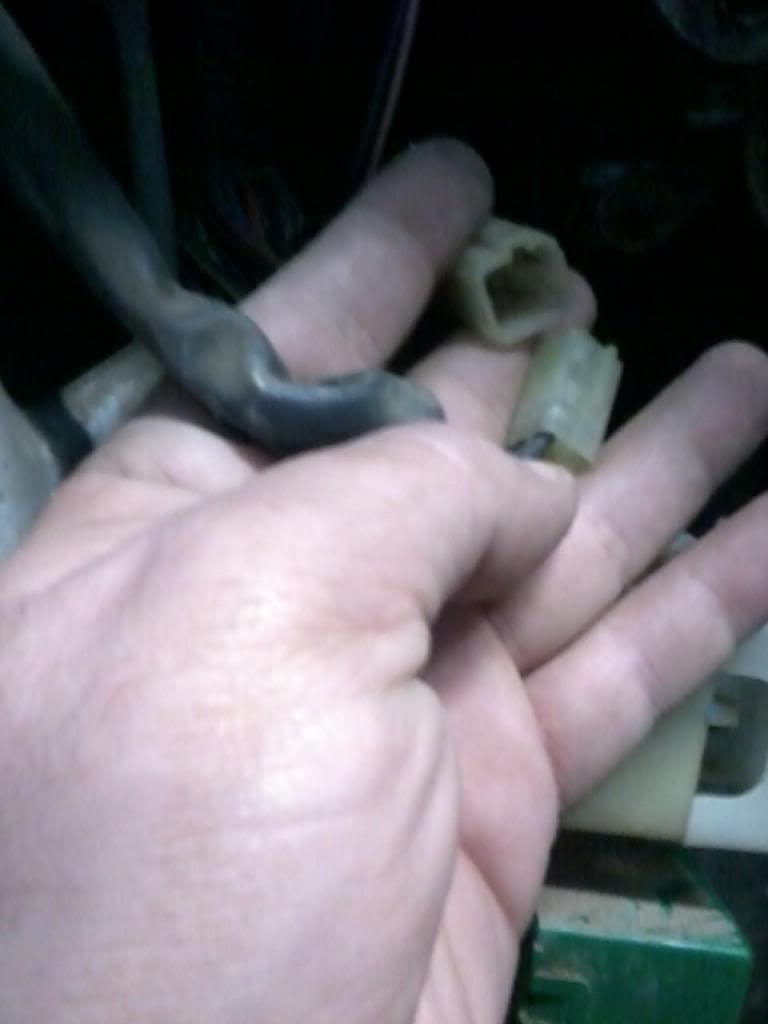

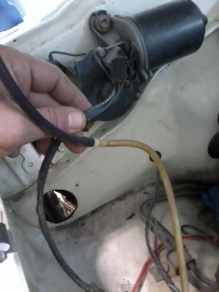

Here I ran the wiring up to the windshield wiper motor. I know the wires are mostly blue and here is a difference between 85 and 86 and newer. The wiper connector is round and the exact same plug as the Starter Relay on an 85. This will get all of the other connections in a place to where they need to be.

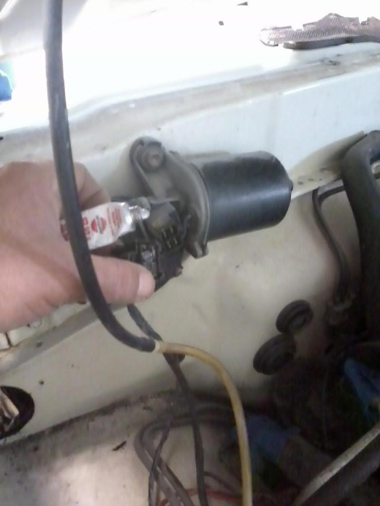

I have done alot of this earlier but putting up more just as a reminder that helps these old trucks. Put some dielectric grease on all of your connections when making them.

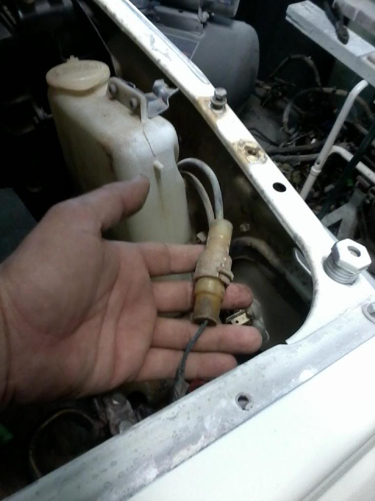

Here I am connecting the washer fluid bottle and plugs are in close proximity to where the need to be. 86 has a round plug for washer bottle, 87 and newer has a flat plug but same wiring color.

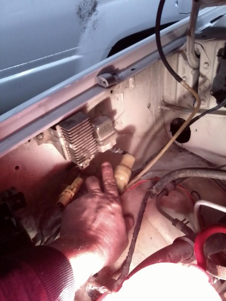

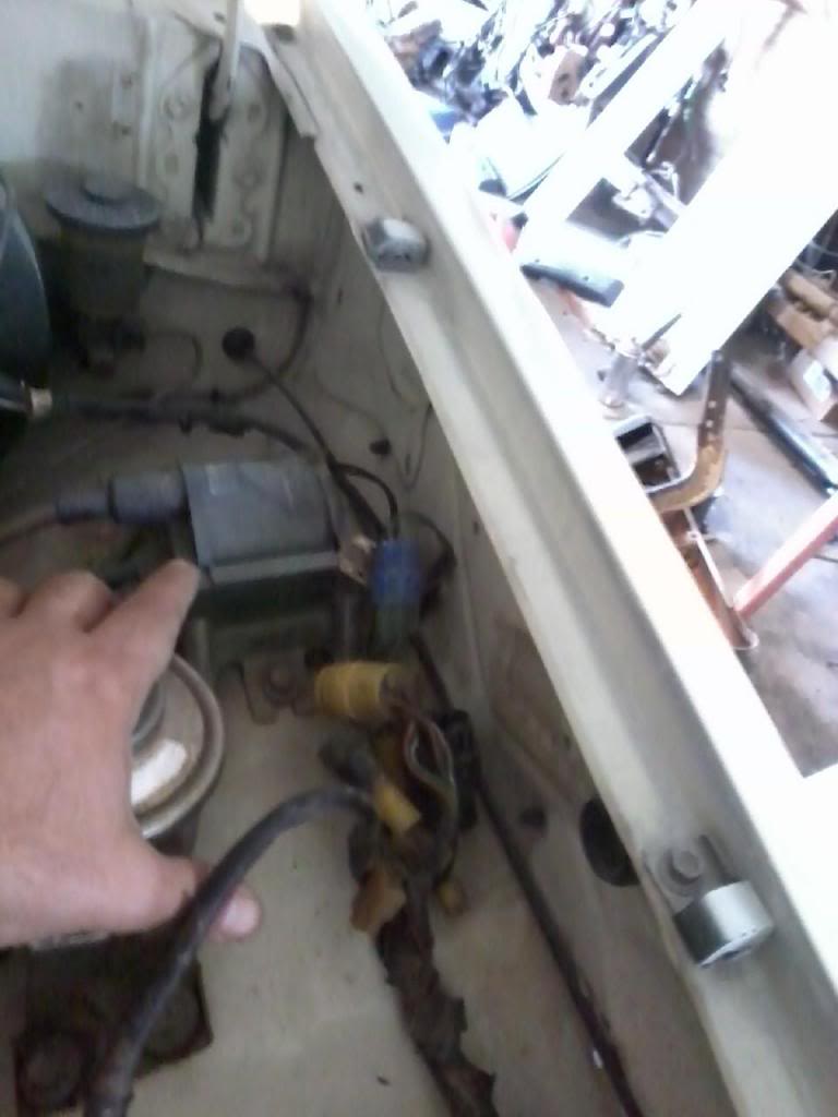

I got the head light harness installed. The brown tab goes in the center. You hav to swap the headlight harness as one problem I have seen helping someone else is the way the white wire that goes from the alternator to the fuse box and contiunes on to the heater blower connects in a different area.
Just showing some more connections. They are fool proof.
Toyota loves their grounds. I take a wire brush and get all of the corrosion off of the terminals and where they get grounded to. This one is mounted to the inner fender.
Installed Coil and Igniter.
This surprised me. Usually Toyota has all of the screw holes punched out. I will need to drill the holes out for the air box. I also do a test fitting before installing it. I learned something today that not all holes are pre punched. Will clean box up and drill holes later. You cant really see it in picture but the hole for the mounting tabs are there.

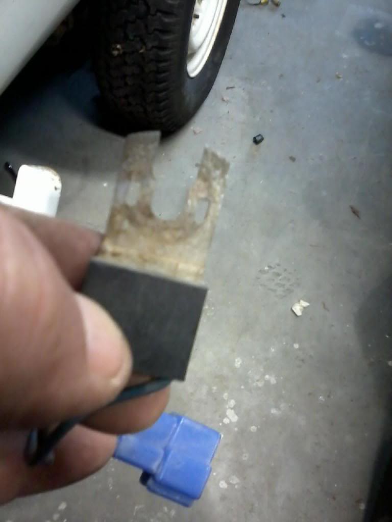

I also installed the Starter Relay and the Injector Resistor. Install the Starter Relay first as the Injector Resistor over laps the Relays tab.
Hi Terry, now would be a good time to rewire supply to starter relay...
All you need to do is:
Make sure you have the correct wire- Thick, black wire diagonally across the thin black & red wire.
Then snip!
