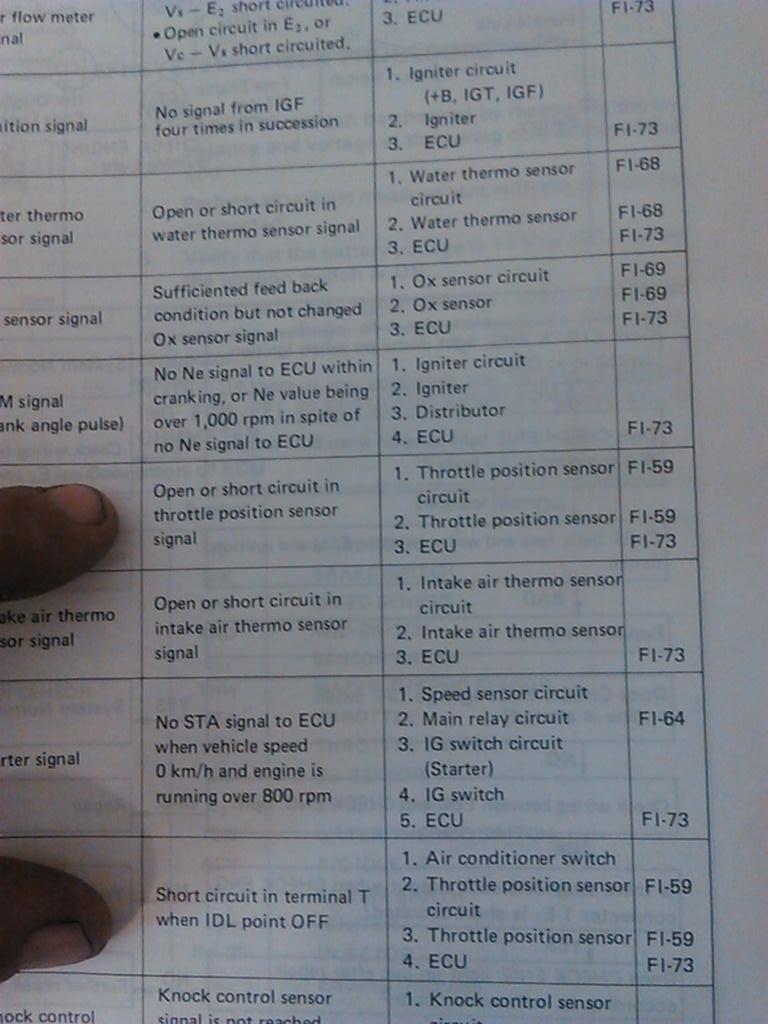

Code 7 is TPS, Code 11 is TPS and AC. I wonder if I havent been on a wild goose chase. 2 harnesses, 3 ECUs, 3 AC switches, and 5 new/old/used TPS. I have had some bad readings and that could be the way I ran some test. I dont feel real confident in some of the test and I have never had issues with a TPS.
I am wondering if the AC system is somehow causing problems, even though I have swapped switches. The FSM, Haynes, and several sites just say AC Switch, but I am wondering if it has something energized or denenergized that is causing the issue. I haven found any info anywhere to say what to look for so I am going thru the AC circuit and see what cause it to thow a Code. There is no information on the switch other then the switch.

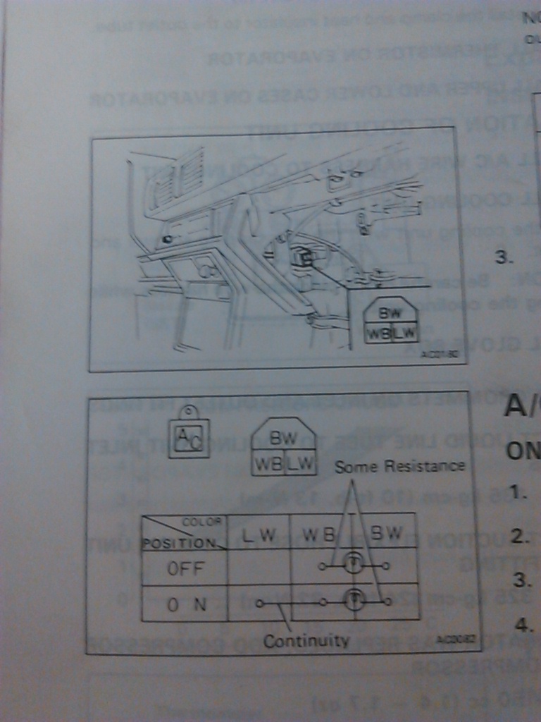

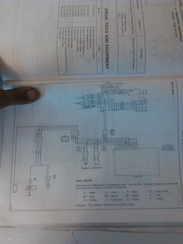

This is out of the FSM. Top finger is on Code 7 which I am not getting. Bottom finger is Code 11 which is the only Code I am getting. Have been tracing wires and other things but these are out of the FSM. Not sure why pics are sideways. Atleast the info will be out there. I am hoping Photobucket will straighten out later. Sometiems it does at a later time. It is showing correct in PB.
Actually shows where the switch connector is at on this one. Doesnt always show where they are.

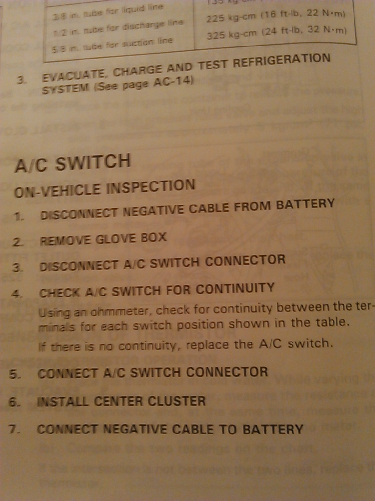

Here is the test for the switch. Very few times that I use the FSM over Haynes but sure have lately. Even the FSM says it is for advanced users. I must be getting advanced quick.lol. Normally a Haynes will get you thru but having the FSM does come in handy at times.

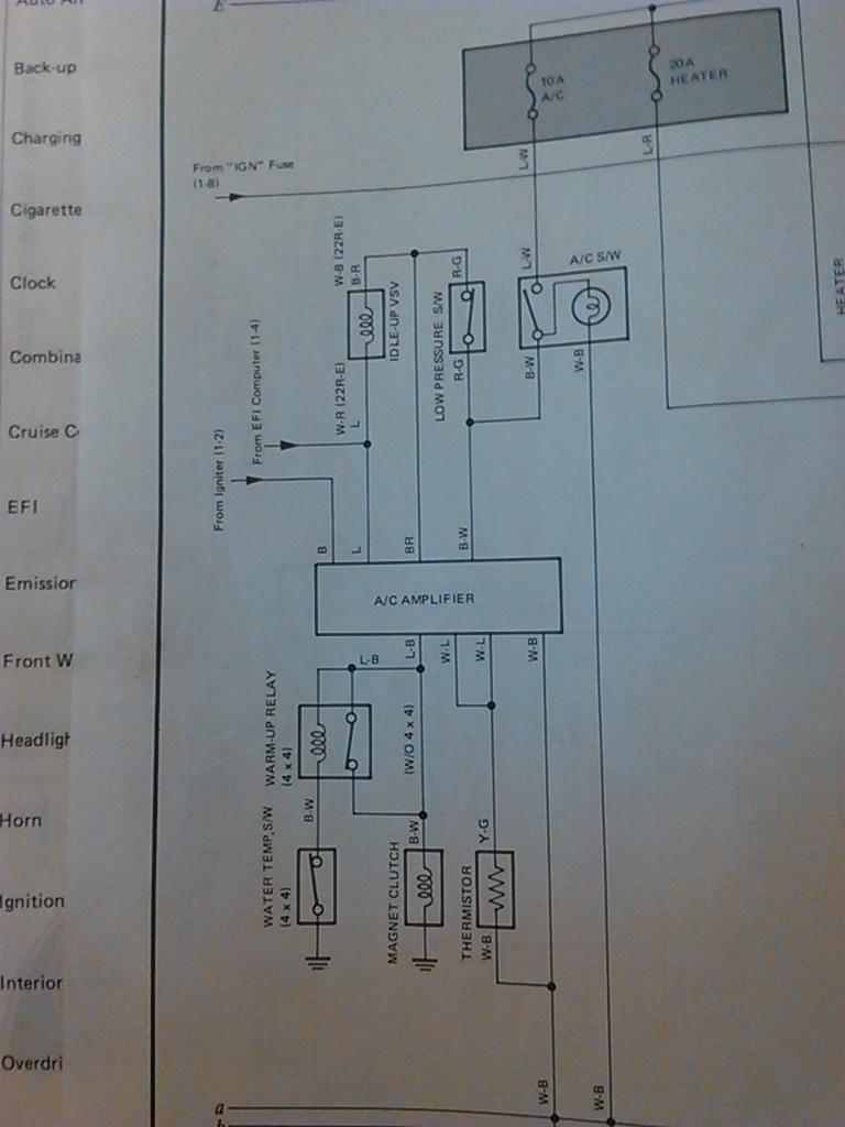

Here is the AC Circuit, like my blind butt can see something like that. At the very top of the picture is a realy. I have no idea where it is at. Been looking for it. If you click the picture, it will take you to my PB. I dont see a way of zooming in on it. Was hoping to see it better on the computer screen.

that relay is gona be either out in the engine bay or over near the ECU terry ive heard mine click even without my compressor in the truck (it is now but) but i had the doors open an music playing couldnt tell you 100% where the click came from

Hello Cyberhorn...The only relay I can find is the Heater Relay. I swapped it out but can find any test to run on it. Also it doesnt appear to be in the AC circuit if I am correct. Electric is not my strong point.
