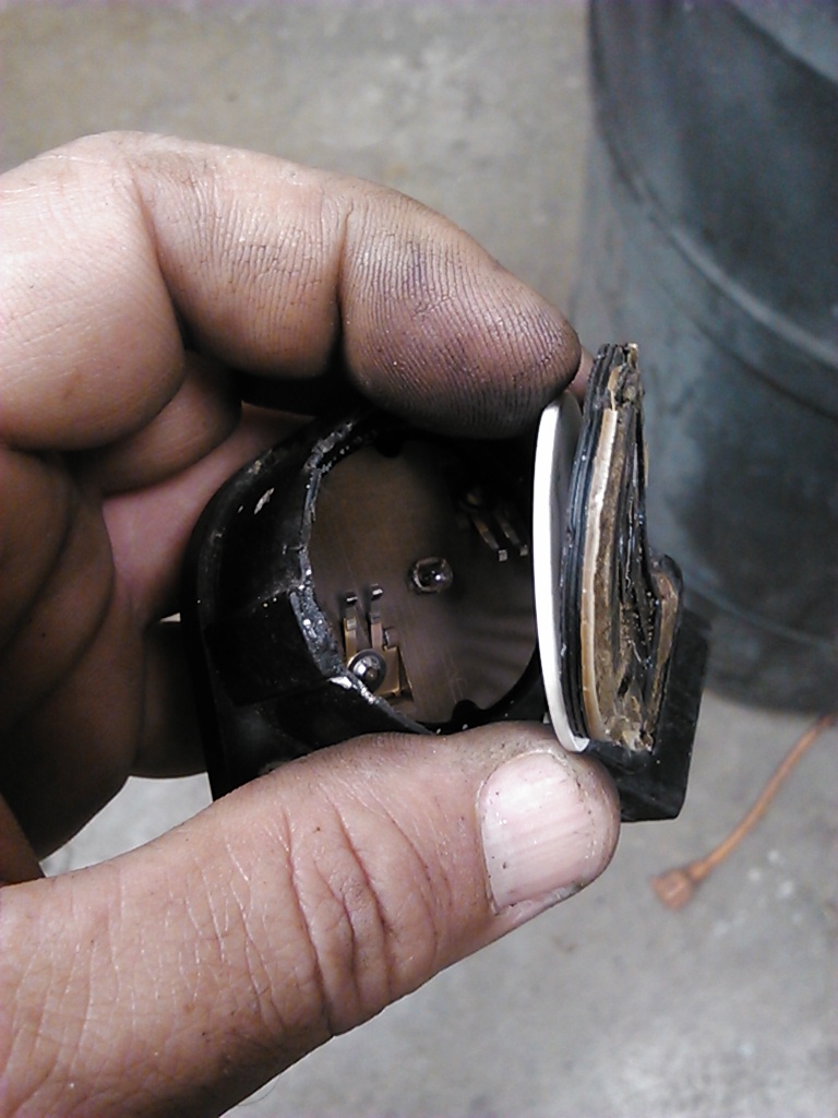

Hello junk4u... I took a TPS that I know is bad as it had rust in it and took it apart. You could possibly take one apart and clean it up. Here is a thread http://www.mr2oc.com/showthread.php?t=510522 that I went by and I will show a picture of the other side below that he didnt show.
I could tell on my TPS that it did have some carbon or something built up on it and if you look in the thread that I posted above, a goood cleaning could help. At this time I am going to order a new TPS to know I have a good one and will take measurements on it just so I know how close the test really are. It will eliminate any possiblitity of errors on the TPS. I know I am doing the test right as it is just resistance checks andmight try to clean one of the other ones I have that is just failing one test and see if it makes a difference.
Here you can see 2 sets of fingers that could use a little cleaning. This picture isnt showin this thread that I found http://www.mr2oc.com/showthread.php?t=510522 ( same one as above, but probably makes more sense to add a link here)

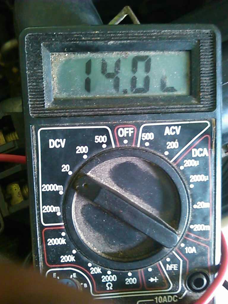

I got the alternator fixed reading 14 volts when running. Will replace it with a new at a later time.

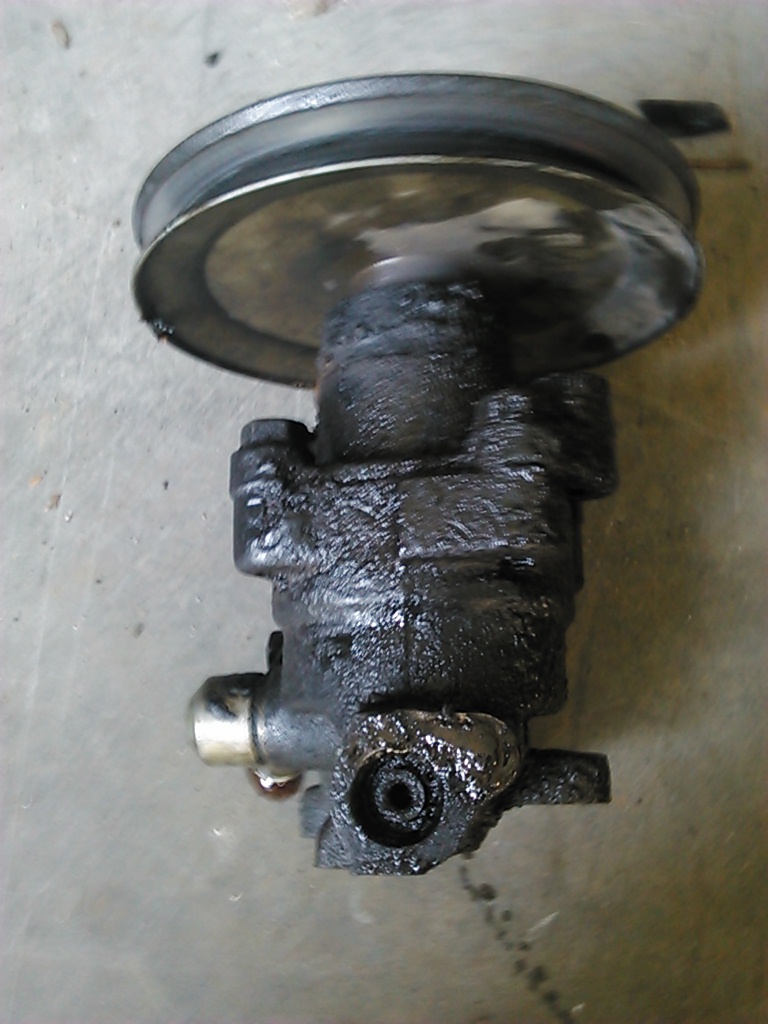

I think I found where the leak was coming from. I seen a thread last week where someone replaced the seals in one of these, wish I would of marked where it was at and replace the seals in this one at a later time. Got another pump installed.
I need to go get some tranny fluid and then comes the fun part is bleeding the power steering system. I find it easiest to raise the front tires and with it idling, turn the wheels from stop to stop about 20 times.

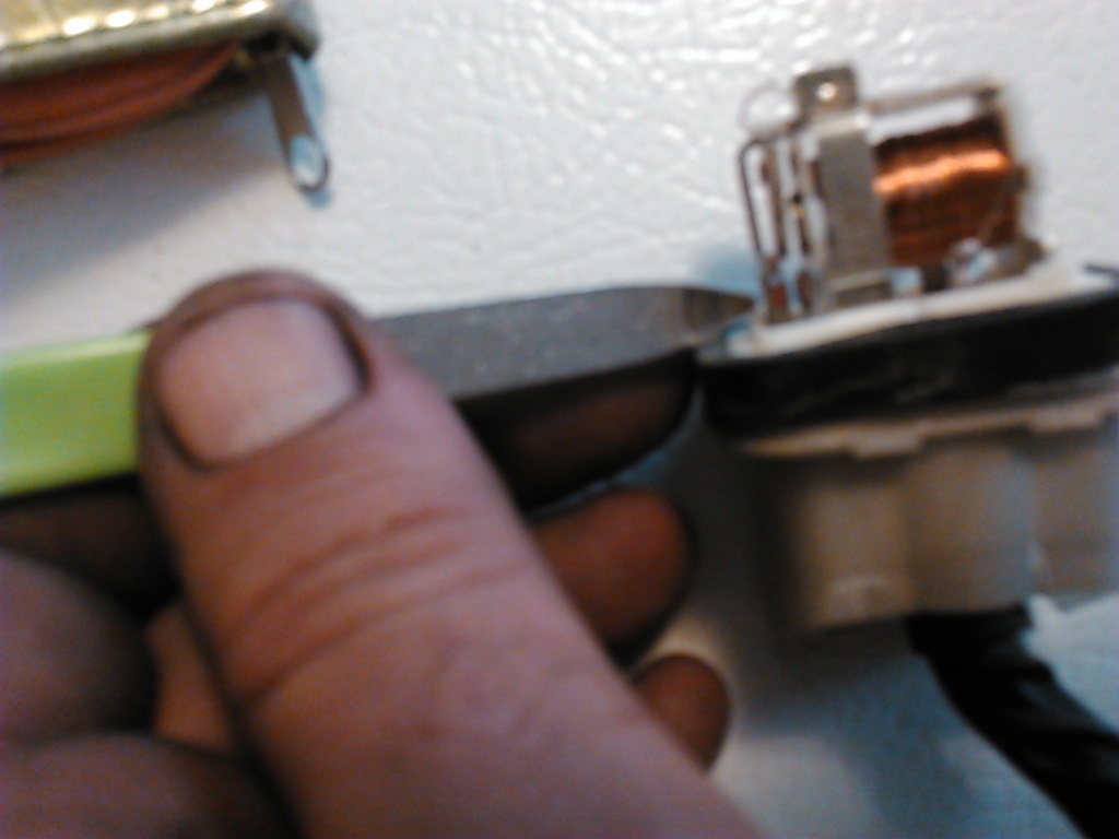

Cleaned the Starter Relay Contacts. Bend these 6 tabs that hold the cover on.
Here is the contacts that need cleaned on these.

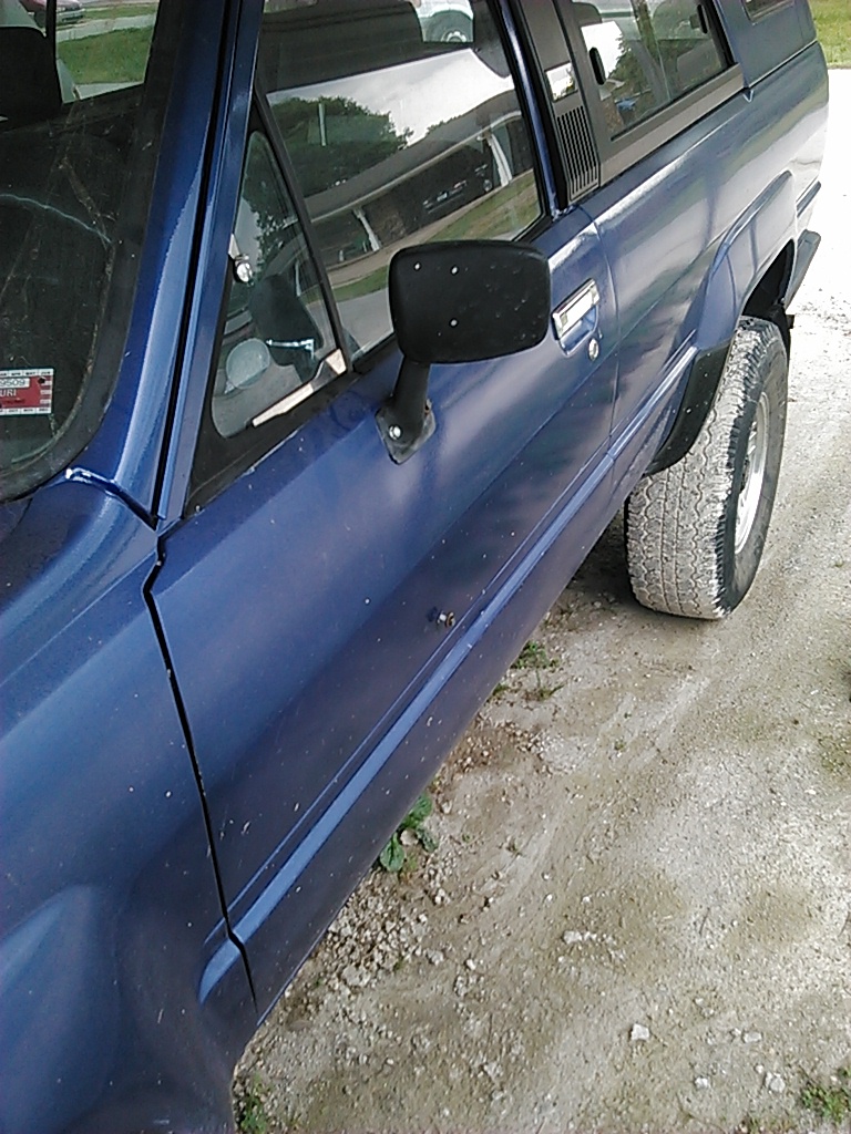

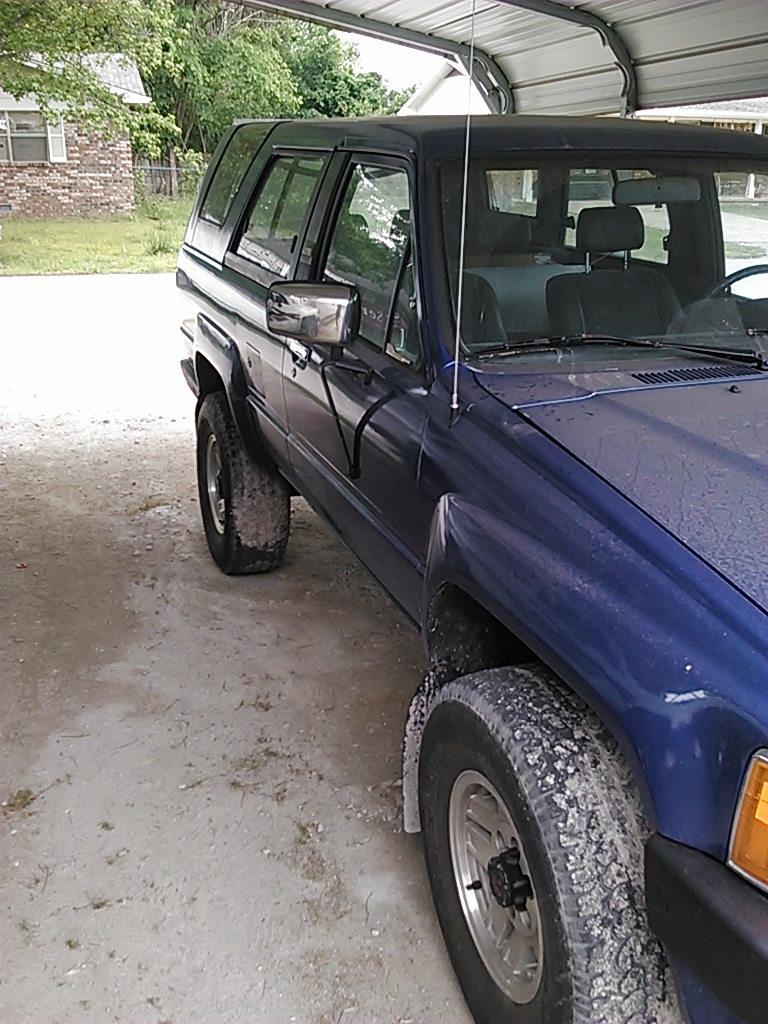

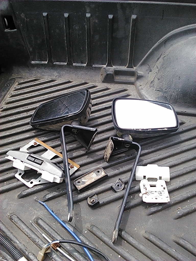

Went to the bone yard today and finally got my mirrors I have been wanting for my runner. I was starting to give up on finding a set like these. I intentionally went with the the doors that had the bolt holes in them for these. I have another set of doors that I could of installed that take the sport mirrors, but I pull alot of trailers and want these for better viewing when pulling. I also got Misty a complete map light kit as she has been wanting one in hers for sometime. One of the pieces that goes inbetween the mirror and door didnt make it from the yard to home but I will make a piece and will replace it when I find one.
Old May 23, 2014 | 01:51 PM
  #2012
Terrys87's Avatar
Posts: 11,787
Likes: 28
From: Anderson Missouri
I wanted to paint the black part up and shine the chrome up but patience got the best of me. I went to put on the drivers side and the bottom bolt is just spinning in the screw hole. I will need to pull the interior panel off to get the bolt out. grrrr...
Got the passenger side on. It went well. I will not use chrome polish on the chrome as it will destroy the finish on it. Learned that on the hard way. These mirrors are firm and adjustable which is hard to find in these. Most are broke or wobbly. I like them for the wider view as this is the one I will make my trailer pulling rig. V6 brakes are coming for it in the near future. There werent any V6 brakes in the yards.
Runner needs a bath. I will paint and clean mirrors later on.

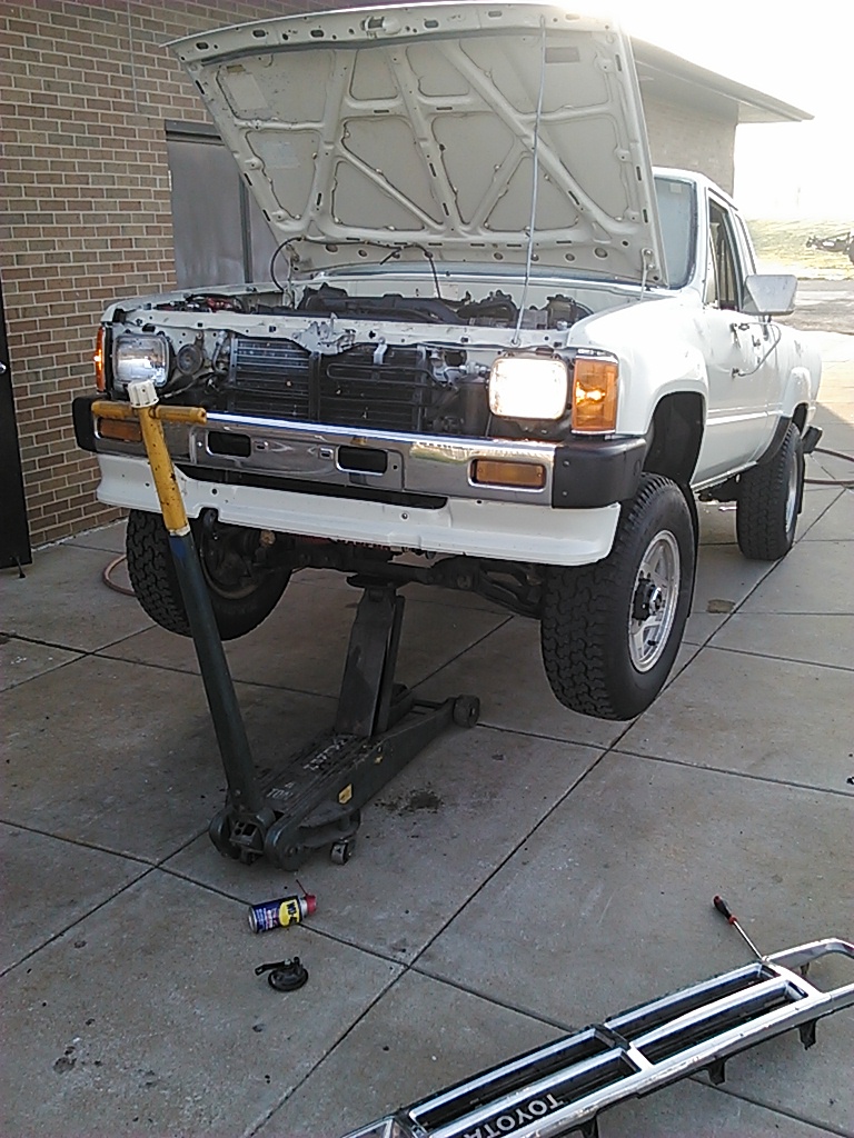

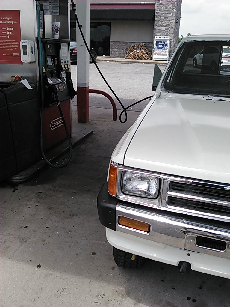

I took the truck to work and it rides great and ran great. No major problems. Got some compliments on it when I stopped twice. So much more room then my standard cab that I had. So am that more excited about getting my 85 going. I actually had to pull the seat closer to the wheel. In my standard cab it was all the way to the back glass and still felt crowded. Great riding truck and steering still feels like new.
The problems I did have is the water temp guage would not work at all. It was working the last time I drove it. I thought I did this https://www.yotatech.com/forums/f116...ge-fix-271152/ but will double check and try a new sending unit. I have a spare Oil and Water Guage I can swap into it.
Five miles from work the passenger head light went dim. It is on in the picture below but doesnt look like it, but it is. I will need to look into that. Not sure what happened but I have seen it is a farily common issue and there have been upgraded wiring projects to fix this. I will start searching for what this problem is. Worked great at the house and for 30 miles. Will check the combo switch as well.wind
The drivers door wont open from the outside, when I changed the door handles from black to chrome, those little plastic pieces can break as they get brittle. That is an easy fix.
Got the bed tighend back down, horn, swapped lights to trouble shoot. Some interior work, got wiring more secured, wind shield cowl, and several other small things that I cant think of. I am working my way to the center of the truck starting at the front and going to the back toward the center.
No leaks!!! Bled Power Steering, Burped the radiator system but will do it again when I install the new alternator and working on headlight issue. Water by jack is from it burping.
