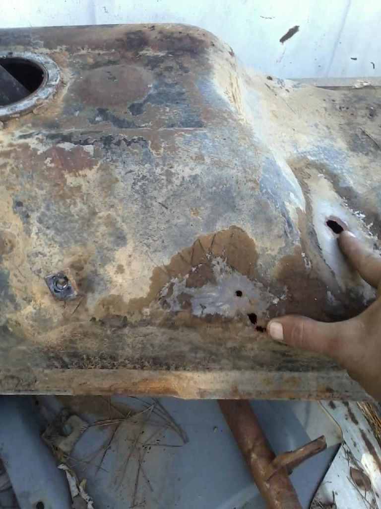

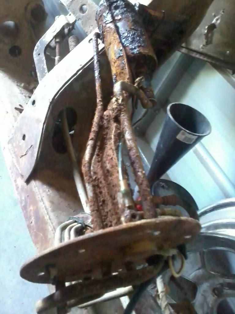

Just wanted to post some pics of a gas tank out of the 87 truck I recently stripped. Cab was rusted and twisted from some previous accidents and wasnt economically to fix. Everything else I have saved off of it. The fuel tank on this one is something I see quite a bit of. I couldnt get any pics of the inside of it, but it was typical of most. It has probably a 1/4 of rust on the bottom of it. That can be removed down to good metal and then coated. I have it listed on the first few post on this build.
The fuel pump bracket on this looks bad, but should clean up real well. The lines on it are probably clogged but I can get them cleaned out. This will be a winter project for something to do at a later time. I am sure alot of these get get tossed out, but is something that can be hard to find or expensive to replace. Alot of the lines on the top part are bad for rusting up, this one is good, but have seen then in bad shape.
The sock on the fuel pump isnt showing, but is coated with varnish and has holes in it that will let chunks into the pump and filter on the frame. Just changing the filter on the frame may just temporarily fix your problem.
The tank had about 1/2 inch of mud on top and just using a garden hose knocked these holes in it. One reason I spend as much time cleaning under my trucks as I do the top side. Just thought I would mention this as it was recently discussed. Works good for me to throw junk metal in and eventually will go to scrap. Every project I have done has either, rust in tank, clogged lines, holes in tank, or bad fuel pump/pump holder.

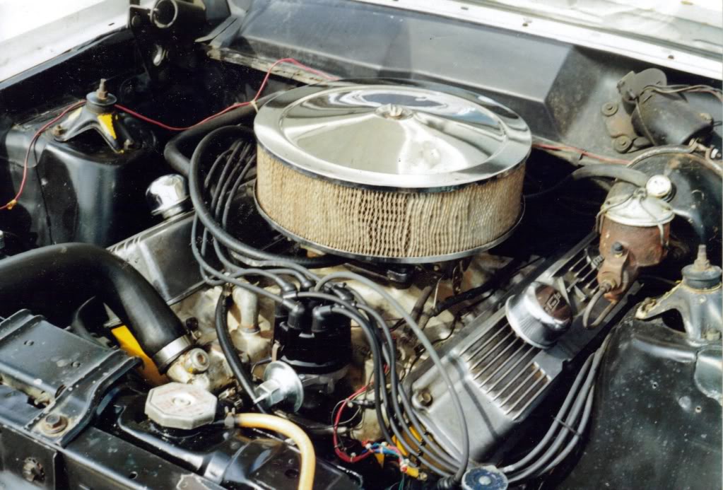

WOWOW! You sure find some crazy stuff when digging into these! Nice! BTW, Here was my Comet Capri GTA.........(can't find the other pic with my 66GT/K mustang... but I'd posted it on my thread, haha... It's somewhere in the HUGE count of pics on my PB account haha... )>>>>
And my OTHER CHERRY, which I miss more than most any of them! (38K orig. Miles from a Marine that was gifted this by the Core in 70! He never drove it hardly, and he was stationed in Victoria Falls... had the Brass Stamp on the back of it still that said "Victoria Falls" with a Marine Emblem......

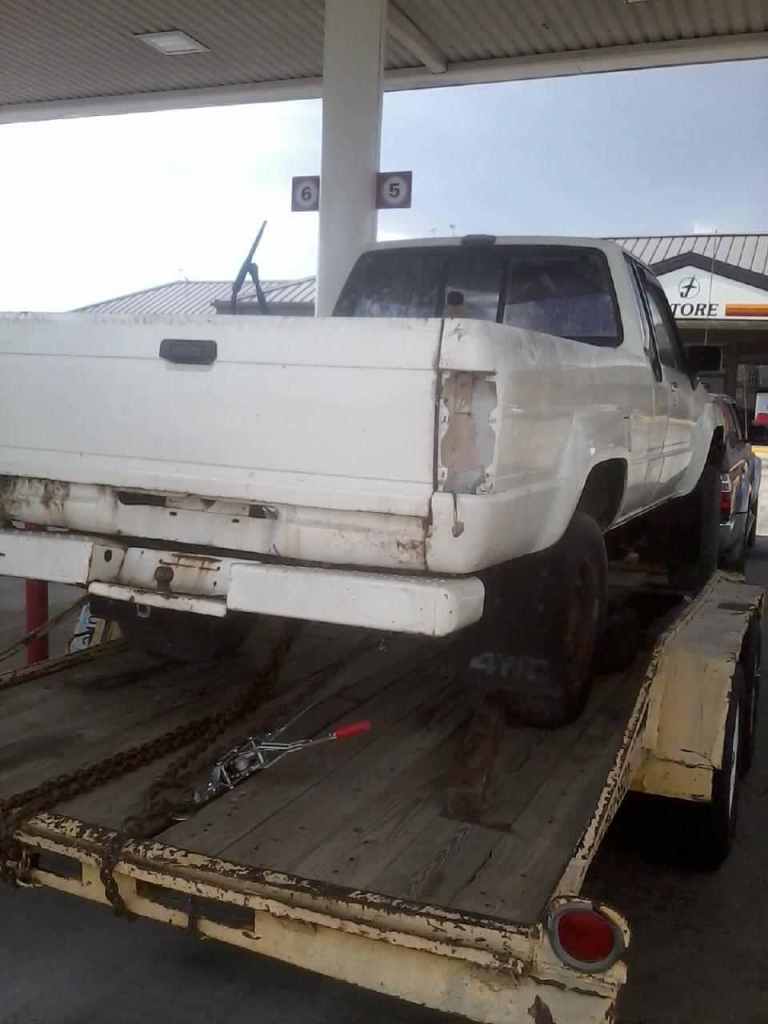

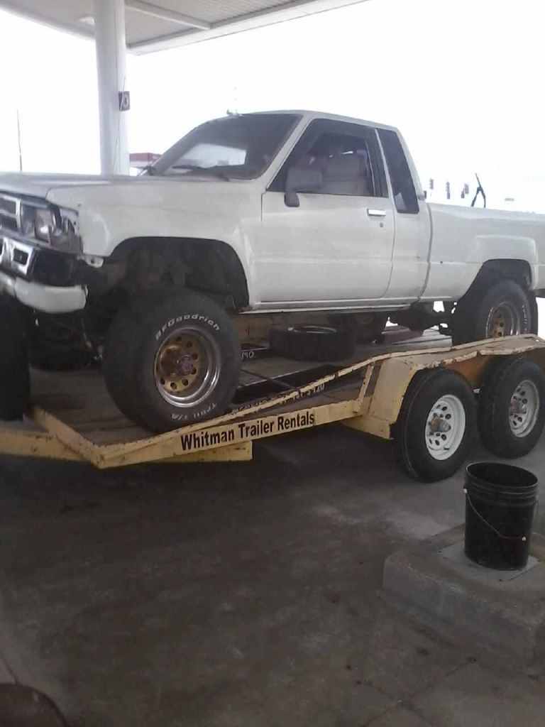

Spent an hour getting the truck ready for paint and it just got to hot. Then got the runners out and headed to the lake. Some of the other pics didnt turn out.
When I bought an 84 truck, the guy had an 85 Extra Cab he was using for parts. When he bought the farm, this truck was abandoned and he just used the parts off of it and then wanted it gone. Mostly just took the light lenses and head off of the motor. Someone has put an 89-95 dash in it. Body and frame are in excellent shape. Biggest problem is no title. See what I can do about a title later on
This truck will sit for a year or two as I want to finish up my other projects. I am not so much into solid axles, but that it makes it a rarer truck and it is fuel injected and an Extra cab. Only has a small dent in the drivers fender, a little rust in the bed, but not all the way thru, and a bent bumper. Truck is overall in excellent shape. Guy was just gong to haul it off.

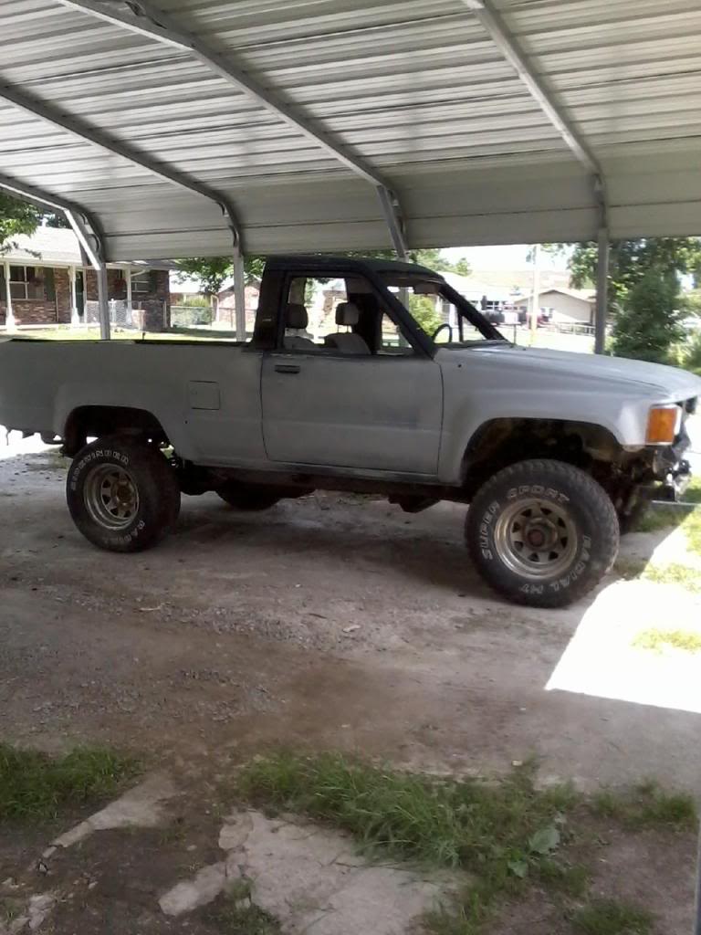

May have a dumb question, but I have an older 22r that does run, needs a small amount of work. Can you put the 22re fuel injection system on an older style 22r motor?
Plan on bring the 86 Runner home this week if everything goes as well. Long story made short, My Downey truck is going to be traded to my brother. I will be keeping the Downey bed but it is still going to have a short narrow bed on it. He wants it restored to a real nice truck. He is going to put alot more money in then I was going to and has big plans for it. It will be sharp. He wants it painted white and the engine bay is white which save me doing a color change. I do not like a engine bay not colored the same as the truck.

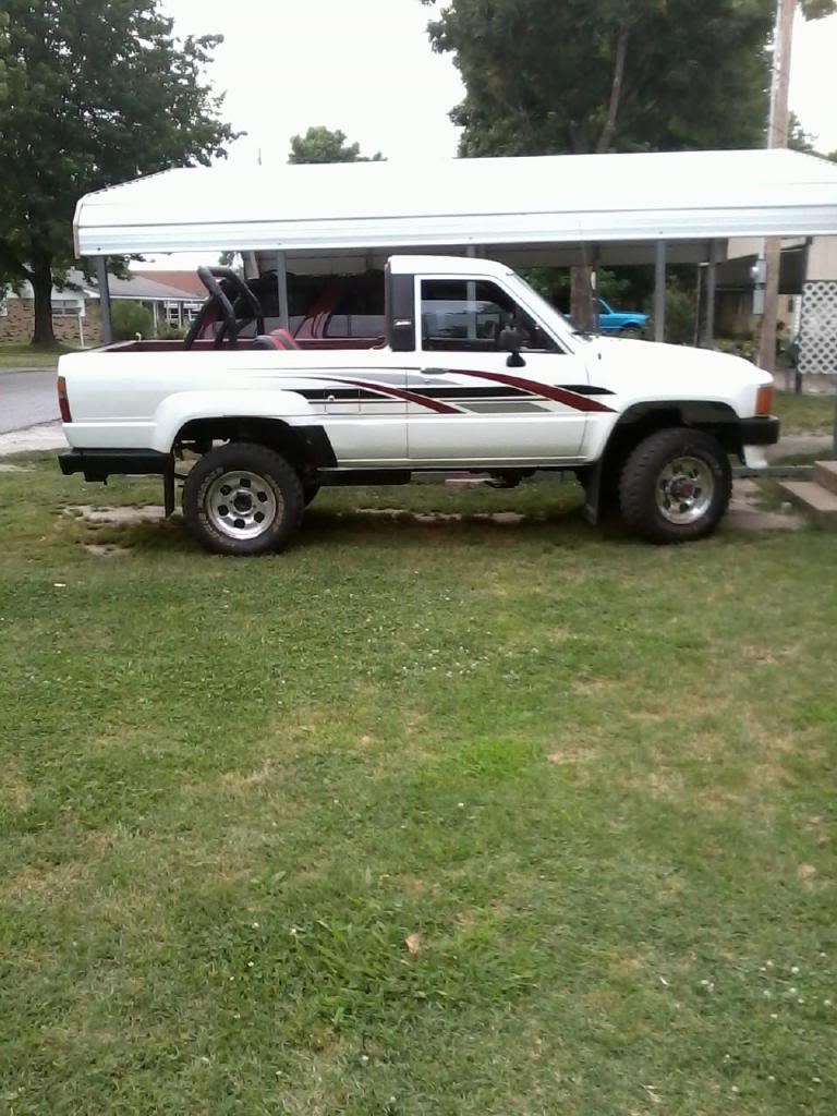

I will be down to my 2 Runners and my 85 Extended cab. I think I will keep the 85 on this build til I see how things go for now. No big plans for the 85 other to get it running and leave it white. It will be get fixed up nicer after I get my 86 runner done. My goal is to have the 86 Runner the nicest of all of my trucks and the most upgraded.
My Favorite and will get done soon. Closer then it looks to being done.
Mistys truck. She goes back to work soon and is wanting alot more done to it. She is saving for a Can-Bac top, wants me to get her Bull Bar on and is wanting a lift on it. She has other plans, just dont remember what they are.
Will be my Daily Driver and get fixed up but not as much as the runner. Pretty much just stock. Mostly needs motor and carpet and new dash. Should make a nice looking little truck. This is the day we brought it home on July 27th.

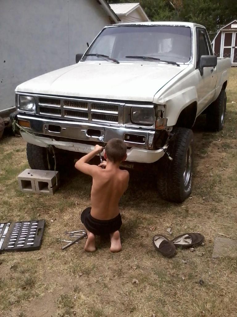

Here is the first project that Justin and me did today. I am going to straighten out the bumper as best as possible and will order 3 bumpers for 3 different projects at later time. It is jsut to hot to work in the shop so we tinkered with the 85 today. I am going to make myself get something accomplished again on a daily basis.

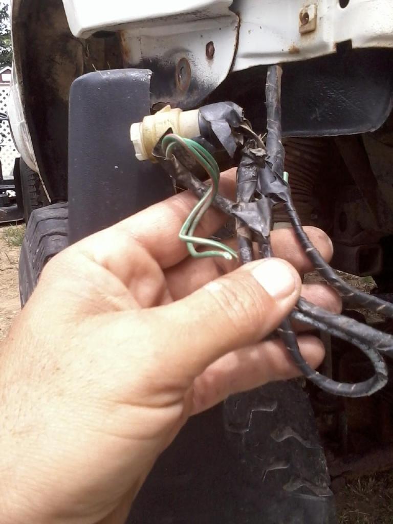

Of course I cant have any project without some kind of poor workmanship from a previous owner. I will get the wires repaired right. Just dont understand why the jury rigging.

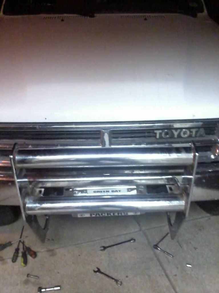

Here I am trying to get a Bull bar for Mistys truck. It came off of an 84 but doesnt want to go on. I have a few other ideas that I want to try. Must because of the difference between an IFS and solid axle. It is an ich off from the top of the bumper to the bottom of the frame.

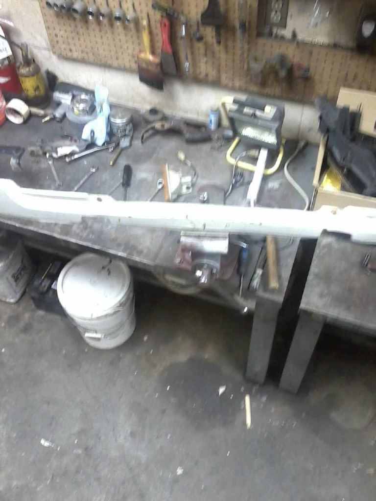

Here is the valance I straightend out that Justin pulled off. 100 times better then it was. Just used a vise on the edges and made a big difference. Will replace at a later time. Working on the bumper with some results. They dont really show in the picture but they were bent up bad.

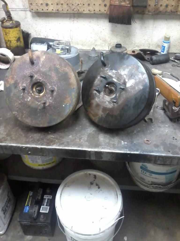

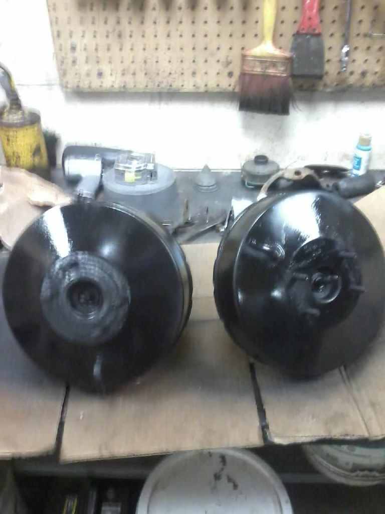

The 85 was used as parts and is missing a booster. I have two spare. Just cleaned them both up just incase one is bad. The rusted one seems to work better.
The rusted one is on the left. Just a little time and effort. Trying to get something done as the heat is getting unbearable.
