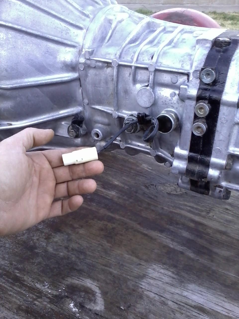

Got tranny cleaned and early on in this build, I had an electrical issue. The Reverse Light switch had rubbed a bare spot on the wire and kept blowing my Eng Fuse. Just a small knick in it. It was a hard find. So wanted to show where to look for it. Have seen this problem two other times since I have had this problem.

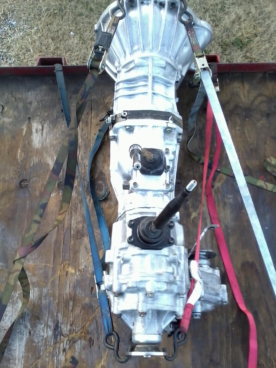

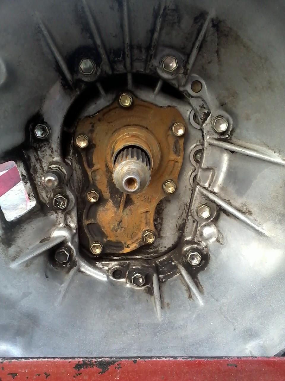

Thanks Grego92...I am hoping to have it back on the road by the weekend if all goes well. I have changed several clutches but doing seals on a tranny is one area that I have some experience on but not my strongest point. Hopefully I can find some thing that might be some useful information.
I went to Toyota and only got one seal today. They got another on order for me and I should get it tomorrow. I did get it alot cleaner.
I got the inside cleaner since I took the picture. It is alot better then what is showing and what it was. Waiting for it to warm up and want to start getting the lower part of engien bay clean and start getting ready to work on the motor.

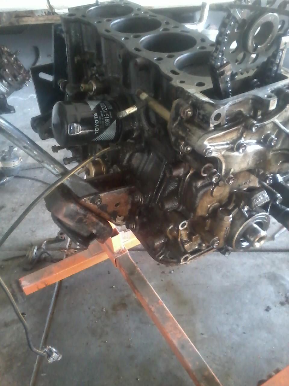

Like I mentioned to Mark, I didnt put in the valve guide seals, it would only have a slight puff of smoke once in a great while, but want to head off as much problems as possible. I want another 20 years and 300k miles out of it. I wish I could kick my own self in the butt for the mistake of not doing the seals then.
When I orginally built it I would of liked to have taken it completely out then and got the bottom end fixed then, but things were financially tight then and I needed it on the road as soon as possible.
Since I got the motor and tranny out, and need to fix the rear main seal, I decided that I would get everything done at once. It still has great compression and will run down the interstate at 80 to 90 miles an hour all day long.
Here head is off. I get my new head gasket tomorrow so I spent alot of time cleaning up the motor and getting it broke down. Had nice weather and took advantage of it as best I could. Really enjoyed the day.
Was a little oily on front, but that was from a leak at the half moon seal. From now on I am putting sealant on those half moons.

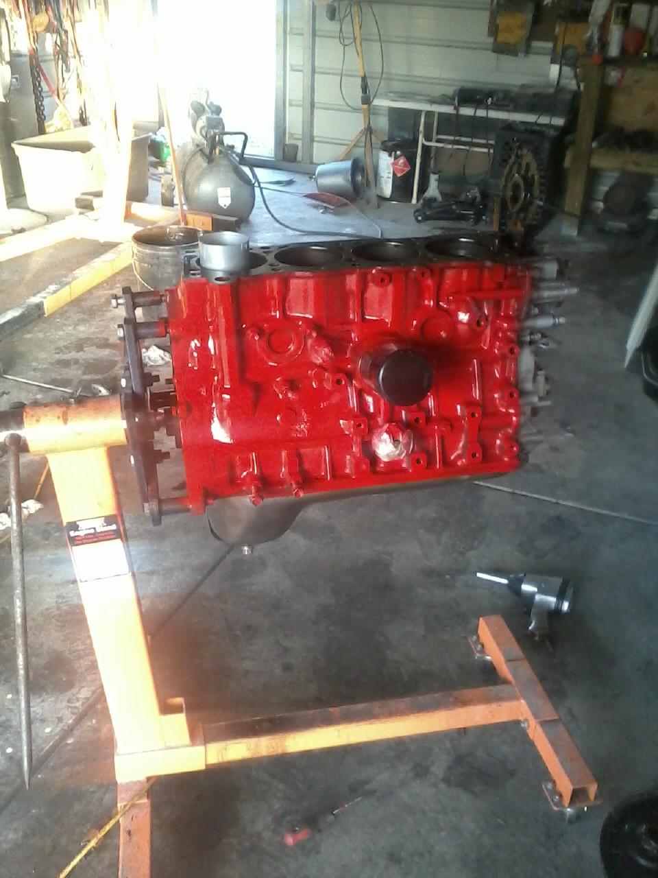

Here it is cleaned. Did get alot of the bolts cleaned, threads chased, holes blown out and a hndful of other parts cleaned and painted.
Got the block painted and need to get some more primer to paint the pan. Doesnt look like much, but cleaning, disassembly, and getting things prepped to gog back together took alot of time.
