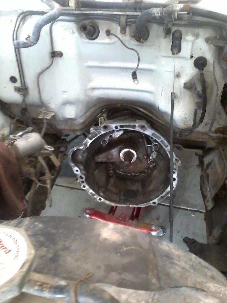

Got the tranny out of the back of this truck and cleaned it up. It was dirty and took it to the car wash for a bath. Picture didnt turn out, but it is alot cleaner. Usually I change the seals to the shafts but since I dont know if this tranny is good, I am not putting any more into it then I just have to. Not even going to hook up the front shaft til I know if it is or not.
I have heard both, yes and no, that a older style 22r can be adapted to a 22re. I am going to say no as the intakes are not interchangeable. I could take a 22r harness and replace it and make it work, but I have this motor sold and will just rebuild a motor that I have.
Got tranny cleaned and in.

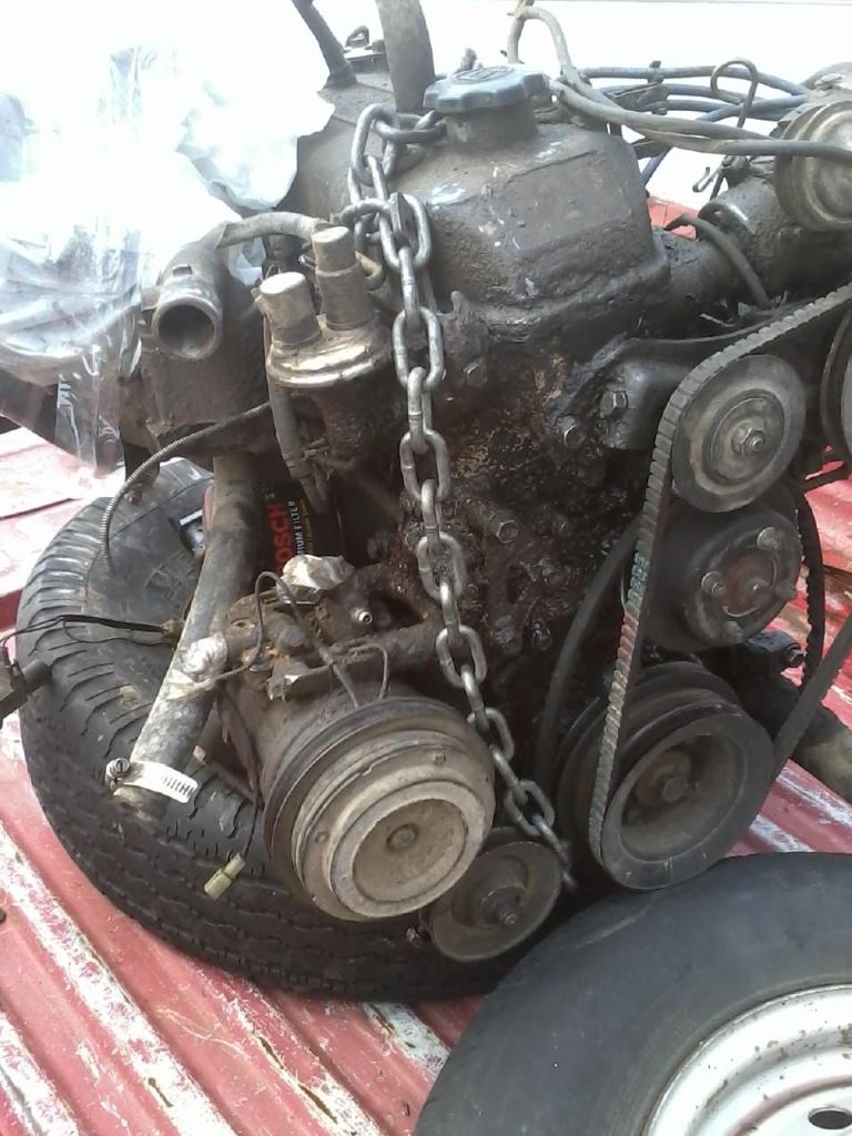

If you have oil build up like this you may have a leak. Seems like the PO would of fixed it, at least the valve cover kit that is $10. This is the 84 22r.

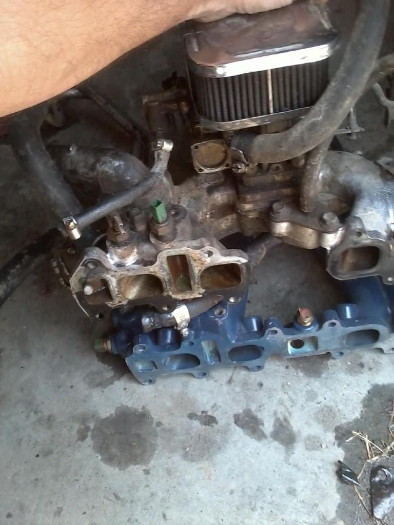

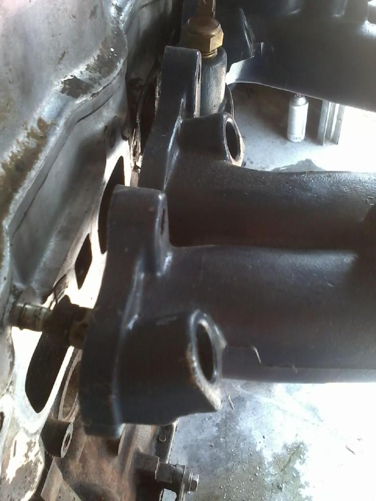

Here is a intake manifold that I used for my 86 Runner and something wasnt right on it and had to use another. The first stud up by the fuel pump lines up but nearly all of the rest dont as you get furhter to the back of the motor.

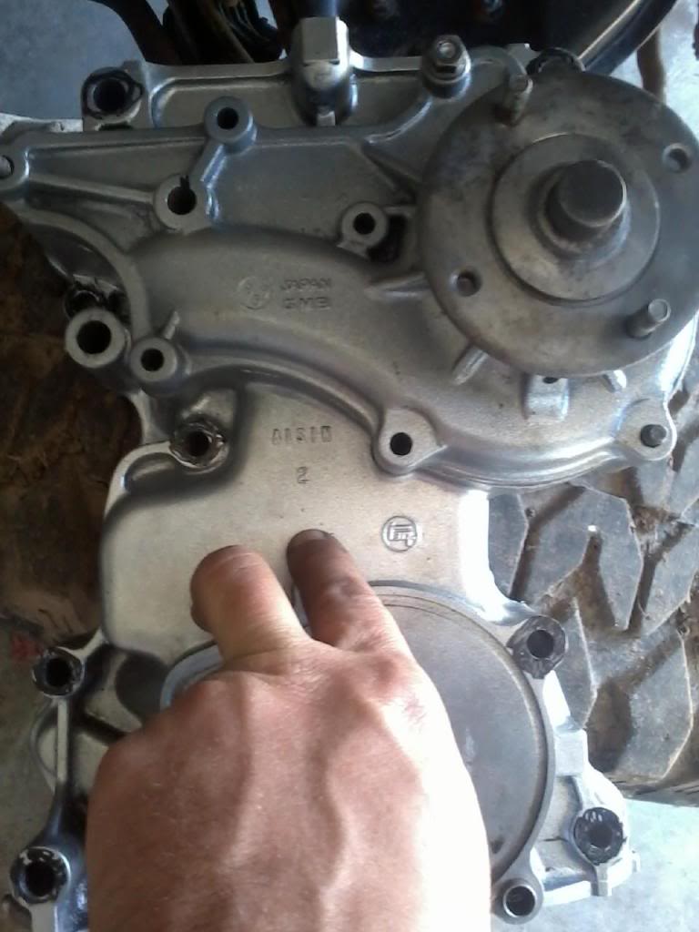

I got my Timing Chain on and had to replace the Timing Cover due to it being worn. I tried to use a early model 22r and they wont interchange. Thought I would put some info up to help others identify what they may have.
84 and older. 22r has no dimples/circles and the number "2" on it. Twistedyota got it right on the height thing, see the last picture for a good example. I also tried to mark which bolt holes for removing the timing cover on down the road when I have to do a chain again. Hope it wont burn off but it if does I tried to come up with an easier way. Never can remember which bolts they are.

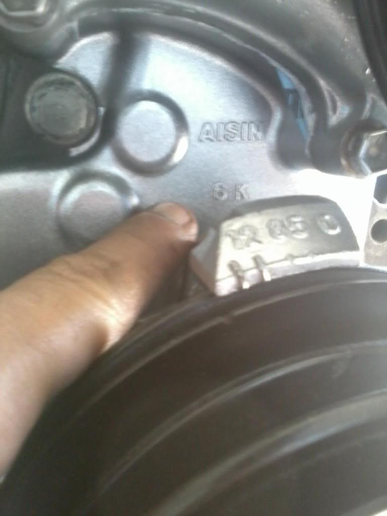

22re has "6k" and dimples/circles. 85 and up.

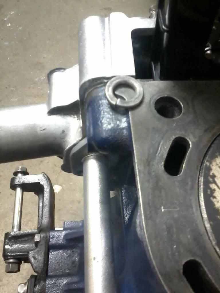

Here is what I am talking about on the 1/8th inch height. I used a lockwasher to help show how much of a difference. This cover is 22r. Seems like the oil pump bolts were to short. Hope this will save some one some trouble. It is an early model 22r timing cover on a newer 22re block.

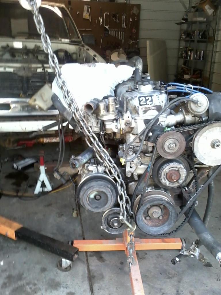

wow that is a dirty engine, pushes old 79 behind bush whistling innocently
actually terry thank you for the picture of the engine with the accessories on it mine came to me partly disassembled an i had no idea what it looked like with the power steering an ac assemblies on it

Hello Mark.. I had heard several stories and even asked a guy that has worked on these alot longer then I have and he thought they would. I thinking on this is that it probably is possible on the newer motors as some were fuel injected and others were carbed. My guessing on that and was probably thought that it would work on the older style.
Your welcome Cyberhorn.. If you need some better pics just let me know. I had gotten a queston thru a PM and my " Necessities first and Luxuries last" came to mind. I used to get hung up on what went back on first as far as belts, pulleys and accessories and that came to mind. I really think that will make you putting your engine back together alot easier I think. It isnt to bad to put your Power Steering and AC in after the motor is in. You wont have to undo anything.
One thing I wanted to add is with AC, you have some bolts that use the AC bracket as a spacer, not sure if you have AC or not, but just be aware that if you dont have the spacer to watch the length of bolt you use. Any questions I have a motor that I can take pics of to clarify a little better.
