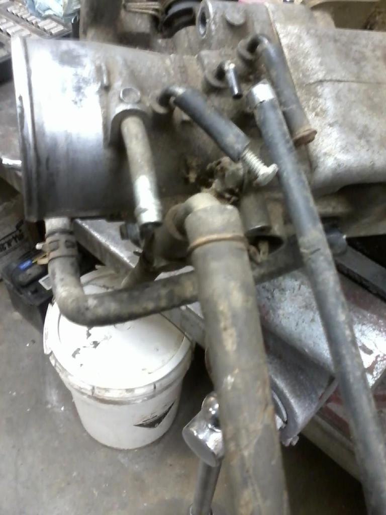

Started cleaning up some parts. Dont think the screws are factory. Grr..

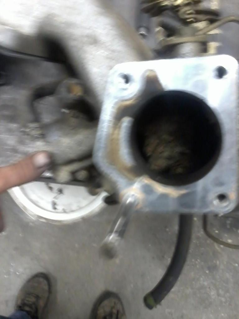

More evidence of a mouse.

Old Aug 12, 2012 | 03:07 PM
  #862
Redeth005's Avatar
Joined: Apr 2012
Posts: 2,817
From: Los Angeles CA
damn that mouse had it made. a nice mansion in there lol

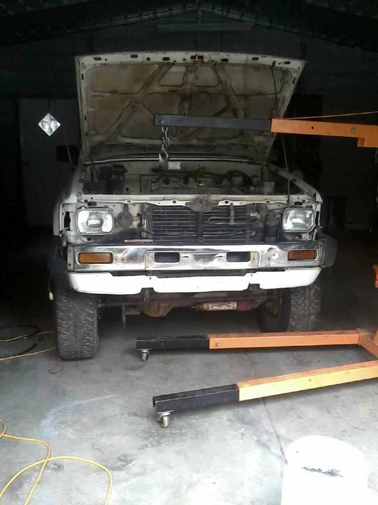

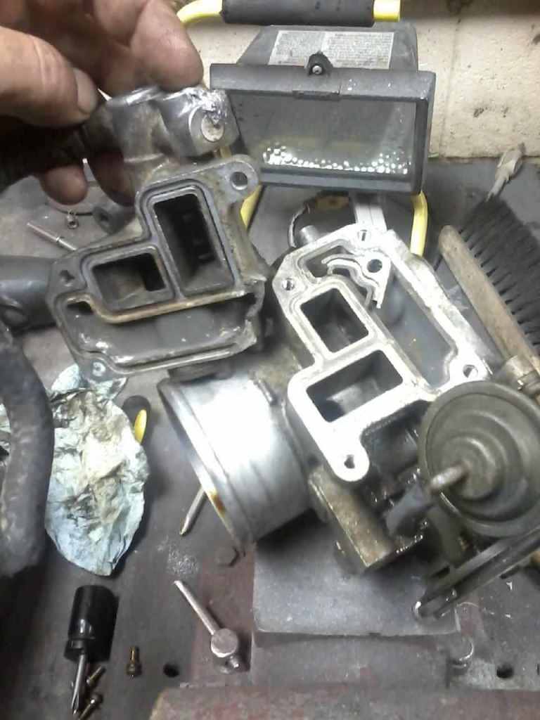

I finally got the truck in the shop. Still doing some cleaning and started to clean some parts. The intake on this 85 is a little different from other 22re's I have worked on. It has a valve of some sort under the throttle body. Unfortunately it has a piece broke off of it. I might be able to fix it, but have thought of putting a newer Plenum on it. Someone got the TPS off of it, so will be replacing it.
In the shop. Should be pulling motor tomorrow if all goes well.

Broke piece and differnent valve then what I have seen in past.

WOW, really exciting! "YOINK THAT 22REEEEK!" haha... GREAT news, can't wait to see it out, man! GET'R'DONNNE! lol.

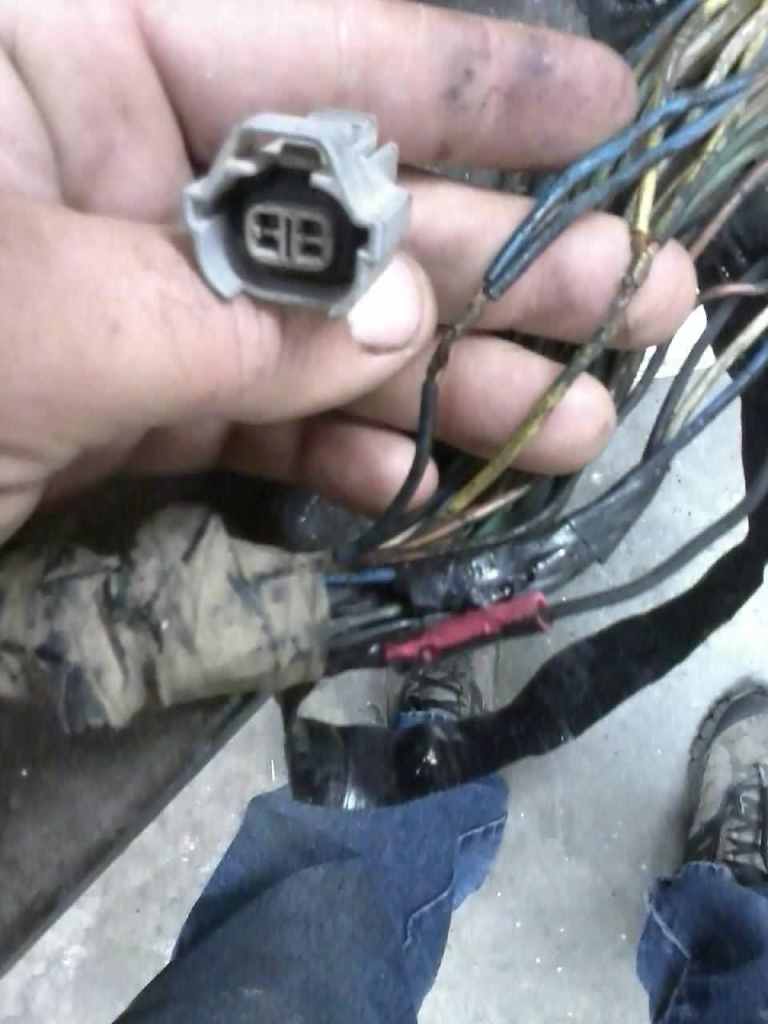

I pulled the injector harness out to check and make sure it is in good shape and if I even want to use it. I will repair it as I have those wonderful red butt connectors that just burn me up on it as well as the 88 truck I am working on.
Someone did put the newer style injector connections on it. These are a far better connector and if it will work on your truck is a great upgrade. They were on the 91s and up if I recall right. Just dont know if they will connect to the older style. 88s have a different injector. I will see if these will work on mine as I like them so much better then the wire clip.
I took this harness out just to make it easier to fix the other problems, but getting the injector connections is easily done in the truck. These caused me alot of headaches on my 86 runner build and I am determined to rid the world of these things. It just unplugs from the ECU and the cable is pushed out from the inside underneath the wiper motor. Might would be just as easy to get a complete one out of the boneyard for the newer style connectors, but dont know for sure.
The blue and yellow wire is to the injectors. These clips are through out the truck. Several within 6 inches of the computer, but they are in a dry area and dont corrode. Some in the tail light harness. Never had any proablems there either.

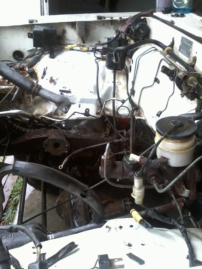

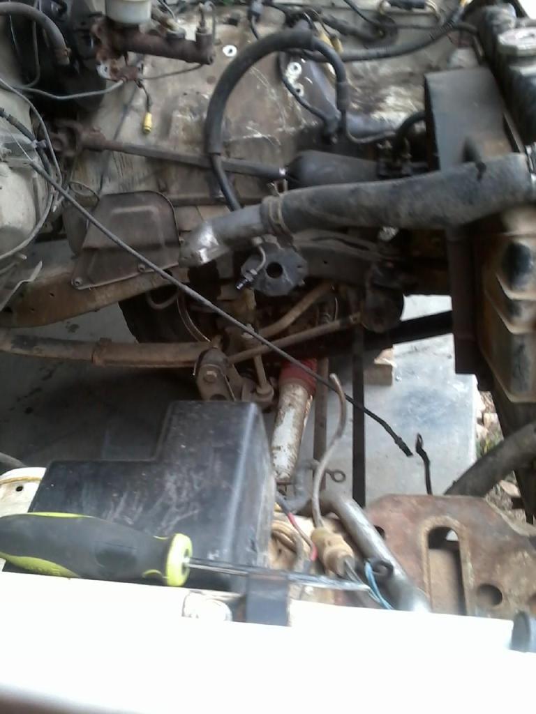

Went to change a ball joint on the 88 truck and parts store didnt have one in stock til later today. So did some cleaning on this truck. Got the motor out, the head is missing on it, other then the injector harness, it isnt really hacked up. Had few leaks but not major.

Terry - looks like your 85 has the newer style "straight" throttle body versus the older "slanted" style. That valve on it is the newer style idle air control valve. The 88 and older 22re's have the separate IACV that mounts under the intake and has hoses that go up to the throttle body. Supposedly you have a desirable upgrade there, a lot of people are moving to that style throttle body, the newer upper intake, and of course they get that newer style IACV along with the TB. I don't know if it actually makes a difference or not. Here is a neat link about it http://siestaoffroad.com/tbody.html
That person also had their Throttle body bored out...I think that stuff is years away for me, I'm still in get my truck back close to stock shape mode, then maybe I can do some of these extra power upgrades.

Thanks Cory..I didnt even notice the straight over the tilt. I will get that piece fixed now, one way or the other. Thanks again for the link. That is a new one on me.

the newer IACV is supposed to smoother...
and the throttle body linkage is cleaner..

I think on top of that latter part(cleaner)... The Throttle Body being horizontal from front to back is supposed to provide improved air flow(what I read, anyway, lol). I know 4crawler discusses it a lil in his "TPS cheap tricks" portion.
