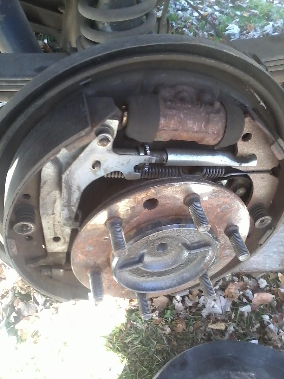

I pulled the rear hubs and the drivers side primary shoe is getting thin but it still good. The passenger side is in great shape. I thenpulled the drive shaft and it would roll. I then started the motor and tried to see if the transmission would go. The tranny seems to be working and I think it is the Tcase holding it up.
No leaks on Tcase or rear end. Front shaft of tcase will spin but not rear output shaft flange.
Drivers Side Good
Passenger Side Good

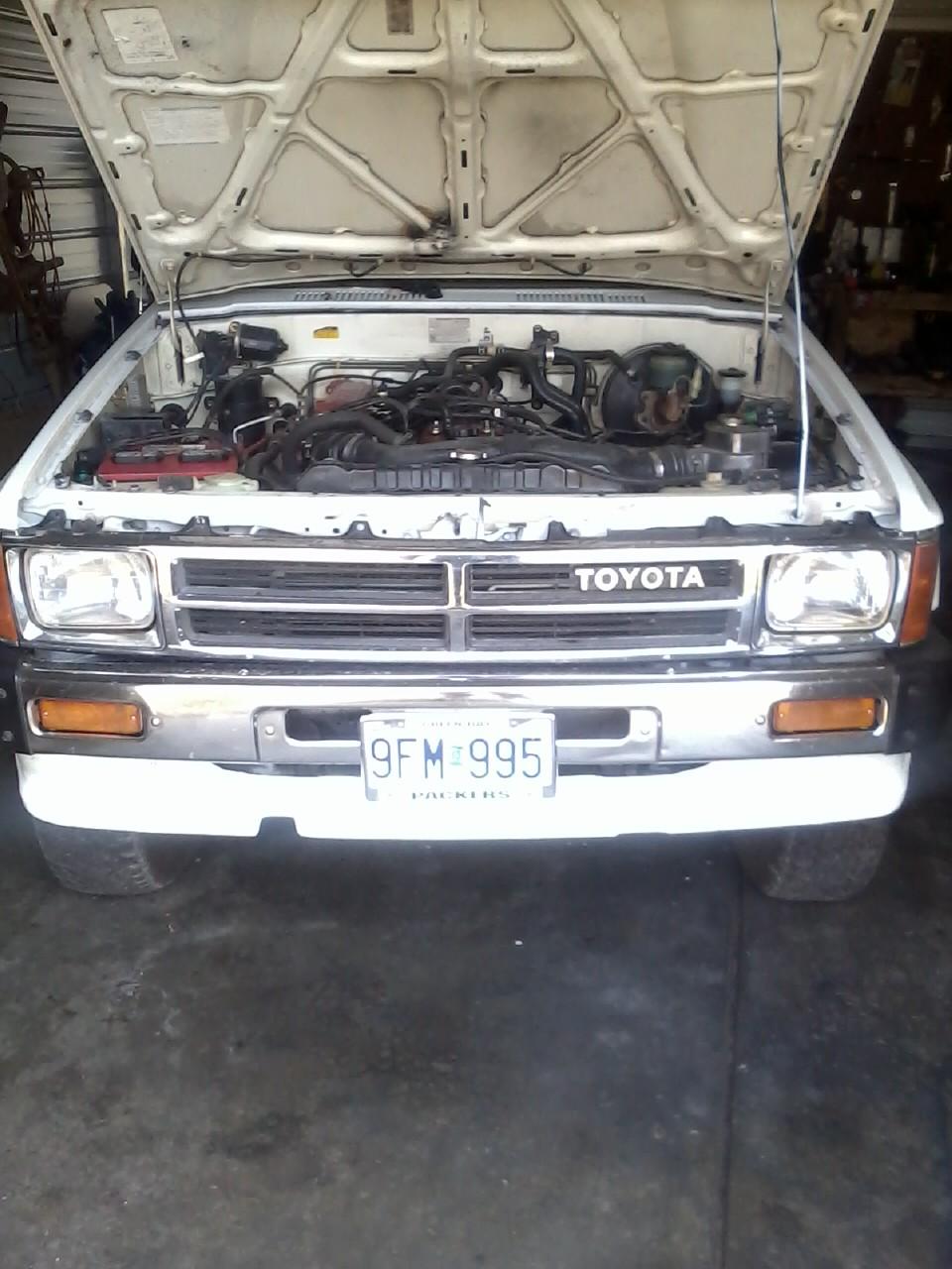

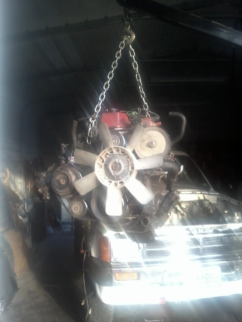

I did get the motor pulled out but the glare was bad. I am happy with how the topend has held up. I did have some leaks at the half moon seals. Several months ago I added some sealant to them and fixed the leaks at the top. I have tried not adding sealant to the half moons and some say you dont need to. I still get leaks if I dont add sealant. From now on for myself, I am adding sealant.
When I replaced my transfer case I knew I had a leak at the rear main seal. So I decided to finally fix it. When I first got the runner, 2 years ago, I knew someone had done some first class pizz poor job on the top end. Bolts were missing, hardware store bolts, vacuum lines were wrong and they used orange sealant for everything.

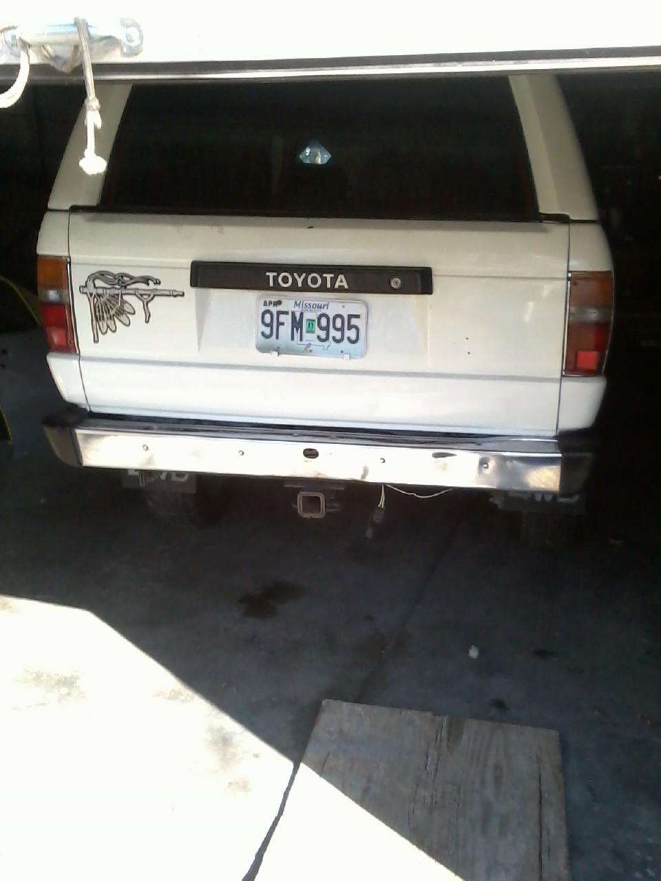

It was moving under its own power earlier this morning. I have a fairly steep angle to get inside the shop, so I had it together just long enough to drive it in shop.
I had it pushed in the shop nose first to do the tcase. Today, I put two bolts in each end of the drive shaft, and two in each side of the transmission crossmember mount just so as I could turn it around and face it to the outside as that is where my cherry picker is and to wash all of the fluids out the door. Easier to clean.

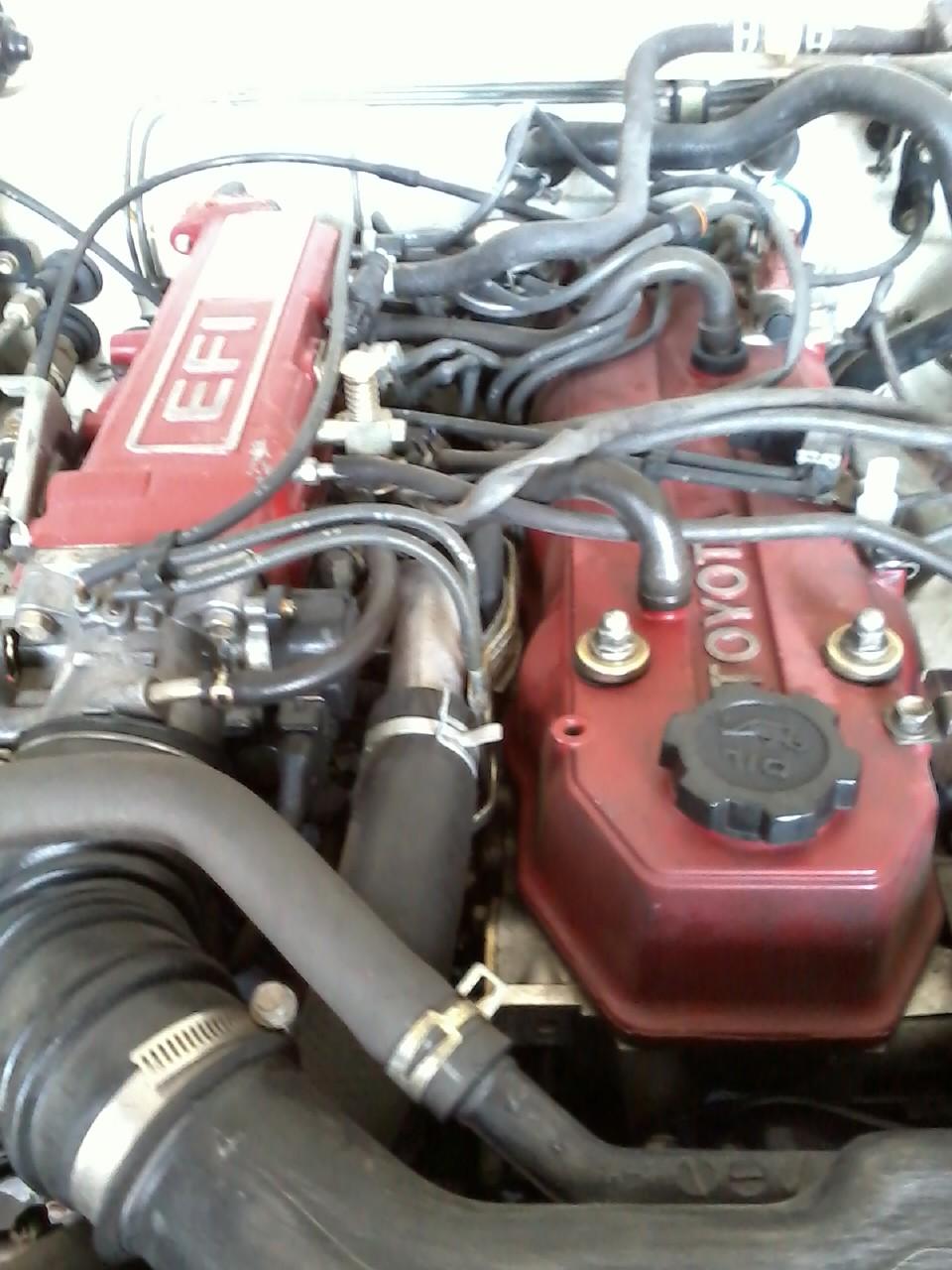

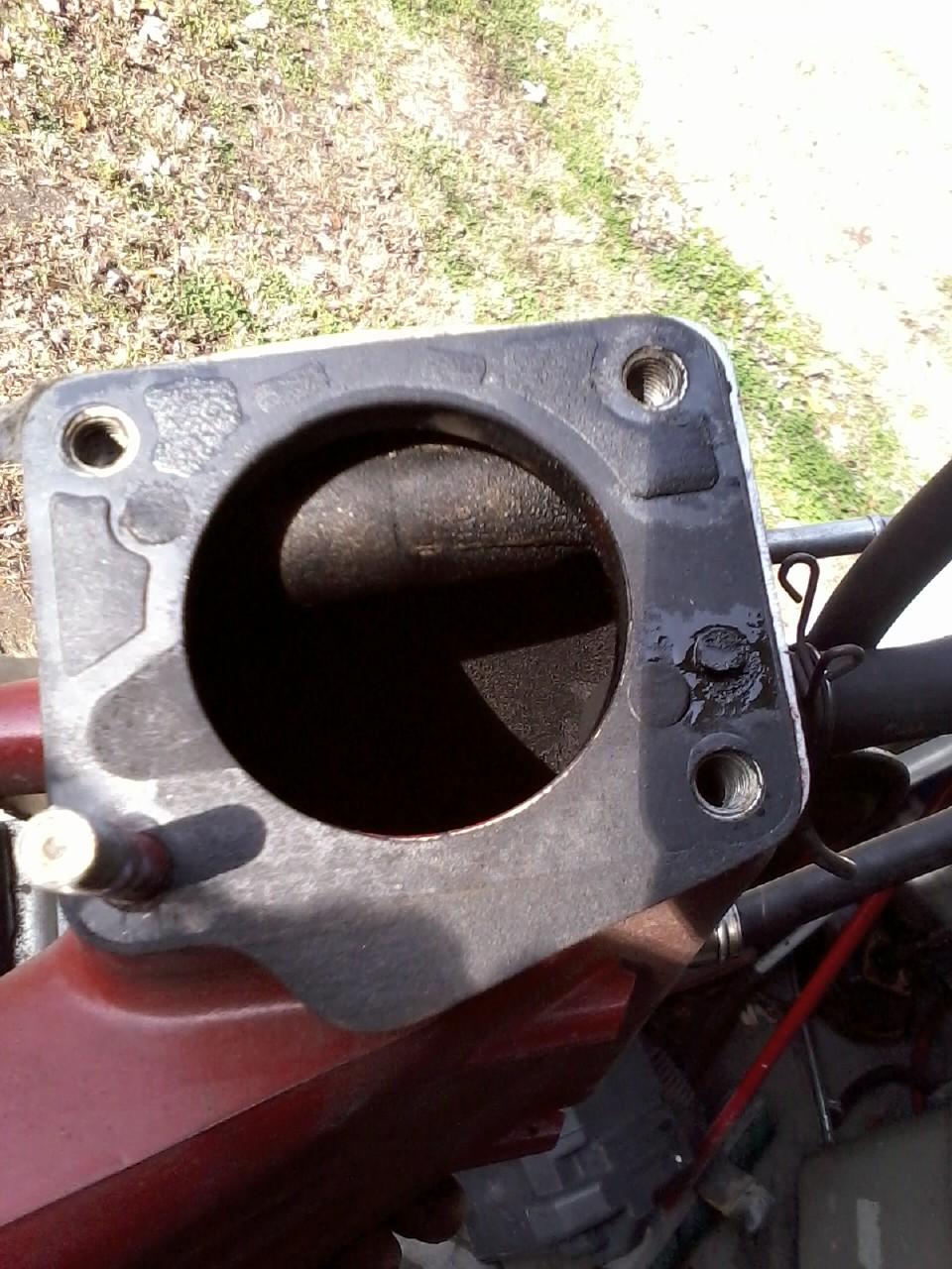

I blocked off my EGR and still clean. The black is from the oil vapors from the PCV valve.

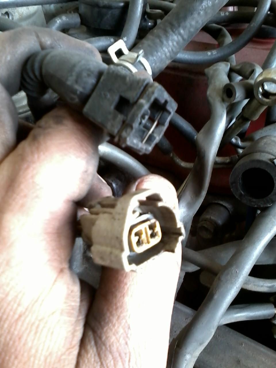

The white plug is for 88 and up fuel injectors. 87 and older have a black plug that is quite similar to the Cold Start Injector plug that uses a wire clip. It is a good idea to switch to the white plug for alot less problems. The wire clips tend to brake off the edges of the connectors and cause firing issues. I have been down that road with my 87 flatbed. Just thought I would show about what the differences are between the old style and new style.

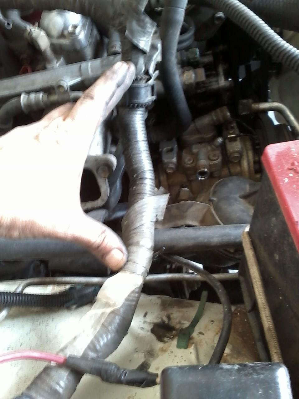

When pulling a motor you have to undo the whole harness from the transmission, fuel injectors and other sensors. This is what makes doing a body swap or frame swap on these trucks so nice and easy. If you can pull a motor, you can swap bodys or frames. I got this picture to add to my frame swap post.

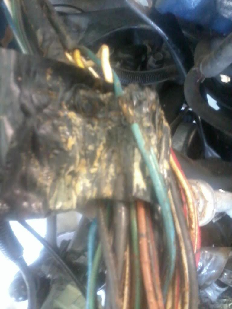

When I could not get my 86 runner started, it was because inside this section of harness, there is a crimp that connects injectors 1 and 3 and injuectors 2 and 4 together. The crimp will pass resistance checks, but wont let enough voltage pass to fire injectors if they get corroded to bad. While fixing the leaks I am going to remove those crimps and solder them together. It is a poor design and gave me alot of trouble trying to get my 86 running. It is a good idea when you have the harness out to remove the crimps. Especially if living in a wet/damp enviroment.
Crimp I am talking about. One will be on a blue wire and one on yellow wire.

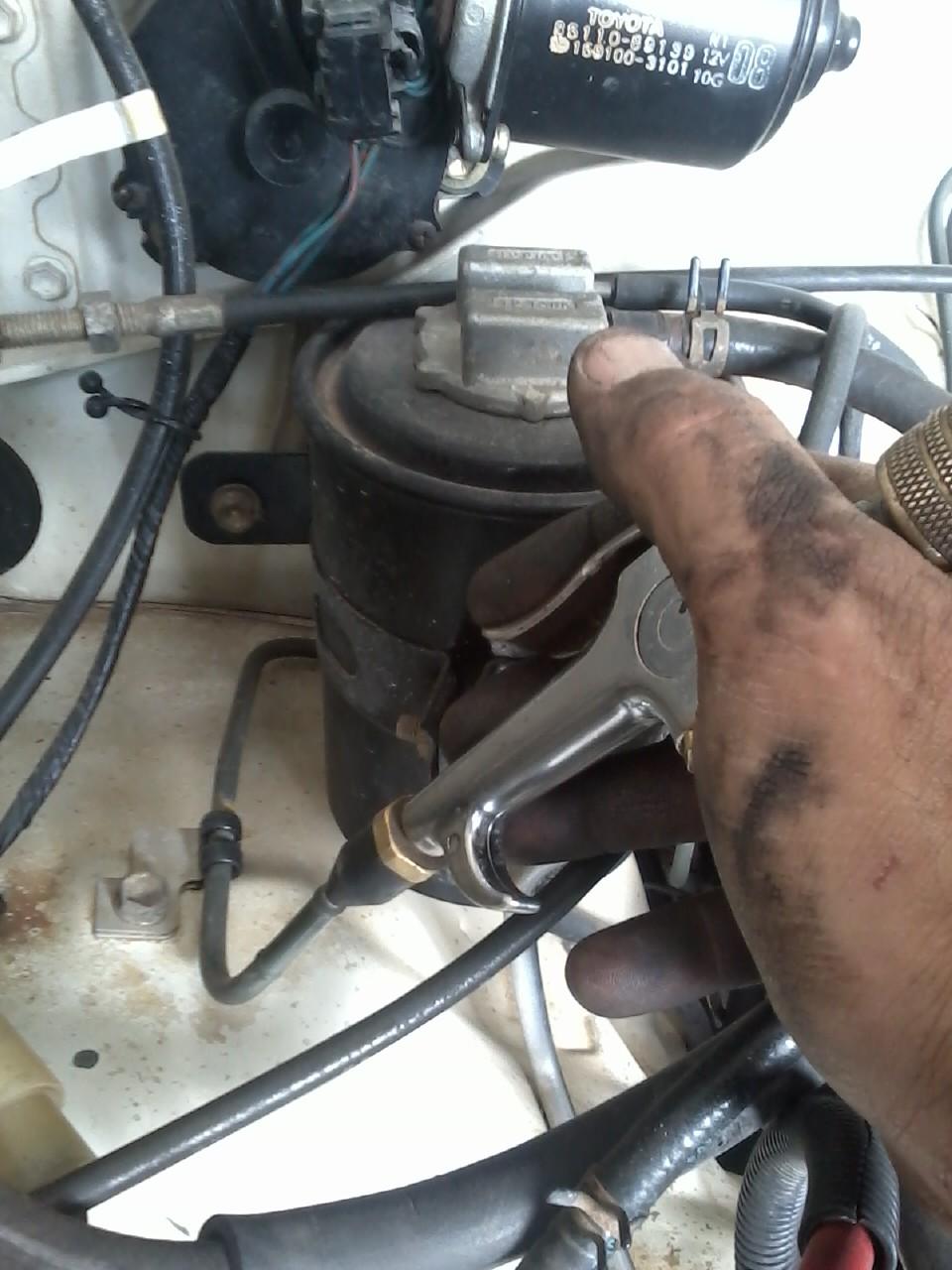

This is your fuel return line. For trouble shooting a fuel issue, I will pull the hose off and let it run into a transparent jar and if it is flowing well, it will fill a quart jar in about 30 to 45 seconds. You will know if it is enough flow. It fast. To make assembly quicker and eaiser and to save missing bolts, I put them back in where they belong when possible.

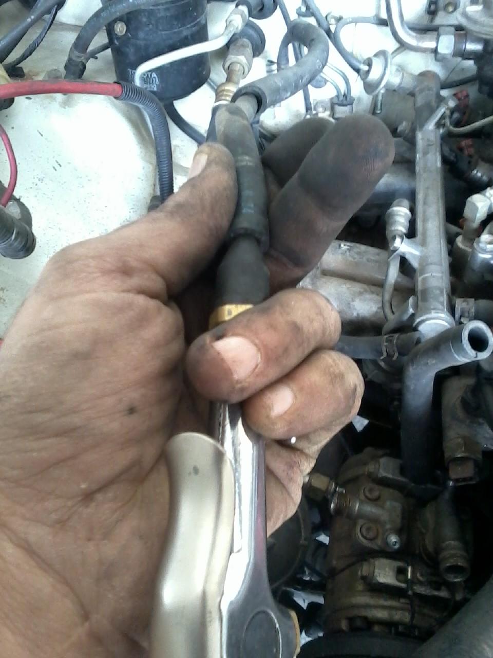

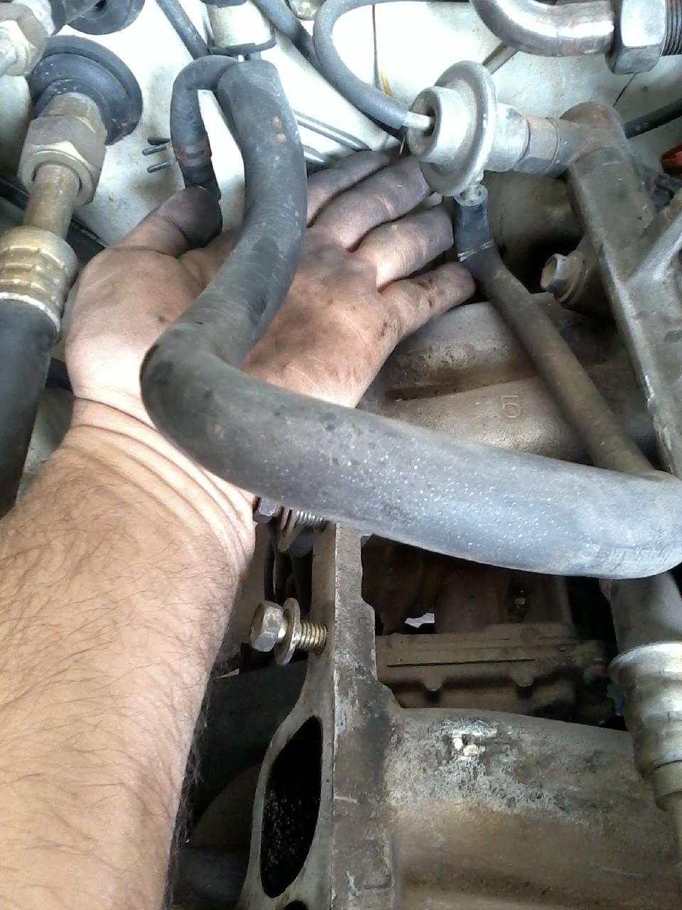

Here I am checking to see if one of the fuel return lines is clear. I pop the gas cap off and you will hear air or bubbles in the tank. I have seen these return lines clogged.
Checking the other line.
