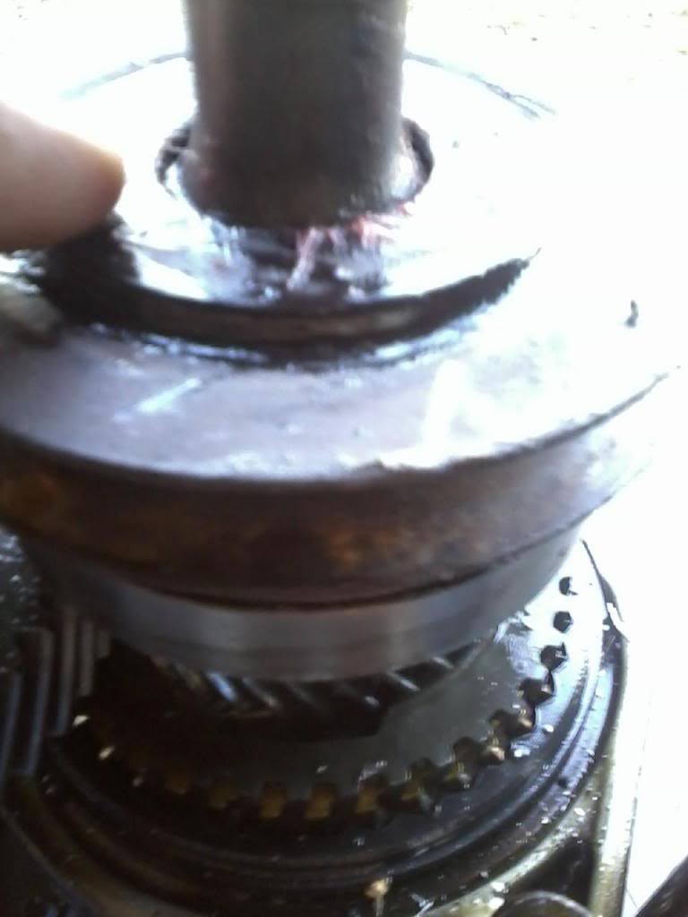

I am jumping around from one project to another, but what I am doing is working on a few things on my lunch break at work and then working on my EFI converison when I am home. Trying to take advantage of the time I have got.

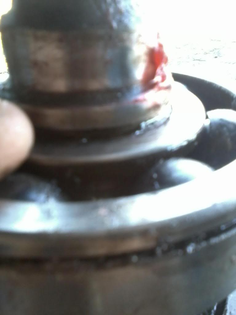

Today it is cold here and we have frost on the ground. I wanted to try a couple of Bubba fixes ( Redneck Engineering) and with the tranny being in the shop and being cold, I took my bearing and stuck it in the oven at about 180 degrees for 30 minutes.
I put a little grease around the shaft of the tranny to let it get cold as well and hoping with the 32ish degree tranny temp and the 180ish bearing temp that the 150 degree difference might make sliding the bearing on the shaft a little easier.
While the bearing was heating up and to distribute force evenly against the bearing, I took a Power Steering Pulley and removed the bearing from inside as I could not find any washers around here that would work.
Then I sacrificed a good grease gun as I have a couple of more laying around that would fit over the shaft and on to the PS pulley.
Then I put the heated bearing over the shaft, sit the PS pulley on top of the bearing, put the grease gun pipe on top of the bearing and a few good whacks, I nearly got the bearing onto the shaft.
Was a great idea until the shaft got to big to fit thru the PS pulley. I will later on take the PS pulley and cut the center out some more for future fixes. The bearing went on almost all of the way until the PS Pulley bottomed out.
Here you can see I just needed a fuzz more to get the bearing to be fully seated to install the C-Clip.

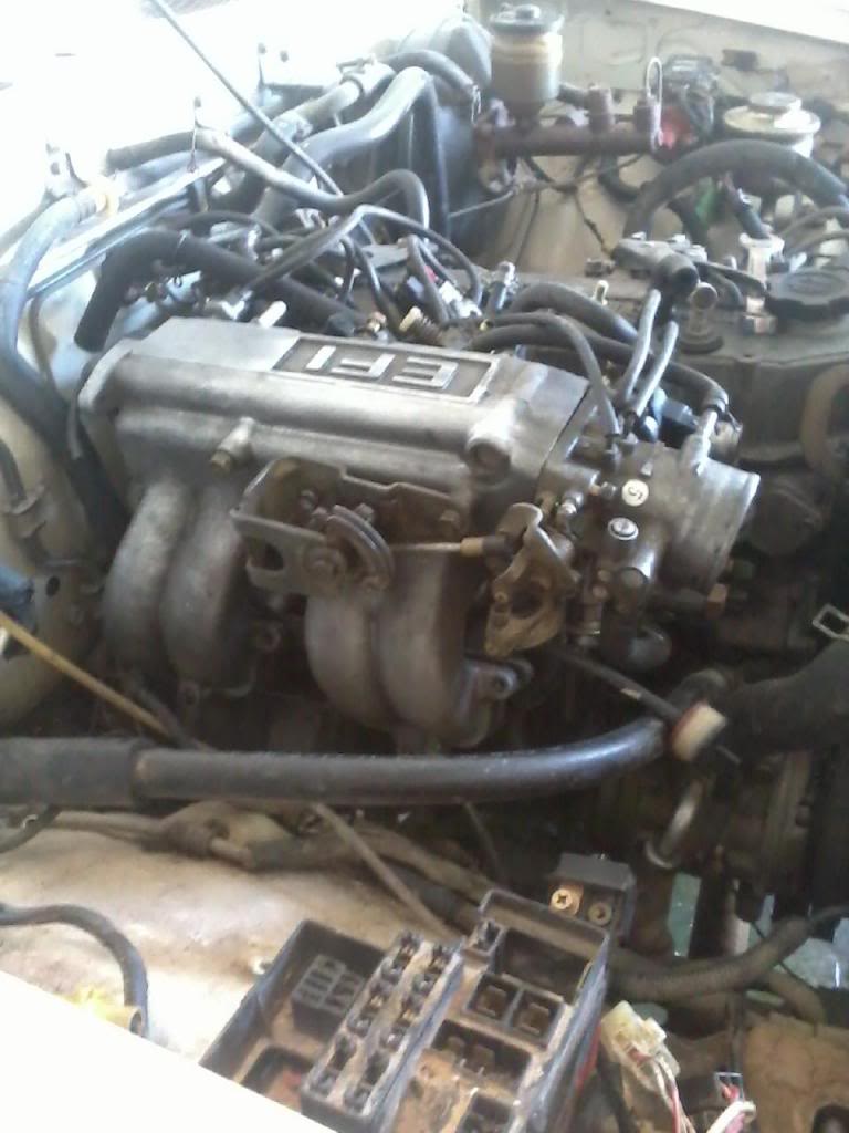

It isnt going to warm up for a few more hours so I might start the 22r to 22re conversion thread later on today.
I dont have any intentions of installing the bearing by hitting with a hammer, but it was to get an idea of what I might could come up with about getting it back on. The Power Steering Pulley and a metal pipe could be used in a press. Sometimes just have to let Bubba do some experiments to make things happen.lol
On warmer days I would get a rag wet and throw it in the freezer and then wrap it around the tranny shaft to get the same results of having a cold day.
I did start a thread called the 22r to 22re conversion>> https://www.yotatech.com/forums/f116...4-88-a-278925/
Got quite a bit done on the conversion. Up to the Intake is permantly done. The rest is just sitting on there to keep it all together and to see the light at the end of the tunnel.

Doesnt look like much but did get quite a bit done. I still need to fix the Injector Harness to get going on the conversion. Should of worked on it when I had the time. Doh!!! I went to install the injectors and went to the parts store and they wont have any in until tomorrow so I went about as far as I could on the conversion.

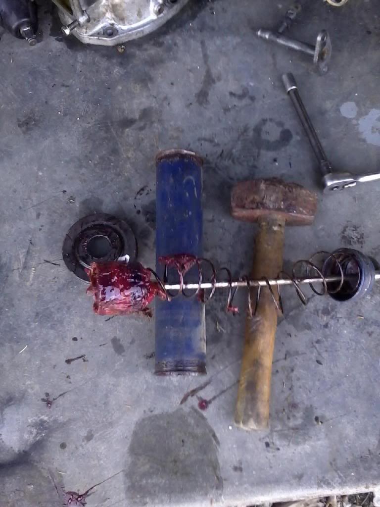

Finally decided to work on my brake booster issue on my runner and I got a booster with the master cylinder on it. I went and just swapped the whole assembly out and now I cant get any pressure on my brakes. Hoping I can just put my old master cylinder on my new to me booster and be back in business again.
The friend that is going to help swap out Mistys clutch stopped by and we are going to change her clutch Saturday morning. He says with his lift and tranny jack, that we should be done with it quick. I could do it myself but getting it done quick is better in my book. We are quick when we work on a project together. The down side is when you have to work by yourself on the same project, it is like you are in slow motion.
I think he liked my tranny bearing idea. Something he hadnt really thought of. I am planning on doing the tranny bearing swap on a good tranny at his shop as well. He has a press and seems to think we could get it accomplished.

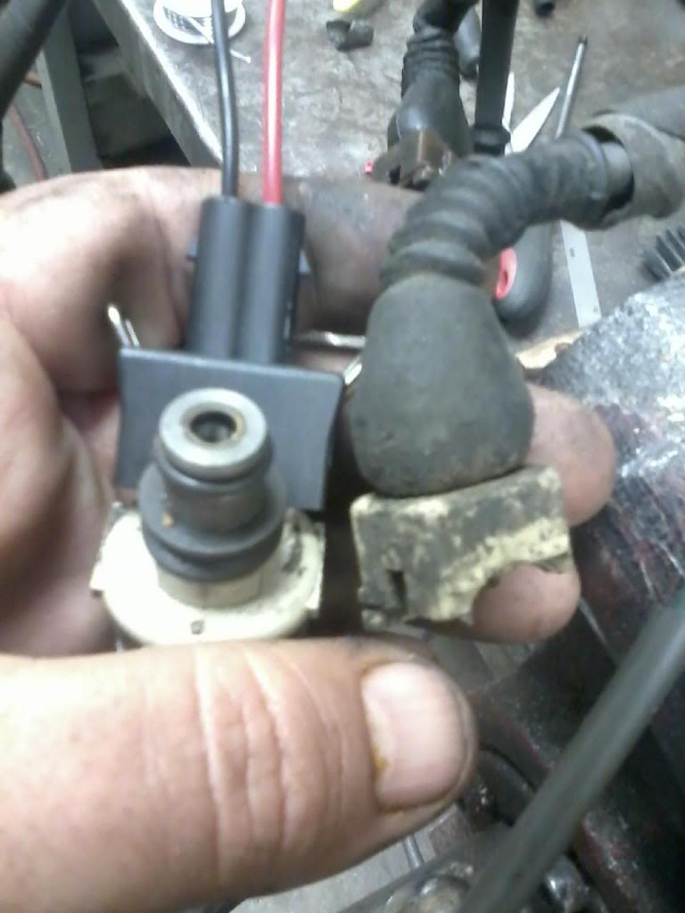

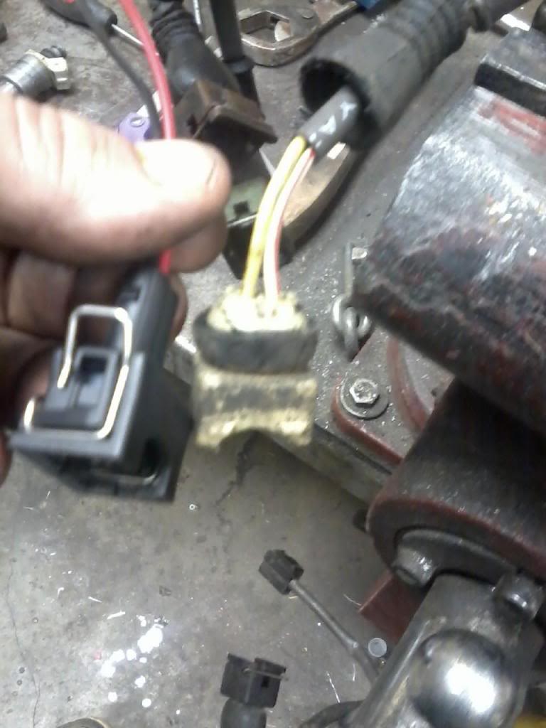

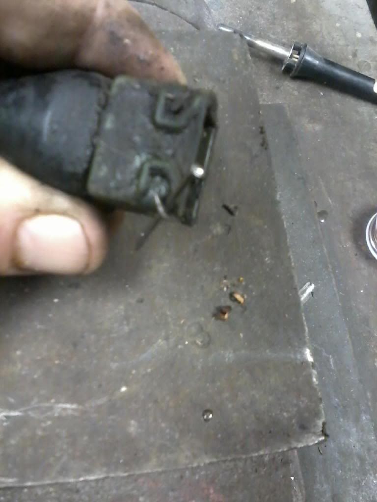

I am taking 3 harnesses to make one for the EFI conversion. Here is a problem I see a lot. Most people seem to have a hard time getting the 85-87 injector connector off of the injector. The wire clip is type is not the best but I use a small nail and lift one corner of the wire off of the connector to free it. Then it is easily worked around.
I ordered one EV1 style connector from connectorfast.com and it appears to be a great replacement for the 85-87 injectors. I am going to test it on this conversion and if it works great I will replace all of them with it. Alex, the guy that sells them is very helpful and great to deal with. The connectors are $6 a piece with a $10 shipping. Well worth replacing with if this one works out like I think it will. Also it is easier to remove then the current connector.
EV1 Style
This is quite typical of what you will see when these are busted up. You can also see where I worked on another connector (TPS, If I remember right), I replaced it and soldered, heat shrinked, and will wrap with electrical tape when I get everything completed on the harness. I am missing a plug and will have to look on my runner to see which one it is and see if I can find one thru connector fast or the boneyard.
The squeeze tab on the side that will make removing the connector easier.

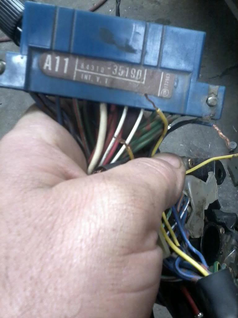

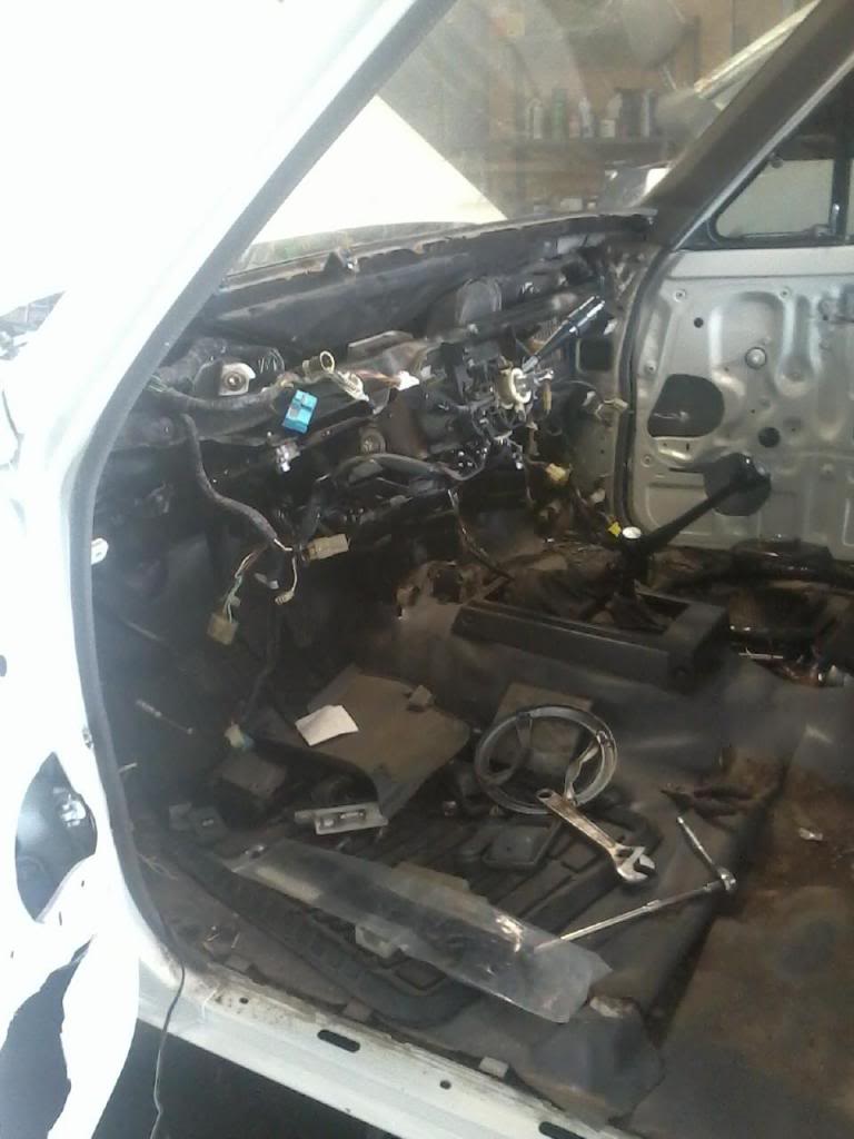

I removed some more wiring and several bad plugs and think I now have the main harness in good shape and have some confidence in the injector harness. I will keep an eye out for a better injector harness.
If all goes well sometime between now and Friday I am shooting for firing this truck up. I still have to install the injector harness, fuel tank system, and the rest of the dash. Still a ways to go but a few good days work and it could happen. While having the main dash out, I noticed it was brown. This truck has not had interior work but looks as if it came from the factory that way and the factory used interior paint. It was not completely covered like if I had used interior paint. I will have to look at another main dash support to confirm my suspicions.
Main Dash Support got a good bath.
Where I am up to now. Looks like a disaster but will clean up quick.

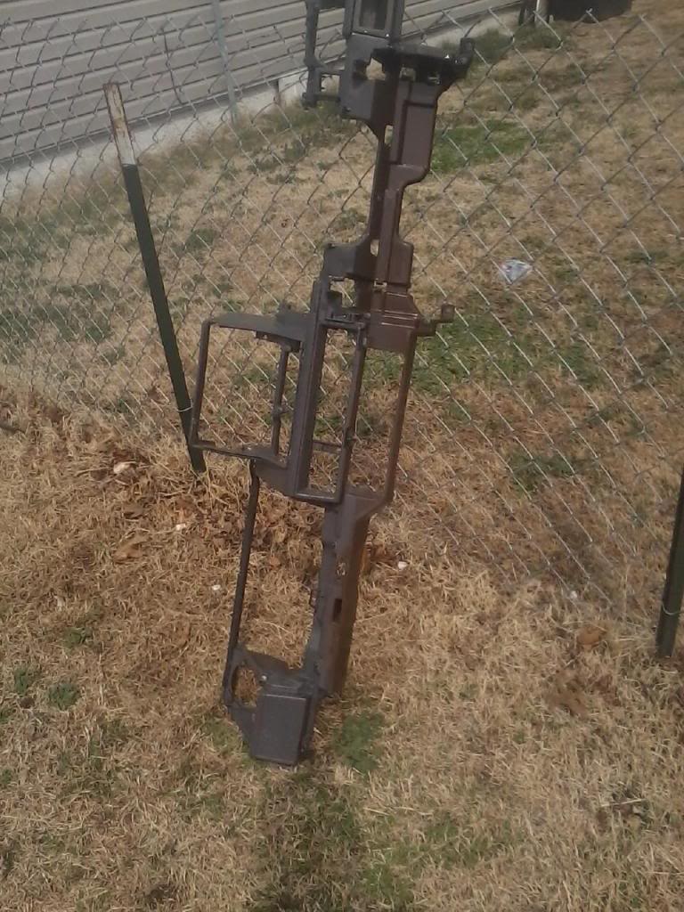

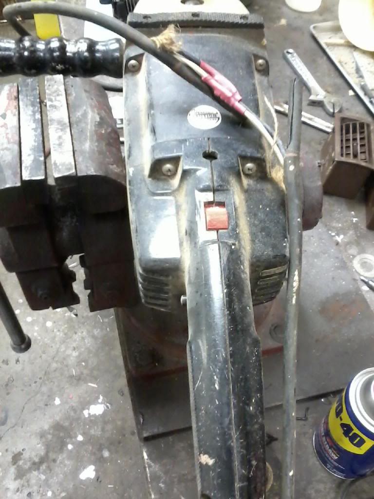

Been driving my 86 and seeing the crack in the dash is just bugging me especially when I have a good spare. I pulled it out and gave it a good cleaning. I need to pick up some more interior paint and it wont take long to get it painted and in my runner. The one that is in my runner will go on my 85. I move the parts from Mistys runner to mine and on over to the 85. Eventually the 85 will have good parts in it, but it is a far improvement from what it had in the past. I will get back on with the fiberglass dash pads later on. Those are just to learn on and when I cant seem to go any further on a project for a while.

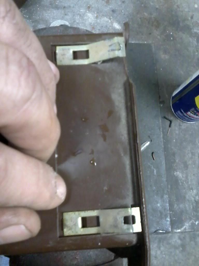

The vent is cracked on this one so I am using it for testing purposes. I am removing the smaller inner tab and seeing if that will make it easier to remove from the dash.

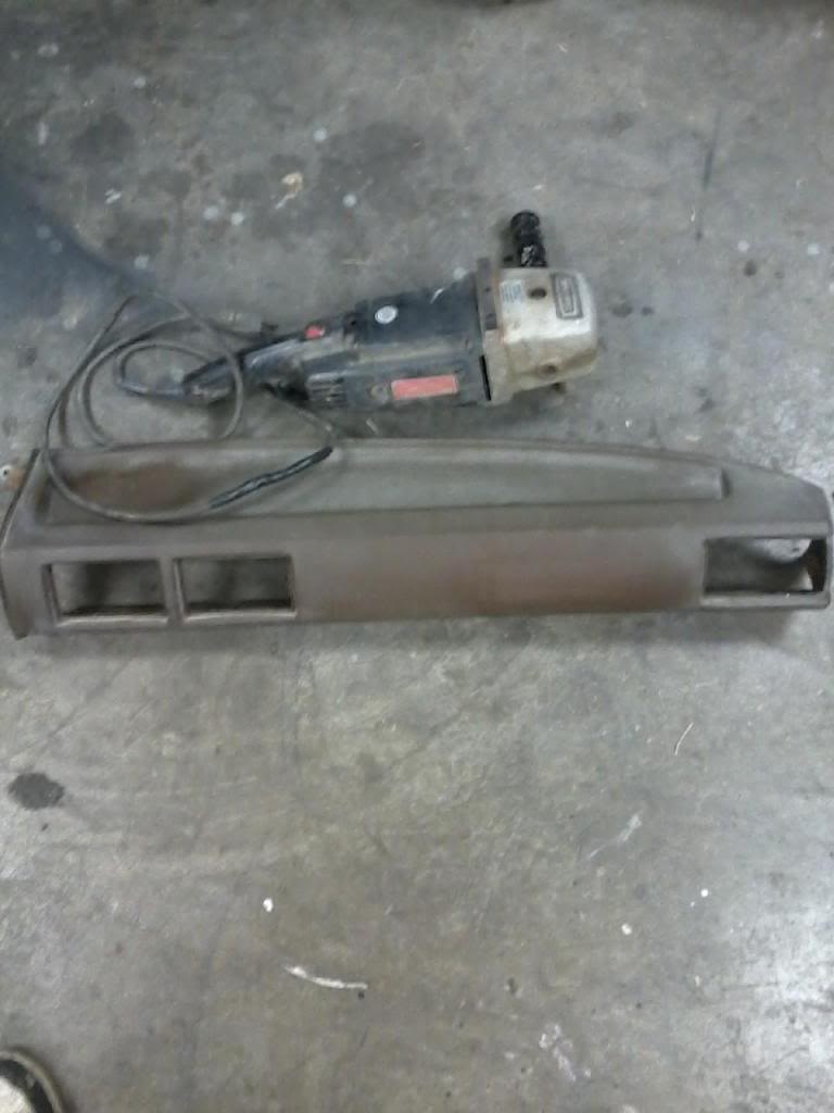

My brother has a place that they recycle some things were he works at. He asked if I wanted some tools that were thrown away. This angle grinder didn't work. I have learned to check the obvious and simplest things first. I could tell the power cord had been cut. I removed the tape and the wires were just taped together. I soldered them the correct way and the Craftsman grinder works great. It is one of the powerful ones that will get you if you don't have full control on it.
Got a Skill saw and it seems to work great. He also gave me a full Makita set that appears to just need some batteries. I will look for one of them and see how the set works out.
