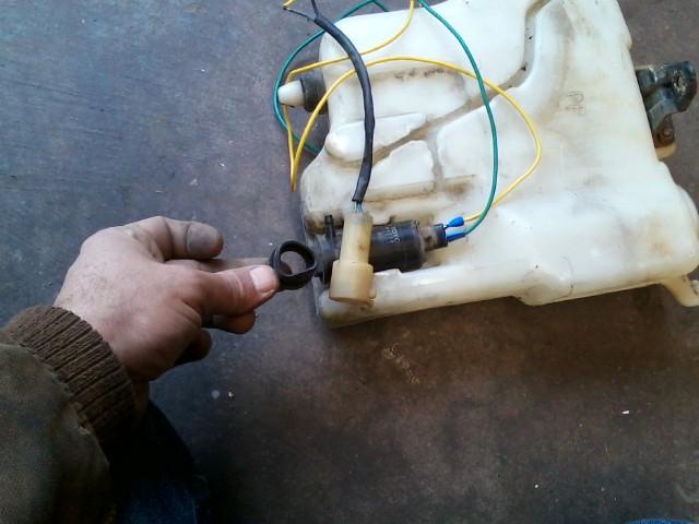

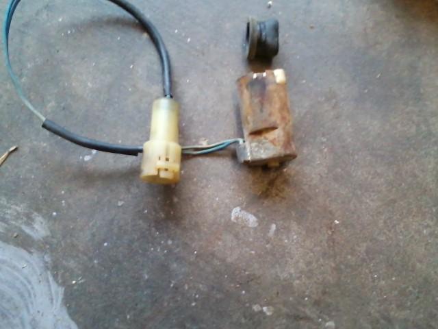

I did get to test my washer assembly. I took a newer model pump and had to wire it to check my switch at the steering wheel.
Here is my old washer pump.
I used a newer pump and it did not have the wire connector to it so I rigged it for now. The rubber seals that connect the pump to the bottle is still interchangeable. The 85-8? will usually be brittle. The newer ones will still work. Even the pumps will work if you have the connector to the pump and just splice your old pump wiring in. I will get another pump from a newer Toyota car or truck and do it better then this. Just showing what you can use.

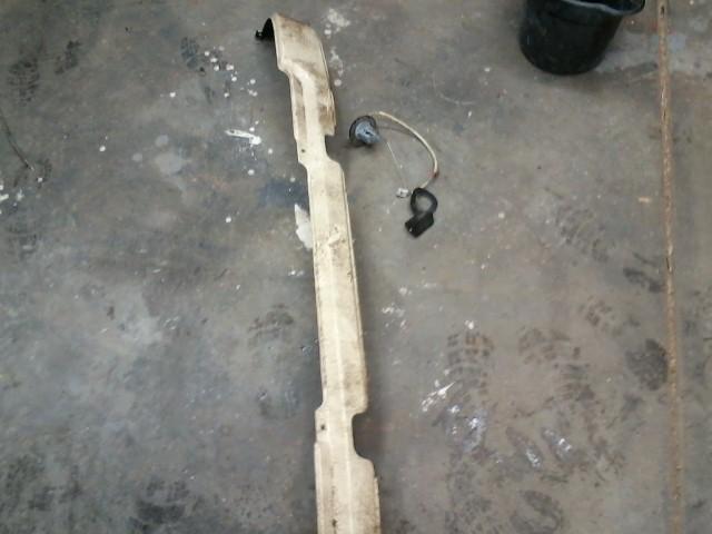

I have taken some time off from the trucks getting the shop to where I can work on them in the cold. Last year I could not due to it freezing me out with no heat and no insulation. I have hourssss spent on getting insulation and a stove set up in my shop and we have been cold and rainy and I am having a great time out in the shop. I will be getting a weeks vacation in the first part of January and have plans to be out in the shop the whole week. Lots of things I want and need to do and figured I should get something done with a full week in there.
I did get to do some work to the 85. I am trying to get it moving under its own power to move it out of the way so I can start doing some work on the 86 Runner that I will be painting and doing some work on. Also I want to get the 85 out so I can paint the whole shop white for more lighting.

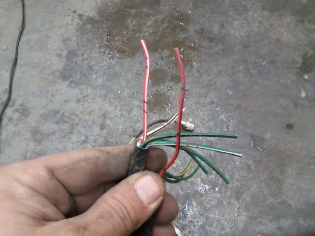

I had to take two tail light/fuel harnesses and make one. Toyota uses 3 different plugs to connect to ECU harness. I will eventually get the correct harness from the truck I have been getting parts from in the salvage yard but that is 98 miles away and I am going to have to lay on the ground to get to it. Something that can wait until it is warmer and dry to do. In the mean time this is going to work.
Toyota changes at least one wire on every harness every year it seems. On the tail light/fuel harness they changed just the red one. One harness has the red wire with black stripe and the other is red with a white stripe. All other wires were an exact match.
I got all of my lights working including front and rear blinkers. I need to install the tail lights and run the wiring along the frame to where it belongs. All lights work, horn is not working and will look into that later on. One big step to getting it legal to drive.
I got a valance from a friend. It is for the pickups. I eventually want to install a 4Runner valance but this will help make the front end look more complete in the mean time. Also got a fuel float gauge from him so I can get the bed mounted and the wiring installed and have this part of the project wrapped up completely.
