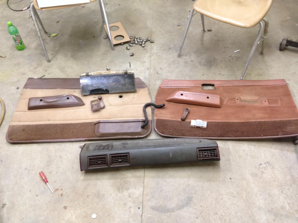

Not perfect but I got a start to your brown interior buddy.
The door panels are in great shape just need cleaned up. Perfect dash pad, got it out without breaking the vent yeah me lol. SR5 gauges needs the lens replaced. Let me what If any of it you want/need I grabbed it all for you buddy.

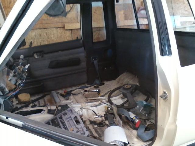

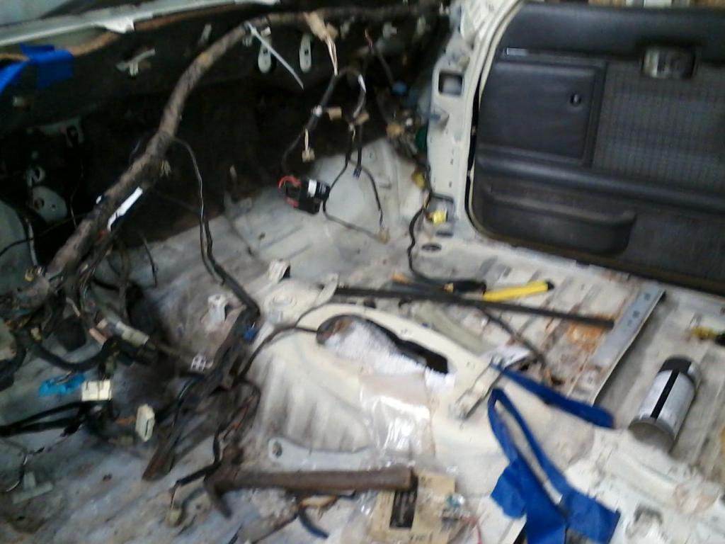

I was able to go to the bone yard but wasn't able to stay as long as I would of liked. I did score an SR5 Main Harness for my truck. It came off of a rusty, beat up, truck that had some panels cut off of it. This is one of the most loaded trucks I have ever seen. It had the sun roof in it.
The Main Harness I got has the following factory options.
Cruise Control ( I wont hook it up)
Map Light
Glove Box Light
Electric Antenna
Electric Door Locks
Lights in Doors
Electric Mirrors
Wiper Delay
Head Light Reminder
Door Reminder ( I think it is what it is)
Low Level Fuel Light
I am sure there is something I missed. I just need to replace a blinker plug. The only problem I have run into so far is the fuel/tail light harness is a different plug. I will need to go back and get it in a few weeks. I should of grabbed it today but the ground was wet and I was running out of time. In the mean time, I will try to just hook up the fuel pump so hopefully I can just get the truck to move under its own power. I also grabbed the head light/fuse box harness. I am sure I have an 86 Injector harness so maybe I am done swapping harnesses. This one looks to be great. I can start assembling the dash now.
One loaded SR5 harness. I will eventually add some of the features at a later time. Just want to get the basics and get it running.

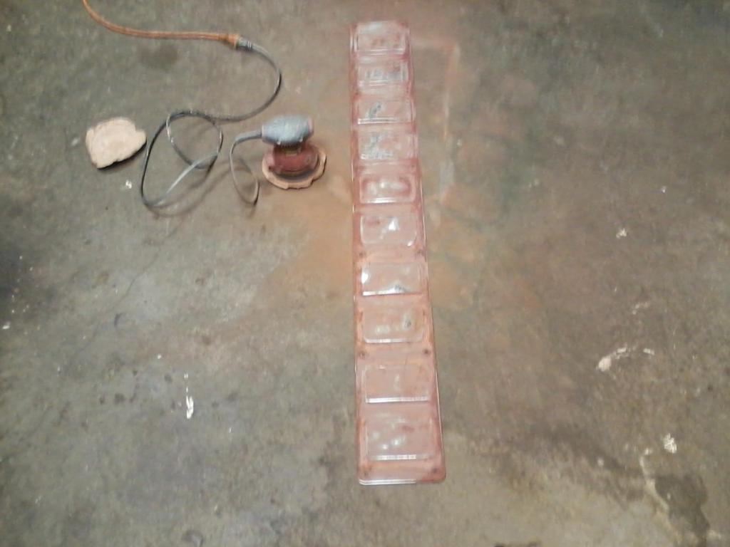

I was able to grab a tail gate panel. It was rough looking but a little hammer and dolly and some sanding has it looking ten times better. Once I get it painted it will look better. Later on I am going to get a roll in or spray in bed liner and then paint over that and it will hide any imperfections. One more piece to getting it closer to assembled.
I was working on getting this piece sanded and let Hunter work on getting some farm pieces ready for paint and he is getting the sanding part down real well. He helped save some time.

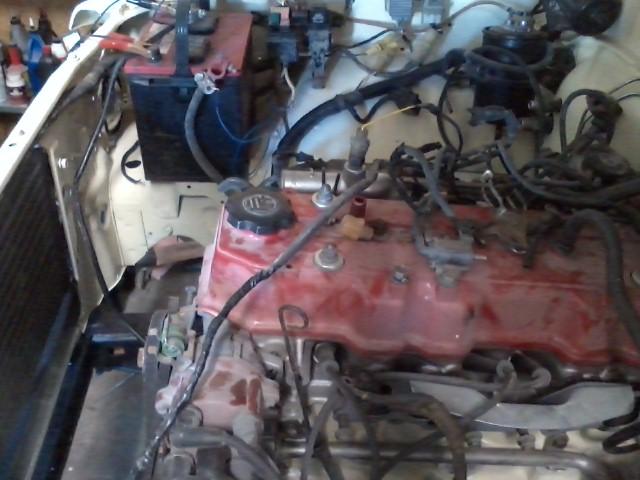

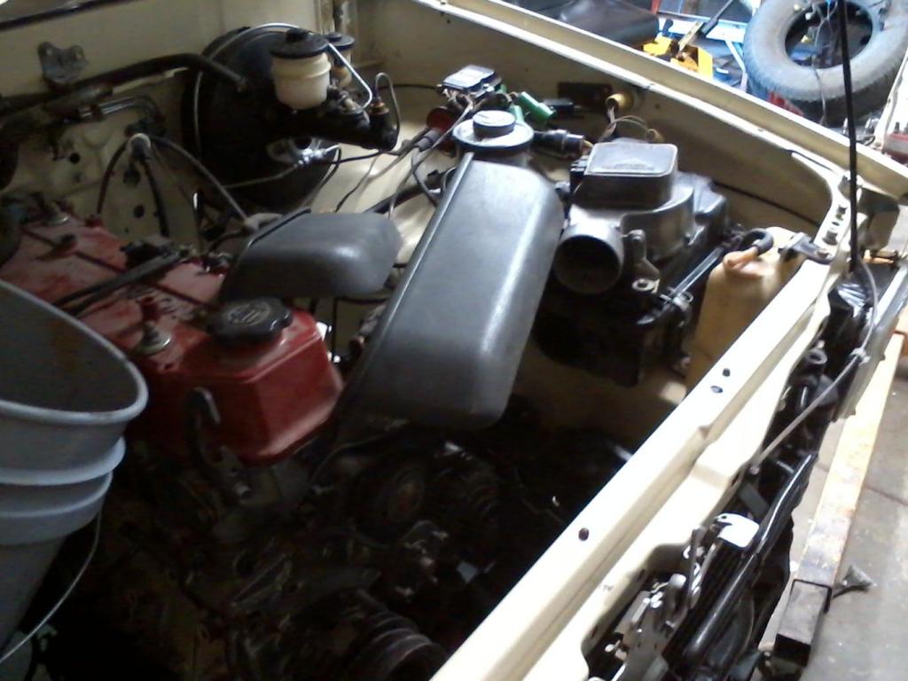

I have been cleaning and installing the power steering resivoir, harness, AFM, and coil. Starting to look like a engine bay again. Also got some second gen door pockets to install at a later time.

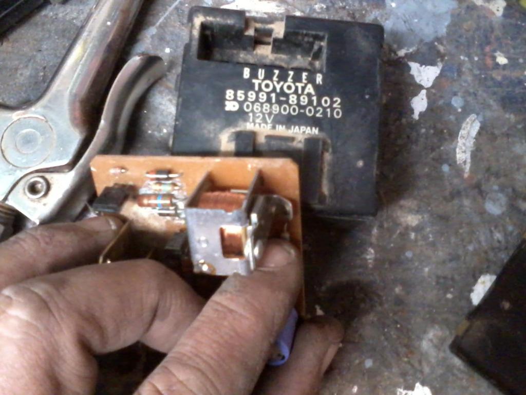

I disabled my door buzzer. I have shown this in the past. Some remove the buzzer box and then the dome light wont work. I just bend the tab back to keep it quite.

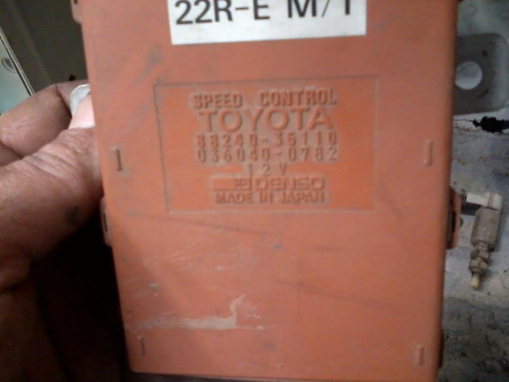

Here is the Speed Control Box. I dont have all of the parts needed to make it work but it is a start.
Installs below fuse box.

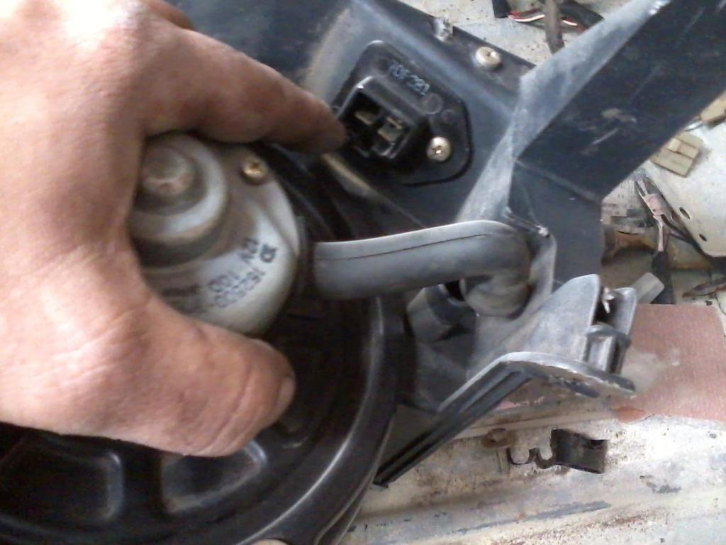

Got the Blower Box cleaned and installed. One of the toughest trouble shooting I have done is on this resistor. There are 3 and 4 pronged resistors. I will need to order a 4 prong resistor later.

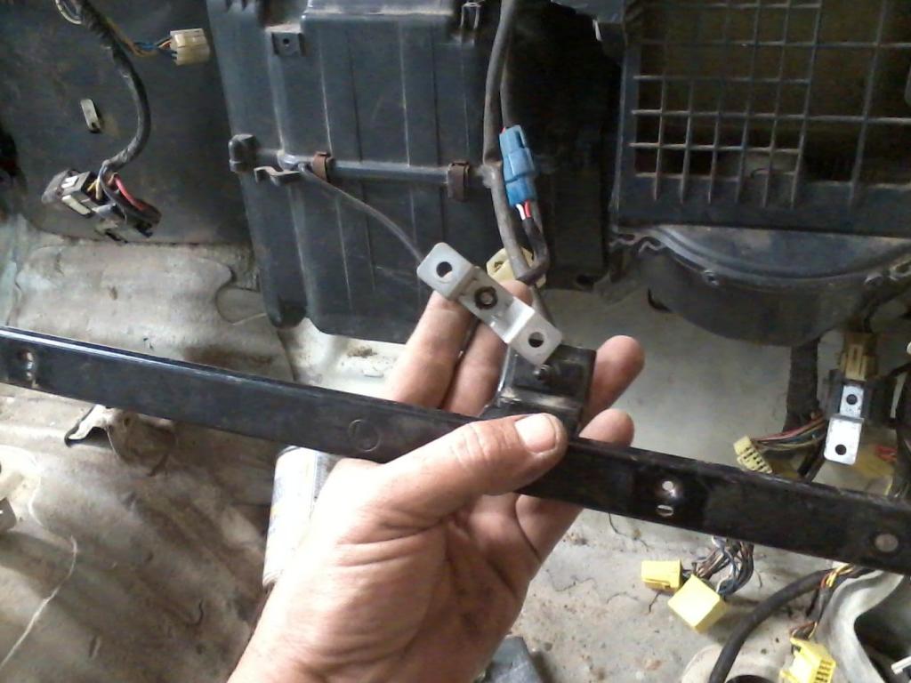

You have to have the Glove Box Light option installed in the main harness. The bulb is on top and the bottom bracket has a tab weled to it to control the light. A new part I will be keeping an eye out for when in the yards.

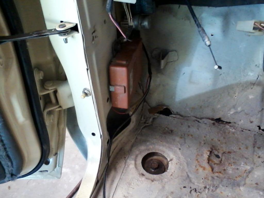

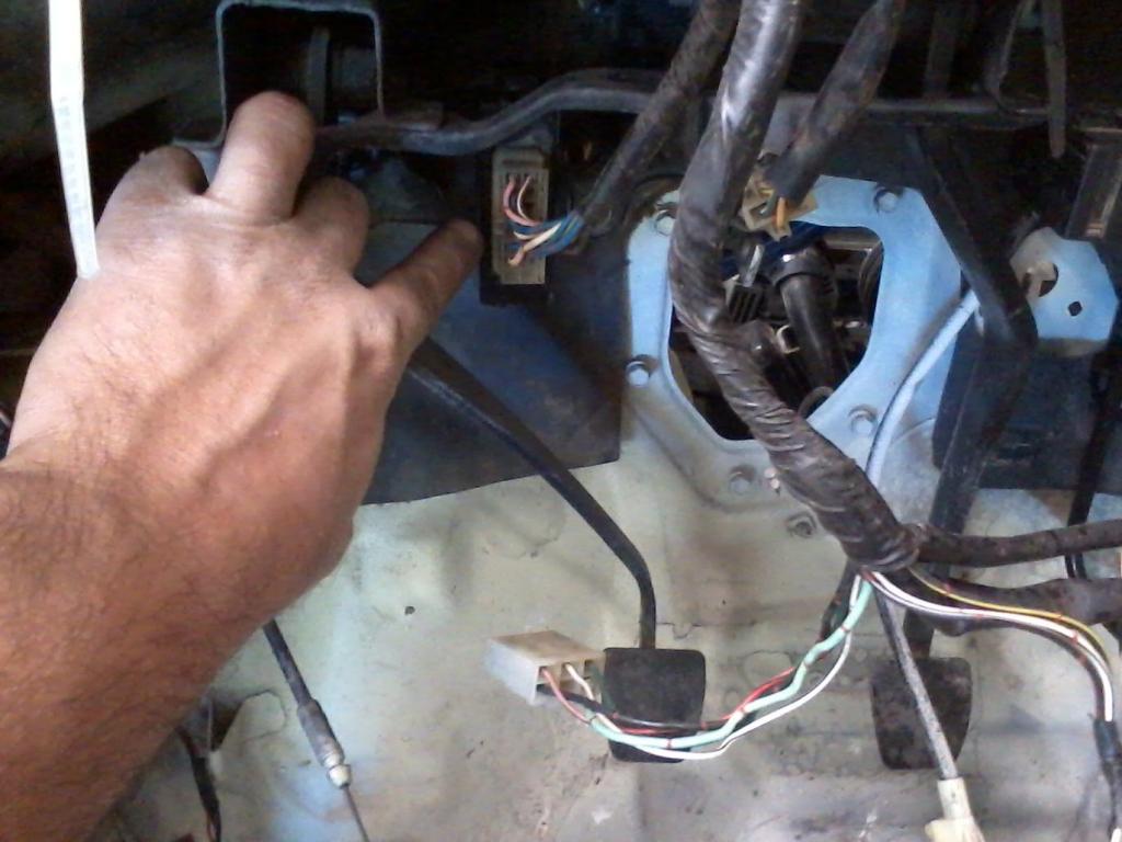

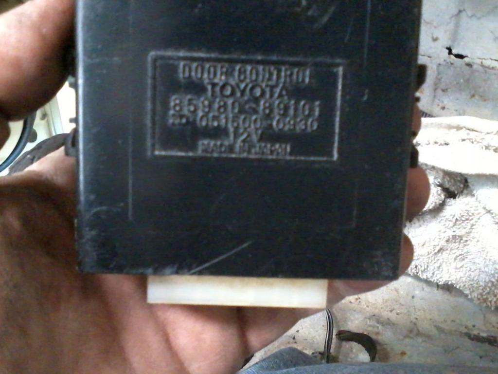

Door Control Box.
It goes above the clutch pedal. I dont know what it does, but it looks good doing it.

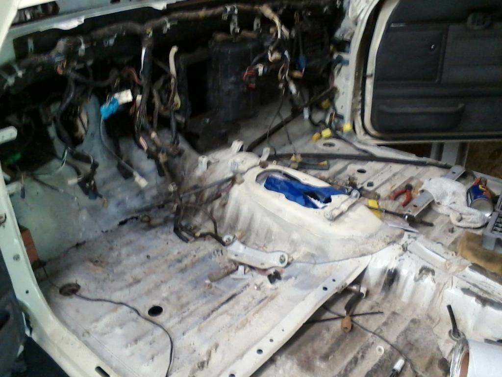

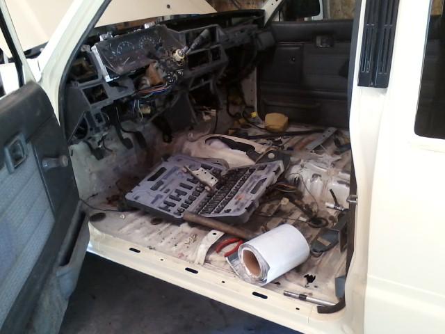

I did get some time to get the shop organized again by getting some of the parts back on the truck. I got most of the dash back in. I did a few electrical checks and so far so good. I will eventually get the interior tan but now I want it to look descent, find what parts are missing as I am having to assemble the whole interior from what was in it before.

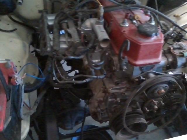

I have been working on my 3rd gen lately and it is taking up the funds for my 85. I have been doing some small detail work on the 85 when I get the chance. Been busy with work and a few other things.
I did pull a goof butt move. My check engine light wasnt working so I looked and there was no bulb in the cluster gauge. After putting in the bulb I still did not have a check engine light, so I started checking some things out and finally I thought I would check the connections on the computer. That was the problem. I had removed the computer and it wasnt even hooked up at all. I actually had the computer in the bed of the truck. Doh!!! Once I installed the computer, Wah laa!! the truck fired up. Wahoo!!! I finally have a great working harness and should have all the options working soon. Still a long ways to go but it is a big hurdle crossed.
Running!!! 12 second video.
