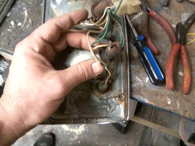

Another thing I got fixed on my 91 was the horn. I know this happens alot and hopefully this will help some in the future. Pull the steering wheel with a Steering Wheel Puller that you can usually rent from a parts store for free. Then check it by touching the brass spring in the 11 oclock postion. I just used my wrench. If it honks it is most likely the brass ring on the back side of the wheel. Not the best picture but you should get the idea.

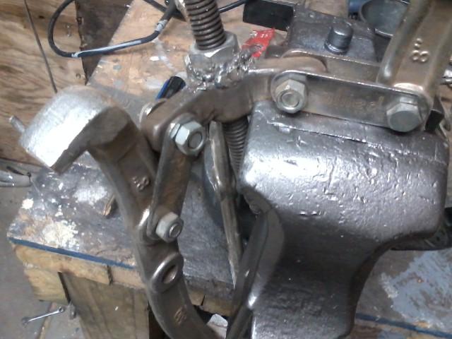

A friend of mine and me tried to pull a pulley and stripped the center of the pulley out. This is my first weld in 25 years that I have done. As long as it works it will be fine for me. I do plan on spending some time on my week off learning to weld. I did do a test on the welded nut and it held so am happy with it. Definetly not pretty but functional.

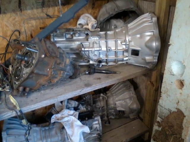

I went to start it and could not get into reverse gear. I have a couple of forward gears, if I recall right this one has 1st and 3rd out.I know I have a bad G52 transmission and am keeping it for parts and for learning to work on. I am thinking I may have put it in the truck instead of the good one, Doh!!!
Here is what I am thinking is my good transmission setting on the shelf. Grrrrr.....

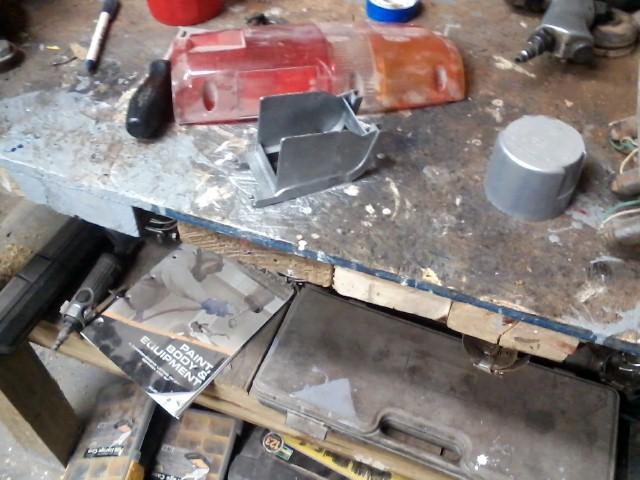

I got this idea from 4Crawler. For a little more illumination, paint your light seperator silver instead of leaving it factory black.

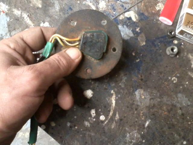

I replaced my fuel sending unit. I still dont have enough fuel in the tank to see if the gauge works. A lot of these trucks, when you get to 1/4th tank or less, the gauge is not accurate. Here is why, the wires are just worn thru.
When installing a new fuel sending unit, the flat part of the triangle should be pointing the drivers rear bumper.

Got the bad tranny out and marked it. Got smart and turned the shaft on the other one and all gears were working, even reverse. It is easier to swap transfer cases with the transmission standing on its end. I didnt get a picture of it but I have tried with the transmission laying down and it is a royal pain. Manuals even suggest standing on end.

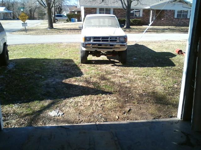

It moved out and in the shop on its OWN power!!!!, at 12 oclock. Shifter is being difficult but I can shift it just fine without the stick in it. Probably just needs a new shifter bushing.

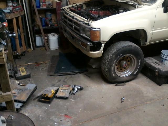

New Brake Master Cylinder installed. Still no brakes. Calipers are frozen and rear brakes are not operating.

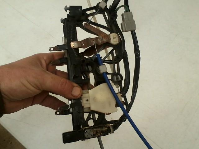

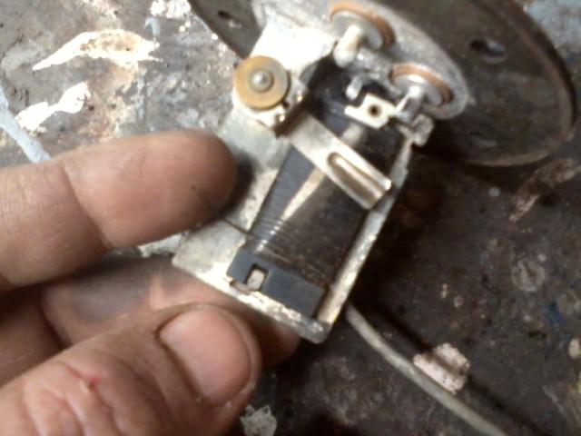

I had five heater control assemblies and it took all of them to make one. I still need another cable to have this one finished. Usually the blue cable that attaches to the heater valve on the fire wall gets bent up due to the valve sticking. Once the cable is bent, I have never gotten one to work right. Also some of the tabs that hold the cables snap. A poor design but it is what is on these trucks so have to live with it.
Some have a 3 and some have 4 speed switches. I am sticking a 4 speed switch in mine just to have an extra option. I need to get a heater core and some interior paint and that should be soon. Taking the dash out isn't as bad as it is let on to be, the pain in the rear part is getting the heater control cables to work right.
5 controls to make just this one. One of the biggest project left on this truck getting closer to being done. Some of the others like exhaust and windshield will be done by a shop so those are really counting on me to get done.
