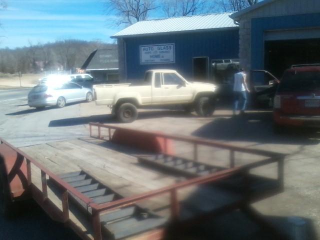

Dropped the 85 off at the windshield shop. Was suppossed to do it yesterday but was to tired. I replace the brake pads but did not get them bled out. Luckily low range was geared low enough to get it to the shop with out brakes.
Tomorrow or Friday it goes to the exhaust shop. Picking it up from the windshield shop tomorrow.

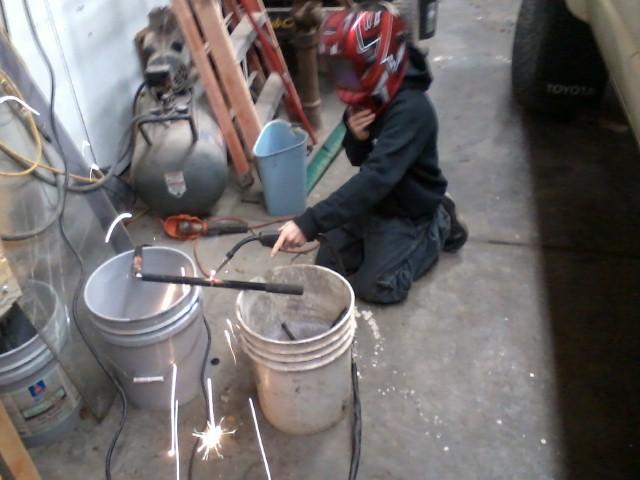

I was out tinkering on some things and Hunter wanted to know about the mask and did not know I had a welder. I let him give it a shot.
Here is his first weld. It didnt hold up as I was able to get the bolt off of the bar tht I let him weld it to. He still liked it. I will not be the one that fixes their trucks in the future, they are going to know how. They already know most tools and how to get around in the shop.

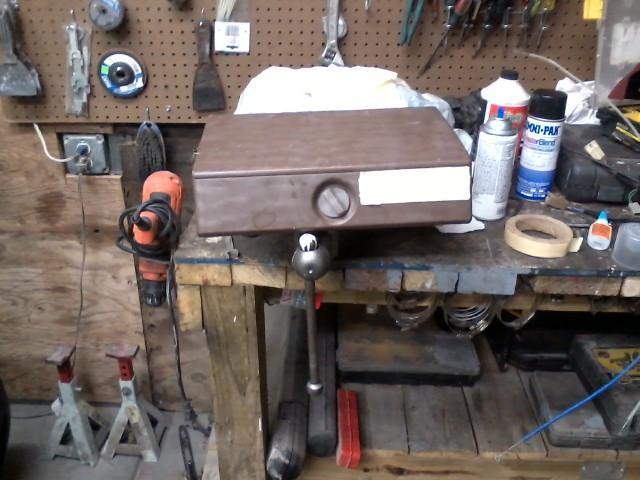

Starting to put my dash back together. The plastic is faded and dead in areas. One thing that can make a truck more enjoyable is just having a nice interior. I was against painting plastic in the past as it always looked terrible. That was I had always seen regular paint used on interiors. It has to be interior paint.
If I was buying my trucks back in the 80s, A white Runner with a red interior and a Creme truck with brown interior would of never have happened. Now the white runner is my favorite all time truck and never would of thought I would of want a brown interior with my pickup. I have a nearly completed gray interior for it but just doesnt seem to go with the creme color and is how the factory sent it.

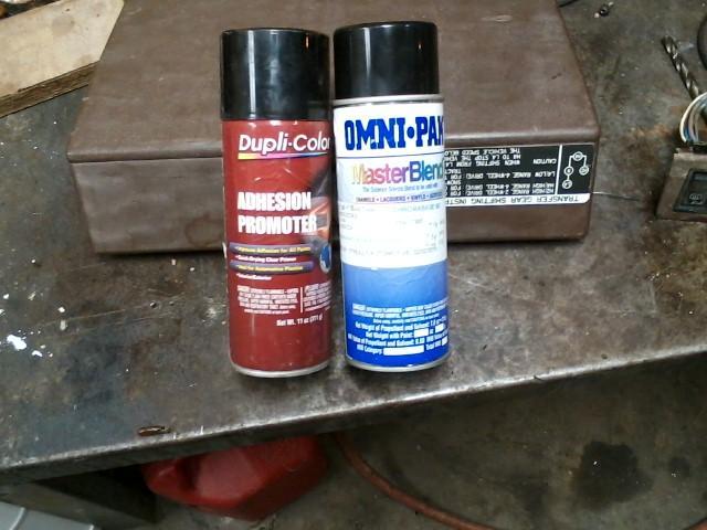

You have to use Adhesion Promotor before using paint. Cleaning it is the biggest time consumer. Doesnt take long after getting it cleaned.
Will get some painted pictures up later as it is done. I wanted to keep the shifter label so masked around it. Shows more of the faded as well and the after does look better.

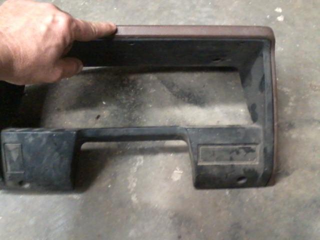

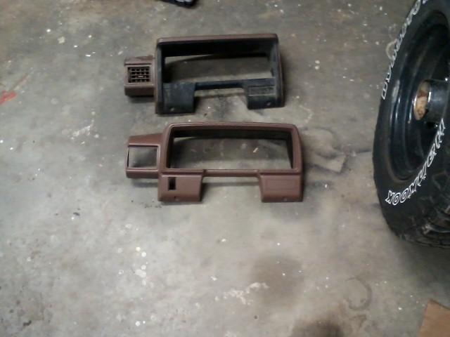

I had to go help with a few things so will update what I got done so far. There are two different types of Speedometer Bezels. Both are interchangeable but I like one kind better then the other.
The one I like is more pointed and has less black showing.
Here is the other sytle. It is more squared off.
Both of them together.

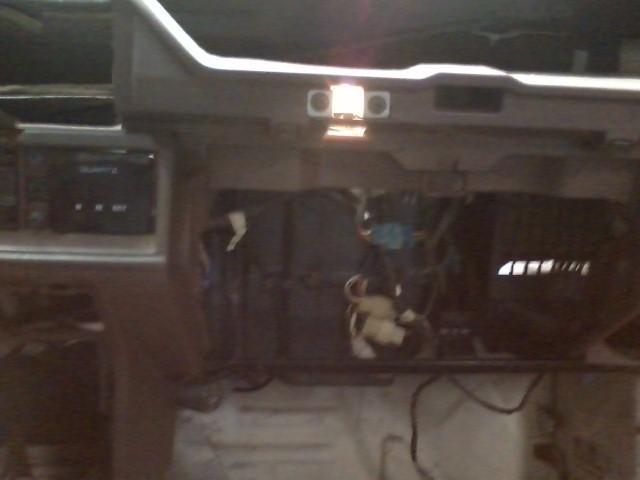

Got my glove box light working. This has to be factory wired into the harness to add this option. Sure it could be added by hard wiring but something I dont know how to do.

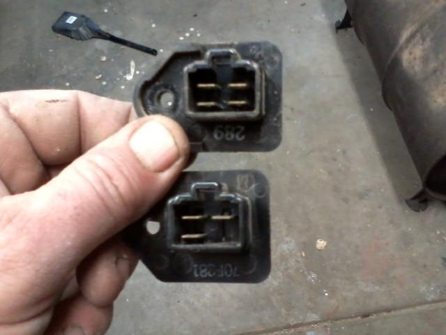

Some have a three speed fan switch and some have a four speed fan switch. I installed the four speed fan switch in mine and have all four speeds working. One thing I have run into in the past. Some have a 3 pronged resistor and others have a 4 prong resistor. Double check as to what you have. Not sure which years used which.

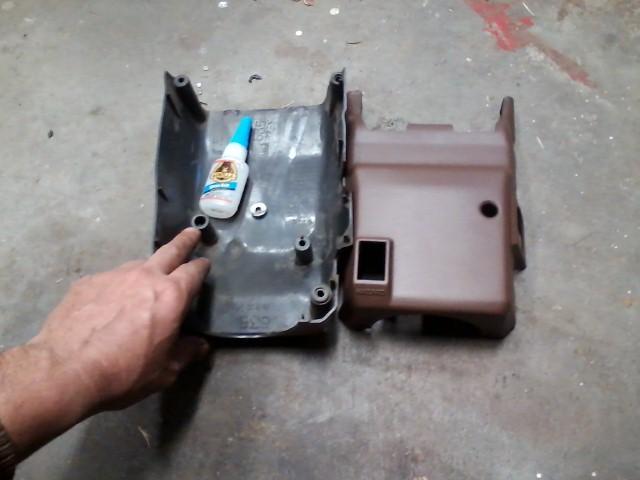

Same thing with the Steering Column Cover. I painted my brown. I see several covers where someone gets over tight and breaks the inside tabs. I use a washer and Gorilla Glue to fix those broken items.

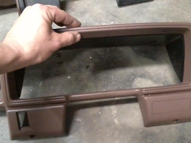

I got most of the dash in. I am currently working on the speedometer cluster. The lense was in bad shape and will finish it tomorrow.
