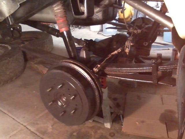

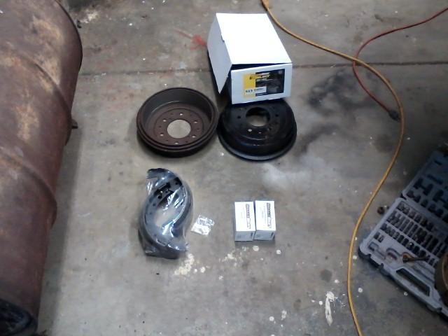

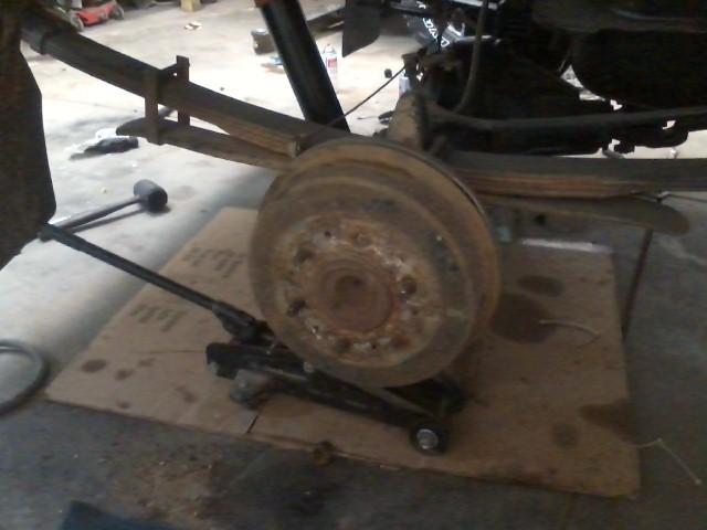

What should of been an easy job turned into a several hour job. Getting the drum off was a royal pain. The 12mm bolts stuck in the drum and would not come out. Finally got that taken care of and the parts I ordered are the wrong ones. I ordered them off of the internet and both the slave cylinders and pads are wrong. Argh!!!! I will just get some from my local parts store tomorrow.
Pain in the rear side. Before
Some more detailing I did and got the hardware cleaned and ready to go. I did luck out on that, that it does not need replaced.
$110 later that was unexpected, I got new shoes and slave cylinders, I also got the drums turned. Will be having a friend to help me install the shoes. I tried but have never been able to get them on right.
I did get the one broken stud replaced so made some progress.

Two days basically messing with the rear brakes and still not done. I will be having a friend to come over and help me finish it up tomorrow. I would read the book and compare to the other side and just was only a few steps from having it done each time but it was always something. The extra cost will set me back until next week or so on finishing up my interior for what I had planned but I should have good brakes all the way around when done.

Thanks Hab... I think I finally won it. I had a friend to come help install them and he showed me a trick or two that I think will work. I am actually looking forward to doing another rear brake job, just not on this one, haha. I was talking to Jason and he was actually stuck between me and you on 44. We did not get it to bad here. Im ready for spring.

Got my brakes on. I pinned each pad and was trying to work from the bottom up. My friend showed me to work from top down. Think I may finally have the rear brakes figured out. Got to work on why parking brake lever does not want to function correctly next. It has been a slow but steady battle. i spent from 7 am to 3 pm trying to get them installed, but I did learn a little.

They had several accidents on 44 due to the weather and he had to wait for them to get it cleared out. When I was coming home from Joplin there was some more accidents. People are just driving to fast for the conditions. I talked to him just a little bit ago and he is now in Oklahoma.
I am fortunate to have patience as it was a longer repair job then what it should of been. About 7 hours, I should of learned something. lol

Got my brakes bled and took a short spin in the truck and they work fantastic. What a relief. Also got the head off of my brothers truck. Take it into the machine shop tomorrow.

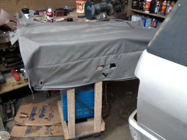

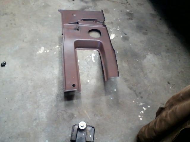

If my math is right, I just went over the $2500 mark on my build. I have been trying to keep track of my expenses and it is about where I thought I would be. I figure I have another thousand just to get it in driving condition, mostly tires and axle and another thousand for stripes, towing accessories, stereo and a few other things that I know will come up. New motor, clutch, brakes, windshield, and exhaust so am hoping I will have a dependable truck when finished.
Got another can of interior paint and was hoping to get the interior put together but I ran out of paint and left a seat belt at work that I was fixing and it has to go in before anything else so that held me up til tomorrow.
Headliner took more paint then I thought. Also I will replace it with another one at a later time as it does have a small rip in it. No hurry as it is not noticeable really. Besides I am in no hurry as quite a bit is required to install a headliner. All rear glass comes out and it would help having some clips and when Misty has time to help me with it.
Painted headliner pic did not turn out and will get one later.

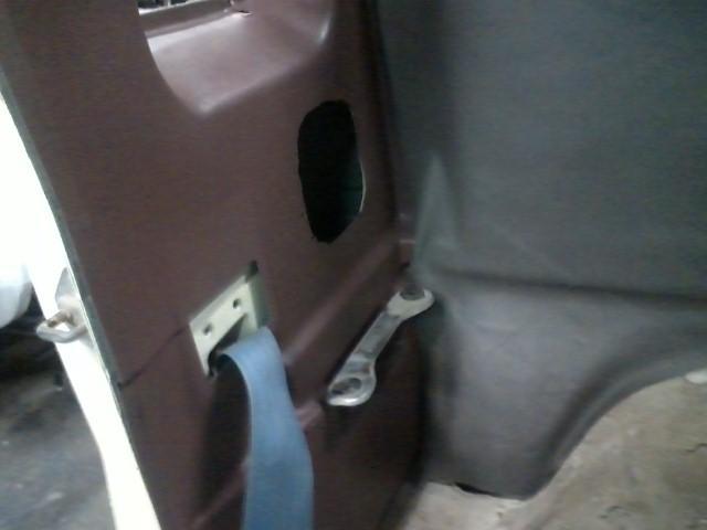

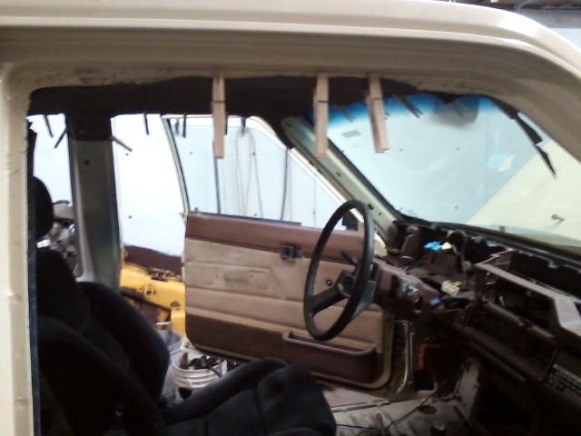

Starting to put the headliner back in. Normally it isnt that big of a job but the headliner has shrunk a little and the back glass seal has expanded a little which is making it a little more difficult. On a back glass or headliner, from now on I will do them in the same day to avoid the difficulty.
Here I am using clothes pins to help reform the edges. Only reason I dont have my dash together is I need another speedometer cable. I probably got one out in the shed but it is 19 degress outside and it can wait. Nice and toasty in the shop though.
Mostly a reference picture for me in the future. The side panels go in first and the rear panel goes in next. The brackets can be used to help hold them all together.

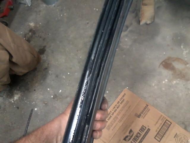

These little clips help hold the headliner in and sit behind the window glass seals. Next time I am at a bone yard I am stocking up on these. They make installing headliners so much easier. These are factory.
I am using a little Dawn dish soap to help install the side and rear glass.
Where I dont have clips, I am using a drop of Gorilla glue and holding with clothes pins.

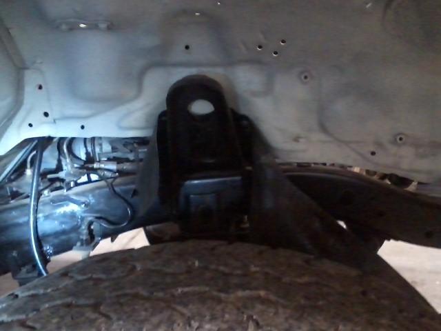

While waiting for some Gorilla Glue to set up, I thought I would try and find my fuel leak. When I took it to the muffler shop and moving it around the house, I get a whiff of raw gas. I loosened the bed bolts and then my air compressor seemed to stop working grrr... will look into that next, lifted the bed and did the fuel pump jumper. I wont post a picture of the fuel pump jumper here as the 85 and 86 trucks have a different way of jumpering then the newer trucks as I am using an 87 harness. I have a picture of an 85/86 jumper and will post it later.
With the jumper in, key on, it circulates the fuel thru the entire system up to the injectors. Not thru the injectors. I cant find any leaks so it has me wondering if it is leaking at the injectors when running. I cant see any leaks at this time.
For those that think changing a filter on an IFS truck with the access plate is difficult, the solid axles dont have the access plate which makes it that much tougher.
No Access Plate. ( No shocks either just yet)
