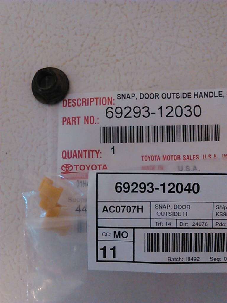

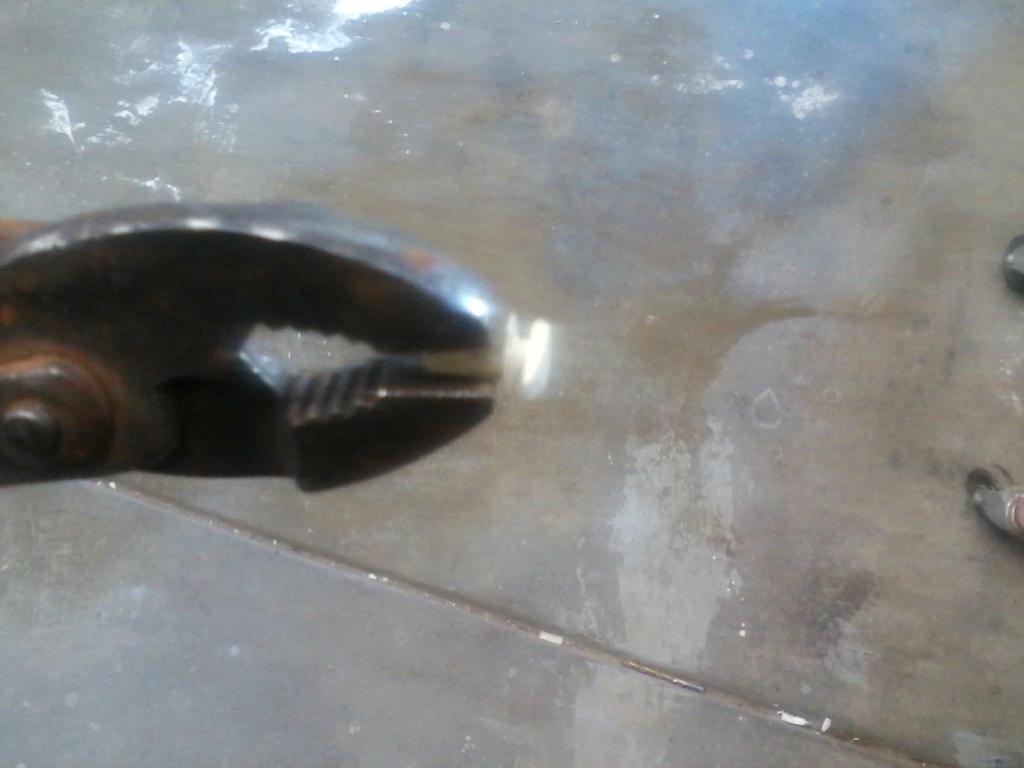

The paint project is coming along nicely. Are these the door clips you were saying break? It says yellow for drivers side, white for passenger. They are $5.99 for 10 on eBay. The dealers near me do not stock any parts. I went to get something for the 3rd gen and had to wait 4 days for it. eBay or online Toyota dealers are faster and cheaper!
Old Sep 23, 2014 | 07:28 PM
  #462
Terrys87's Avatar
Posts: 11,787
Likes: 28
From: Anderson Missouri
Hello Nervo19... That does look like them. Can you post the link for them? I normally get parts from Overstock or Partseast if I am positive I know what I am getting. The Joplin dealer has always been quick for me. I hear other dealers are slow. I am getting ready to order ball joints for my 3rd gen and wont be getting them from my local dealer. Whew!!! They are expensive. Surprised at the difference in cost from Toyota place to another.

They are 5.78 plus 1.99 shipping for 10. They are shipped from China but I've been buying LED bulbs from China and they arrive in 5 or 6 days. The seller has a ton of other clips that look Toyota familiar.
http://www.ebay.com/itm/Each-10-Pcs-69293-12050-69293-12060-Door-Lock-5mm-Rod-Size-Clip-A20534-A20535-/400778117503?pt=Motors_Car_Truck_Parts_Accessories&hash=item5d503cc17f

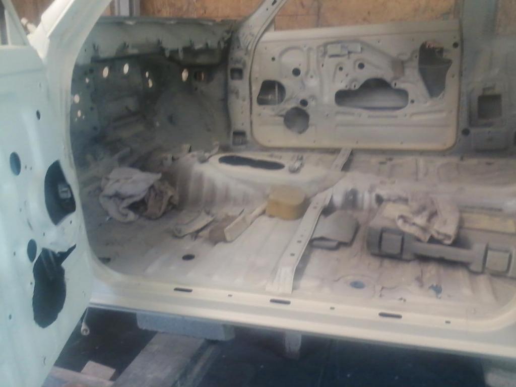

Got the cab painted. Supposed to have some help getting the cab on the frame tomorrow. My shop is a mess from painting. There will be a big clean up day when I get the cab back on. Always is when I paint, but is all to due to painting. Most of the material laying around has to do with it.
Put a light coat on the inside to hide the white. I will be insulating the inside so much of it will be covered.

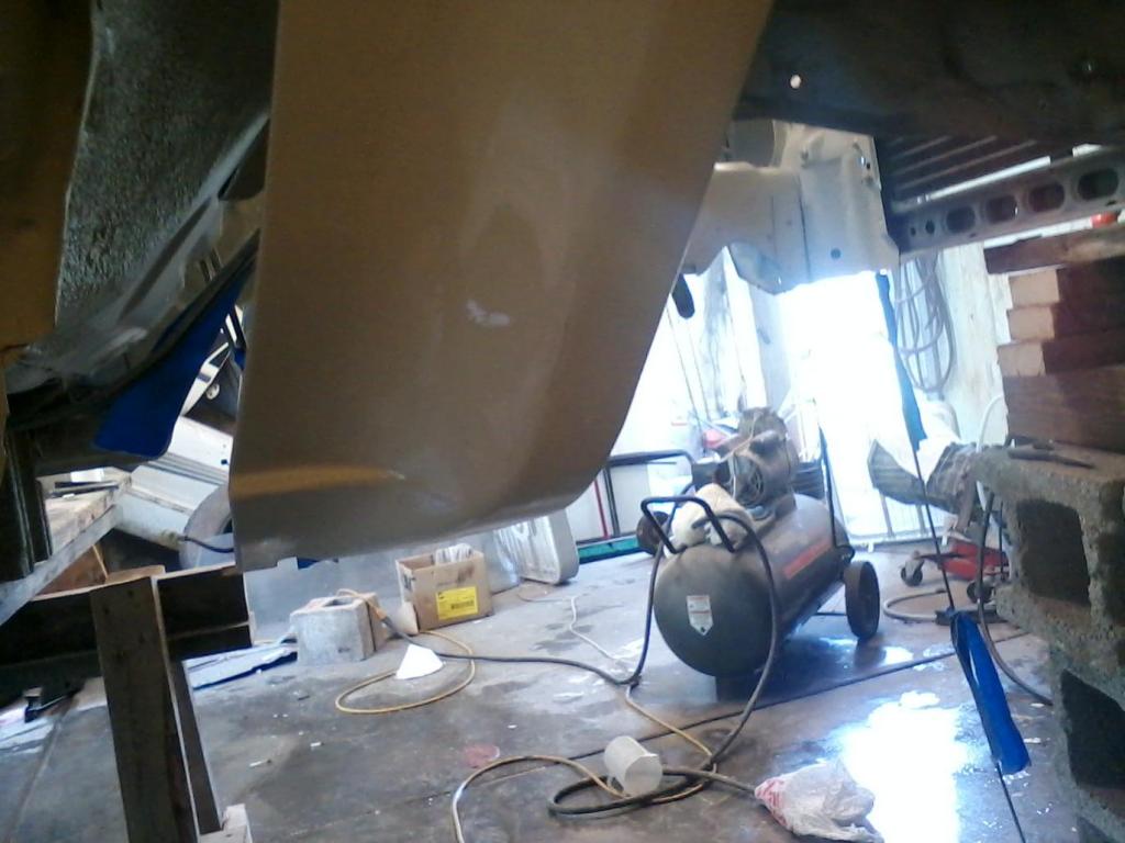

My air hose splashed a little water on the drivers fender. I bumped the edge of the passenger fender with the air hose and the lid was not completely on when I clear coated the roof so have a few drops that I will need to wet sand later. Hope alot of this will buff out. May be hard to see but is it right on the crease on the passenger fender.

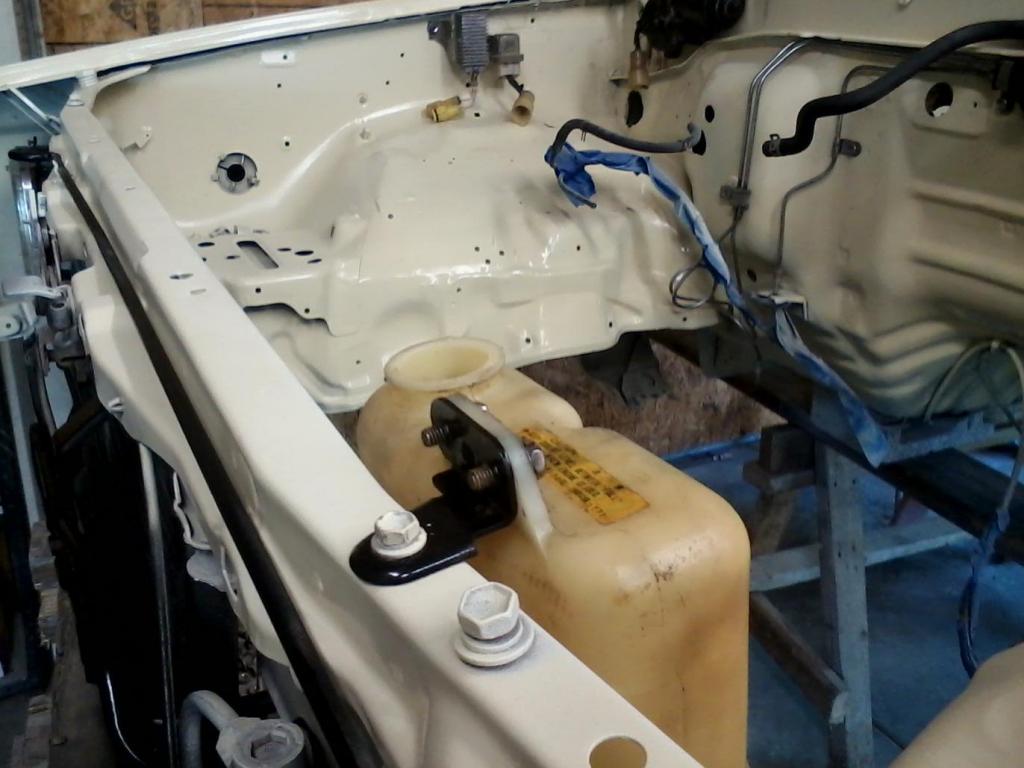

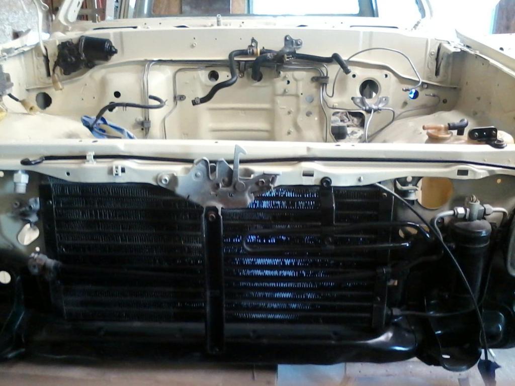

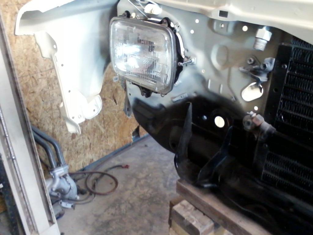

Got my headlight buckets in. I also painted the core support similar to the way Toyota would of done it. This is how it was and most trucks I have seen done this way.

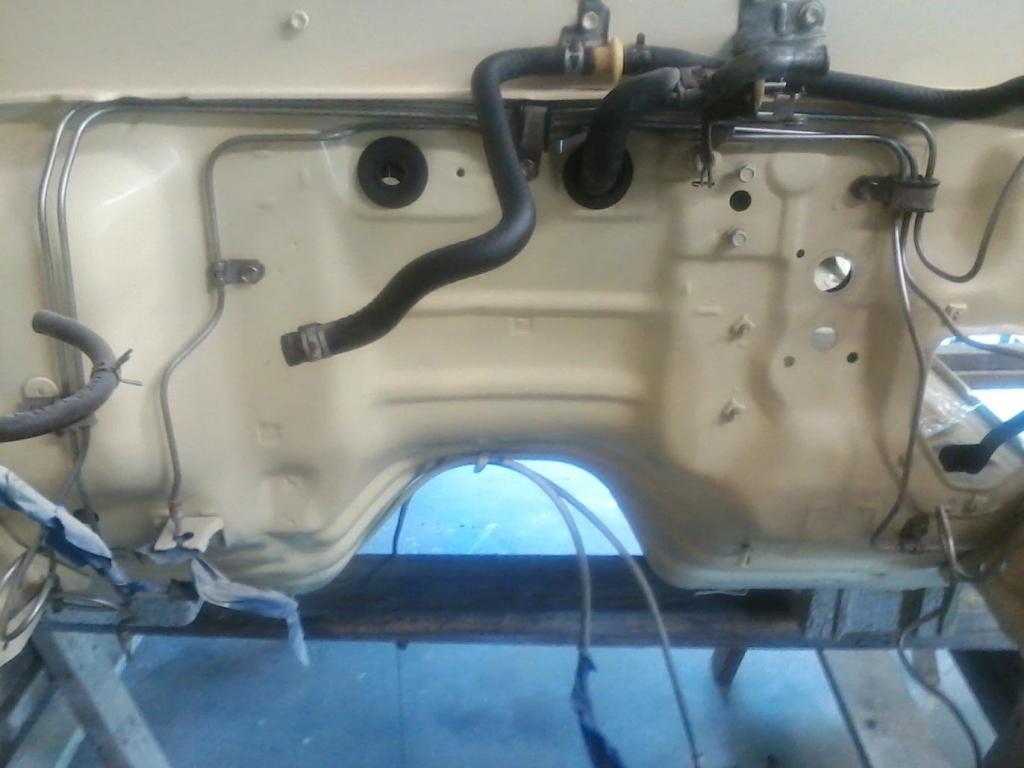

Cleaning and painting parts that I can that wont be in the way later. Got the brake and clutch lines in. I left my booster at another shop or would of gotten that in.

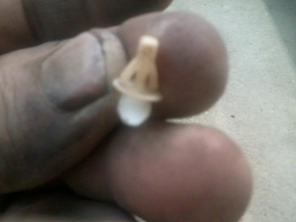

I found a set of door seals on a camper that were in great shape. If you have strong fingers, sometimes you can squeeze the tabs to get them to release from the door. The squeeze tab is 90 degrees oppisite of the hook tab that goes to the door seal.
Here it is in the door seal.

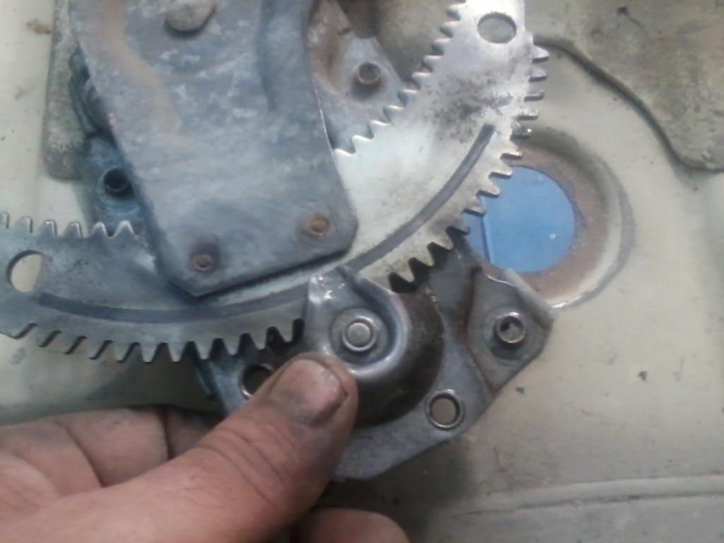

I am working on several different things. The window crank on this one is good. The cone where the pivot pin is, is nice an tight (where my thumb is). If it is wallowed out, you will need to replace the window crank. I have run out of grease, but eventually I will put a light coating on all pivot points. The biggest reason the windows get hard to roll up is the rubber seal in the door just needs silicone grease to make it roll up so much easier. I have that posted on my 88 Runner build below if info is needed.

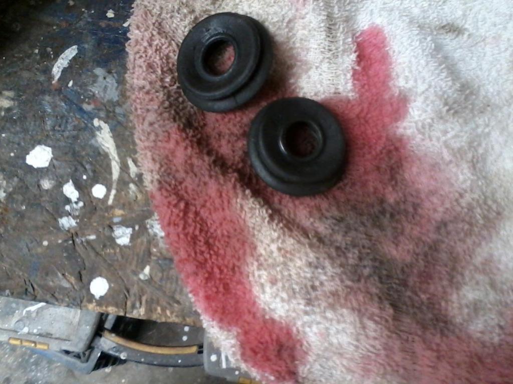

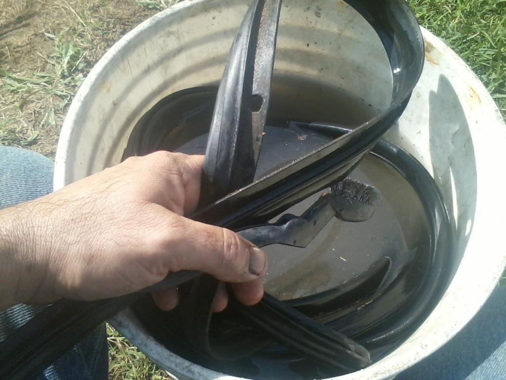

Here I am letting the seals soak. Water was clean but now is nasty!!! This is the windshield cowl strip. A wire brush will help get some of the gunk and dead rubber off. Also have the other door seal soaking.

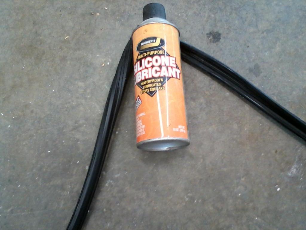

Here is the window seal that goes into the door. One big fix for hard to roll up windows is to soak the track in silicone. Makes a big difference. After I get the windows in I will use some black sealant to help hold them into the tracks.

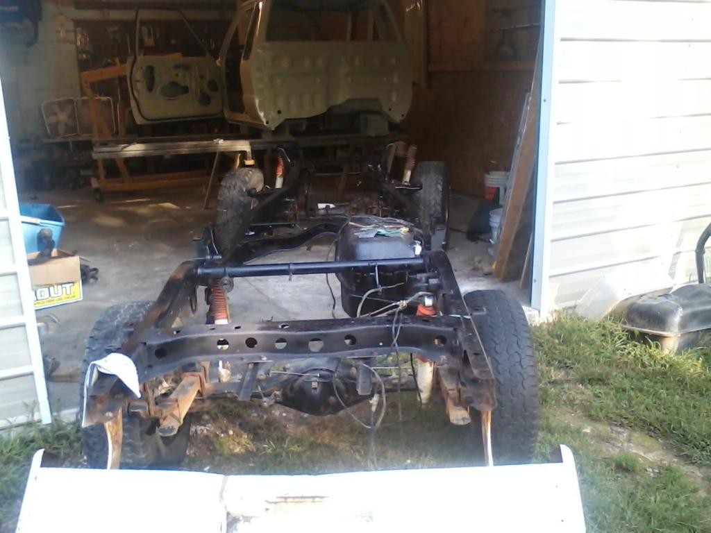

Waiting for some people to get home from work and hope to have the cab on the frame here soon. Getting closer.
Got the cab on at 7:15 this evening. The black and tan goes together will well. I have always liked chrome but the black does look good on it. If I keep it balck and tan, I would have to call this the Dobermin Pincher.

Hello Ed.. The silicone can make a big difference. I have struggled with windows in the past that almost would strip the handles splines out. It will take two or three coats and working the window up and down to get it worked into the rubber, but if that is the problem, it will make it where you can roll the window with just your thumb and pointer finger. It can make that big of a difference.

Your Welcome Mark...It can make a tremendous difference. It seems to work even in extreme cold as well for me. Mine did great last winter and it was coldddd.

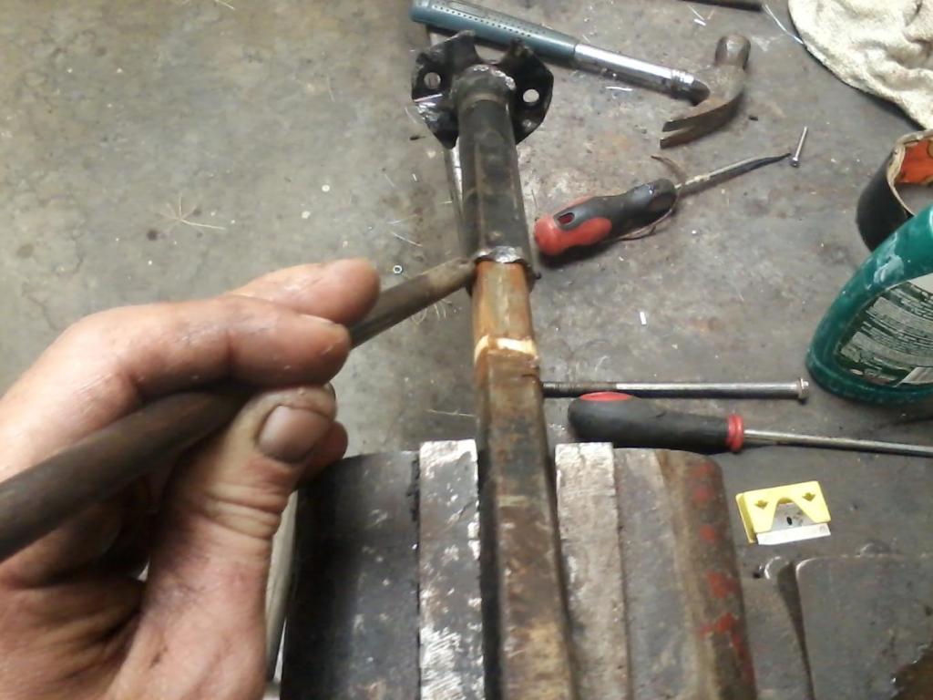

When I had to pull my Steering Column, I had to pull from the wheel to the ragjoint. Normally you should be able to seperate it at the bottom of the column, in the center of the shaft or at the ragjoint. Not the case for me and not the first time I have experienced this. The shaft is designed to collapse in the event of a head on collision to keep the steering wheel out of your chest. Every shaft I have seen, the center section is frozen.
Once I get the shaft assembly out, I soak it in PB Blaster or something similar and just use a rubber hammer to expand and compress it until it works its way free. This one took the Big Freaking Hammer to get worked free. Been soaking for quite a few days and still would not seperate at the column or center section.
Should be able to remove bolt and then compress shaft to get out. Most shaft will not compress due to rusted together. With the shaft in a vise and a hammer, I got it to seperate.
I had to use a punch on this to get to seperate along with trying to compress it with a rubber hammer. Finally got it. I cleaned it up and it is operating great now. I do have a spare that I might use instead.

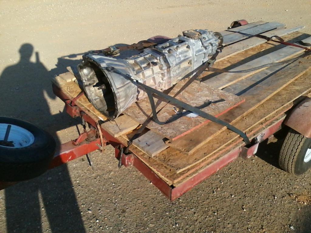

Cleaned my tranny up. Still have a little more cleaning to do and will get some new gaskets for it.

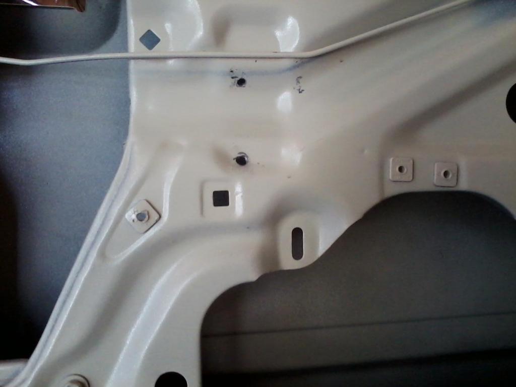

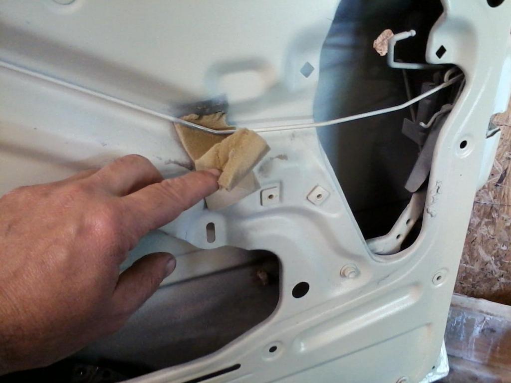

This is my passenger door and it does open like it should from the inside. The drivers side does not. I was comparing the two trying to figure out why the passenger did and not the driver. I then seen this little foam. It helps hold the rod into the valley impressed in the door and that little bit makes the door open.
Here is the valley with the door handle pulled to open it and you can see where it is out of the valley.

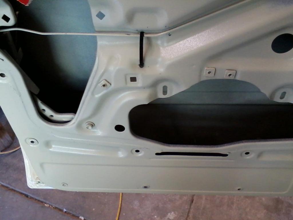

Not the best fix in the world but is a better system then what Toyota did and it is working great now. I drilled two holes and used a ziptie. I will see if it is going to interfere when I stick my windows back in and let you know if this will work. Either way it will be a similar fix if it does interfere unless someone has a better idea on to do it.
A friend of mine and me have seen this issue several times and surprisingly I dont ever see this pop up on Yotatech or even seen a thread on it.
High Tech door fix.

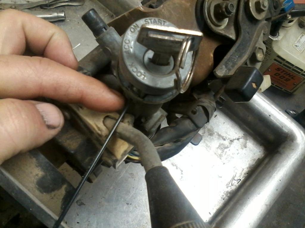

I have been going thru my steering column. For some who may not know how to get the ignition switch out, it easy. Been a lot of stolen trucks popping up on the main page lately.
The key has to be in the ACC position. When it is there, just use a small allen wrench and push in the tab. This will let the switch slide out. Reason it has to be in the ACC position is the tab at the bottom of the assembly.
Release button.
Button and tab I was mentioning.
