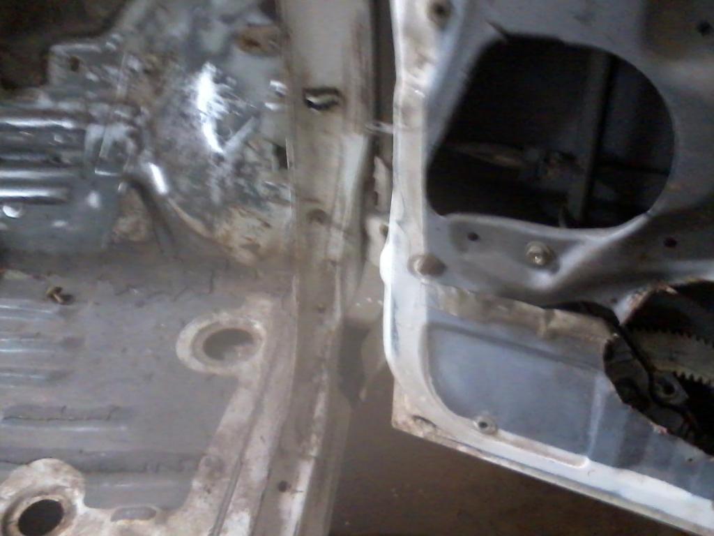

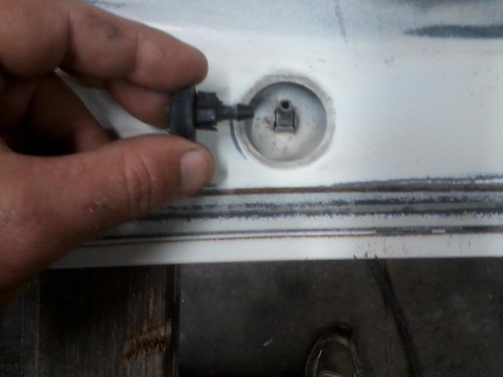

This is not the windshield sprayers I like. They have a skirt on them and I have difficlut time getting them off. The other style just pops right in and out and I will post pictures of them later when I get a set. They easily interchange.
With my hand on the top side of the hood, I support it and then thump the nozzle a time or two to get it to pop out. Not the best way but these can be a pain to get out.
Here is what they look like out.

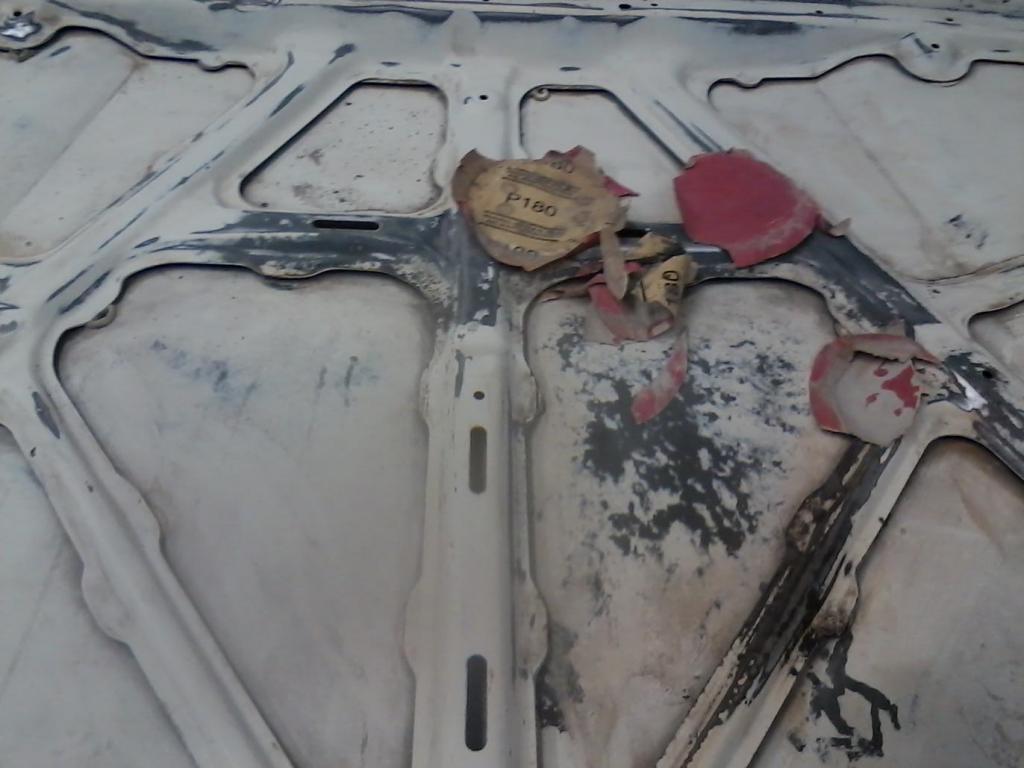

All of the edges on the hood is eating up sandpaper, grrr...

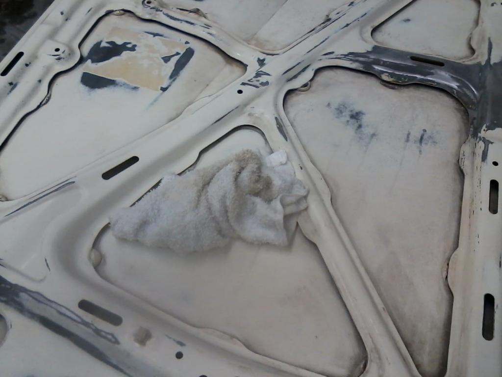

Here I use a wet rag with a few ounces of thinner as a degreaser. Under side is finally done and will be getting primer on soon.

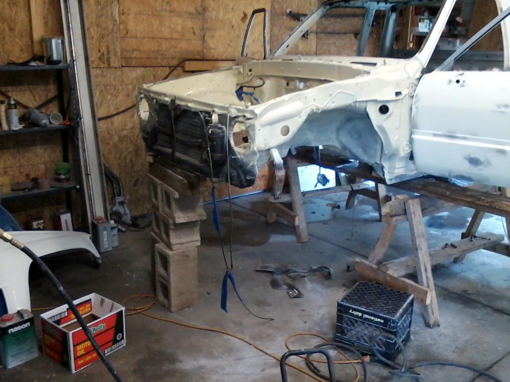

Starting to fix my goof up. I am going to have to get the cab higher yet to get a spray gun in there.
Here with the wet rag and thinner is where I am degreasing the truck. Will do the whole truck a few times. Before.
After

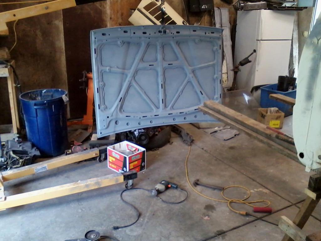

Got the underside of the hood done, inner fenders, and cowl. I am only going to coat them with primer and paint as it wont show. Better then what the factory did. I wont use sealer on these parts.

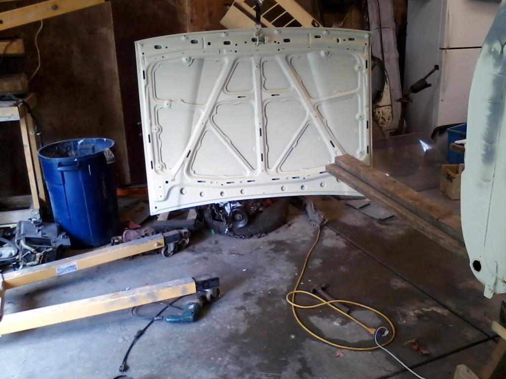

High tech hood holder thingy. Cherry picker and a tie down strap.

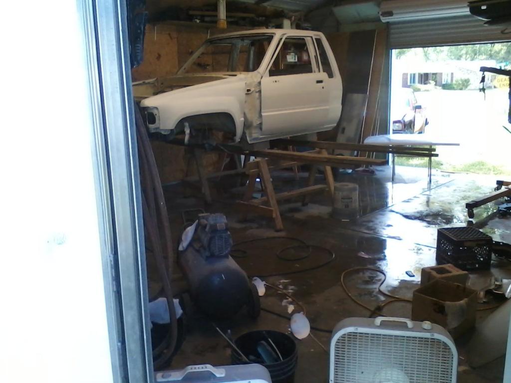

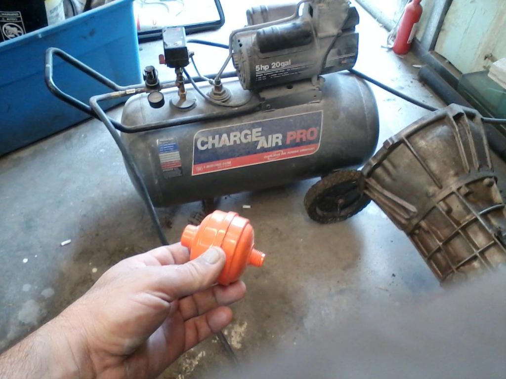

With my million dollar shop ( yeah right) this air compressor will do the job. It is what I have used to paint every truck I have with. You are not on the trigger every time and my air gun is at 40 psi and the tank goes to 120 psi so it has plenty of time to catch up. I drain the tank in between stages and also use a disposable air filter that will catch any moisture.

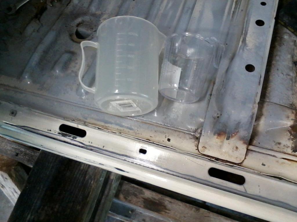

Those paint mixing cups are to complicated for me. Jason showed me this trick. I use ounces or millileter cups. The paint will be a 2:1 ratio. 200 millilters of paint to 100 milliliters of activator or just double what I need. So much easier then those paint cups. I have been wet sanding the truck and am taking a break and letting it dry out.

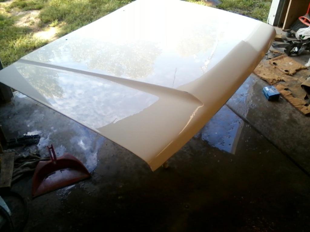

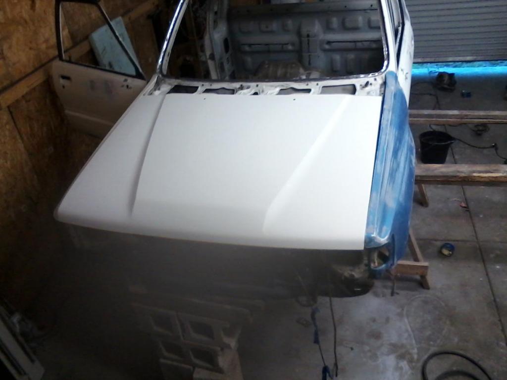

Got the hood done. I still need to clear coat it but I need some activator for the clear. Something I did forget to get. It has turned out great.

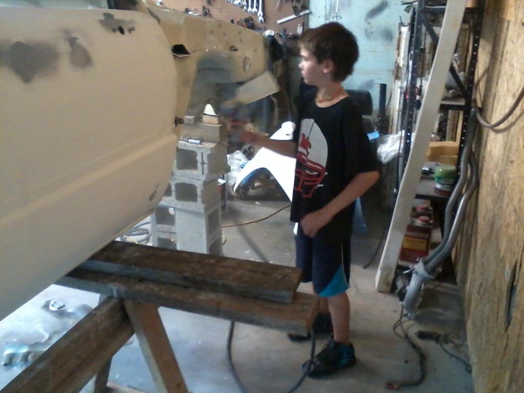

The brats did get to shoot the clear coat on the inner fenders. This wont show and gives them the feel for painting without doing to much damamge. My mask would not seal up on them so I had to let them do it without a mask but did have the air flow going good.

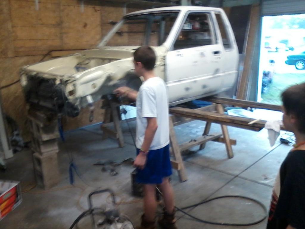

Clear coat is the one I will have problems with. I have never run paint but clear will run or orange peel on me. It is easy enough to fix just so much better when it lays down right the first time.
Justin shooting clear for the first time and they both actually did a great job.
Hunter doing his part. Probably did better them me, lol. I got the hood done just did not get the picture. Base coat has a dry chalky look. The clear is what gives it the wet, bright look.

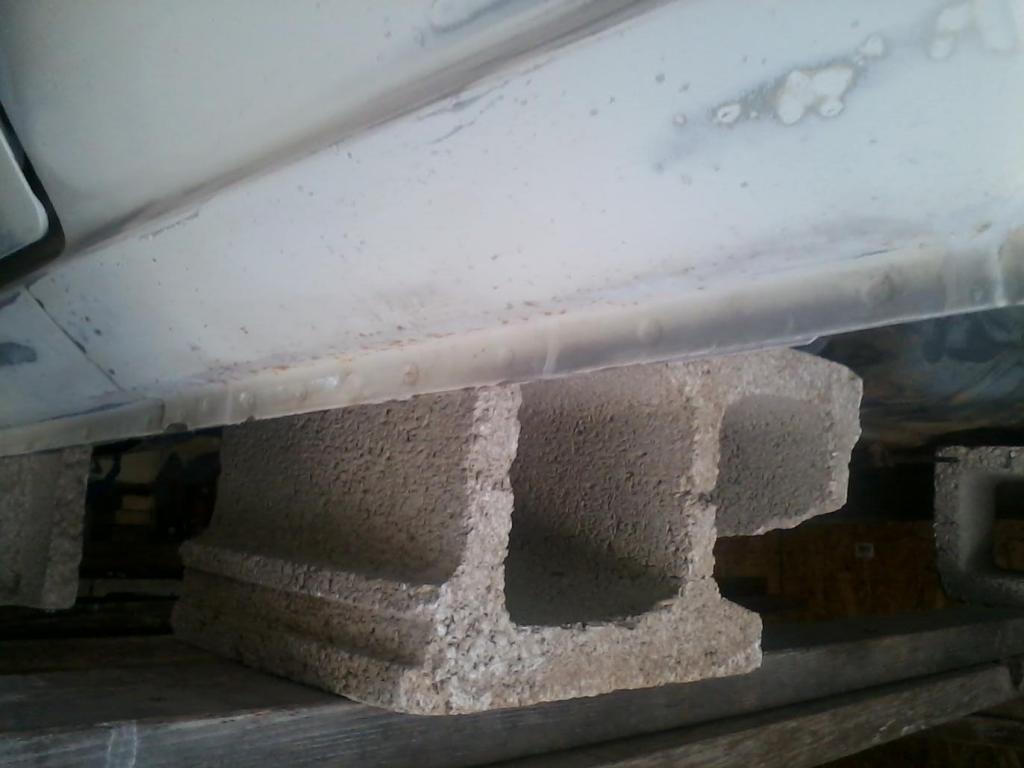

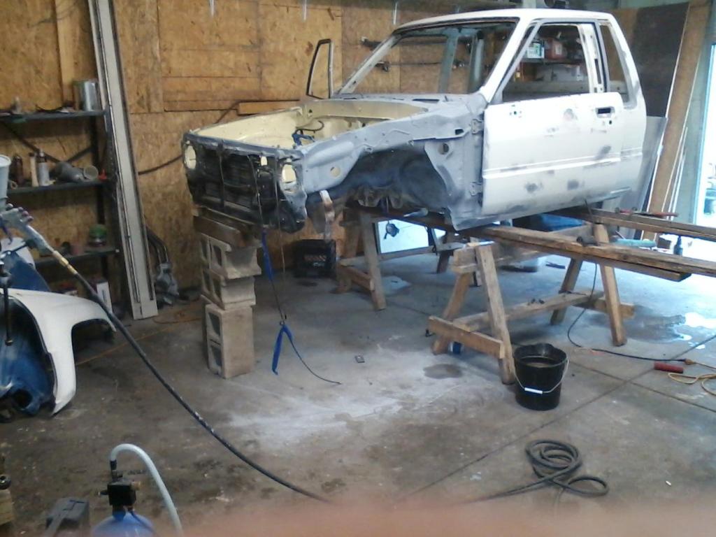

Nearly got the truck ready for paint. Biggest hold up now is getting it high enough to get to the rocker panels and finding a way to paint the roof and high parts of the truck now.

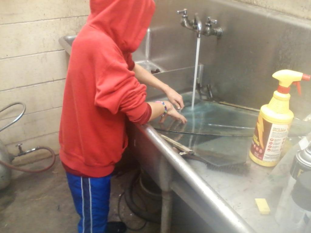

Here is Hunter getting the tint off of the side glass. He just wanted to hurry up and get it peeled off. I tried to explain that he needed to get the glue off as well as the tint. Don't think he quite understood as he just liked seeing the ting come off. He got it done. I did have to go back and get the glue off at a later time. I got the other two bushing I needed for my lower control arm for my 86 runner and hope to get my front end rebuilt here in the near future for it. I have everything to do it now, just need to get the parts on.
What took me ten minutes getting all of the tint and glue off, took me an hour to get the glue off of what Hunter left behind. If you use heat and slowly work it with the tint at the same time it will come off so much quicker. I spent an hour getting the glue off of the one Hunter worked on. At least he tried and he did better then I expected.

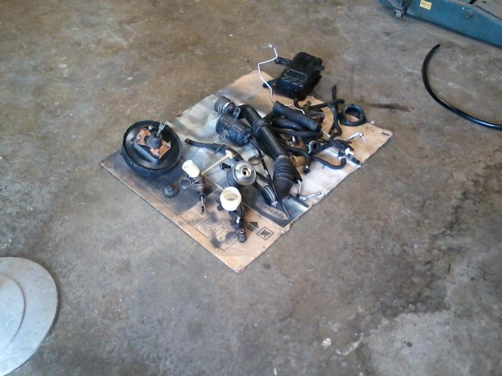

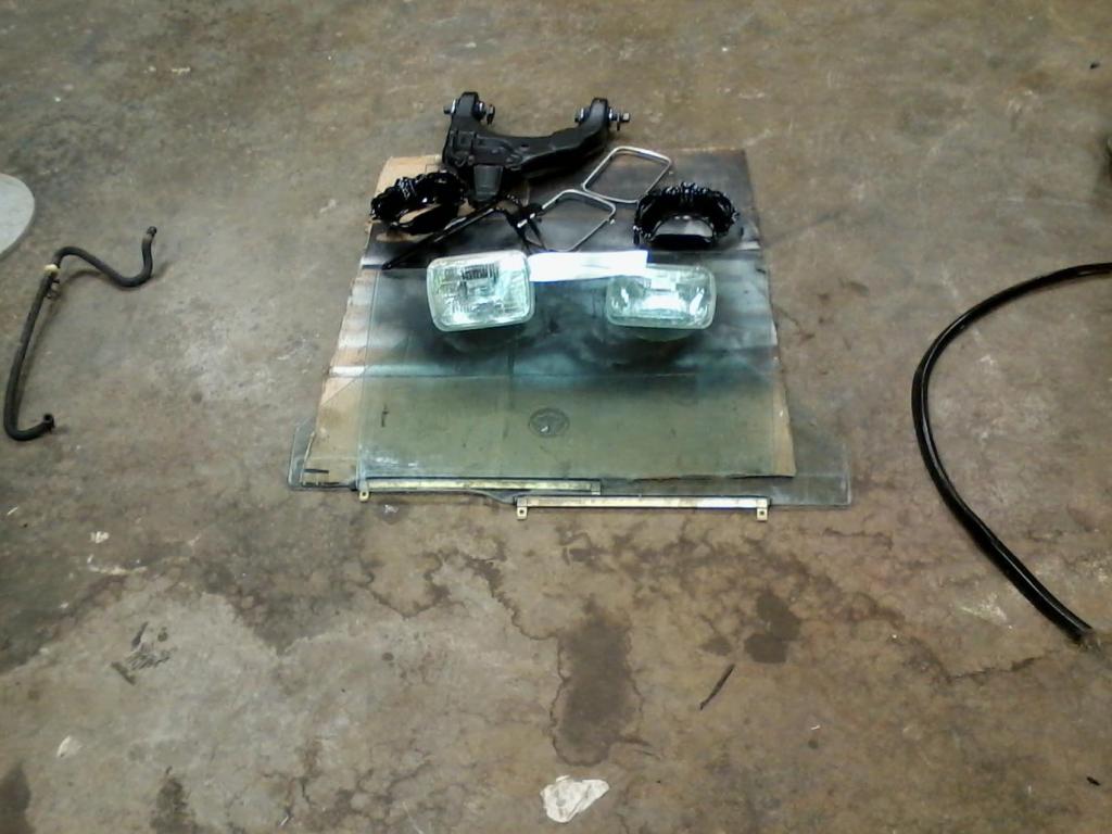

Along with the parts above, I did have a tote bin full of parts that came from underneath the hood. Cleaned them up and with some hoses I got from the salvage yard, I took the best of them and cleaned them up and made sure they were clear of debris. I would like to find something to give them the new look.

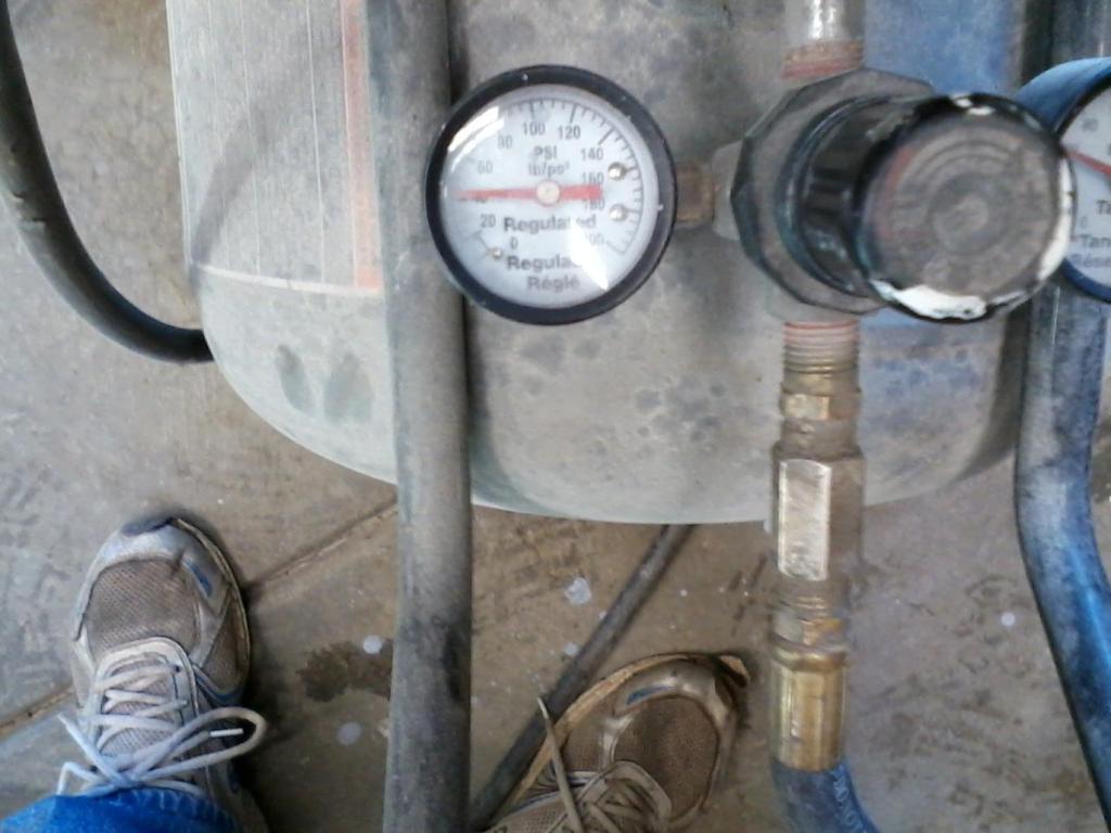

Just passing on some info for painting. Depending on what pressure your gun takes, I set my pressure with the trigger pulled and adjust it to the correct pressure that way. Usually the pressure will read a little higher when you let off of the trigger.
I finally got smart and cleaned off the gauges to where I can read them and when spraying, I throw a towel or something over the gauges to keep over spray off of them.

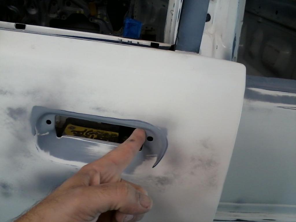

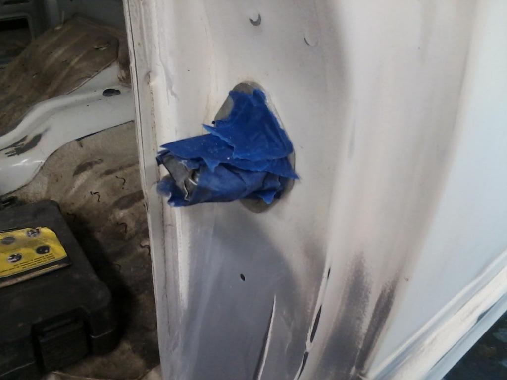

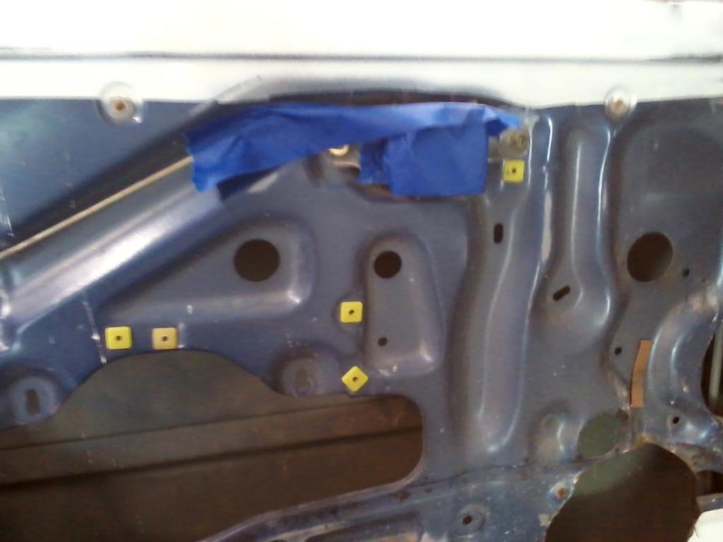

Not much masking to do. Mostly here to cover the handle and to keep the door mechanisim from getting covered and making it hard to operate. I also covered the door lock and put it in the lock position for better covering.
Here is how I plan on opening the door when painting. It will be covered when I reinstall the door handle and should be very little touched at all.
Covered the latch. I will have a little over spray on the latch but it is easier to get the paint off of later.
