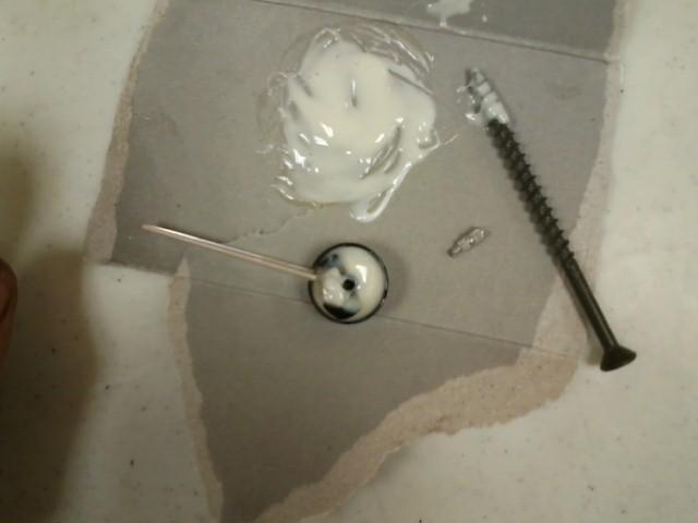

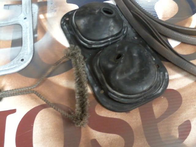

A couple of pictures did not turn out, but I want my shifter boot to look well. I use a wire brush and some soapy water to get the dead plastic off. Looks a lot better now.

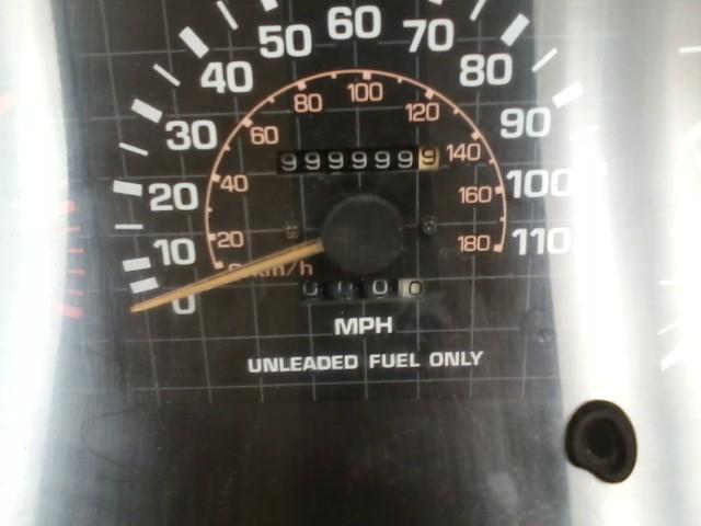

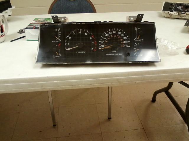

Started to work on getting my SR5 Gauge to the way I want it. I am taking two junk gauges and making one of them. I will never again try to set the mileage on a gauge that has the hashmarks in the face. The needles break off of the splined spindle. Luckily I had two that I was able to piece together.
Here you can see the spindle in the bottom right of the picture. The needle is formed around the spindle. I used a two part epoxy and it seems to be working.
Just a reference for me in the future as to know which bulbs get placed in the gauge.
I use Turtle Wax Lens Restorer for the face plate. Works great and is a lot better then it was.
Here is the gauge with the hash marks. I set the odometer to 999999. I have driven it a mile or so but want it to read all zeros when I do start driving it normal. Gives me a 10th of mile for around the house and such.

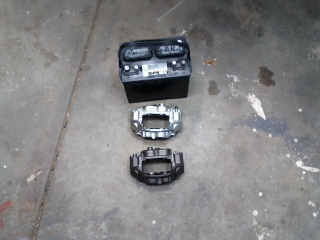

Not the most exciting update but it is a couple of more things off of my list of parts. It got down in the teens and I knew my battery was on the edge of being junk. Today it would not start as I had it sitting outside.
When I buy a battery, I always buy the highest Cold Cranking Amp battery that I can. It is overkill but when you get in cold tempertures that is when it pays off. Never been stuck in a parking lot with a dead battery due to tempertures.
I tried rebuilding my old calipers and they just werent cutting it. I finally broke down and bought a new set. Waiting on the brats to get home to help bleed them out and hopefully have front brakes. I have rear pads and slve cylinders but always have a tough time with those. I will get help putting those on. I have seen it done a thousand times and that is just something I havent been able to figure out.
2015 parts. Calipers are different colors but will be getting painted when I do the axle.

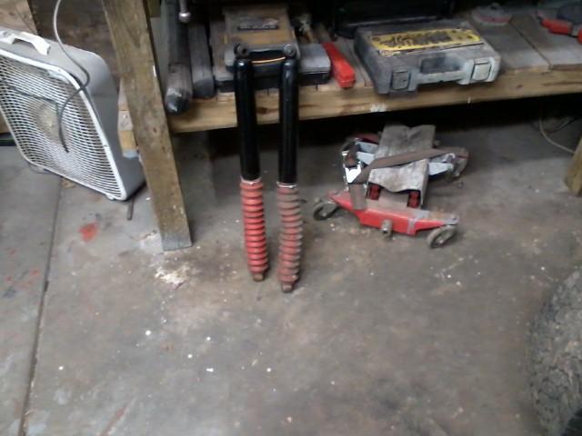

Got over the brake issue and was out in the shed looking for some other things and found a set of rear shocks from a parted truck or I got from a friend a while back and checked them and they are still good. Will get them installed tomorrow. One more step closer to it passing inspection. I will probably have to break down and buy some front shocks in the near future but once I get it legal and dependable I will start working on the other issues and getting things to where I want it to be.
Fresh coat of paint and I will clean the boots tomorrow and see what else I need to do to pass inspection. Lights work, horn works, rear shocks, glass will pass, exhaust will pass, brakes will pass visual inspection but still not working. I think I am getting close.

Speaking of battles, one of my shock bolt mounts was stripped and at one time the front end was sat on the ground with out tires on. That bent one of the dust shields. Later on I will be rebuilding the whole front axle and those will get replaced. I did get the shield back into some what of a normal position.
Got the shocks on and they are better then I expected. They still have a ton of pressure and when trying to get them on the shock mounts took alot of strength to get them on. I just hope they are too strong as I dont want a rough ride. I also got the truck titled today. I did not realize the title had been dated and I got to pay the penalty of not titling it in my name after 30 days of purchase. Ouch!!! that was a $200 penalty.

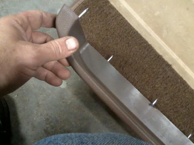

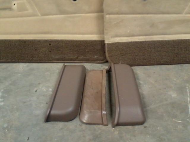

The left is a door panel is for the drivers side. It has a pocket but the passenger door does not have a pocket. The center pocket is for a second gen truck, the outer pockets come from a second gen runner.
On the back side of the passenger door panel, it is marked to use a second gen truck door pocket. The second gen runner pockets are larger. The thinner pockets just dont serve much use for me.

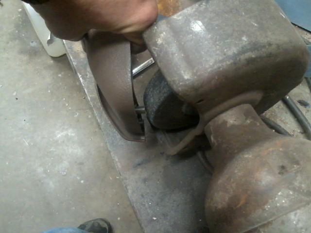

You will need to grind off the two longer post to mount these to the panels.

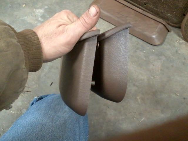

The pockets do have a narrow and larger end. I set the narrow facing to the front and about 3/4th inch back from the edge of the panel.
I use nails cut to different lengths to poke thru the panel. My completed panel picture did not show up but will post it later.

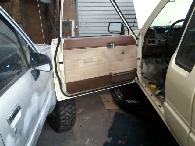

Finally getting around to getting my door panels on. We have gotten some snow and I dont want to mess with going to Joplin to get some interior paint to match the vinyl on the door panels and door handles. I will pick some up Monday and just mask off the things I want to cover.

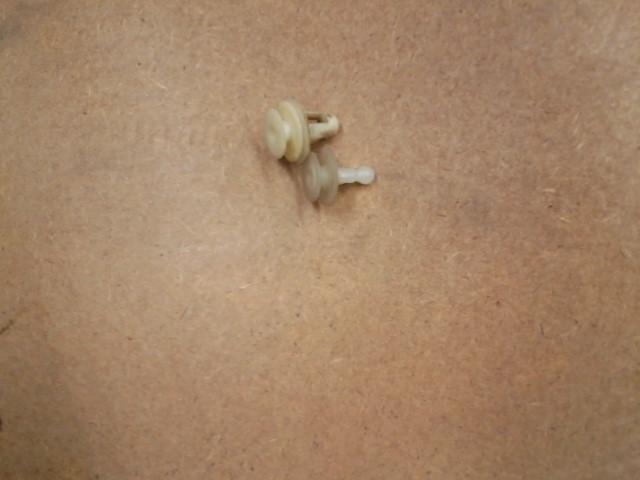

Toyota uses different clips to hold the panels on. I actually prefer the white clips over the yellow myself. They are interchangeable but you need the clip out of the door and I will stock up on them the next time I am at the boneyard.

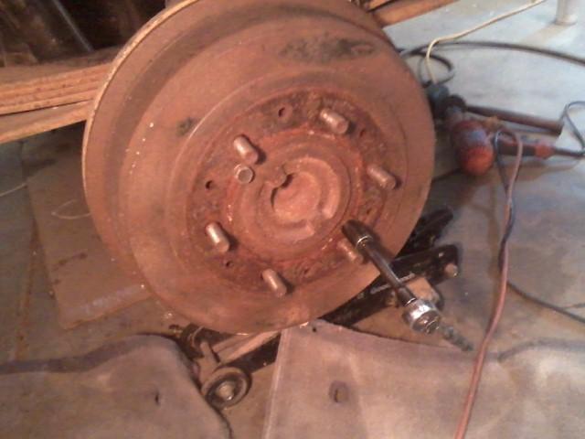

I see alot of damage to these rear brakes and really no reason for it as Toyota has two bolt holes that you can use 12mm to pop the drums off.
I could of used a little longer bolt but this worked. They were froze on but the bolts popped them right off.

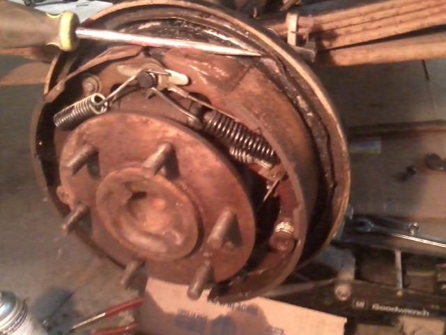

Where the screw driver tip is and around the edges, you can see where someone in the past used pry bars to get the drums off.

The top slave cylinder is what my 86 uses, the bottom is what is on my 85. I have gotten the wrong cylinders before. If you stick an 85 slave cylinder on an 86, it will work a few times and then the piston will pop out of the slave cylinder and you will lose all fluid and no brakes. I have been down that road before and it is not fun. Luckily I am able to handle a truck with no brakes at unexpected times. Just be aware of which slave cylinder you are installing as they will bolt up and is easily over looked if you are not paying attention. When I did the wrong part on my 86, I just thought it was a different manufacturer.

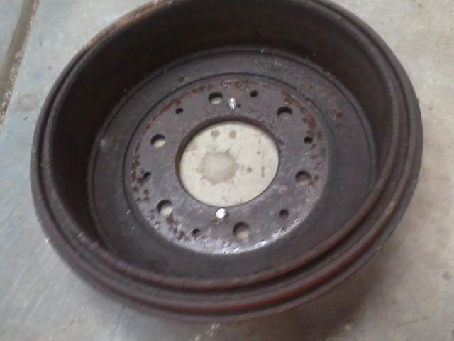

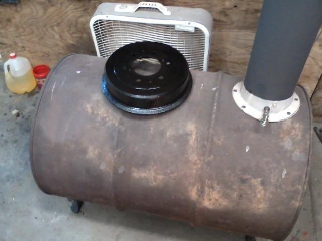

Got the drum cleaned and baking paint on. I will run it to the store and see if it needs turned or even replaced if it has been turned before. Does not look like it has been turned before but if it is not useable, it will look good going to the scrap pile.
