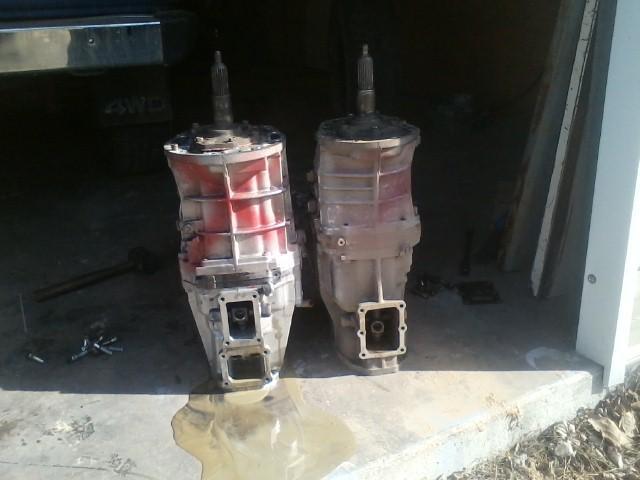

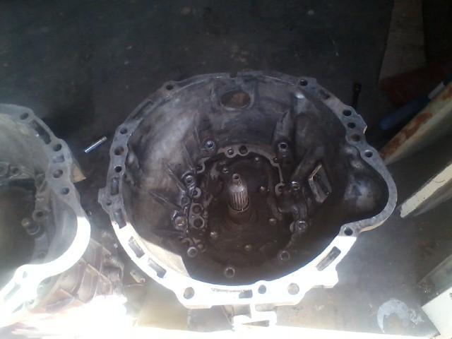

Here is the hole in the bottom of the transmission I was talking about earlier. A friend of mine was telling me the turbos are the only ones with this hole. Also he says the bell housing is great for heavier duty clutches. I am still learning some things on transmissions.
Also the nose piece for the shaft is larger then any other one I have seen. The nose piece I have sitting on the bell housing is typical of all the other transmissions I have seen. Also look at the bottom part of the nose piece on the transmission and you will see it is a larger square on the bottom of it. Lots of yucky oil come out of it that I get to clean up. Gear oil is the worse for cleaning.

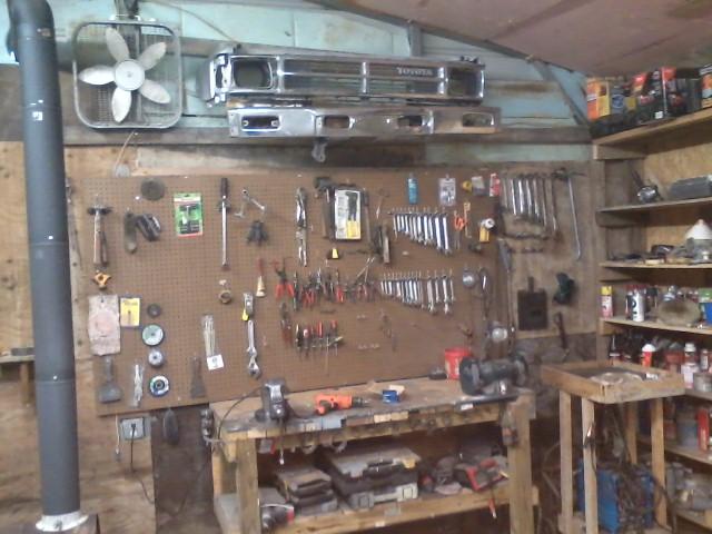

I took some time off from work to get several things done. One is get the shop finished like I want and get some side projects done. One that I have been tinkering with for some time that still has a ways to go is getting the front that I made from junk parts. The core support that I am using is the one I first used on my 86 Runner when it was in the beginning stages. When I got the runner, it did not have a core support. I used this one until I got a better one. It is rusted bad but it served its purpose until I got a good one.
The fenders that I used were dented and rotted that I was unable to repair them. About the only good things on this is the grill and head light buckets. The bumper is bent and one I used for awhile as well. I eventually want to hide my circulation fan and have a bench light hidden over head. Another long term goal is to turn the head lights into more shop light or some day when I get an electric garage door opener, have to light up the shop when pulling in. That will be a ways off.
Also got rid of my two metal shelves and made some shelves that heavier built and hold more. Doesn't look like much accomplished but I already have about 20 hours in the shop doing some things. It has been cold too and with heat, it is so much better then what I went thru last year. I couldn't even be in the shop due to the cold. Been in the single digits and so far no problems.

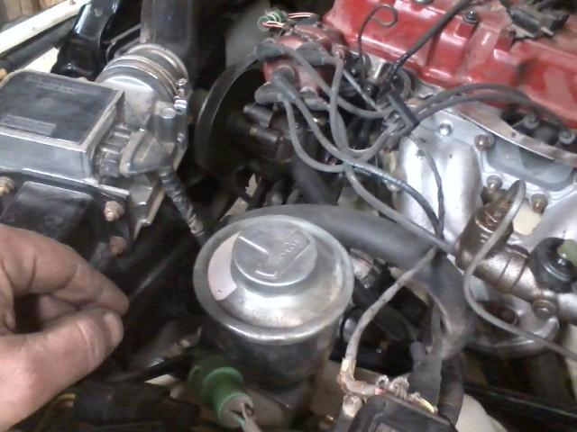

Fairly recently there was a thread about the vacuum lines being removed from an EFI power steering pump. I had no issues with out the vac lines off and since the pump with the vac lines is bad. I am going with the carb power steering pump. I got to leave and will add more later.
Thumb is showing the EFI pump with vac port.

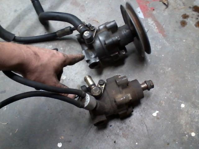

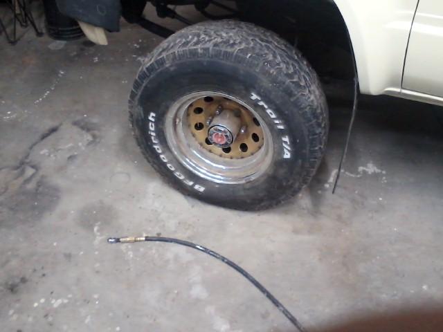

I got my power steering on, wahoo!!! It makes it so much easier to move around the house and getting it out of the shop to work on other things. To bleed the system of air, I raise the front end and go stop to stop several times. Your arm will thank you for raising the front end up and save some wear and tear on the steering. After I get as much air out as possible, I then start the truck to help get fluid thru the pump.
I was excited just to get it movable and that is great, but now having power steering for tight spots is so much easier. My drivers front tire has a slow leak, so that is the next quick fix. Still need to do the brakes, exhaust, and windshield. The 88 has been taking up the funds so it will be a while longer yet but one step closer to having the exterior finished and will start on interior after I get the outside finished.

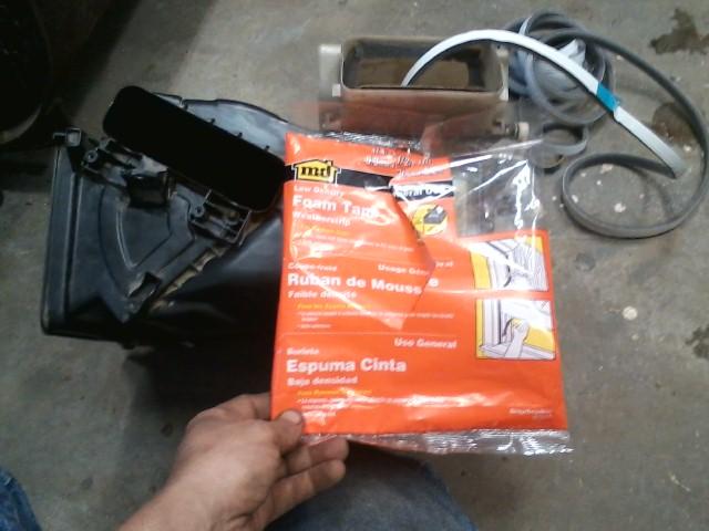

I took 9 days off from work to get things caught on things around the house, shop, and trucks. I spent 8-12 hours days trying to get things done. Some things went better then expected and some not as well. Overall was happy with what got done. I did not get to the 86 Silver Runner and still need to do some work on the 3rd Gen. Maybe tomorrow.

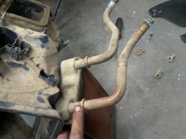

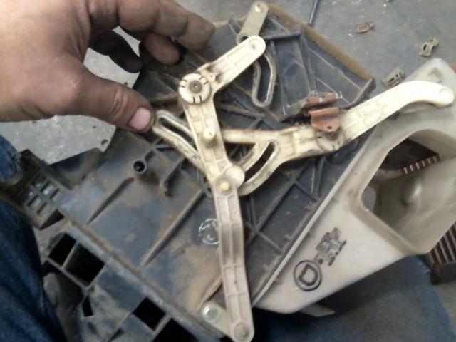

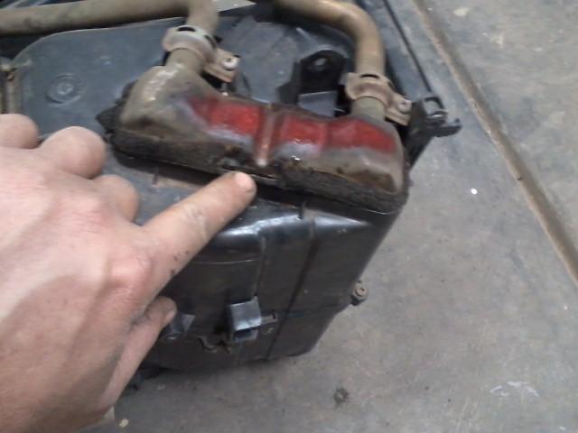

I get to pull the dash out of the 85 for the umpteenth time and hope this is the last time for it. The heater core in it for some reason just started leaking. Not sure why but will find out when I pull it in the morning. Luckily I had a spare setting in the shed and cleaned it up.
If you buy a new core, it wont come with the pipes and these c-clips are easy to get bent out of shape and will leak. Since this one is a spare I had I did not pull them off. These can get dirty but I gave this a good cleaning.

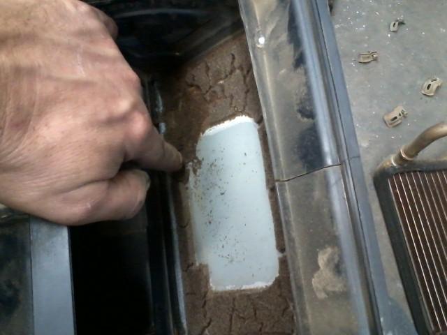

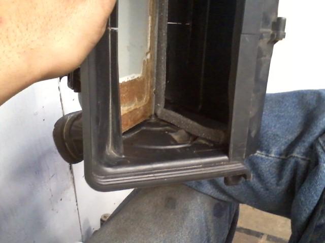

This used to be soft foam but now will turn to dust when touched. I just scraped it all off and used some foam seal around the edges.
I got this from Lowes. Getting the white tape off can be a pain but when it comes off it looks like snake skin for the glue. I cut a little extra and just trimmed it once I got it in the vent.
What it looks like when installed on the plastic. It does not stick to the metal to well. One of the vents I was unable to seal around but it is not going to be a problem. Not much air will leak around the flap and it is inside the truck.

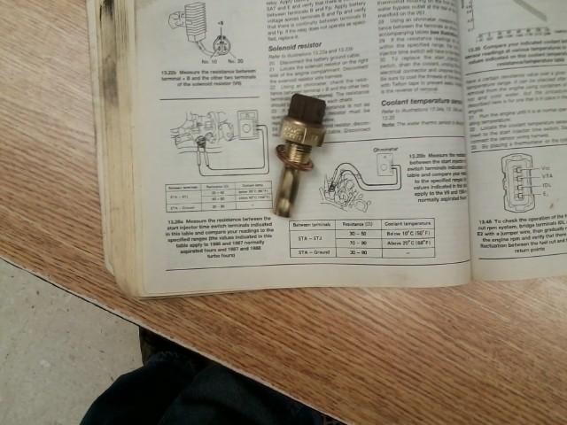

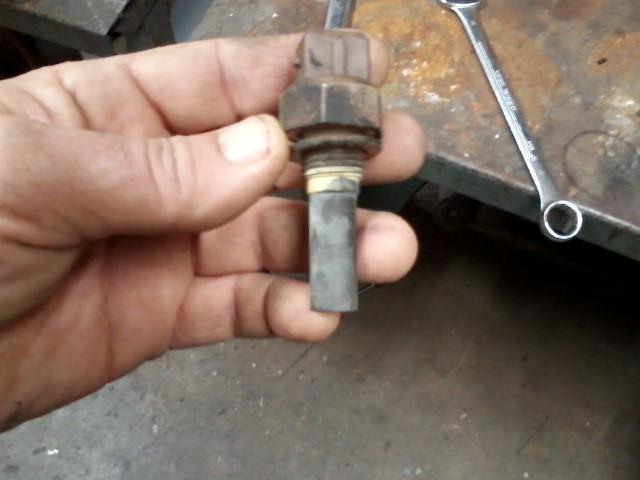

The 85 would not start due to it being cold. I used some starting fluid and fired right up. Usually a sign that the Cold Start Injector Timing Switch is bad. Never had the Cold Start Injector to fail.
Here is the new to me one.
Cleaned up and passing test. Should fix the no start issue once I get it installed.

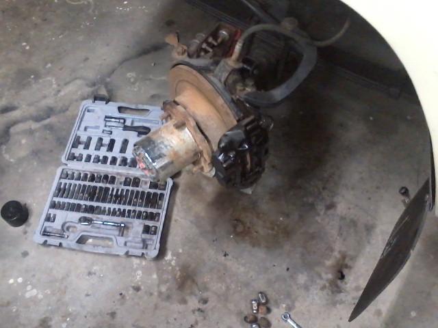

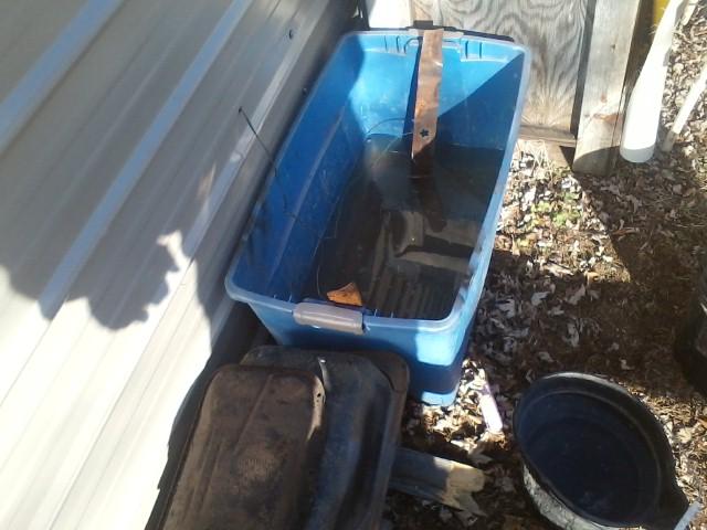

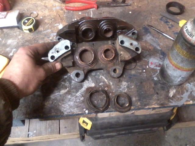

I moved my Electrolisis Tank outside. I soaked one of my brake calipers in it and it made disassembling it much quicker. Should of done the other one that way as well.
The calipers are frozen. No pad on the inside of the drivers side. If there is fluid involved, I am going to find a way to get it on the floor.
Here I am forcing the pistons out. The needle nose pliers simulates the rotor. This keeps the pistons from popping all the way out. If one doesnt pop out, keep air pressure on it and tap it lightly with a metal hammer and it usually will come out.
Here it is disassemled. This will clean up. What is behind the pistons is usually nasty!!!
Here you can see where the piston stuck to the the cylinder. A good cleaning and it is working great. I did not get a picture of it reassembled. I replaced the inner seals and dust seals. Eventually I want to replace all the brake system with new. This will work great. I am still needing to order some new pads. At least now I can stop the truck. Before I had to watch it when moving it in and out of the shop.
I got my caliper rebuilt. Will be ordering brakes from Rockauto and get them installed when they get in. I can now stop the truck, was wondering how long it would be before I put it into my work bench.

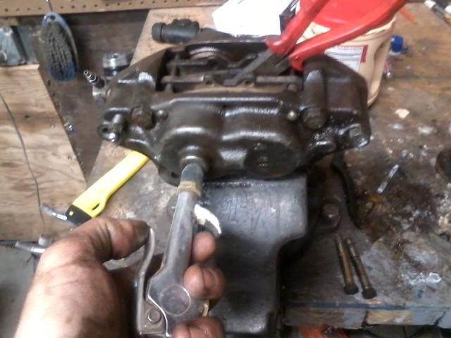

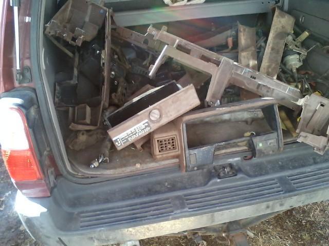

This is the 50th time I have pulled the dash assembly. The heater core for some reason went bad. Got most of it back in and marked this one as bad with red. Pipes, clips and box will come in handy someday. Here is where it split.

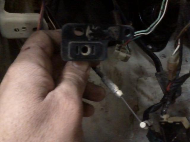

One option that is rare to find is the plug for a factory drop light. I have seen the plug a few times and got it installed on mine. Have seen pictures of the drop light and maybe one day I will have one. Eventually want to get all the options on this truck working. That will be a long process and this truck will be one loaded truck with factory options. I just lucked out on getting this harness.

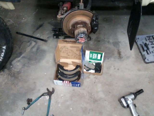

Got front and rear brake pads/shoes in from Rockauto today. Was not supposed to be here for a couple of more days so that always makes nice when parts show up earlier then expected. I just put the front pads on. I do have rear slave cylinders to go with the back brakes and will get to them later.

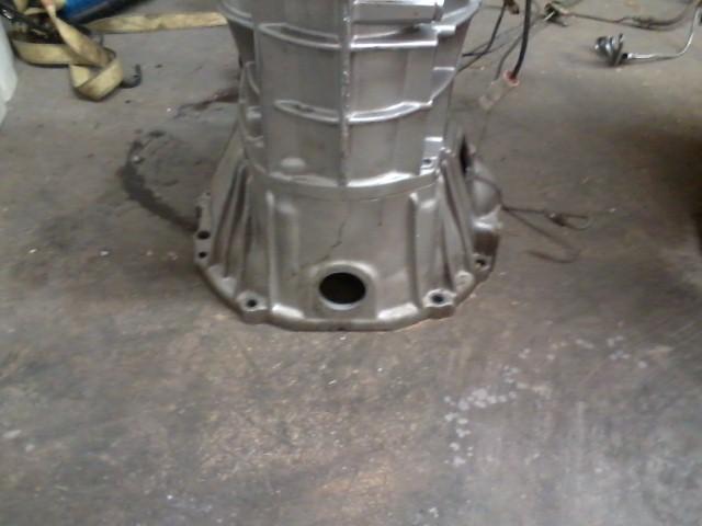

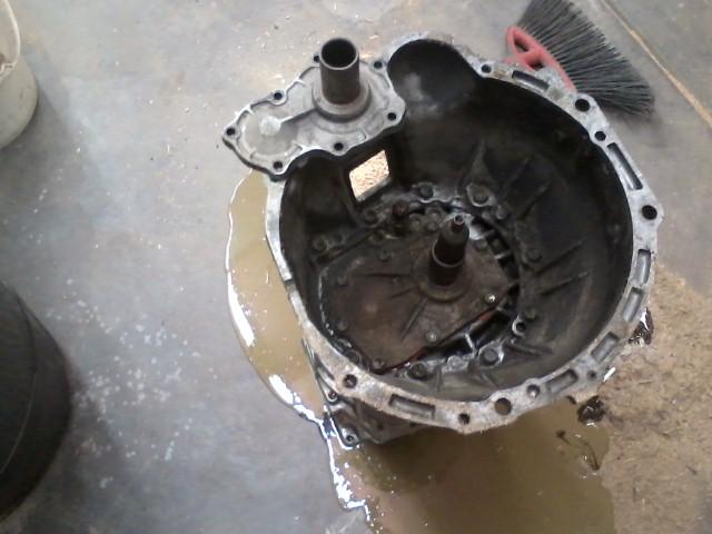

Hello Ed.. I will need to ask my friend what he was talking about. The transmissions are the same length. But the bell housings will not interchange. I swapped the turbo bell housing to a W56 ( Almost sure it is a W56) and it was way to big. I put the W56 bell housing on the turbo tranny and the bell housing was way to small.
Turbo bell housing ( hole in bell housing) on W56 tranny. If you look closely, you can see the W56 transmissions bolt holes ( on left side of transmission) and the bolt holes for the turbo bell housing are way off.
Trannys are same length.

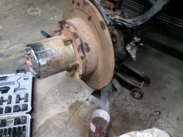

Hello cyberhorn...The electrolisis tank is great. I cant geta good weld on the stud and not enough of it to grab on to. I broke my last easy out and still need to replace it. I did find another manifold while getting some information on the doors for you.

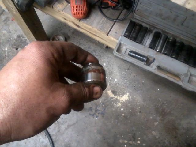

I may need to get a better picture but where my pointer finger is, those are closest to the rear of the door. I have used the yellow plugs to fix another door. These are the square quarter inch holes I was telling you about being pre punched in the door. You can go from the shorter arm rest to the longer arm rest just by moving the yellow plugs. Also the longer arm rest will hide your old hole.
There are two square holes on each side of my pointer finger. My pinky is for the front hole on either arm rest.
