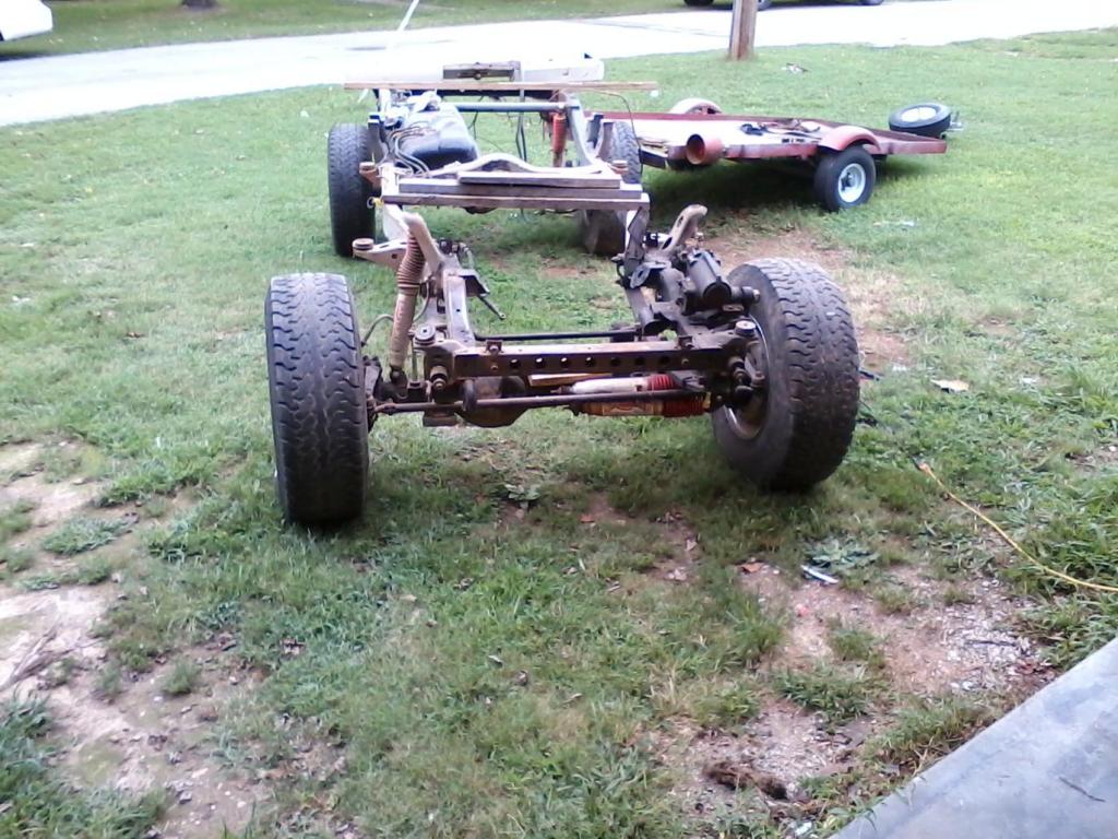

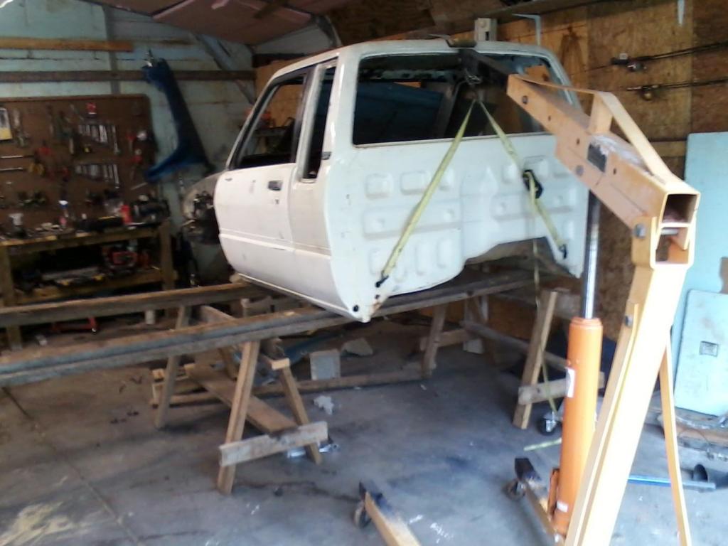

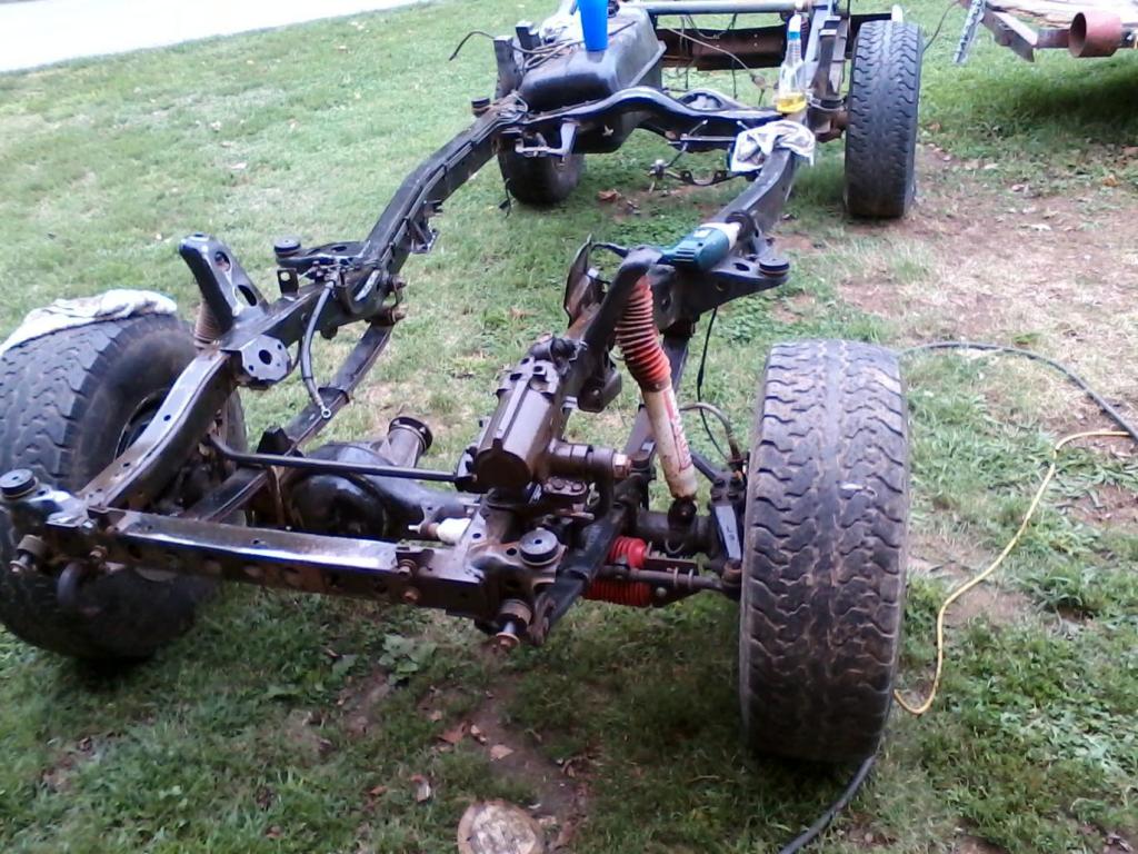

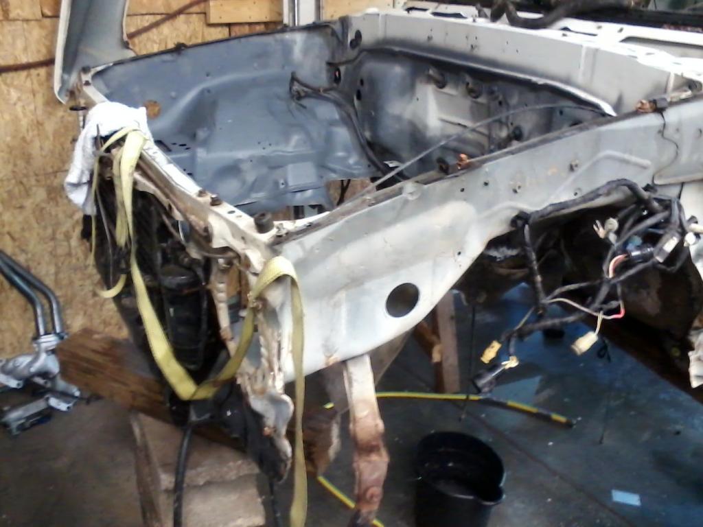

I got the frame out and the cab is in the shop. I did have a small mishap and if I had only waited until someone got home from work it would not have happenened but I was impatient. Nothing bad. I work by myself most times so pay close attention to safety. I made sure that if it dropped it was never more then a foot and that is only because of the thickness of a concrete block. I am going to start cleaning the frame so I dont get impatient again as I need some help to get the cab supported more safely. It is alright for now.
Cab in shop waiting for help to get saw horses where they need to be.
Frame outside getting ready for cleaning and paint.

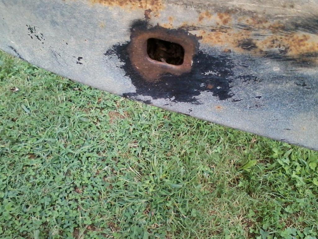

My impatience did cause some small damage that I can fix. It fell about 3 inches. grrrr..

could have been worse terry that 3 inch dent in the rocker coulda been your body which dont fix as easy as metal
do be careful man

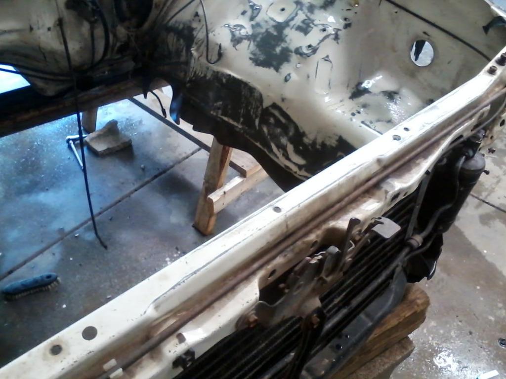

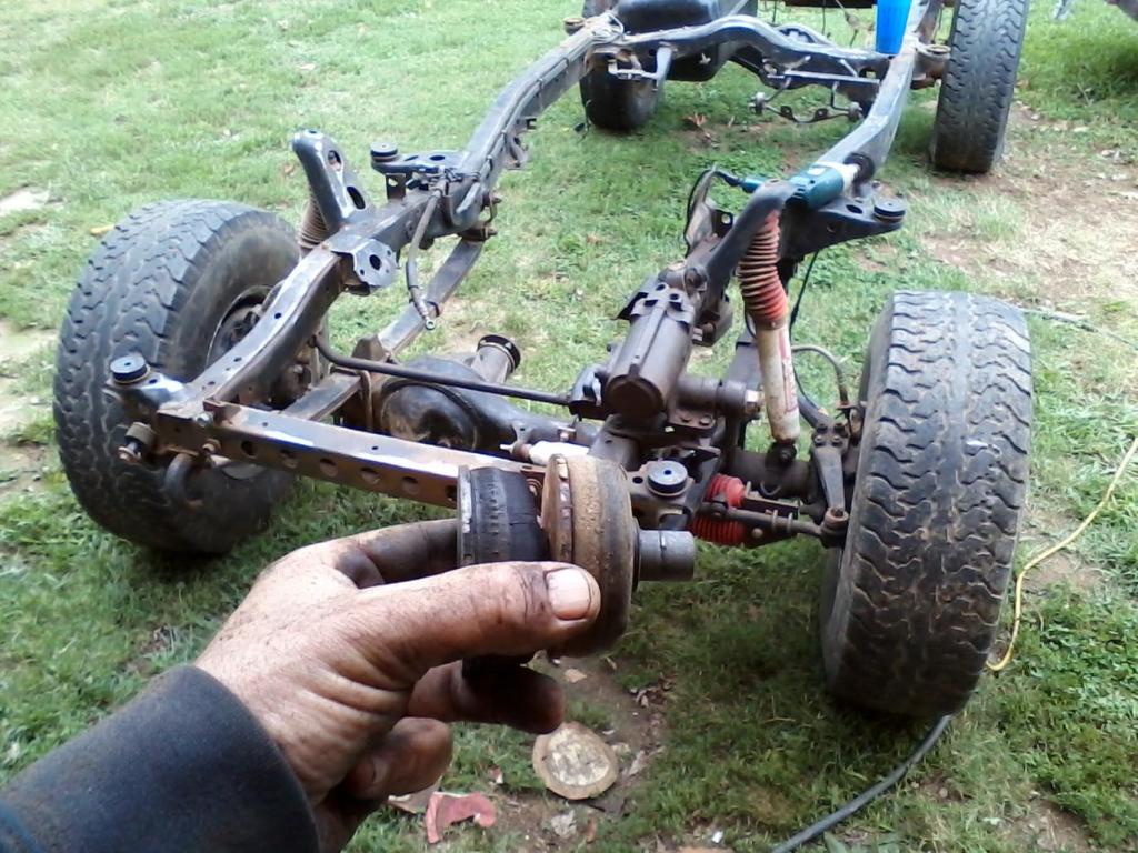

This frame was loaded with dirt. Not sure if you can see in the pictures but it is half full of dirt.
I take an air hose and start at the back and keep working my way to the front until I get to the center then I work from the front to the center. Got the frame cleaned. I will still wash it out at a later time and spray some oil in the frame.
I would like to use some new bushings but these are still in good shape. I just cleaned them with a wire bench brush and will reuse them. Everything I spend cuts into my painting which I am hoping to do next Friday. I did not do any body work since I was greasy. Will do that this coming week. The frame here is cleaned but not with degreaser. I will be rebuilding the front axle at a later time so it will get a good cleaning and painting at that time.
It is starting to rain. I sanded with 80 grit paper and a drill and a wire brush on a drill. After wards I soaked the frame in degreaser and scrubbed it with my hands. Am hoping the rain will do alot for me. This frame just has some surface rust in a couple of places but other then that it is in excellent condition. No rust holes anywhere.

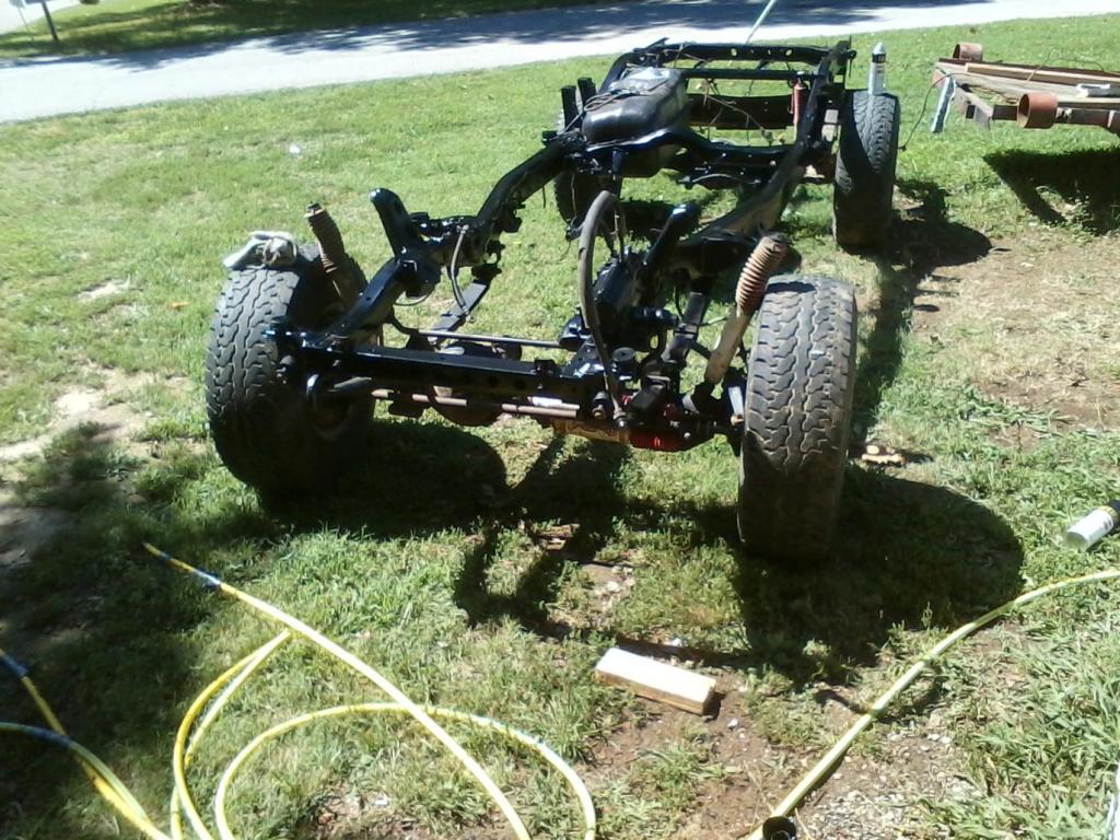

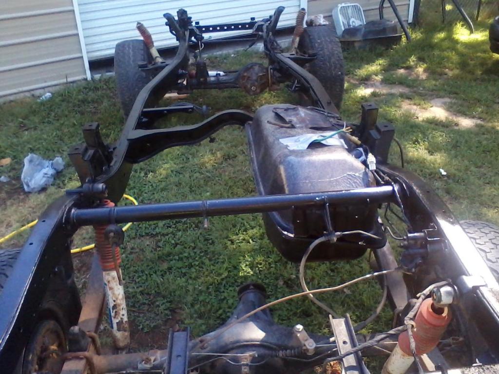

I scrubbed the frame with my wire toothbrush in the nooks and crannies. It is now CLEAN and painted. I will do the axles and leaf springs when I go to work on them. Looks better in person and really happy how it has turned out. Next I will be degreasing the bottom of the cab and engine bay and finish up the body work on it.
Pictures dont do it justice but here is another view.

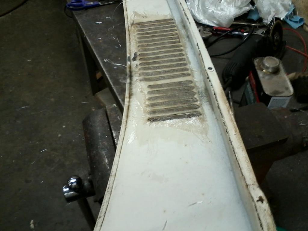

I am working on a possible failed science experiment. The windshield cowls let a lot of dirt into the ventilation system. I ground down the back of the cowl vents and laid a piece of fiberglass material over the vents. Later I am going to cover the vents with some body filler and go for the smooth cowl look. I am thinking it can still draw air thru the wiper blade holes.
Old Sep 15, 2014 | 12:51 AM

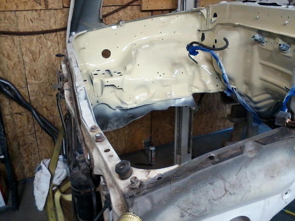

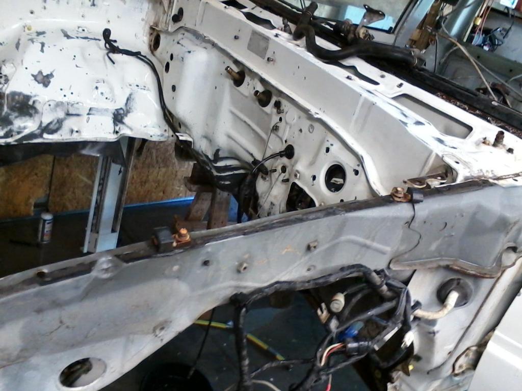

Rats!!! I went to put some sealer on the engine bay and I am out of activator. It wont be at my local Oriellys til 4 this after noon so I am going to take a nap and see if I can get that accomplished. Plan on painting the engine bay tomorrow and will start body work on cab in the next couple of days.
Cleaned the firewall.
Got the bay ready for sealer.

how is your sheet metal skills?
instead of using filler maybe cut out the louvers and weld a piece in..

Originally Posted by Terrys87
...The windshield cowls let a lot of dirt into the ventilation system. I ground down the back of the cowl vents and laid a piece of fiberglass material over the vents. Later I am going to cover the vents with some body filler and go for the smooth cowl look. I am thinking it can still draw air thru the wiper blade holes.
[URL=http://s1098.photobucket.com/user/Terrys87/media/Terrys87023/project2_zps2c53b444.jpg.html]
Wiper holes may be a little too constricted.
I'm planning to simply mount steel or plastic mesh under the cowl grille... (like one of these), or gutter filter/guard like this
With UV-stabilized tie-wrap/cable tie...
...or steal the plastic vent mesh out of this - LOL!
Last edited by RAD4Runner; Sep 15, 2014 at 07:19 PM. Reason: edit "under the cowl grille..."

it'll draw air through the former drains on either side might get a bit dusty'er air pulled in

Hello Robb... I am wanting a welder badly. It is on the list. I do havea few spare cowls and eventually I am going to get a welder and close it up with a plate. That wont take long to repaint at a later time. I was going to get one from Slacker but buying one from him would go a long ways toward a welder. I want a welder badly.
Hello Mark... I accumulated things from the house and when I did my shop wiring had some left over from it. I actually forgot a few other things that I meant to get out of here. I can already tell I will eventually haul off the 3 rims on this truck, its shocks, and my exhaust from my 86 when I have it replaced. This stuff piles up quick.
Hello Ray...I may ago that route for awhile. I am determined to keep that debris out of my ventilation system. Thanks for the idea. One reason I had to cut out that other panel as it was just mud or stuff that an airhose and vacuum would not get out. Luckily there was no damage.
Hello Cyberhorn..I had forgot about the drain ports. That will allow plenty in. This is going to be my work truck and it wont be down many dusty roads. I am going to put to much effort in it to get it all dirty. It will get used like my other ones do but not abused.
