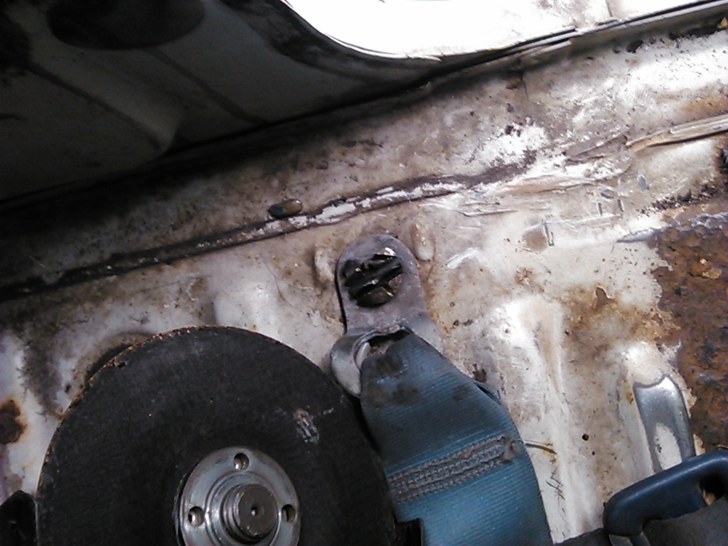

Another reason is to straighten out POs prior work. They used a torx head bolt in the seat belt and buggered it up into thread holes. Had to cut it out. Also removed 15 pounds of speaker wire.

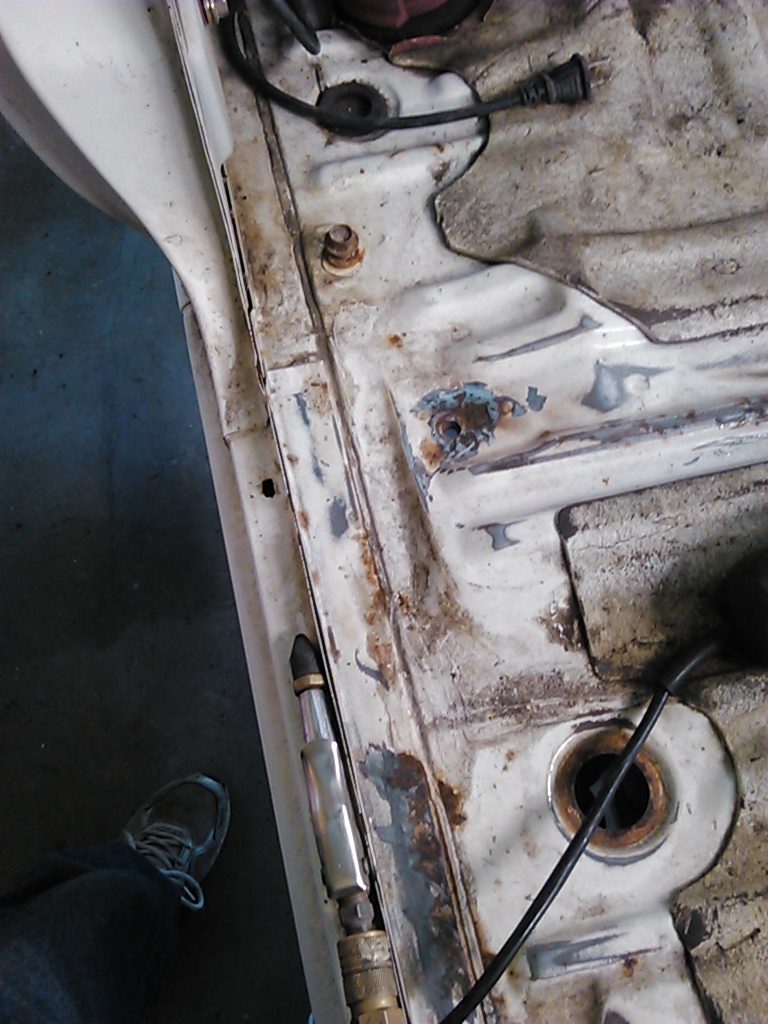

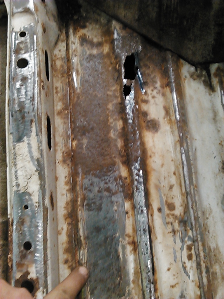

Grinding out some of the rust. I have 3 rust holes that are going to need to be patched in, I will find some rust converter and cover it with POR-15. Here you can see where I removed some of it.

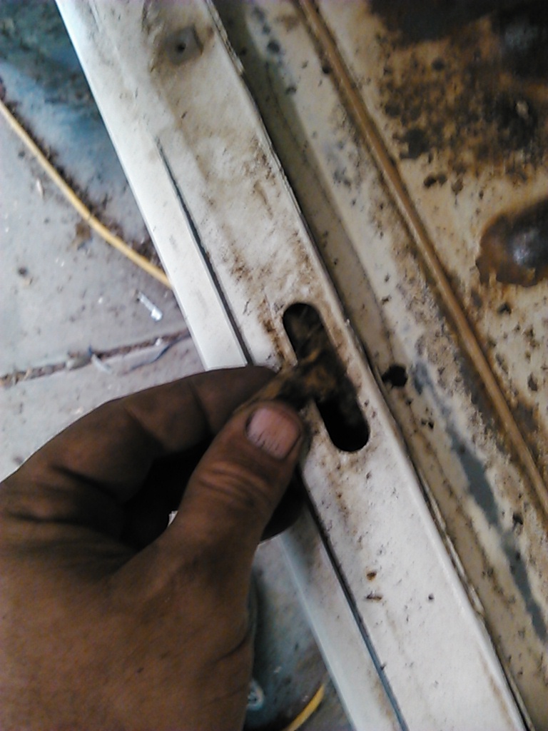

I have showed in my other builds about cleaning out the rocker panels to clear the drain holes. When I first got this truck, I found a mouse skeleton in the passenger roceker panel. Here I am blowing some of the dirt/mouses old house out the front hole in the kick panel. I stuck the yellow plug inside the kick panel hole to show where to get some of the dirt out,

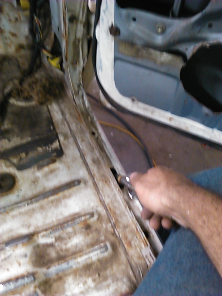

Using an air hose in the cutouts on the top of the rocker panel, just underneath the door trim will push trash to the rear of the cab.

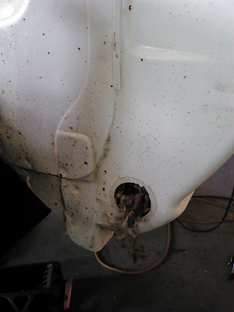

Here is the hole in the back of all cabs where some more nasty gunk came out of.

This is not even half of the trash that has come out of the rocker panel. I had cleaned it up earlier when I had to remove the torx bolt. It is nasty. The "V" notch on the bottom of your rocker panels on the inside is the drain holes.

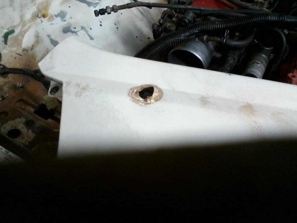

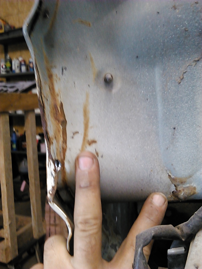

The drivers front fender has been bumped in the past. With my pointer finger you can see where the paint flaked off from a bend and my middle finger is showing a crease. I was able to hammer and dolly it back into shape.

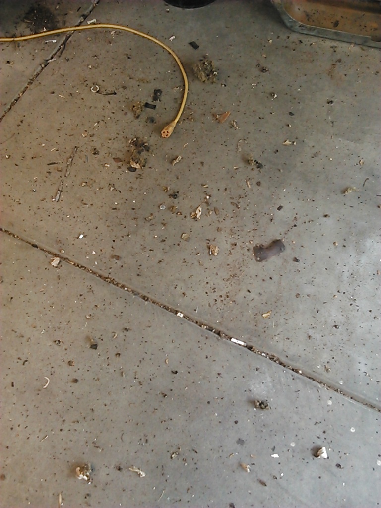

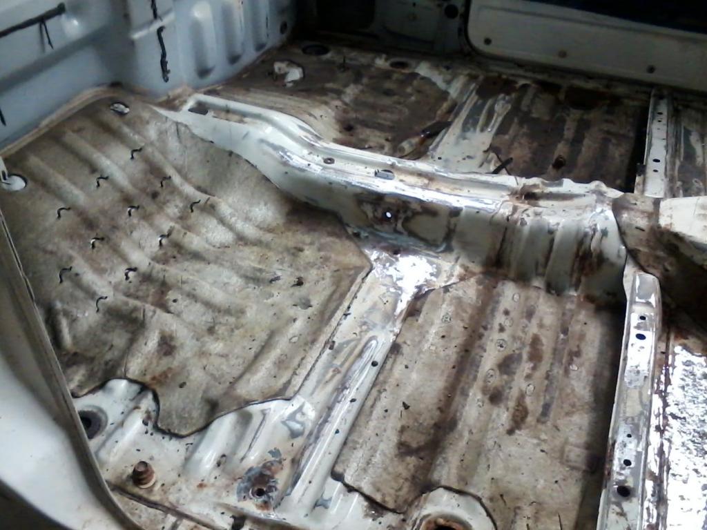

Got the cab floor cleaned and stripped out.

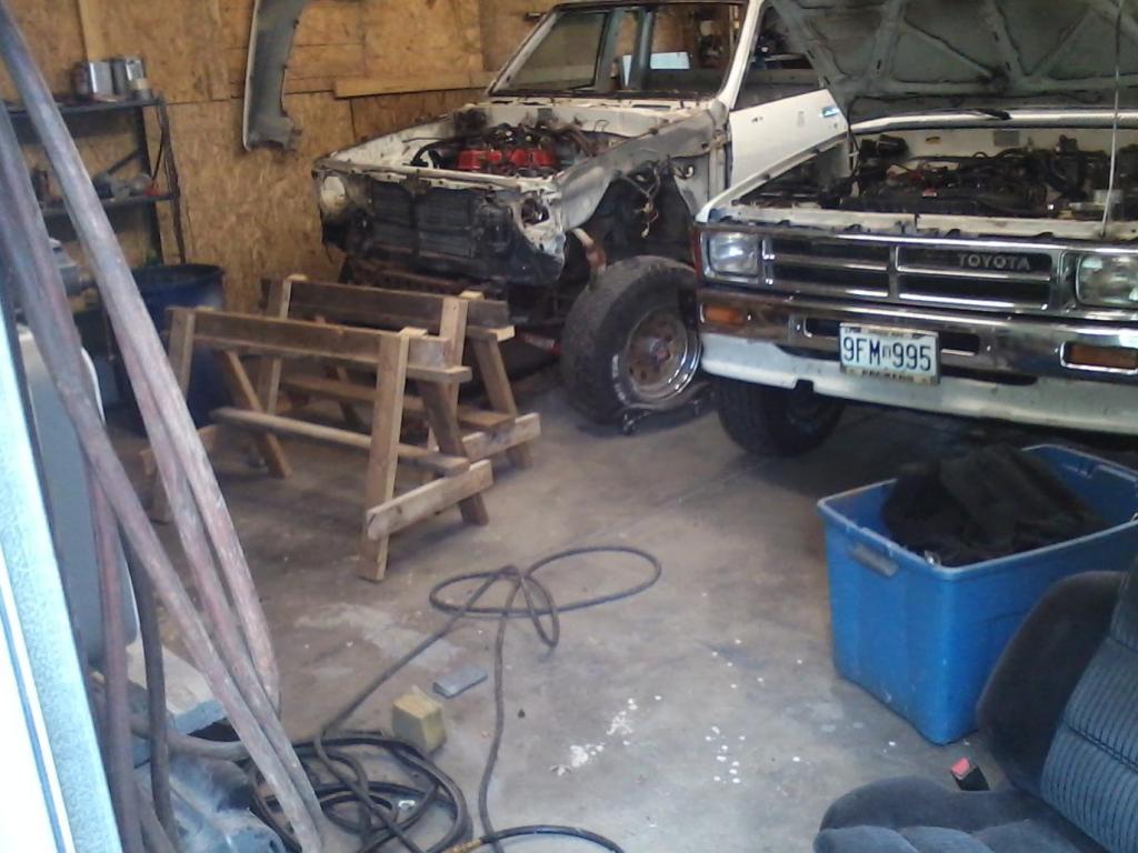

I had to replace a TPS on Mistys runner. Built two saw horses and cab is just waiting for me to get some help to lift it off.

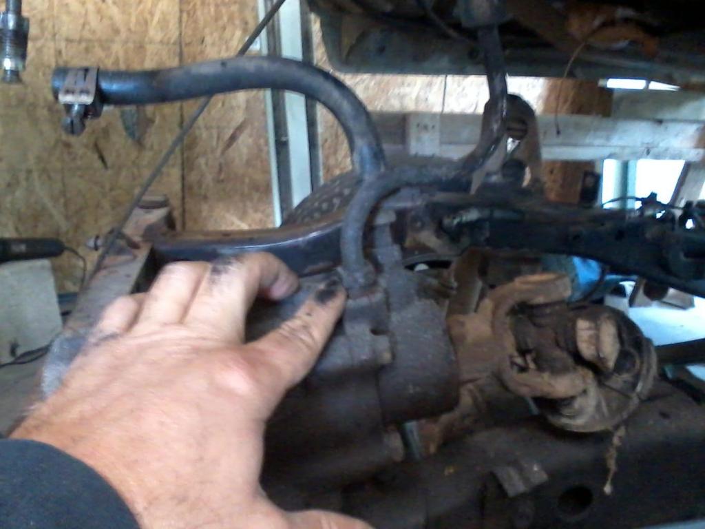

I got the motor all disconnected from the transmission and now am getting juiced up on coffee and will start pulling it and then the transmission. I was wanting to keep the drive train in to conserve space but getting it high enough to clear is going to be an issue.
I changed the plugs on the 3rd gen runner the other day and ripped a boot on the coil pack. I ordered a Denso plug set from ebay thinking that would get it fixed. They only come with the wires and you cant get just one boot for the coil. So I lost some time going to Joplin to get another Denos coil with the boot attached. Last night the skeeters ran me out of the shop but am hopeing to have a better day today.
My neighbor is a retired bodyman of 40 years and was looking at the condition of my 85 was really impressed how solid it is. I told him I was going to cut the 3 rust holes out of the floor board and have them welded in. He says he is going to show me a different way of fixing them later on. He is leaving for a week vacation and should show me when he gets back. Looking forward to see how he does it.

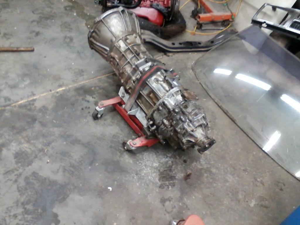

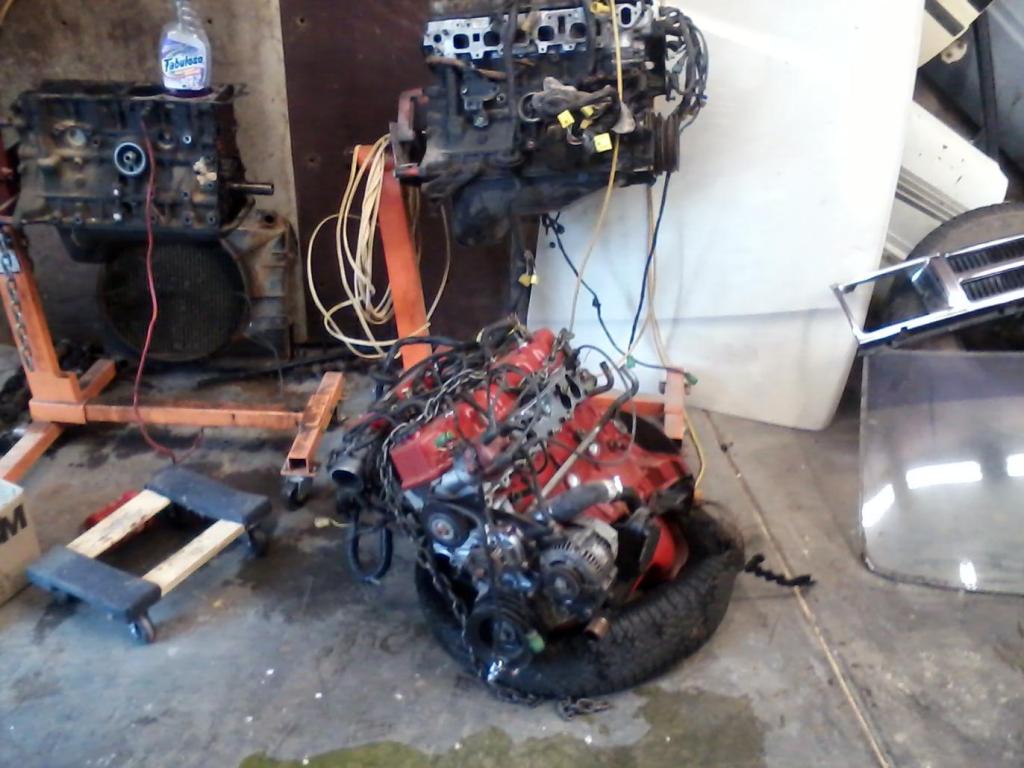

I got the motor out. Will need to do some re arranging. Also I loaned my nephew my cherry picker. He lifted a Dodge Cummins Diesel with it and those are heavy motors. Just for safety really pay attention to the weight limits. He messed up my cherry picker and I will have to get it straightened back out. I eventually want to get a collapsable cherry picker for space saving. Harbor Freight stuff works great for these motors but even their engine stands will not support a full size Chevy V8 motor. The cherry picker has pulled alot of 22re motors with no problems and probably would of pulled his diesel had he not had the arm so far out that the leverage was to much for the cherry picker.

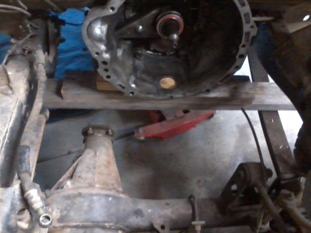

On a solid axle truck, I support the tranny with some 2x4s across the leaf springs.

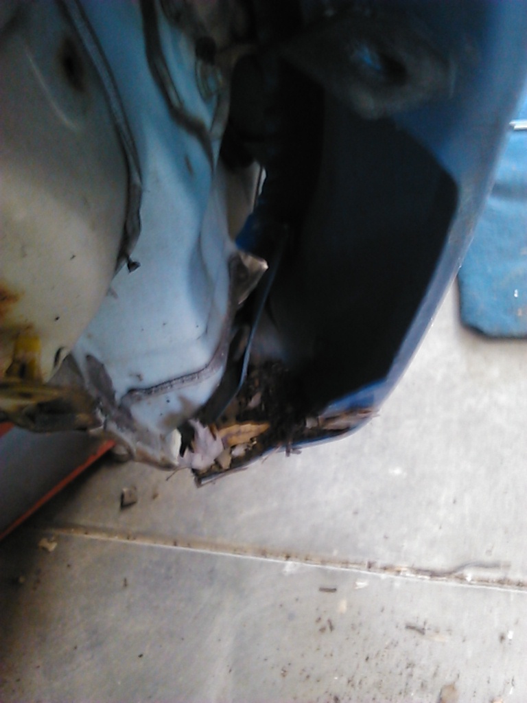

Where my nephew over extended the cherry picker. Just pay attention to the weight amount you are lifting.
Tranny is out and I got it degreasing. I originally was going to get the truck running and then remove the body and clean everything but that has changed. It will be getting cleaned soon. Got two little boys that I am going to put to work on this.

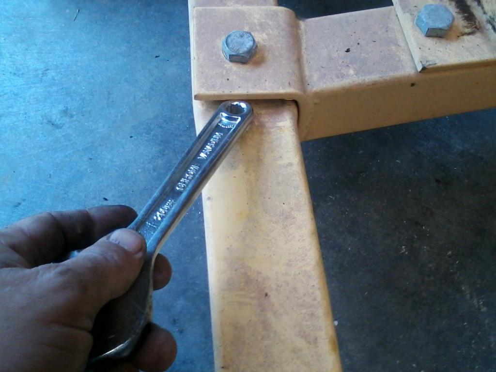

hate to say this terry once square tubes been buckled like that its never gona be as strong even if he can even get it fixed the metal will have to have been heated to do it leaving its strength changed id say your nefue owes ya a new cherry picker thats not safe to use any more
an im redneck enough to know, i seen it done ohh boy what a mess...

Hello Ray... My dad worked my butt off when I was a kid, he got away with it and I am hoping I can too.lol, they actually like helping on things like this. I will eventually get a cowl cover from Slacker, it might be a while but I am going to try an experiment of my own and see if I cant get it covered. Hoping it works out. Either doing what you are talking about or just fiber glassing the whole thing closed.
Hello Cyerhorn... I am afraid this thing will eventually be going to the scrap pile. It can still be used for light stuff but it heavy lifting days are over. I am using it against my better judgement, but getting everybody I need to lift it off is not going to be easy with every bodys schedules. I got some red neck in me too as you are about to see.

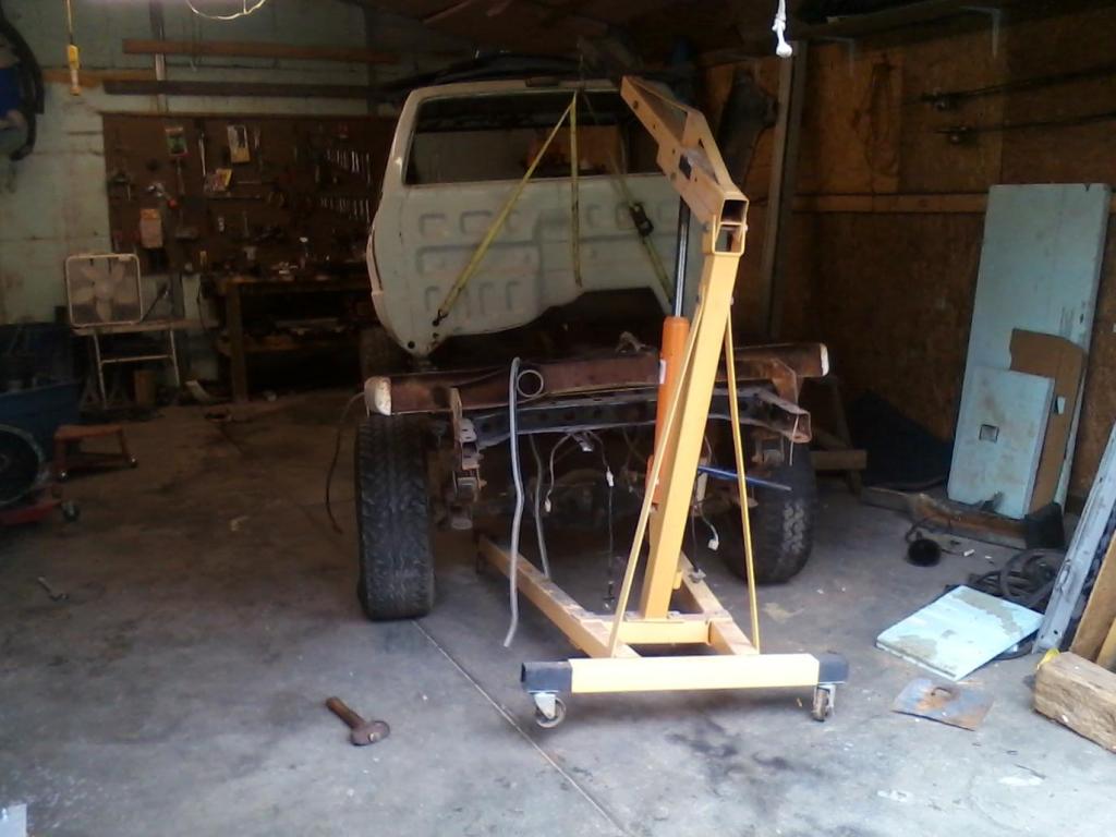

Started to lif the body off and have it a snag. I am taking a break and catching up on what I have done so far and thinking of how to get the rear up 2 more inches to clear the frame. In the mean time here is what I have done so far and how I have made some clearance.
The Power Steering lines were higher then I thought so I removed them.

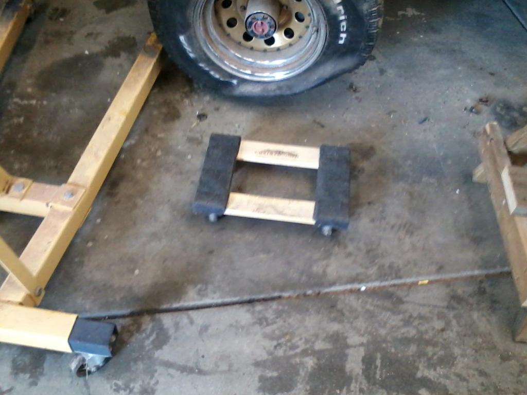

Flattened the tires and remove wheel dollies.

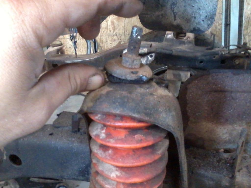

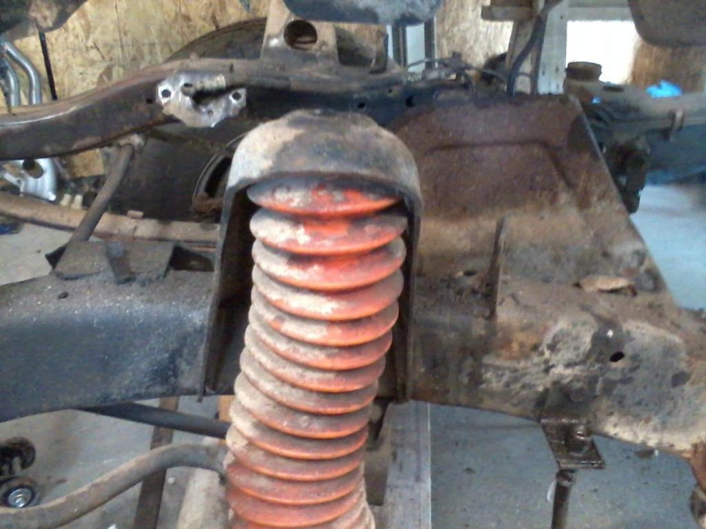

Cut the shock bolts off. These are junk anyways.
That gave an inch more clearance.

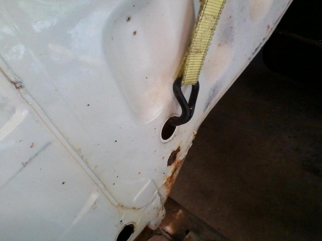

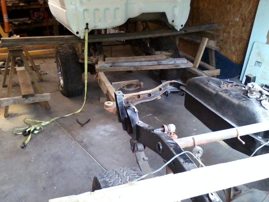

How I lifted the back was with a strap with some hooks on the inner holes.
Using the cherry picker to lift the back end up.
I need two more inches for the shock hoops to clear the cross boards on the saw horse. grrrr. Front is supported by concrete blocks and the cherry picker is also there for extra support.
