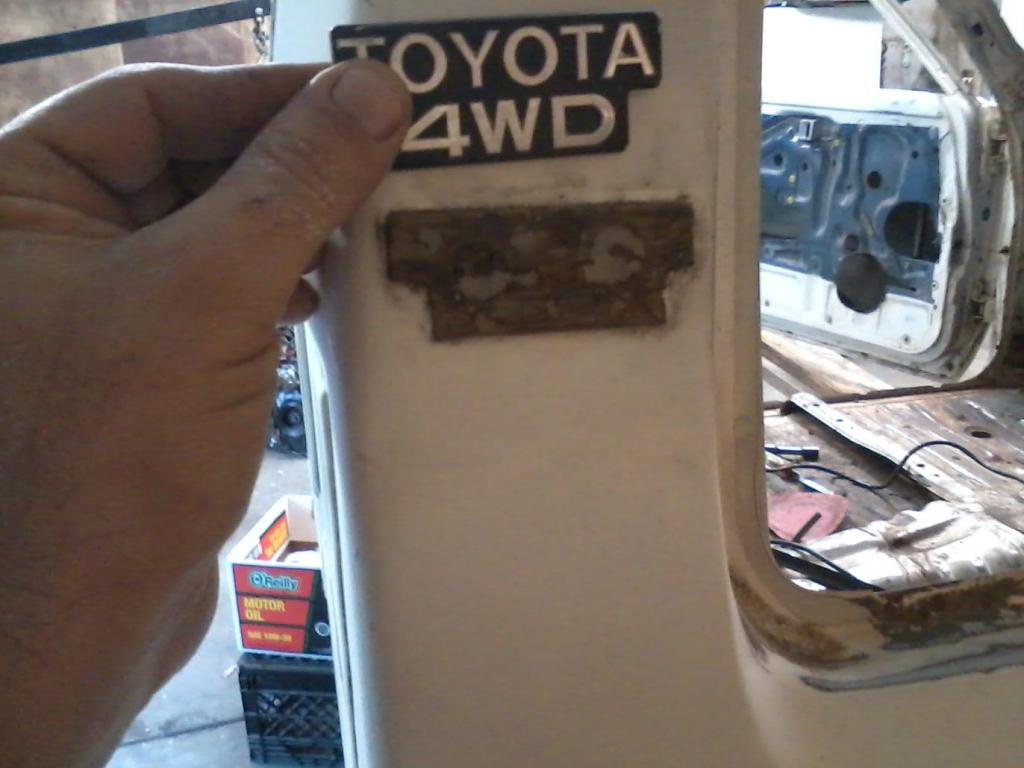

I wound up removing the rest of the dash. It has a mat that generates alot of dust and to get it out I removed everything. Then I gave it a good bath on the inside. I should of taken alot more pictures but did get a few. I did pick up enough paint to do the cab and I will paint more then what the factory did. Will get some of those pictures later. I am hoping to paint tomorrow but it could be Friday. The glue that the previous owner used on some things is really slowing me down on getting it off.

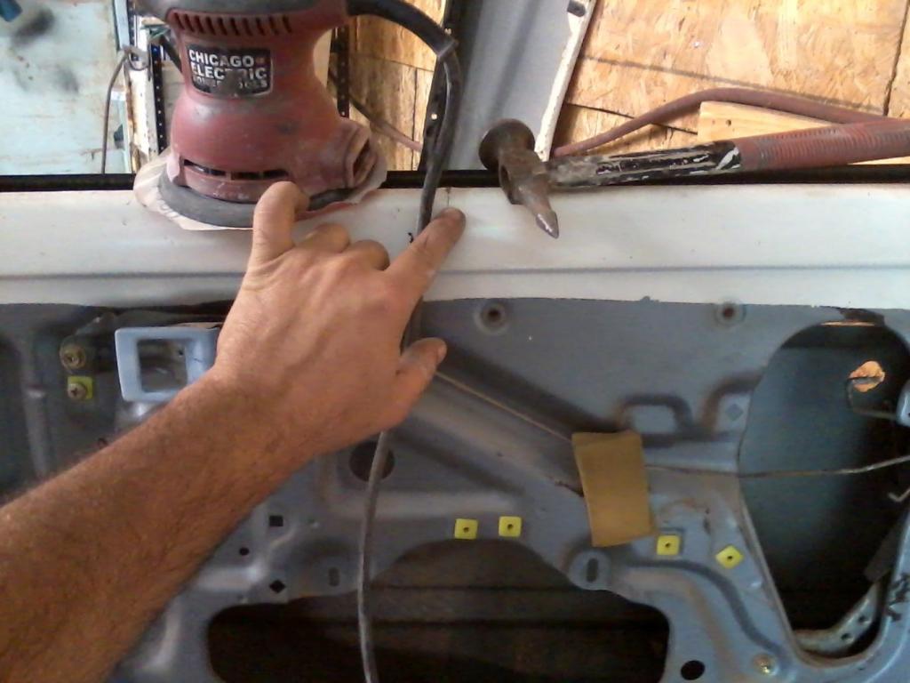

Here they did not remove the handles when the truck was painted previously. I am sanding out some runs that they had has well from not removing some things.

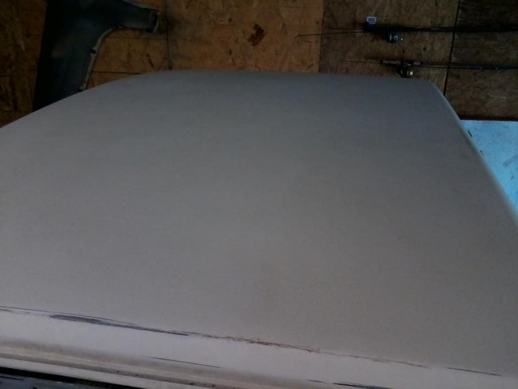

Roof is in great shape. I do have a small spot to fix. Best roof I have ever had to work on. Most look like elephants have danced on them. This one is nearly perfect.

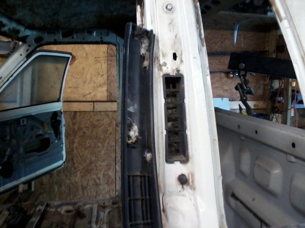

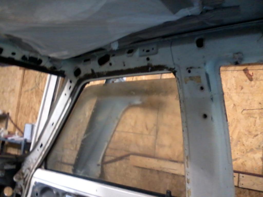

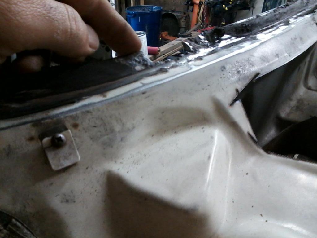

Another reason I remove as much trim as possible. Lots of dust behind the B pillar trim and I used high pressure air to clean the truck before giving it a bath with bleach water. No more mice evidence now. I will Peel and Seal the cab before I put the interior back in. Have done lots more but mostly is cleaning and removing things in preparing to paint.

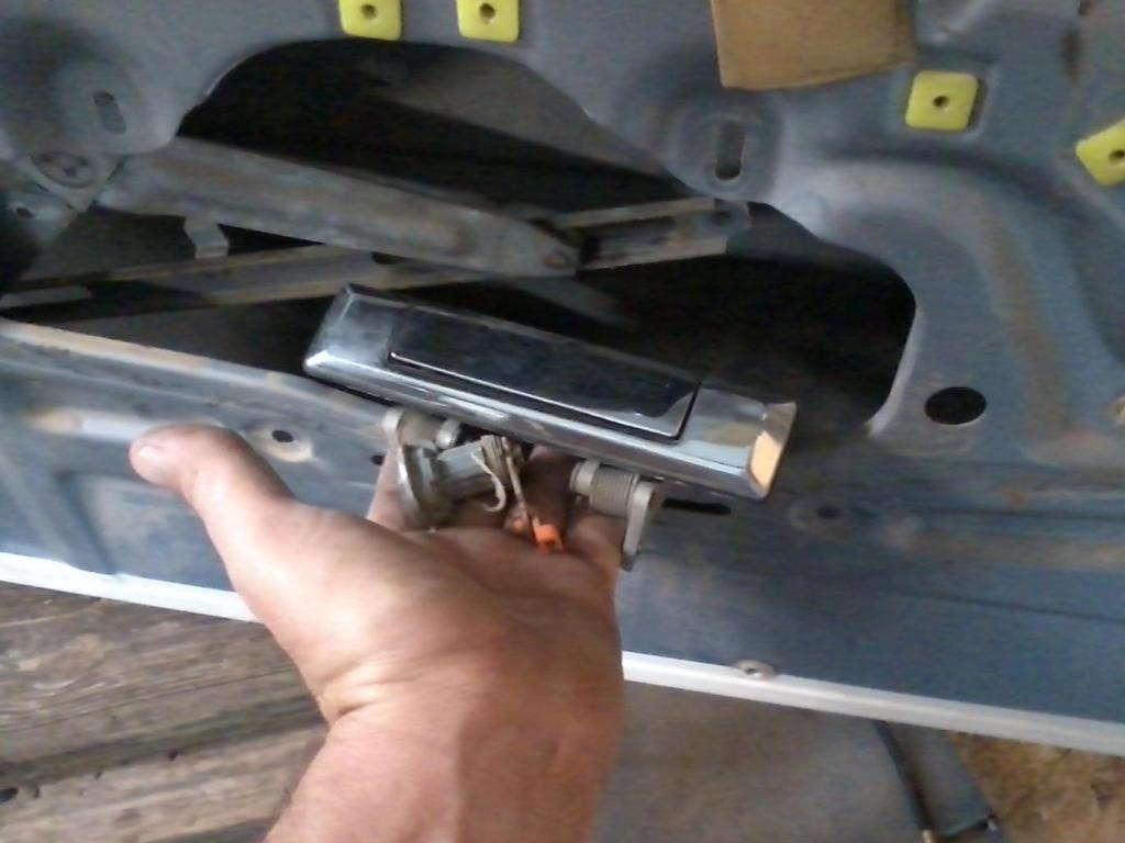

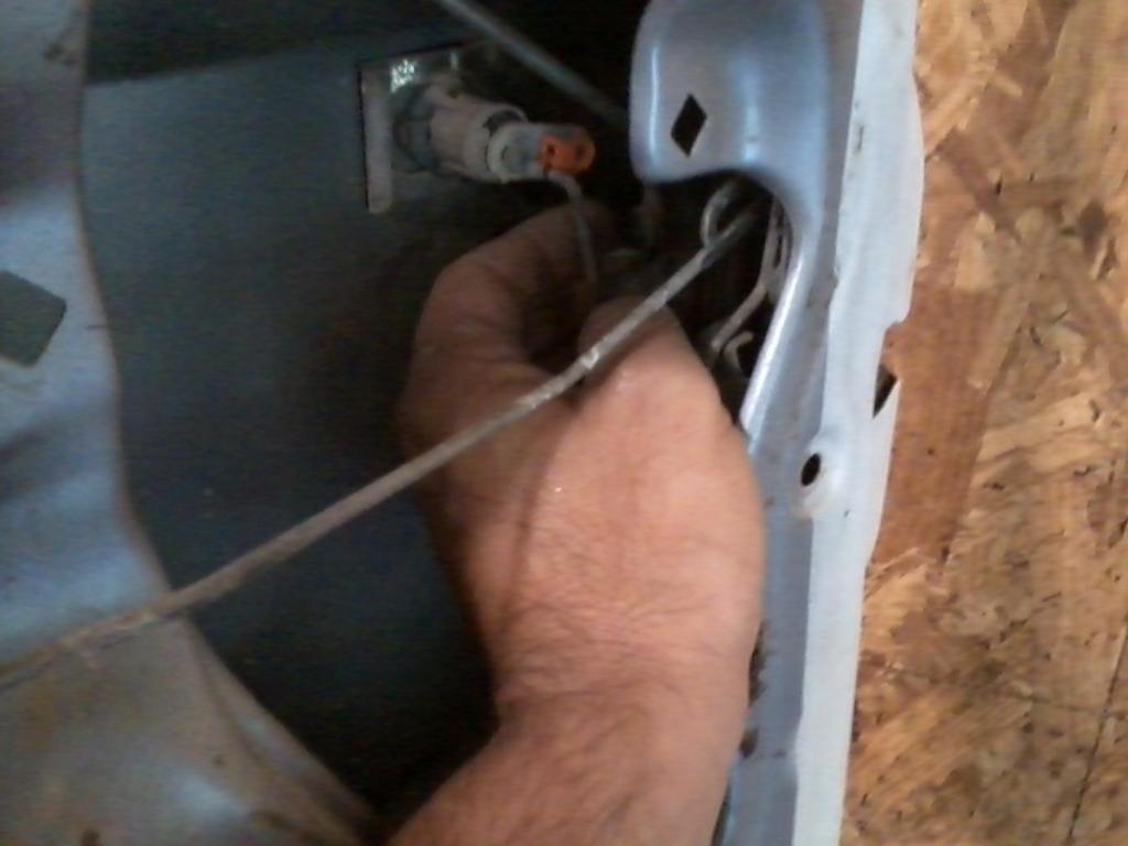

Opening and closing the door is the one reason you will see that the handle is the last thing I remove just for that reason. I tried to rig clothes hangers before but couldnt find away. What I do is just stick my hand thru the opening and push down on the lever after I get the door handle off. I usually just use one finger to access it. Also when I am painting and needing to open and close the door I stick my finger just inside the lip to open and close it with out latching it. I do this so that I can get the jams.

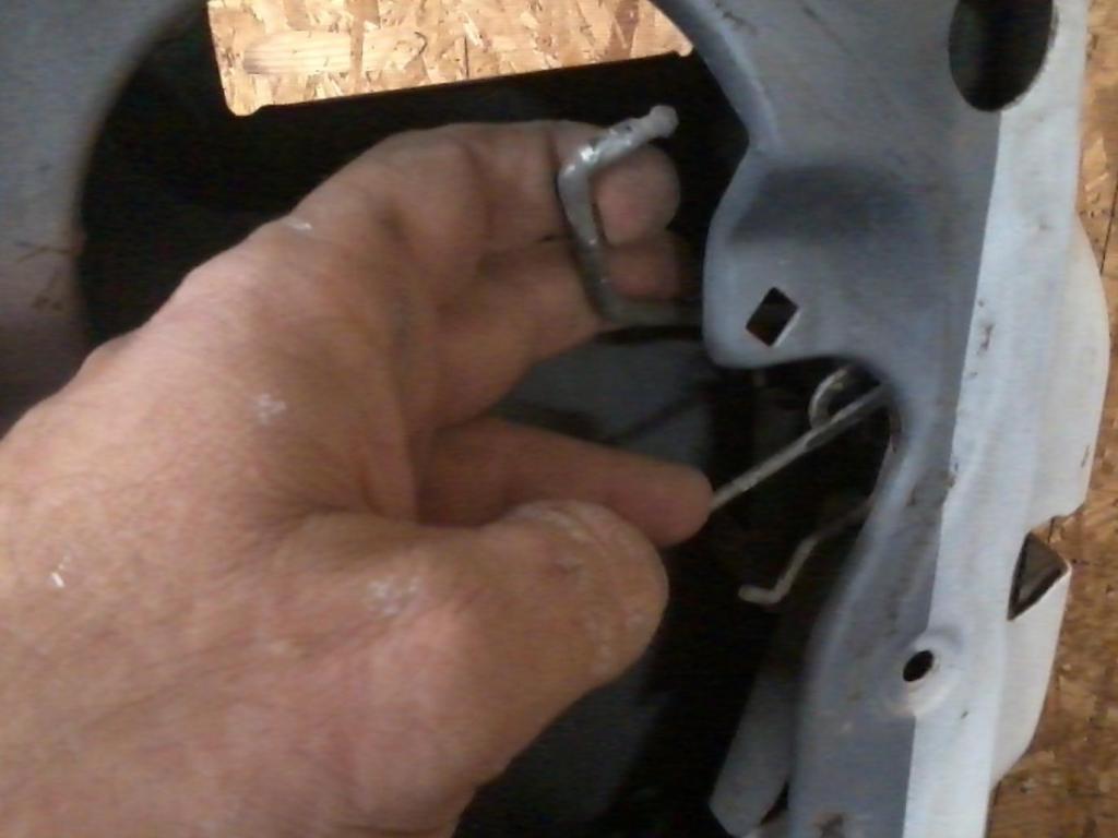

Getting this clip off is a royal pain in the rear. It is going to be brittle and will break on you. They are about $2 new from Toyota. Just be prepared to buy two of them. They go together easily but the clip pops thru the hole and the the rod keeps it seperated. Getting it out is the hard part. I stick a flat blade screw driver between the rod and door handle and twist it. You can see where one of the clips broke on this one and have each one I have ever done.
Once you get the clip off, it is easy to just push down on this rod with one finger from the outside. Sometimes it will want to fall to the latch assembly and you just kind of hook your finger to pull it to where you need it to be and then push straight down on it.

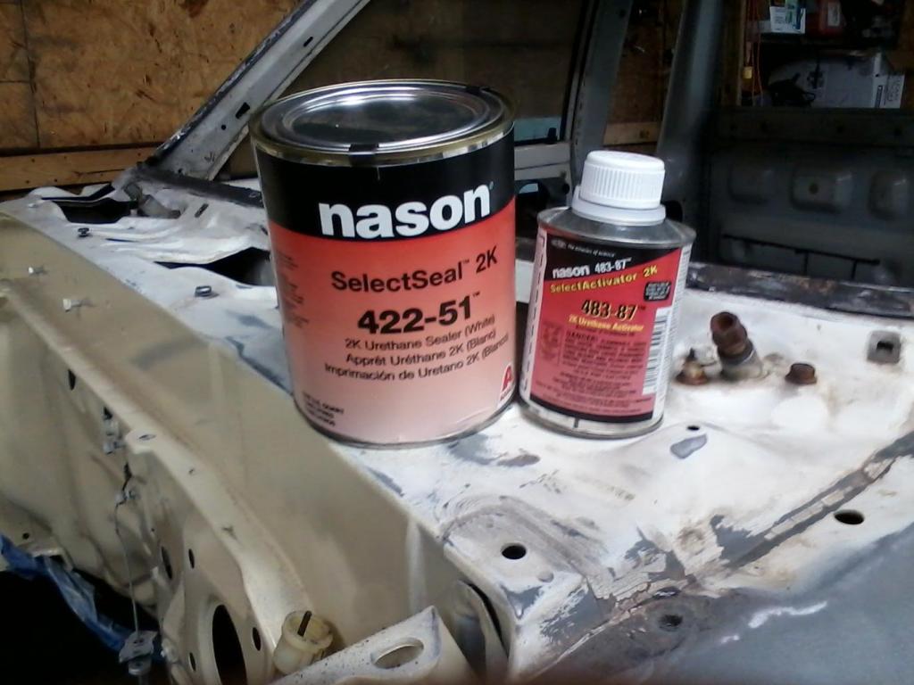

Using a sealer in between the primer and base coat gives you one last oppurtunity to fix any flaws before paint and makes everything one color so as you dont have to add an extra layer of paint over a light or dark spot. I really recommend using this. Not needed and adds about $65 to the cost of the paint job. I wont seal where you cant see, just the outside panels. One quart will cover an entire truck.

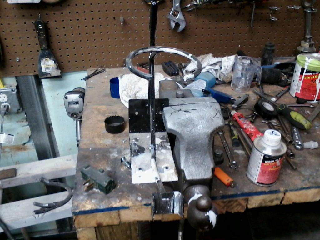

I had my paint gun stand mounted on the end of the work bench, but it got in the way. This works great and I can store the stand when not in use. If I find a convient place to mount it later I will but the bench is used for mechanics and think this is my new mount.

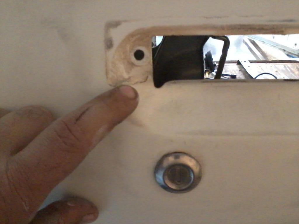

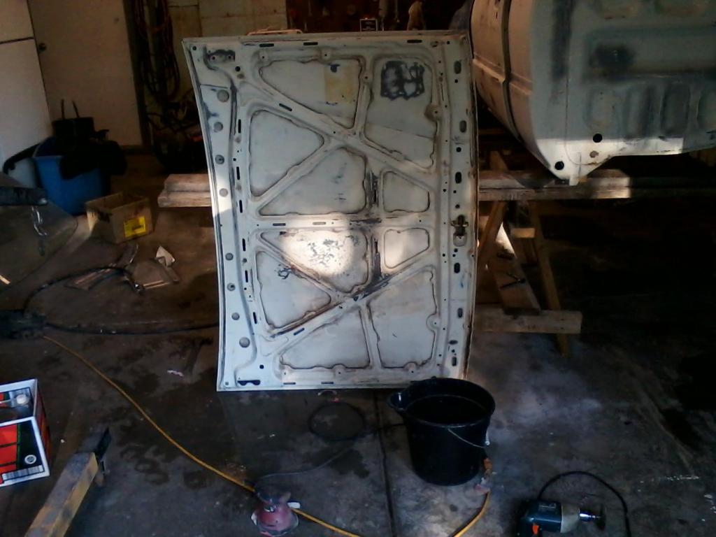

Passenger door where I am spending time removing paint build up from not removing door handles.

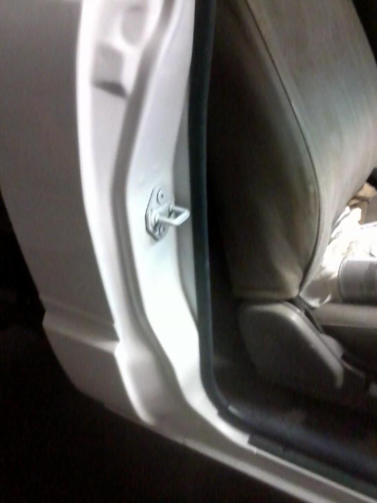

To remove the door seals, on top squeeze and work down the sides.

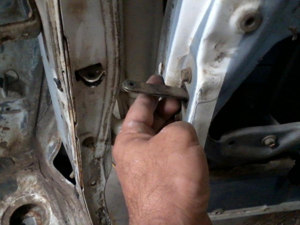

When you get to the door stop, I remove the pin and also you can pull the strip up and down to get it off of some little "T" tabs. I eventually will replace mine with new seals. I have them marked in one of my thread for new ones some where. The rubber seals are usually dry rotted and need replace. I have found some nice one in the salvage. Look on campers if you see one in a salvage. Usually in great shape.
Door stop, I just slide it way back in the door.

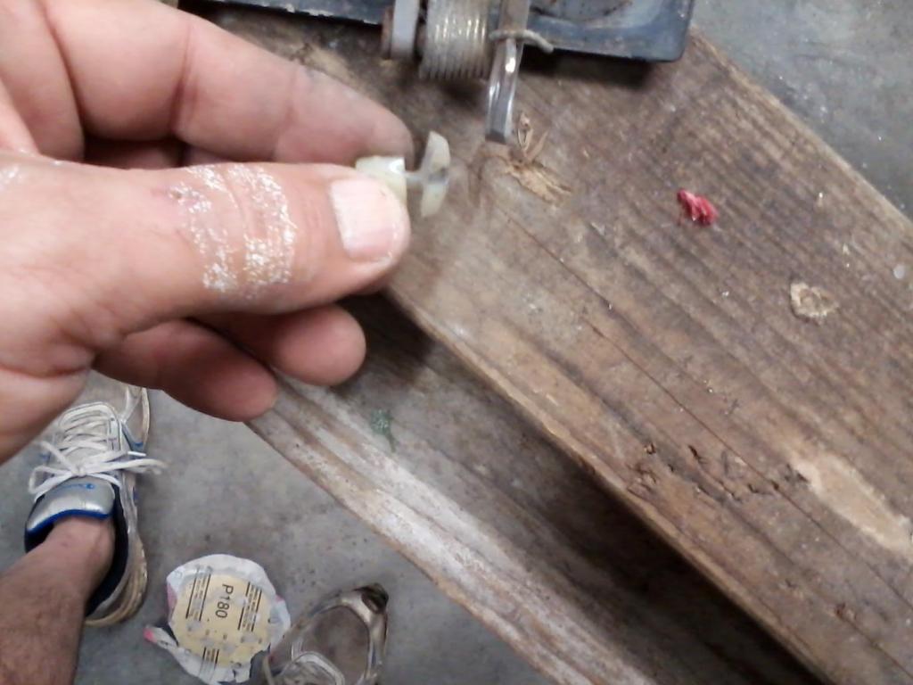

Two of the four drain holes on mine were clogged. Even though my trucks start out as junk, going thru one like I do, mine are cleaner then a used truck. I have seen nice used trucks that are filthy. Even with rat droppings, feel mine are cleaner as I use bleach and will peel and seal. Not trying to be gross but project trucks and some used trucks can be nasty.
Door Lock removal. These are side specific. Passenger clip is orange. I turn it 90 degrees to remove from rod.
Once turned, just pop the rod out and the lock will come out from the front.

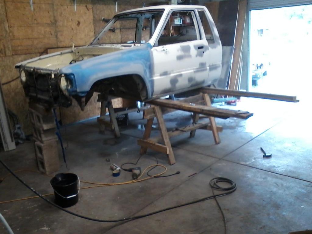

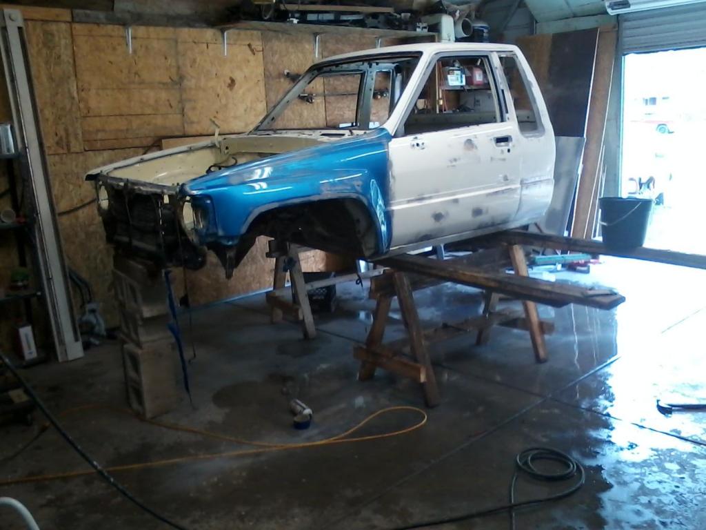

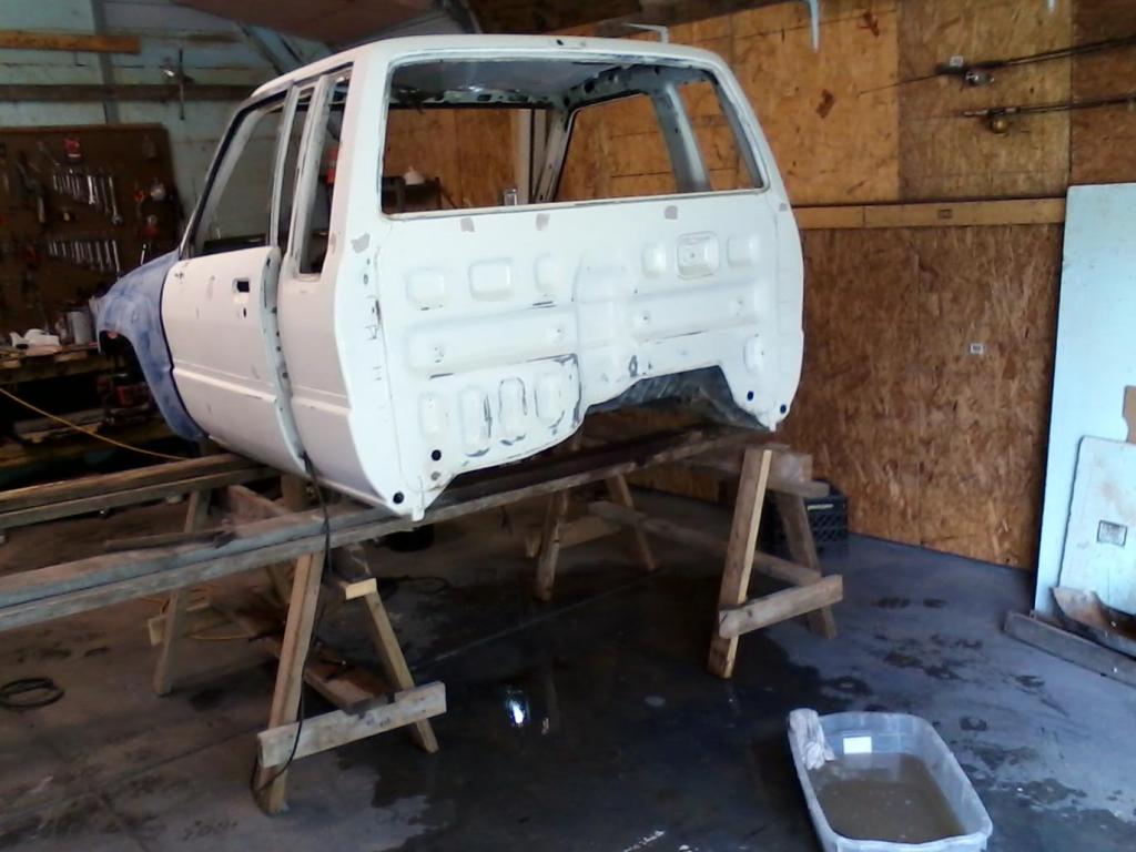

I got the fenders on with two bolts to start sanding on them. Have some paint chips to fix and they should be done.
Going to have to raise it higher to do some repair work and will wait til they get home for that.

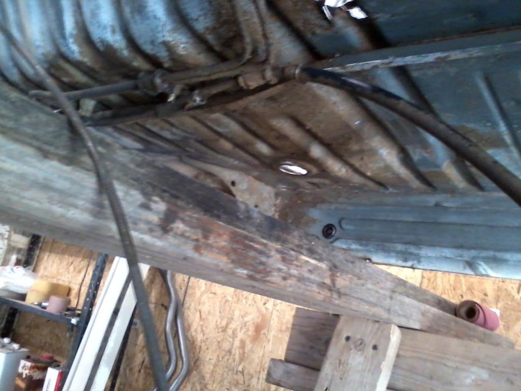

Been doing some work on the under side as well. This is a heat shield. Still have another greasy one to go.
I have started some body work. The 5 spots are about the size of a hail ding. I am also working on the underside. I was going to use bedliner for the bottom but am afraid it will crack out and cause a place for water build up. I will just paint under there to prevent any rust. ( I hope)

I also dislike the door and lock rod clips. They always break or get brittle and break when you mess with them. Sometimes they are in a compromising position and seem near impossible to get off. I too, usually keep some on hand for when I have to mess with them.
I like the idea of using the sealer in between primer and base. Plus it adds another solid layer to help against shipping off later down the road.

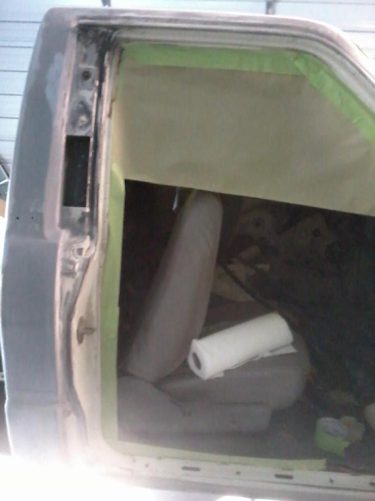

Super Glue will fix anything. I got a little rip and might see if I can replace it later.
I pretty much have the drivers side done. Still need to do rockers and roof. Started blocking it out.
Not a sure fire way of determining if it is smooth, but when it is wet and you run your hand across where the damage was at, without looking, you cant feel where it starts or begins. Also the whole panel kind of feels like a freshly waxed surface in my opinon.
Here is what most of the underside looked like.

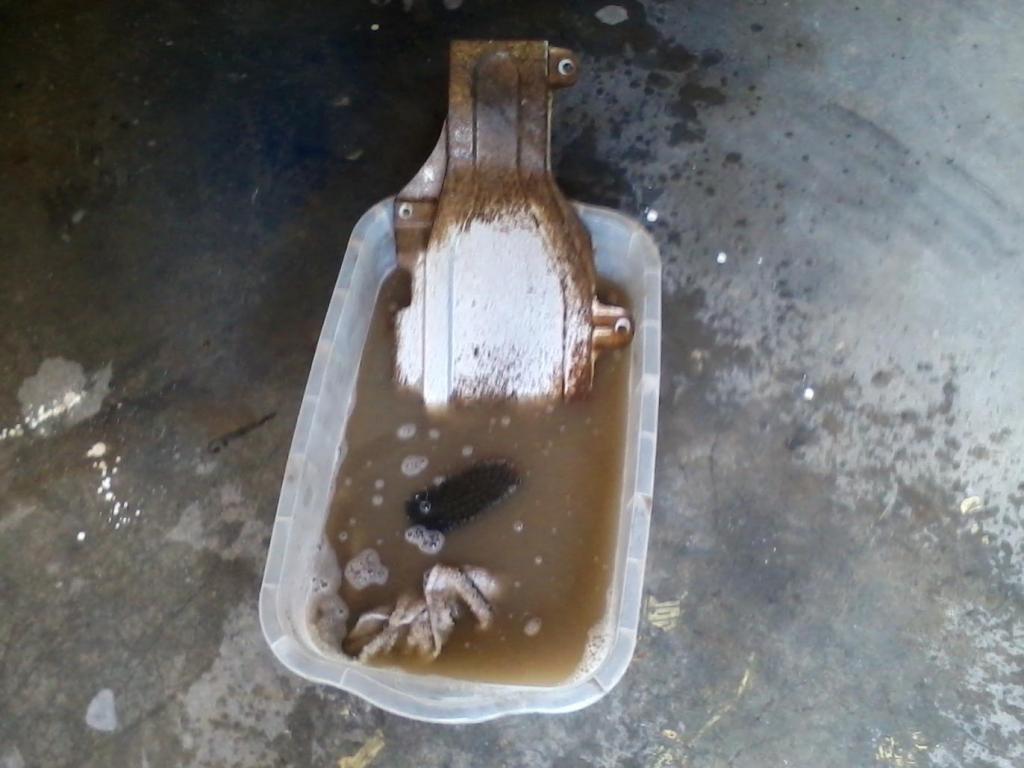

Got the heat sheilds cleaned.
Starting on the inside of the hood. It is dirty and taking alot of time to get prepped.

Making some progress but still have a ways to go til it is done. Mosquitos arebugging me. Will try to get out there after awhile.
