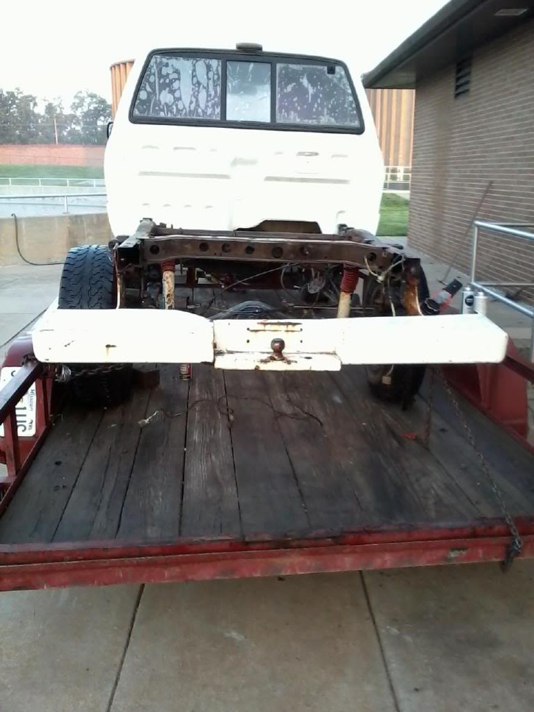

I really like this bumper, but when I took the bed off I could tell how damaged it was. I have a chrome bumper that I will eventually use. It was what came on my 86 Runner when I first got it. My 85 has been temporarily evicted as I am getting the shop ready to paint the 86 extracab.I also got the frame cleaned up and scrubbed down. Will be painting it a little later. For now I got the area where the fuel tank sits painted. I want to get the fuel tank back in here fairly shortly.
It is sitting tilted as I have a stock tire on the passenger side. The end of the frame was banged up and I was able to get it fairly straight. Seems like every truck I work on has a little end damged. Did get a lot of mud out of the inside of the frame. I will take it to the carwash again to get the front part of the frame at a later time.
