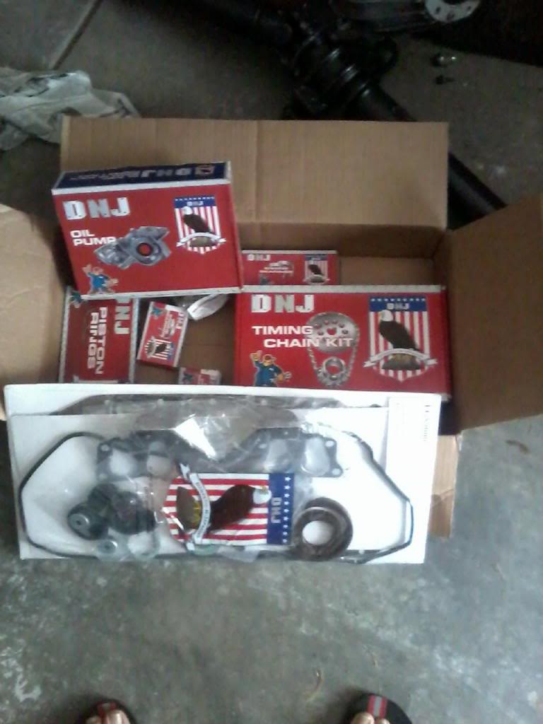

I must of not ordered my parts right. I got everything except the pistons from Engbldr. He has my pistons on the way. Always nice getting parts in.

new parts always awesome to see an have for a project
did you have to go bigger on the pistons terry or stock size

Hello Cyberhorn, I had to go 20 thousandths over on the pistons and 10 on rod and main bearings.

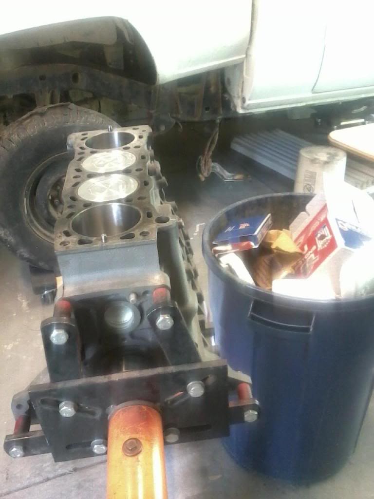

I got my short block put together today. I have everything else to assemble the motor and I think I have everything to get it put together and get it running. I am still going to pull the body off and do the entire frame but do want to get it running for now so as I can move it around and finish a few other projects. I have been going thru as many of the systems as I can checking them out, coil,sensors,... I need to install the gastank and I cant think of anything right off to keep it from firing up. But will have to wait til I get the motor in and see.
Trash can full of empty boxes is always a positive. Crank and pistons in.

Old Jul 28, 2013 | 10:15 AM
  #168
Cyberhorn The Dragon's Avatar
Joined: Jul 2012
Posts: 2,365
From: Idaho
oh what a tease terry backside of the block in the stand LOL

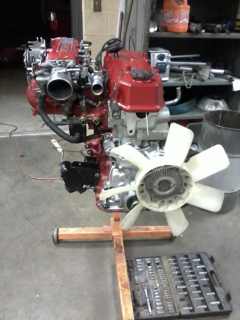

I have gone thru this engine and still want to retorq all of the nuts and bolts. I am having an issue of the Harmonic Balancer is not wanting to go onto the shaft all the way or something behind the oil pump is holding it out. I will be checking into it when I get back from drill after this weekend. Just hoping I dont have to pull the Timing Chain Cover. The truck is missing its exhaust maifold. 85/86 have the O2 sensor in the manifold. I dont care to use headers, so will start searching for the exhaust manifold. One of the benefits of restoring a truck that was used for parts.
Joined: Jul 2012
Posts: 2,365
From: Idaho
she looks great terry there are several 22re's being parted out on the forum buuut dont know which might have the right exhaust manifold

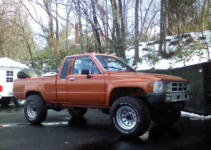

Looking for color ideas.
I like the topper being painted to match the truck.
I have had red, probably not.
If it looked good on this body style.
Old Aug 6, 2013 | 04:44 PM
  #176
Joined: Jul 2012
Posts: 2,365
From: Idaho
sent ya a PM with several options i can even try to do a 2 tone if you'd like
Old Aug 6, 2013 | 05:11 PM
  #177
85sr5excab's Avatar
Joined: Sep 2012
Posts: 618
From: iowa
I really like the burnt orange in the top pic myself.
Old Aug 6, 2013 | 05:20 PM
  #178
Joined: Jul 2012
Posts: 2,365
From: Idaho
LOL i said that as well
Old Aug 6, 2013 | 09:35 PM
  #179
85sr5excab's Avatar
Joined: Sep 2012
Posts: 618
From: iowa
There u have it. 2 votes burnt orange, no votes any other color......I think the winner is clear Terry lol.
