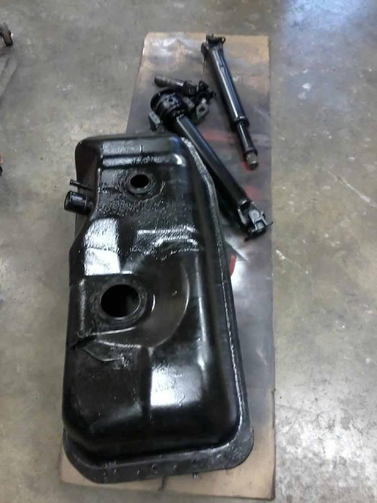

The other day my youngest son said we would never get the big truck running ( what he calls the 85) and mom and me said yes we would. He wanted to bet the both of us $50 that we wouldnt have it street legal in 3 months. I will be gone from June 8th til the 24th and so I said I needed two more weeks. He agreed so I need to have it street legal by October 12th. The only big thing that is holding me up really is getting the motor put together and a little time and I can have it running.
I showed him some pictures of trucks I had already done and he still thinks he can win. He is going to be doing alot of mowing and side jobs in the neighbor hood. I told I would even have it painted by then. I have been having to put alot of my build funds into our 3rd Gen runner as it has been needing alot of basic maintaince such as tire, alighnment, tie rod, brakes and seems like there was something else. I also have been getting some parts for my 86 Runner and that has cut into the 85s build as well.
Been waiting for the weather to clear as I can take some of my parts to work and do them on my lunch break. After I get back from my summer camp on the 24th, I should be able to put some funds and time in on the 85. Even Misty wants to show him that we can have it done. Should be alot of fun. Him challenging her was what really got her wanting to get after it quicker as well. Just had to take care of the family truck and get some parts for the 86 while the getting was good.
I did get my fuel tank cleaned and looking great. One thing I have always done in the past was to rinse the tank with water before adding white vinegar. This time I had a quart or so of gasoline still in the tank and I think that weakend the vinegar and took longer then it should of. I will rinse it the next time.
I try to mention in all of my builds about how bad these tanks get and this one cleaned up really well. I will still use some Red Kote on it to prevent it from rusting again and to seal up some rust dust that is as fine a baking flour that is nearly impossible to get out. Probably wouldnt hurt anything, but I think it is so fine, that it could get past the fuel filter and get to the injectors.
Alot cleaner then what the picture shows. The black you may see is a stain.
Got the tank painted and the driveshaft cleaned and painted as well.
