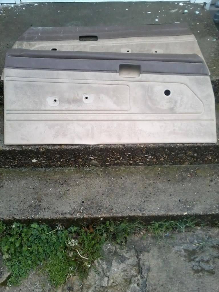

I did come across some uncut door panels. Mine have speaker holes in them and are full length. The ones I got are half panels. Great shape just need cleaned up. Even if I cant or dont use them on this truck, it is nice to have a good set available. If they wont work, Grego has a nice write up on door panels.
Weather is supposed to be alot better after tomorrow so I am hoping to get started on the several different things I do have to get them done. Should be one busy summer and things will start to move quick once I get things going.
Great door panels I found out of a camper. Someone beat me to the door seals or I would of grabbed them too.

Thanks Cyberhorn..It is alway nice having some great parts and these dont have speaker cut outs in them.

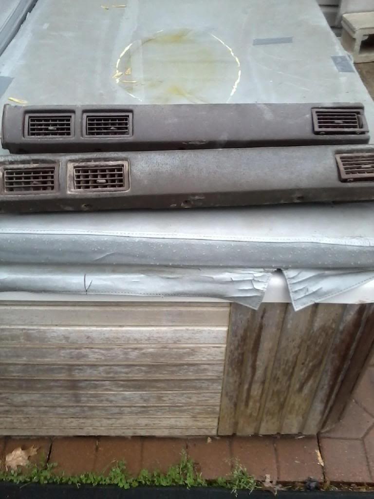

I also got 2 great condition dashpads. One for my 86 and one for this truck. One has a hairline crack at the front of the pad, other then that, both are perfect.

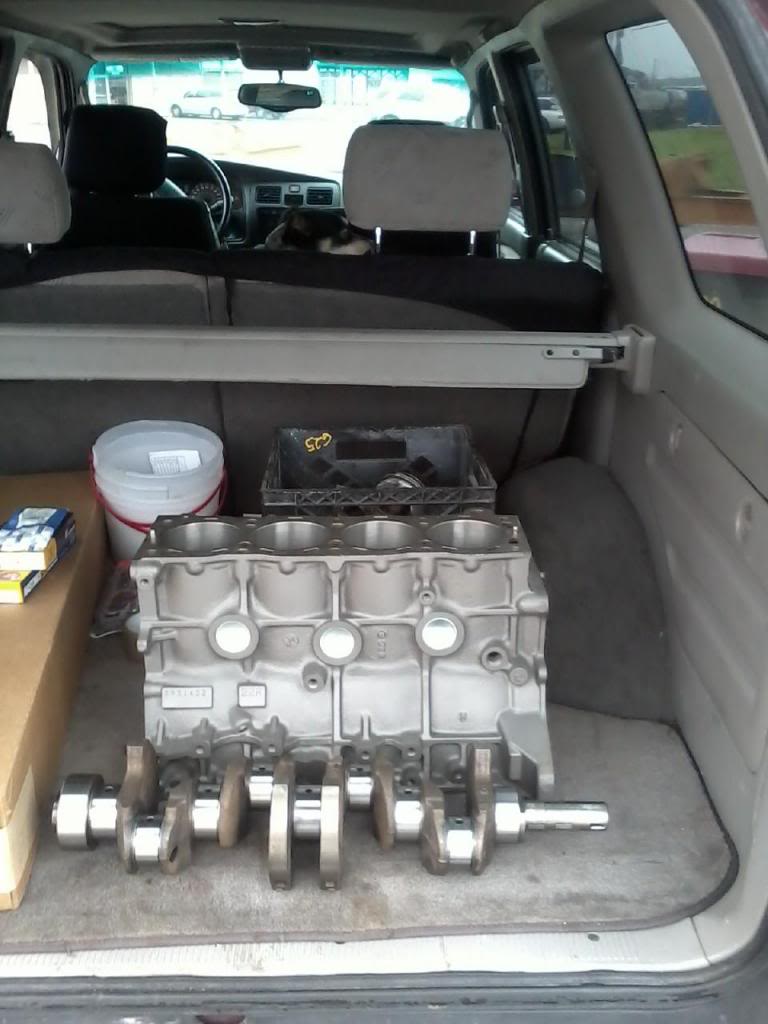

Havent been able to do much on the 85. We had some snow earlier this week and I am trying to get the 86 extra cab ready for paint. I did get to pick up my block,rods and crank. Rods and crank are 10 thousandths over and the bore is 20 thousandths over. Was hoping to avoid alot of machine work but since this truck is going to be a keeper. I will spend the extra on it. Will be looking at Engbldr and slowly accumalte the parts I will need. Hope I just need to get the pistons,rings and bearings for the bottom end. I have most of everything else.
Slowly building up the parts.

that is a CLEAN block terry sheesh ya could eat offa that one lol!

Hey!! Is that your runner in the pic with the block n crank n the back??Didnt know you had another one!

Thanks Cyberhorn... I will be glad when it is in the truck, but the truck isnt ready for it any ways so it should work out fine when it does come together. The truck is going thru an explosion before it goes in. The weather is warming up and I still havent gotten to mess with getting the bed off and I am hoping the cab isnt as difficult as the bed has been. I want the frame looking purty as well and also want to use this thread to show how to do frame and body swaps when this build is completed. It is going slower then I would like but it will happen.

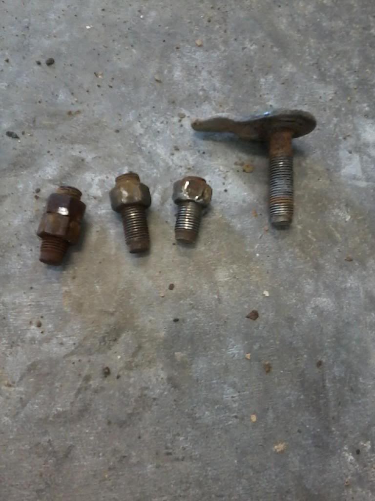

I wouldnt normally get excited about broken bolts, but these are on the bed and they can get pretty rusty. I have soaked them in 3 different rust dissolvers and several times and they still wouldnt loosen. Today I got the cheater bar and a breaker bar and got them off.
The one on the right is a bed bolt. I have broken sevral of these in the past. If they dont break and the tab bends up where it cant hold the bolt still, then you hope you got enough room to get a cutoff wheel in between the bed and the bolt head. Luckily this didnt happen to me this time but it has in the past.
Bed is ready to come off, just need to get the parts I have stored in back that I have already cleaned up and set a side for this truck. I am wanting to pull the bed and eventually the cab, but for now I want to get the gas tank out before it gets to much warmer. As it is now I will have fumes and that is something I dont care for as the fumes are what can be dangerous.
I try to mention in each of my build threads about how bad the tanks can get in these and I am sure this one will be no different. If nothing else for the peace of mind knowing it is in great condition when done.
These broken bolts are actually a good thing. 2 weeks of working on these. I normally have patience on stubborn bolts, but did get tired of the hold up.
