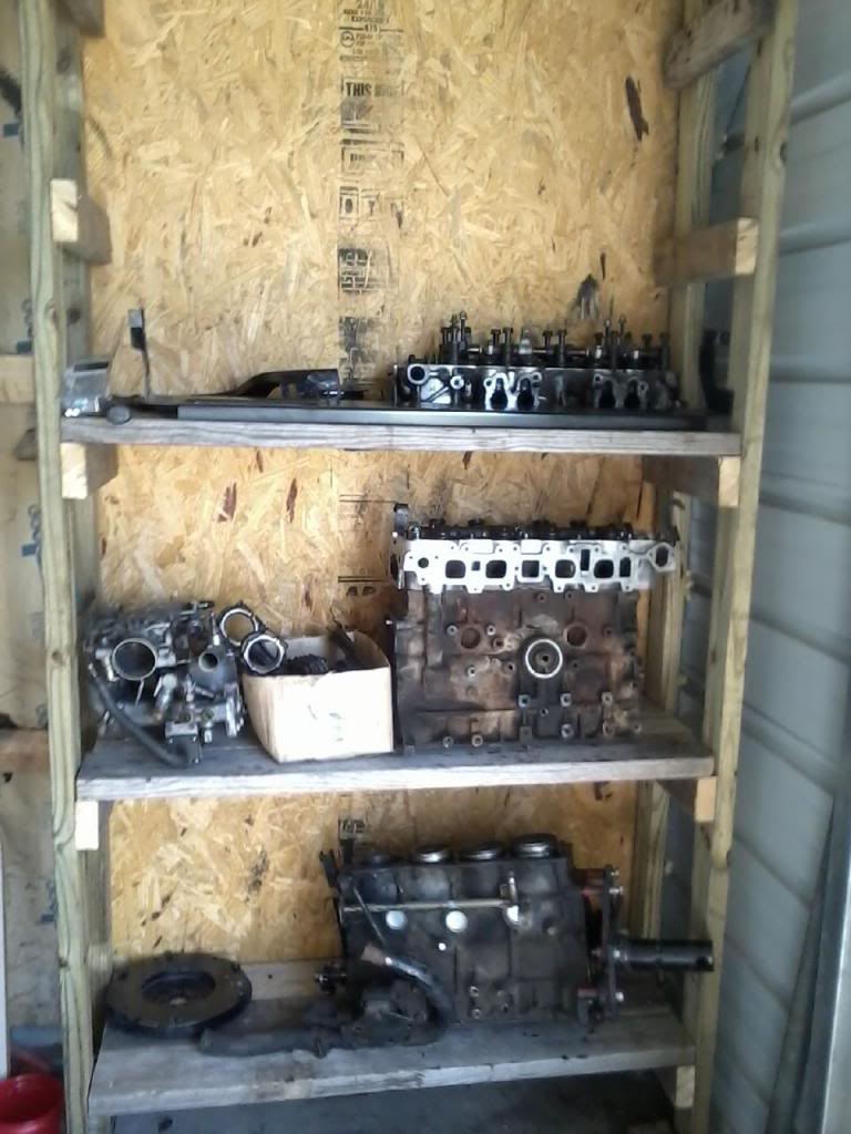

I was looking over the rest of the truck and I will be changing out the drivers front fender and it has a little ding in it that I got off of Highluxs which is a great fender. I only see 6 other little dings on the whole truck. Just door dings. Cab roof looks perfect and 3 in one door, 2 dings in the other door and one in the extra cab part. When I get on it, it should not take long at all to get it ready for paint. Might be one or two that I missed but wont be much. Waiting to take some time off from work to get it done but we are a guy short so who knows when that will be. Hoping soon for some time off.
This shelf sit at the back of my truck. I was on a ladder and at the top of the shelf and I did not have it very stable and I fell off of the ladder and so jumped to the frame of my truck and didnt make it like I wanted to and fell to the floor. I dont bruise easily and havent had a bruise in about 10-15 years. Now I am hobbled up for a few days but it could of been worse. Buggered my leg up real good but for the height of the fall, guess it was a lesson on being a dumb butt.

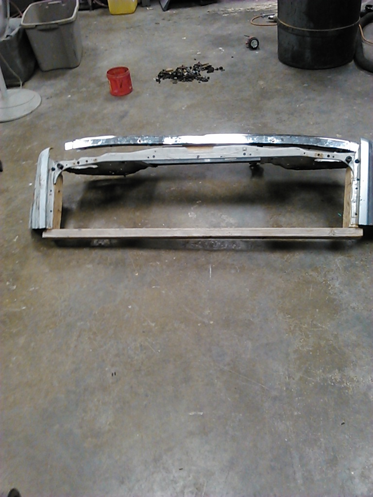

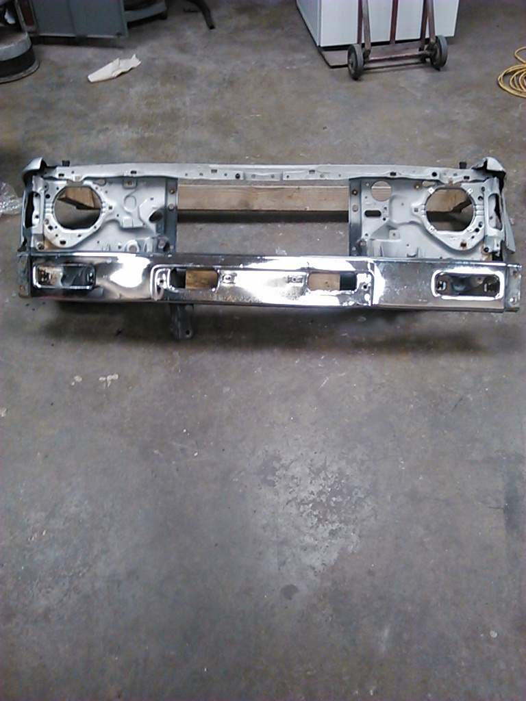

I was looking over the rest of the truck and if I counted right, I have a total of 6 door dings. Less then hail damage or very minor damage at all. I fixed two small dings in the new fender that I will be putting on at a later time. I got this fender from Highlux and it is in excellent condition. I just got it roughed in and will finish it up completely when it is on the truck as it is easier to work with on the truck and is to flexible as it is now. The bed I still have a couple of hours worth of work on as well but that wont get done until I go to paint it.
I do not like headers so I took a "Y" pipe I had and with a wire brush, drill and sandpaper I was able to get it to new metal again. Checked it out for cracks and everything looks great. Just need to get it on the manifold and it will be loud when I take it to the muffler shop at a later time as well.
It wont take long to get the rest of the body in shape and I could be painting it soon but I want to get all of the mechanical issues worked out before I paint it as it will be coming off of the frame for paint.
Two parts closer to being done and show how minor the damage is on the whole truck.

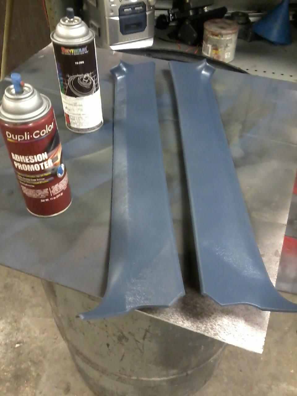

Size:  46.5 KB[/QUOTE]
What color and where can i get this paint?

Hello JusToyotAdkins... The Adhesion Promoter is just an off of the shelf can. The interior paint I have mixed up at Oriellys. You will need to ask your local store where their paint store is. That is the support store that can mix paint and supplies all of the rest in a certain amount of radius from the paint store.
I have an Oriellys 2 miles from me but I have to go 35 miles to the one Oriellys that mixes the paint. You can take a sample such as a kick panel that isnt faded and they can mix it up to the same color. I believe Autozone works in the same way. I dont have Schucks, Checkers and some other stores so dont know if they do the same thing. You want to make sure that they know it is for interior use. Cleanliness is the key to getting it to look good and lasting. I use a solution of water and Simple Green and rinse well.
There are a few colors that you dont have to have custom mixed, but blue and red is one that you will have to. There is a gray that is close but still stands out if you dont do all of the pieces that is off of the shelf.

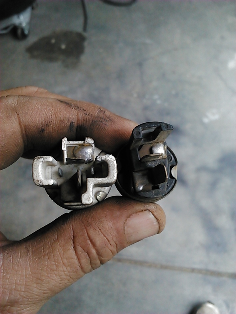

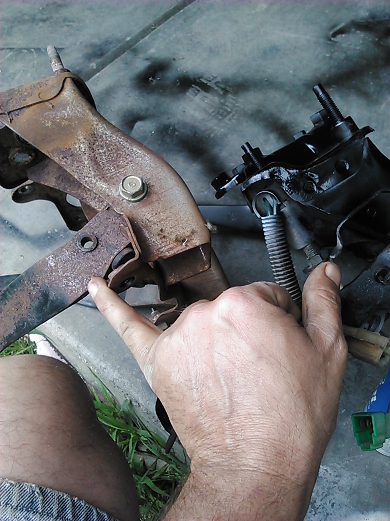

The 85s don't have a Clutch Safety Switch and no place to mount it on the 85 clutch pedal. Since I have an 87 wiring harness I swapped pedals with a spare assembly that I have. I could of jury rigged it with a jumper wire and that is what I did to get it to start on starting fluid.
I did get a few gallons of gas for it as the tank is still dry. I swapped a lot of parts from my 85 trouble shoot the wipers, blower motor, and TPS on the 86 pickup and had to go put it back together. Got some done but still need to do some more of getting it back together. Tank is still dry but hoping to take some time off from work later this week and hope to get it running with gas in the tank.
I did get the pedals swapped. Here is the difference between 85 and the newer trucks where my fingers are pointing for the Clutch Safety Switch.
Toyota also switched this plug to the brake light switch so got to swap that out as well.

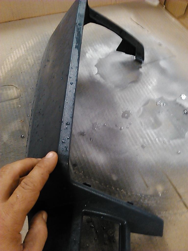

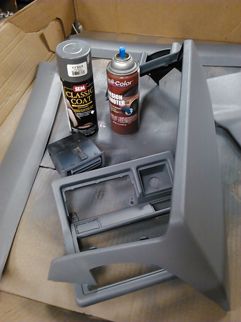

My truck originally had a blue interior and I had the dash blue. I have since got some gray SR5 door panels and will have a gray interior now. This Speedometer Bezel will work for now, it is the squared off type. I like the bezel that has a pointed edge to it. Most would notice the difference but I do and is the one I prefer.

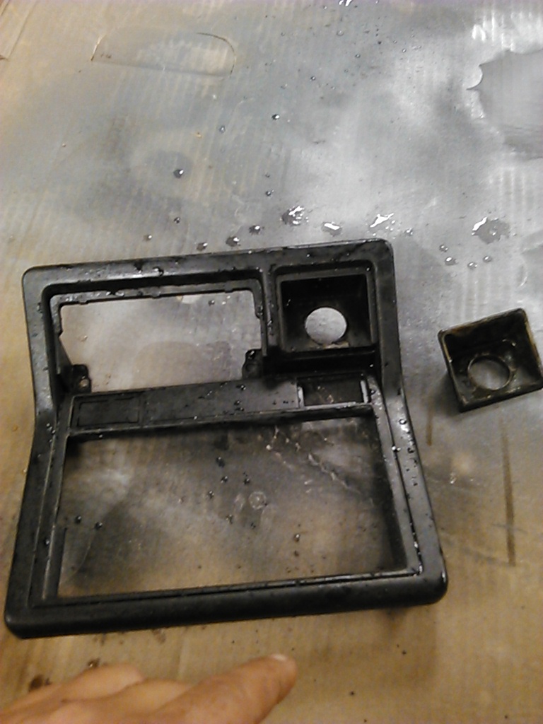

I don't care for the black trimming on the inside so changed it to gray as well. Factory it can be black or same color.
Here are the parts that I have changed to gray. Still have a few to do and the Main Support and will be getting to that soon. I will find a nice set of gray seats and for $100 I can have new carpet. Some one did a bang up job of doing a crappy headliner replacement with who knows what, but I can get a head liner out of the bone yard for about $20. The $30 I have in my door panels, interior paint and a few other things, I figure I will have a nice stock looking interior for $200 or less. It will be awhile before I do the carpet as I have to have a patch panel put in the floor to repair a hole in it.

why couldnt toyota stick with ONE kind of plug for more than a year sheesh plastics look good terry
on mine i ended up putting the fog light switch near the clutch safety kill on the left side just felt wrong to have it on the right side of the dash

I see you provided me with the SEM color I need to use. Still haven't been to O'Reilly's. I have used a Duplicolor gray on some plastics and it matched well but I wasn't thrilled at how matt the finish is compared to real plastic. In reading over Grego92's thread I think SEM gray is what he uses too. I think he's selling consoles and other unobtainium parts on eBay refinished. The sellers name is Greg and lives in Petaluma, CA? They look great but I wanted to tackle a refinish myself. I have a good double decker base and I'm waiting for a new gray lid cover from topgaiters off eBay. They made the shifter boots we have.

Hello Nervo19..I like SEM better the Duplicolor as well. I use SEM 17303 for the light gray and the 17013 for the dark grays. Toyota has two shades of gray for their interiors. It is close enough for me when doing gray interiors and most need colored again as the gray panels will start looking green with age as they came from the factory.

Hello Gizzler00.. In the past when I seen interiors painted, they used regular paint and I did not like the results. Interior paint works great. Stacey David even did Ted Nugents Bronco with it. A fresh looking interior makes a big difference in the driving of the truck. I still feel like I am driving in 86 or 88 depending on which runner I am in. I have been trying to learn how to repair dash cracks when I can in the winter as that would make it even that much newer. Vinyl repair still is getting the better half of me.
