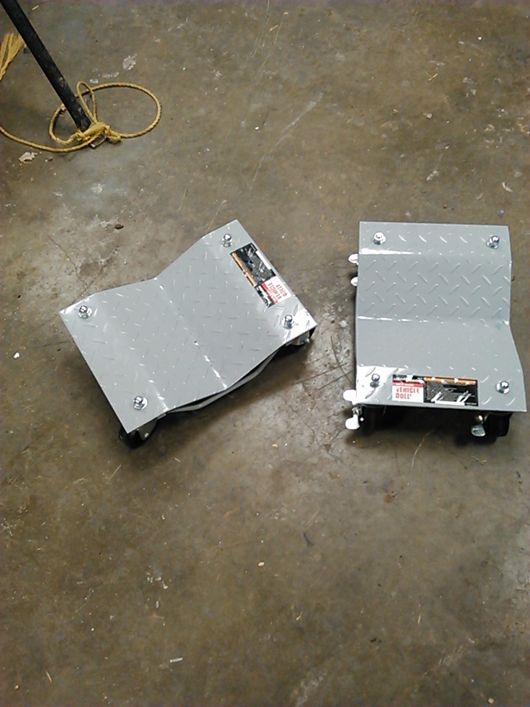

I was at Harbor Freight today and got some front dollies. They had a welder on sale and I was tempted to get it as I want to start to learn welding and need to do a patch panel in the floor, but without electric in the shop I will catch the next sale. Besides, I have found a truck in the yard that is an SR5 and has a nice gray interior that I will be installing in mine. Not sure of the exterior color is still going to be but with the SR5 things that I will be getting, gray will go with a lot of the colors I may want to go with.

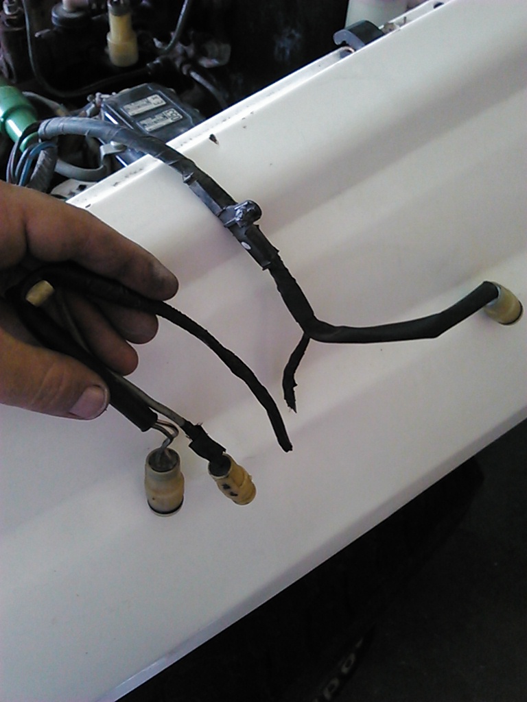

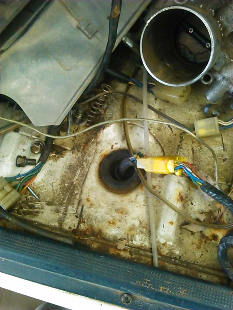

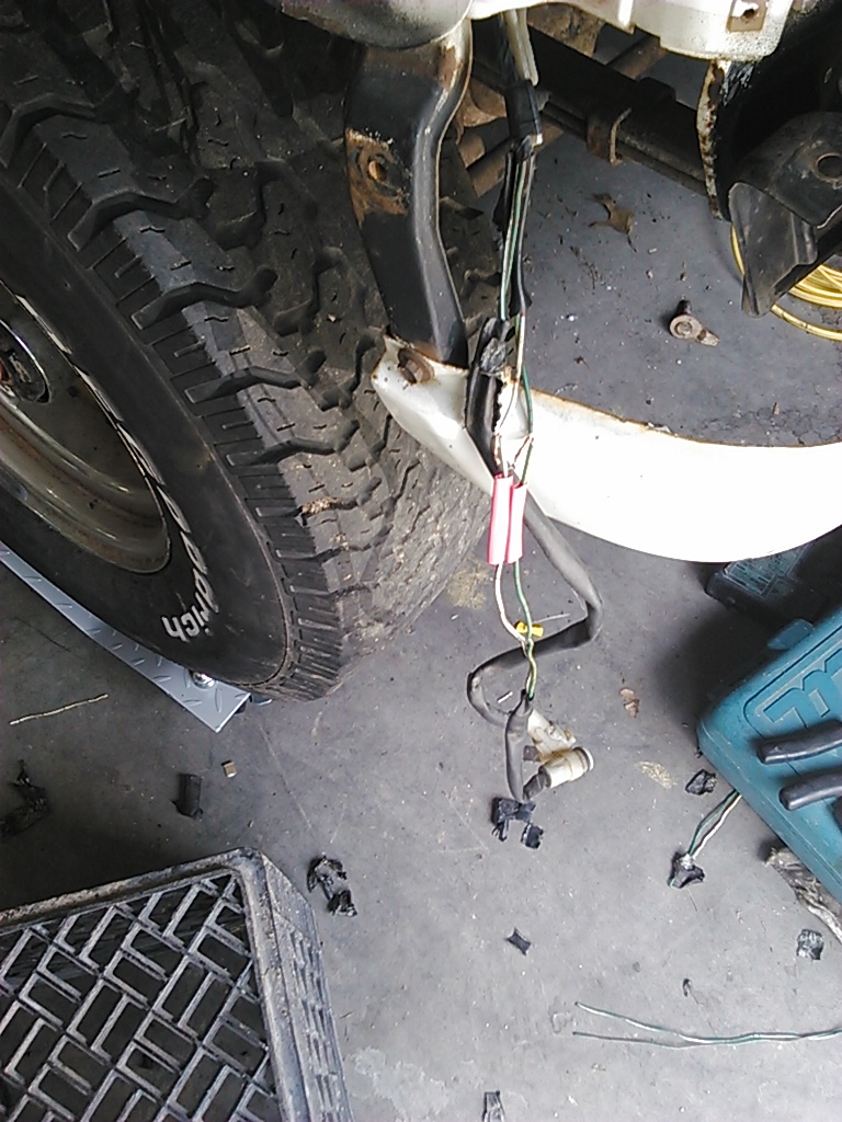

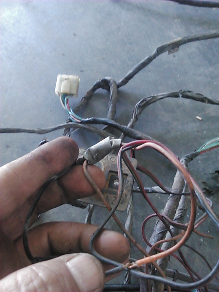

Not sure why the above picture is blurry as it is fine in Photobucket. I started putting the 87 main harness in. When swapping harnesses, it is best to cut the tape that holds the support to the firewall. I have not always been able to get the clips out and then I just zip tie them to the main harness. Got the Main Harness in and the Headlight Harness in. I am using the 88 Runner Headlight harness. I compared the two harnesses and they look the same with same wiring coloring.

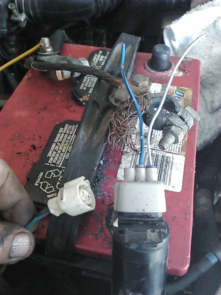

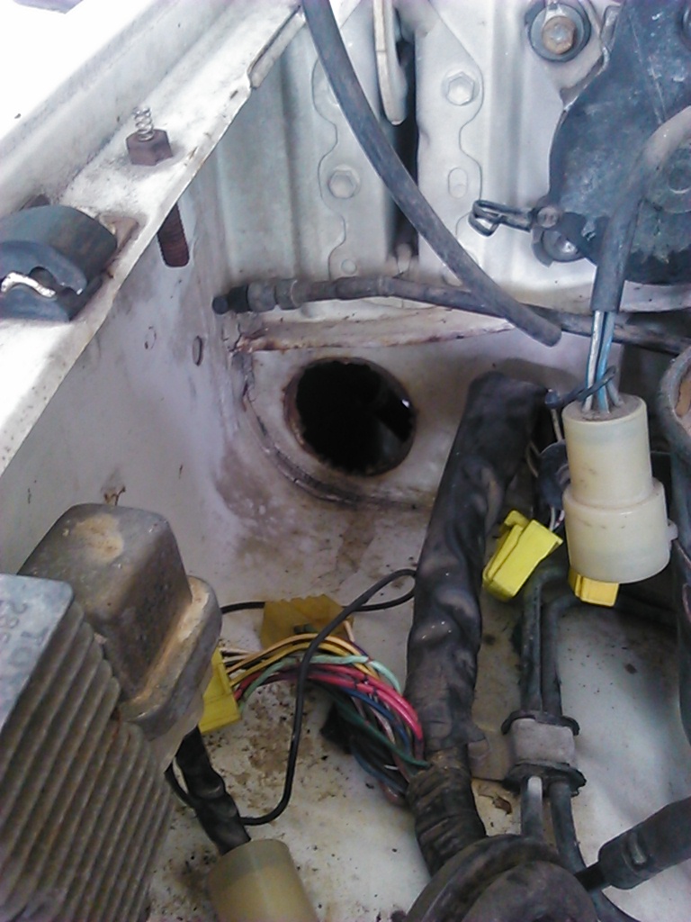

For two reasons I think this truck was headed to the scrapper is someone tried to stick an 89-95 EFI system in this truck and could not make it work. Staying with the same generation is easy to do. I dont think I would want to try and use a next generation EFI system on an older truck. The two reasons I think this truck may have been a carbed truck is how the hole is cut and no EFI on the cab. I will need to run the VIN to see what it was originally.
I am pretty sure it is not a factory cut.

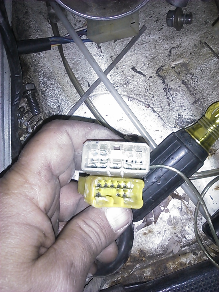

I thought I had a nearly perfect harness. More of a reminder for me but it has the blinker plug cut off. I have one that I will solder on later on.
You can identify what year truck by the harness. On 85 an 86, the wiper motor plug is the same as the Starter Relay. 87 and newer has the square wiper plug. I will just swap plugs at a later time as setting the timing on the wiper motor has been difficult for me in the past. There are other ways to identify what year these trucks are by the O2 Sensor and test ports as well.

that spring on the fender next to the hood support bumper in the pict showing that big firewall hole thats an old alarm plunger switch

Hello cyberhorn... I took me a while to find it. I may have seen it before but sometime you are least likely to see whats right in front of you. I am just trying to get it running but once it is, the engine bay is getting cleaned up of all excess things I can under there. I want a clean look under there.

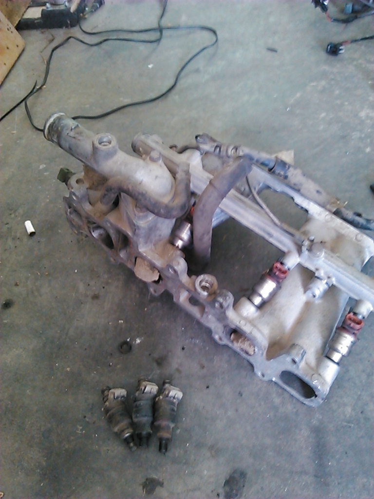

I have two good injectors and a friend of mine had a set to get mine running. I am having some electricians to wire my shop up and want to get the 85 movable to get it out of the way. Getting injectors and the seal kit took some more time.

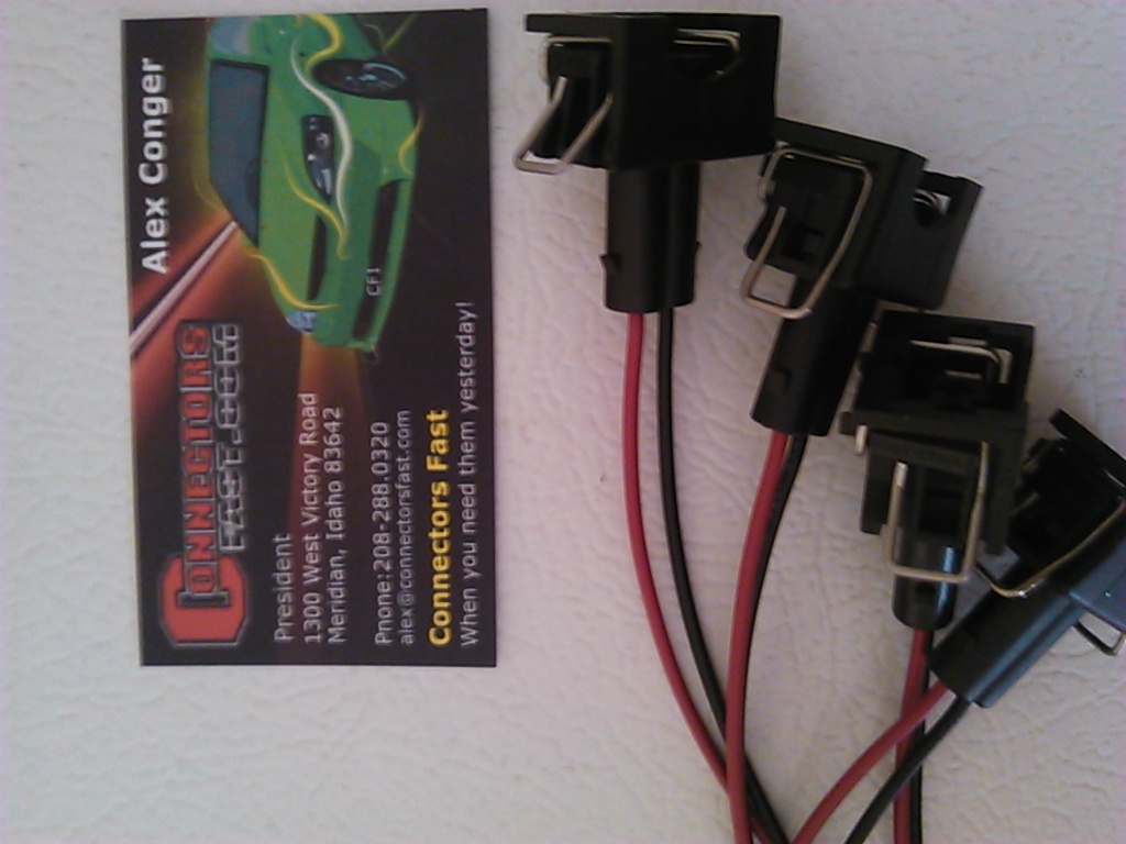

Here is my new connectors. I get them from connectorfast.com Alex Conger is the owner and is a great guy to deal with. Not sure why picture is sideways and will correct that later.
Dirtdobbers made a home in the intake system I got from a friend. Its fuel rail needed cleaned as well but I just have the injectors in for storage and keep them protected. It is 88 injectors with an 85/86 thermostat housing. I am hoping the distributor goes a littel quicker then what everything else has been for today. Was a little disappointed as what I call "Lunch Break Fixes" that you can do on lunch break will save you a ton of time when you get to your project. I will get it the next time,lol

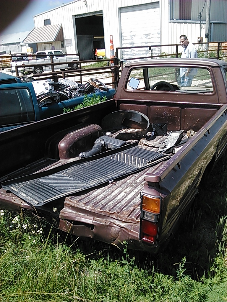

I seen this '57 or so Ford today on the way to the bone yard. You could tell he cleared over the patina. I am hoping that fad goes away some day as well as the big exhaust pipes out the bed of diesel pickups. But I am glad he has it on the road. Like seeing the oldies out there.

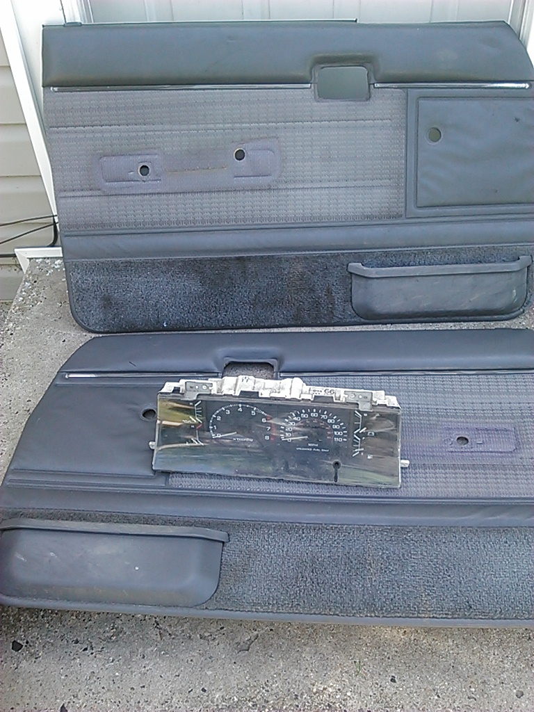

Got me some SR5 Door panels and another SR5 Guage. Got to get while the getting is good. May not be there the next time.

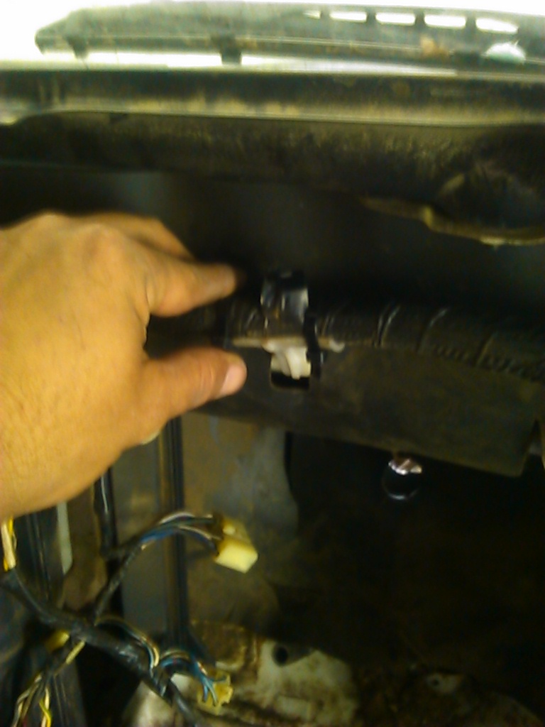

I did get the harness in. I suggest starting at the rear and run the harness to the cab to make sure you get it routed right and easier. Especially if you still have the tank in. Now I can start getting the tank in and let it run longer then just a few seconds. Yesterday it was only running on starting fluid.

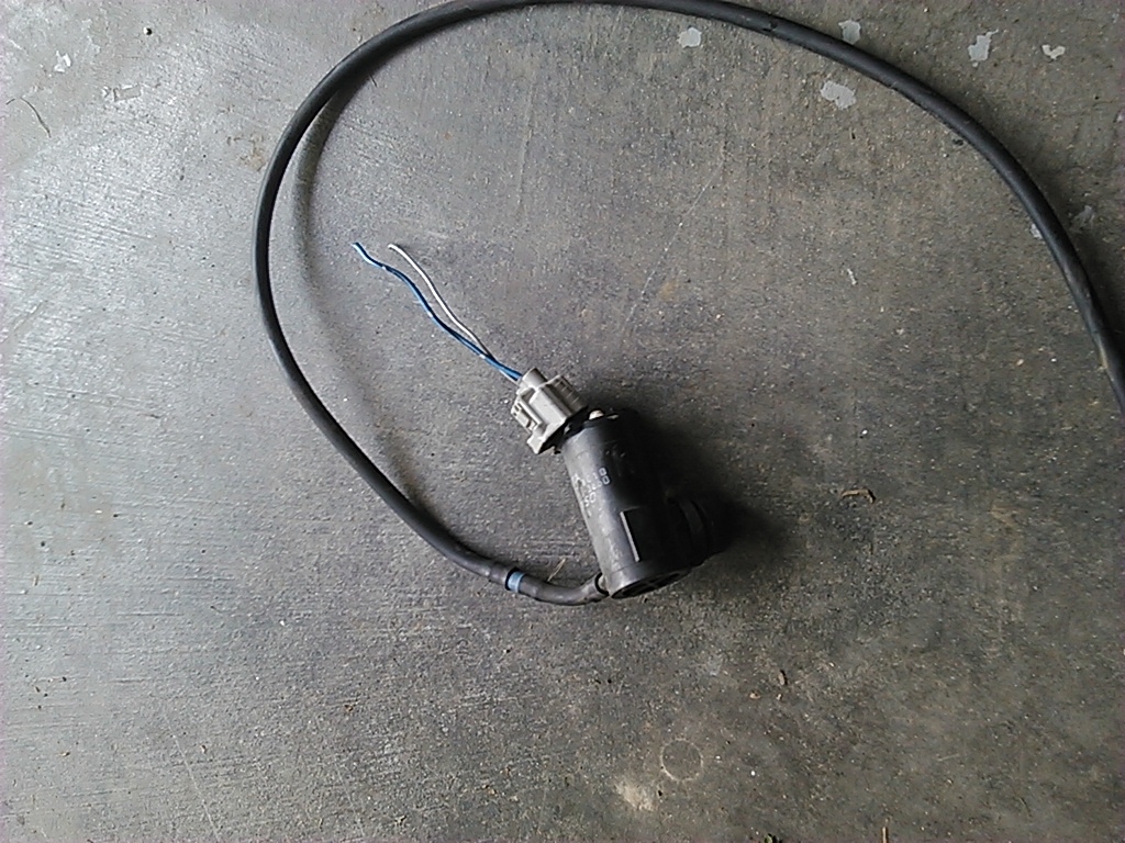

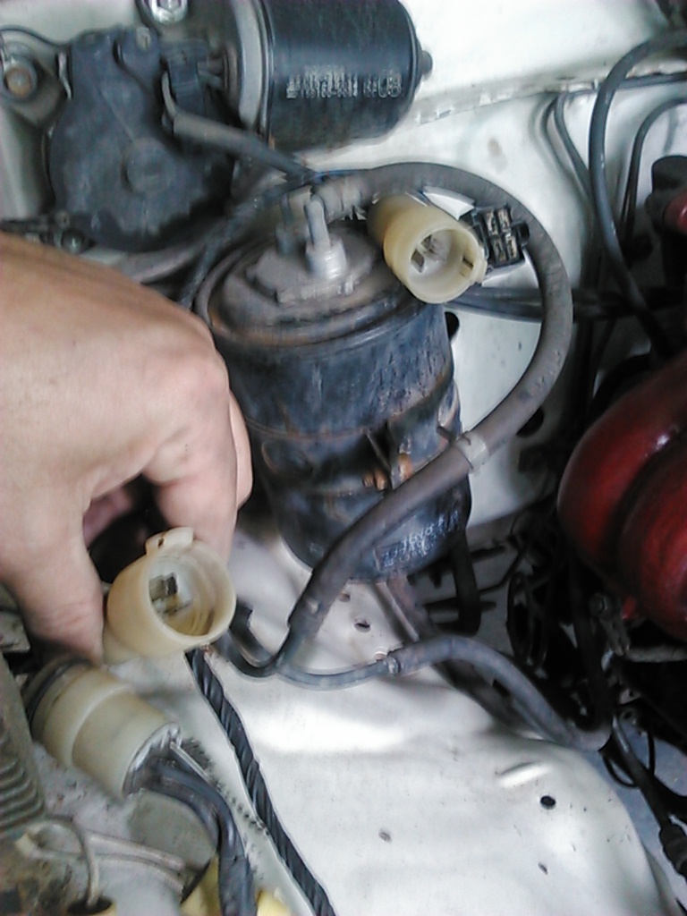

I have had this plug laying on my work bench for quite some time. More then once I have considered throwing it away. I am so glad that I didnt. My O2 sensor is missing and this little bit of harness had it. It is all wired up with shrink wrap on it. Just need to solder it and finish it up. A couple of small steps in getting the truck back together. I will be pulling the bed back off soon and will start body work in it and getting the gas tank back in.
So glad I kept this harness, Whew!!!

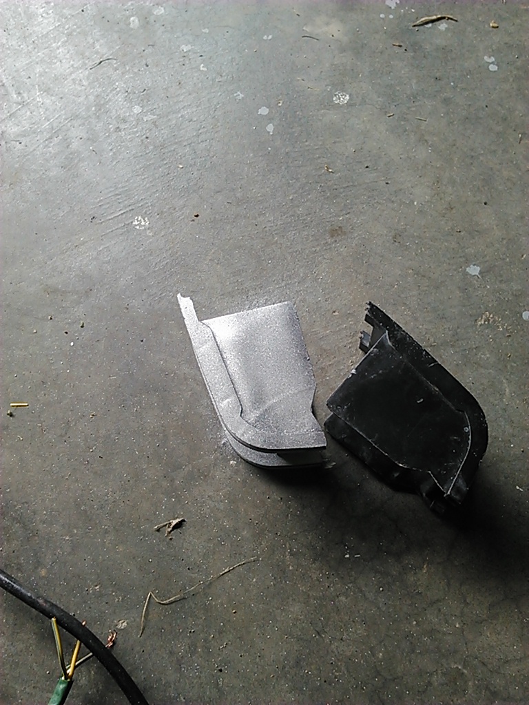

I wanted to get a few things done. I painted my tail light seperators silver for a cheap upgrade that I found on 4Crawlers site.

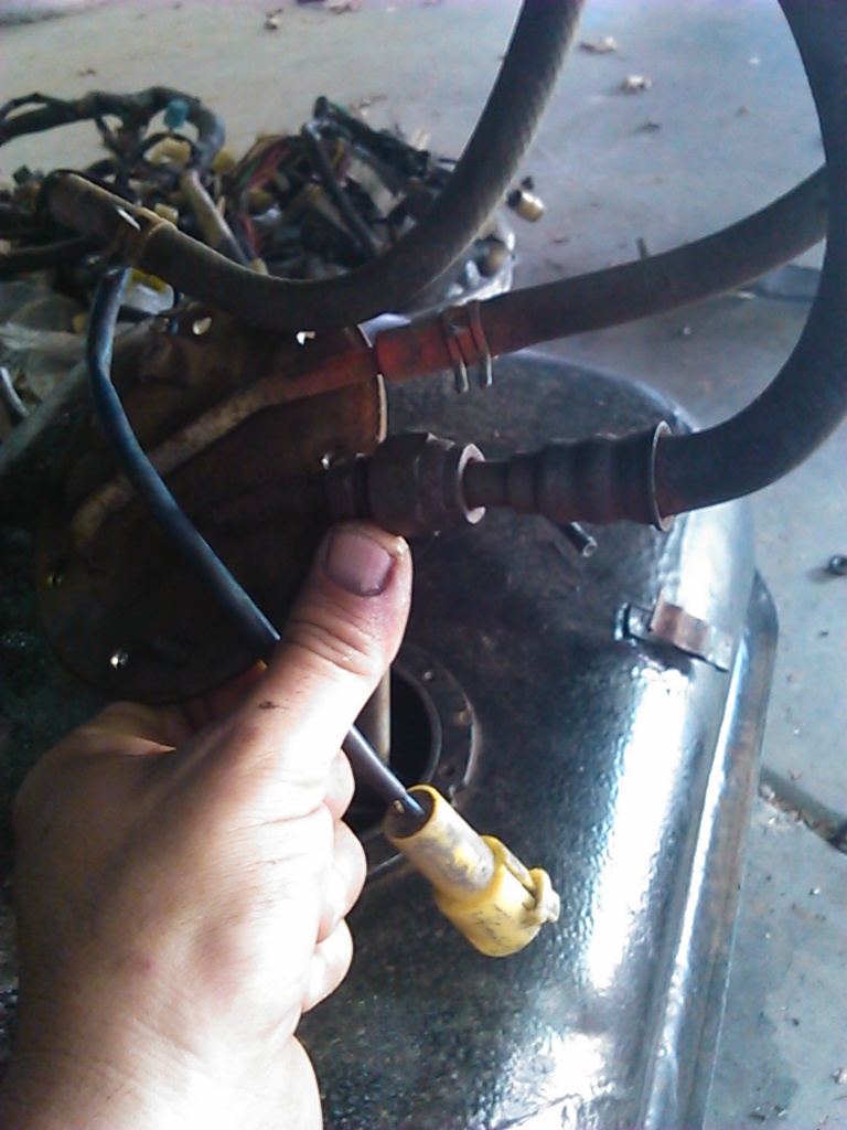

I got the fuel tank mounted but I dont have the fuel assembly in. Neiieer one of them will work. Actually some of the cleanest ones I have seen but the wires are just worn out that gives the readings.
While putting the tank in, I could not get the fuel assembly to seperate. These are to expensive and to hard to find to risk breaking. I will be taking the bed off later on and will try to get them to seperate.

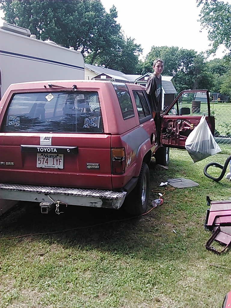

Was at the boneyard today and they had this excellent 79 two wheel drive bed, rust free, and with minor damage that is showing in picture.

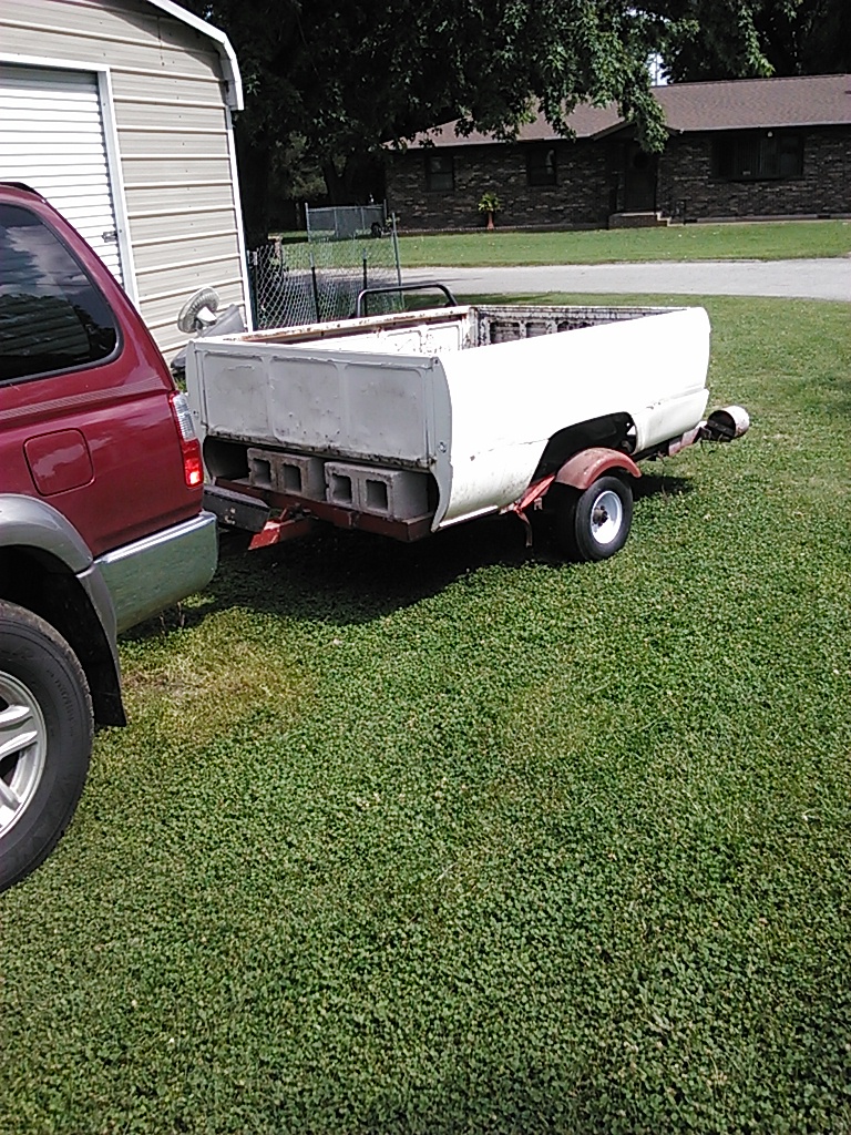

Been repairing some wires on the truck and pulled the bed to start working on the rear of the frame and start on bodywork on the bed.
