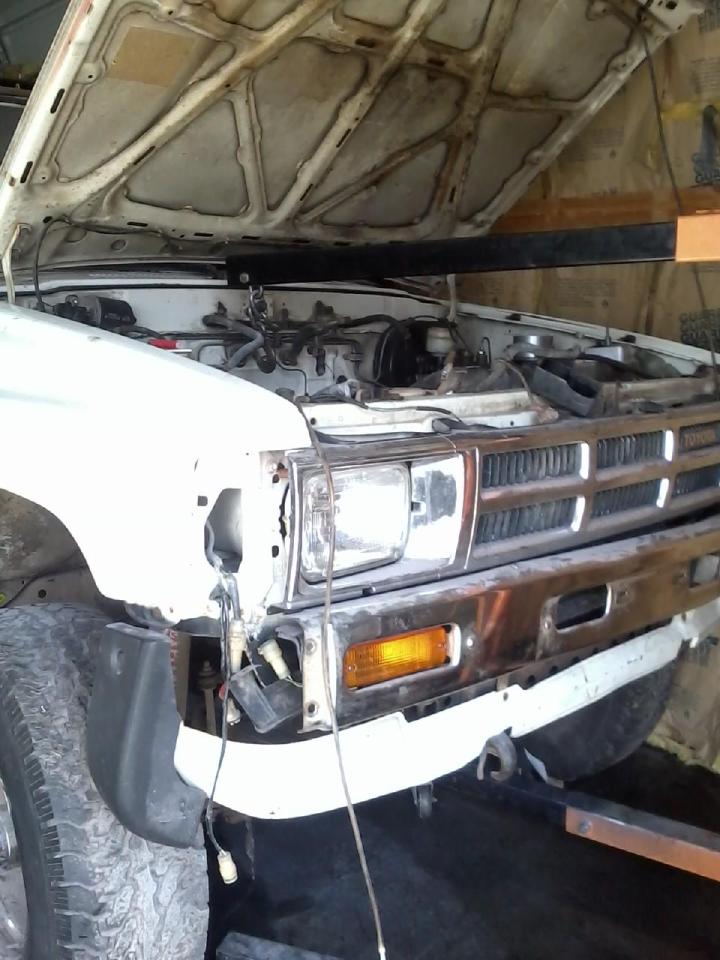

Been busy, but wanted to show some progress. I got my lights in. Nothing major, but with the weather and everything I have been having to take care of lately, it is better then nothing.
Another thing that got alot of time from me and is a side project is my shop. My company was tearing down a building and the employees were allowed to have the materials off of it as it was getting bulldozed. I got the insulation, light, electric wire, and some wood pieces. My shop is bare bones. I am using extention cords for lights and no insultation is rough in the cold and heat.
I had enough insulation to do the south wall and could tell the difference on the heat that was coming thru.The side of the 85 sits on is insulated and I still need to cover it with plywood, but it is a start. Cleaned the shop as well. The 85 side is beautifully clean, the other side is a disaster, but will clean up quick. Had to move everything over to that side to insulate.
I tore down the motor I was going to use. Number one cylinder has a big gouge in it from an apparent broken ring. I have another short block to try so it if is a bust, I will be on the hunt for another motor. Pics didnt turn out of the cylinder but dont think boring would even fix it.
Some progress with lights and insulation.

Front blinkers and insulation. Fiberglass makes me itch looking at it but looking forward to getting it put on.

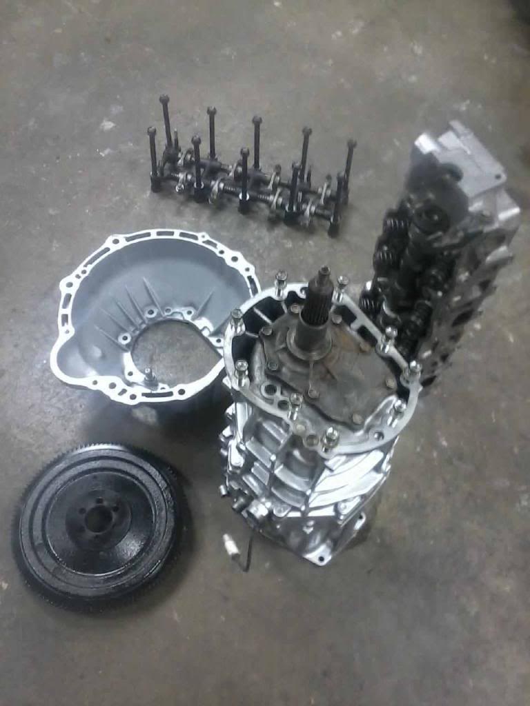

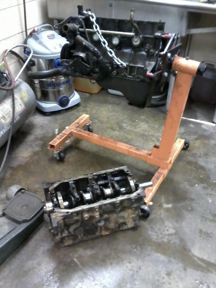

I got another tranny and the one I have for the 85 I dont know if it is good so I am cleaning both of them. This is the third block I have tore down. The first one is able to be bored, but the second one is not. I am hoping this one is good. So far it looks good, but I couldnt see the damage til I got the pistons out.
Also cleaning the tranny and get the head cleaned up. This head was just in the shop and when it was put on the motor, I think the compression took it toll on the rings. Still want it clean and will double check everything. Today is the last day of the old Photobucket so I will have to figure that out as well.
Bad block #2 on the floor and block #3 on the stand. Atleast now I know the conditions of them and get two out of the shed.
Hoping to make some great progress this week but it get cold again Thursday. I am ready for spring!!!

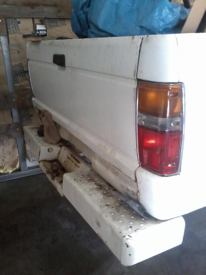

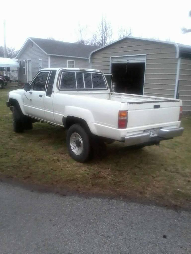

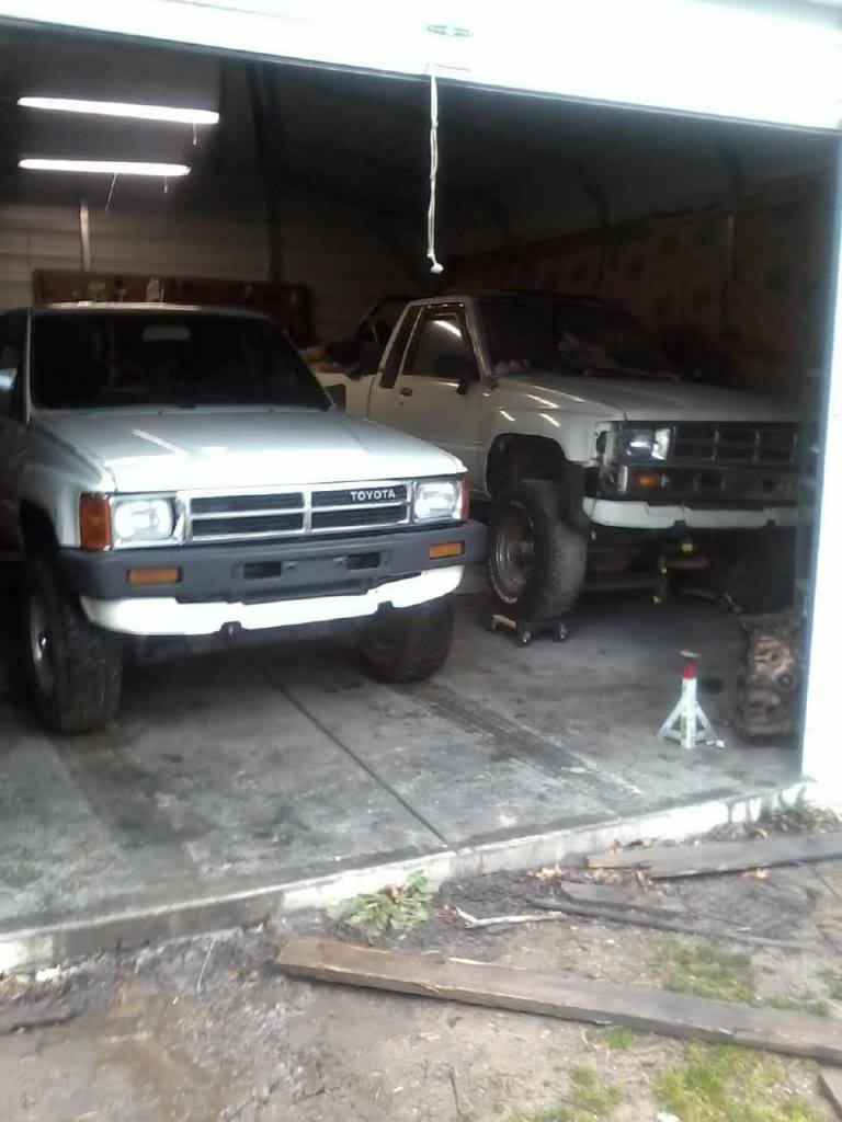

I will be tackling another project later this week when the weather warms up. A friend of mine came across this 86 Extra Cab 22r truck. I really think this truck drives and rides about as good as it did the day it was bought from the car lot. It is one sweet little truck that just needs some small work on it. I will be knocking out the dents that it does have and painting it. The frame is loaded with dirt and will need to get cleaned out and I will be doing the SR5 guage swap, setting the valves, fixing the backglass, replacing the front bumper with a new chrome bumper, and taking 3 rear bumpers and making one good one out of the three. The rear bumper on this truck is actually one hard bumper to find and is no longer available from Toyota. He wants it to be as nice as I can possibly make it and close to orginal as possible. I got to drive this little truck and it gives me the possiblities of what my 85 can be like.
86 Extra Cab
Rear Bumper needs work. I am hoping to have this truck done in a month.

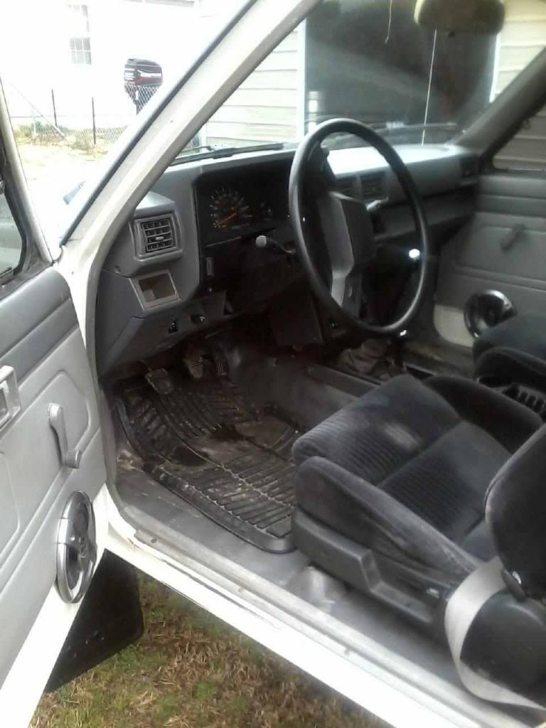

Interior

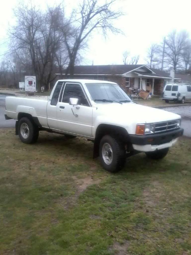

Little brother (86) sitting nexts to big brother (85).

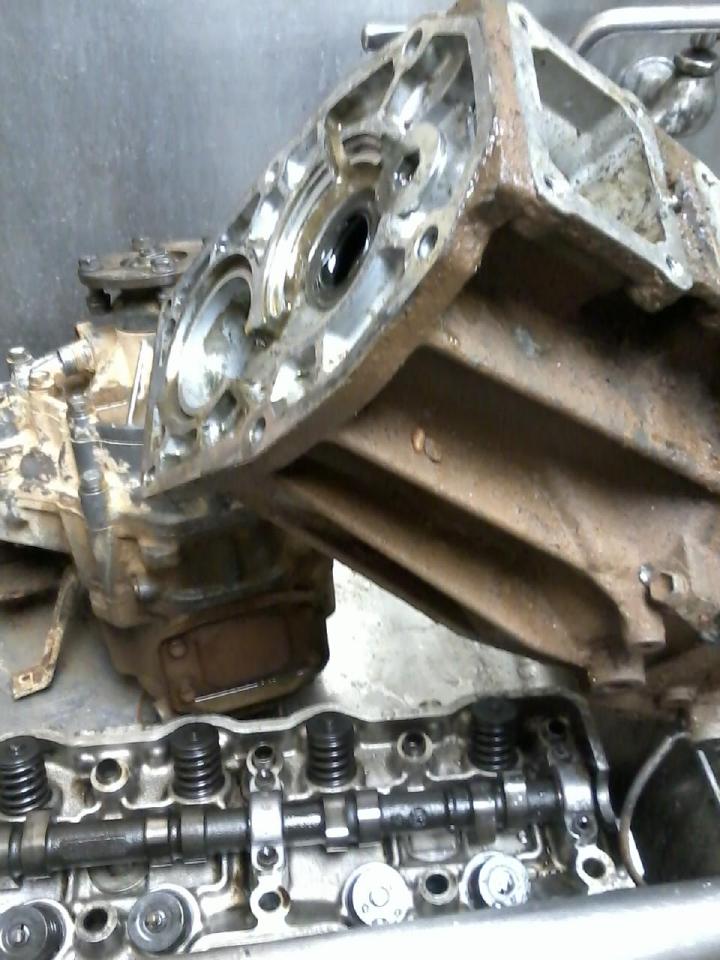

I have made some progress on the 85 as well. I have been getting other parts cleaned up. Trying to get everything together and just down to where all I need to do is the motor. Hope to start tearing down motor number three later this week. Hoping to start making some quick progress just as soon as the weather clears and warms up.

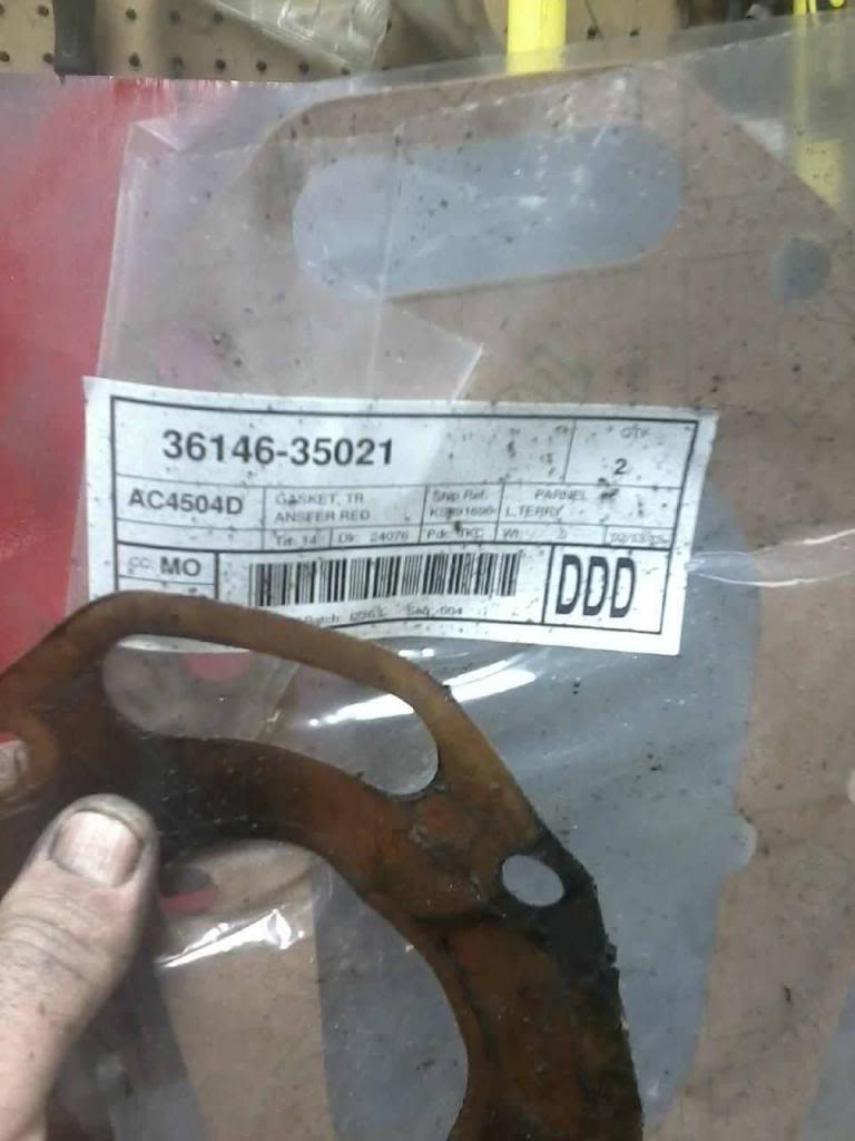

When I am at the dealer and order parts and they are cheap enough, I try to get extra parts as well. If I recall right, this gasket cost $2.10. It is for a W56, and goes inbetween a tranny and tcase. Best as I can tell it will work on a G52. Even tho it looks like paper and might be tempting to use silicone, I would suggest using this gasket. When it gets soaked with oil, it has a different feel and texture to it, almost like a screen to it. I will be getting the front seal and gasket for the front of the tranny as well.

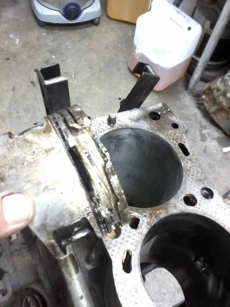

Block number three is a bust as well. It could be bored and saved, but after all of the cost of machine work and everything else involved, I will check into buying a rebuilt motor and the cost of rebuilding this one and see which way I will come out ahead.
Looking at the motor, I had I hopes. When I pulled the pan off, I found a piece of piston ring laying in the bottom. It didnt show until I got the piston out and I could see where it scratched the walls. Not so deep that it cant be bored, but still that will add the cost of new pistons and the work involved in that. So I am going to be debating on which route to take. At least now I know the conditon of these blocks and have plenty of spare engine parts. Heck yeah, I got plenty of pistons,crankshafts,timing covers,...lol..
Number one piston. Dont know how this happens. I have never blown a motor or thrown rods or any of that stuff. Never did understand how all that happens without serious abuse.
