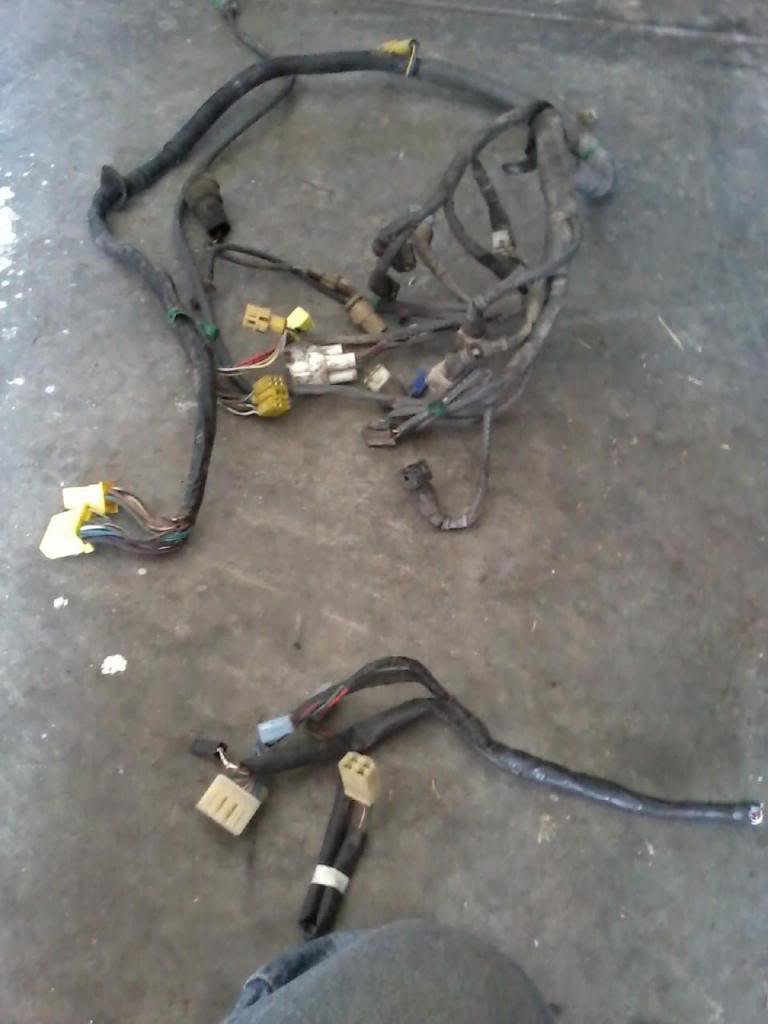

I went to the bone yard and they have an 86 camper in there. I got one of the wiring harnesses that was going to be a big hold up on this build. Also got to talk to Driedel and he has come across one and am planning on doing some part swapping and get that one as well. It is either none or a hundred. Just glad I got one. Jason in tn has one for me as well, but suggested he see if it will fix his runner.
The fuel injector harness is one that runs thru the firewall on the passenger side and is fairly easily removed. I have swapped a couple of harnesses and always get confused on which connects where when someone has asked me so am just making a note for myself to refer to.
Also got the harness to hook up my radio, lighter, and clock.
Fuel injector harness has TPS,CSI,CSI Time Switch,Thermos Switch, Starter connector (brown connector), and the ones that run to tranny area.

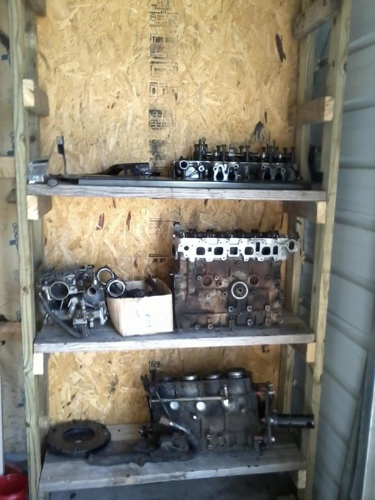

Seems like no matter how fast or hard I try, I am not making much progress. But working on the 86 Extra cab, my 85 extra cab, chasing parts and working on the shop, I do feel like I am making some progress.
A friend of mine did some part swapping and I got a tailgate for a runner that was involved in a roll over and it had several parts I have been needing. I also got a great block from him with pistons. I have the rest of the other parts that I need to get it back together. So this will be a full blown rebuild of the motor. That is going to take a little time as I need to get the funds up for the machine work. Yeah!! the money thing. It is always the hold up.grrr..
New Block in the middle shelf and the parts block on the lower shelf of my awesome wood working skills. When it comes to wood working, I do have to turn in my man card as carpentry is not my strongest point. But I have been getting alot of the wood for free as a friend of mines barn got torn down by a storm and it is just a matter of me and going and getting the materials. Still got some more to do to the shop, but getting sheets of plywood cuts into my build funds, then I have to get everything reorganized when I get a section completed.

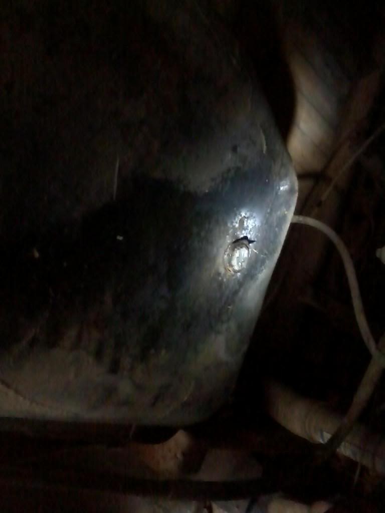

Today it is 34 degrees and I wanted to get something done. That lasted for a whole hour before I froze out and came inside the house. I have tried to mention on my Runner builds about how bad the tanks can get on these trucks and I want to pull the tank on this truck just to see what kind of condition it is like.
I suggest pulling the bed off of a pick up to replace the fuel pump. It can be dropped down, but there isnt a whole lot of line and is hard to disconnect the fuel line while dropping it straight down. On a runner you have an access hole under the passenger rear seat. Since I am doing a frame off on this truck, the tank needs to come out any ways.
No surprise, some one has already pulled the tank and caused a fix that I need to go and deal with. They used a wrong bolt and put some kind of putty to keep it from leaking at the drain plug.

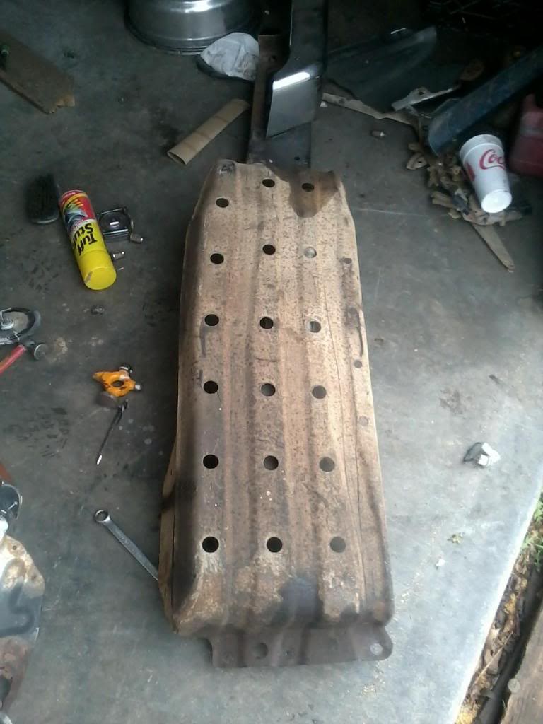

Here is the skid pan that protects the fuel tank. 6 bolts hold it on. I already soaked them with the Aerokroil and all came out without any problems. All were rusted and I have in the past broken these bolts off. So far it seems to work great. You can see with the clutter, I was cleaning up the 3rd gen runners carpet from this past winter, doing some more shelves in the shop and pulling the bumper off of the 86 Extra cab I am doing for a friend. I am planning on taking a few days off of work soon as the weather gets nice to get some of the projects completed.

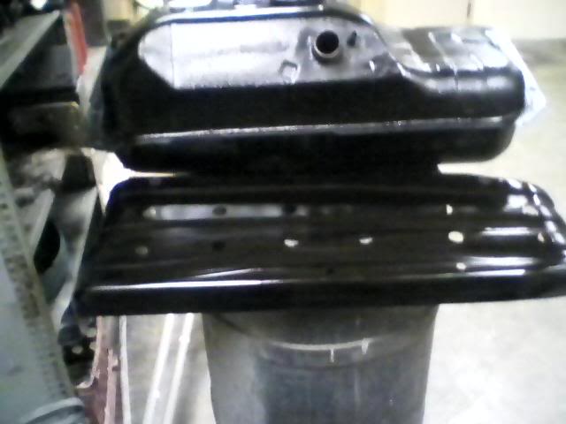

Here is some info from my 88Runner build that I have found/used in the past.
Copied....

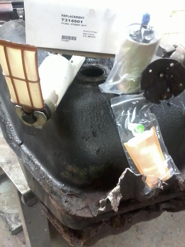

I got a tank out of my parts truck and it was loaded with rust and so was the pump. I surprised the truck even ran. Filter was all plugged up. I spent quite a bit of time cleaning the tank out. First I drained it and tapped the outside with a rubber hammer to break the thick rust loose. Put a little water in to avoid sparks and put some chain and rocked it back and forth to get more loose and then I let it soak with some vinegar in it. I found this on the web. It actually came pretty clean. Have heard of using The Works toilet bowl cleaner from K Mart.
http://www.mopedarmy.com/wiki/Removi...rom_a_gas_tank Several products you can use.
http://www.ehow.com/how_4540637_remo...-gas-tank.html
http://www.vjmog.com/ftopict-3687.html

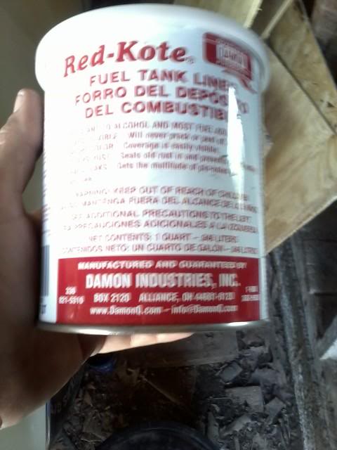

I have a friend that works in a parts store and he suggested Red Kote to coat the tank. I have coated it and am waiting for my new fuel pump to come in. I ready to get the tank in and see if this thing fires up.
I dont mess with tanks in the summer. The fumes are what are dangerous.
I bought the fuel pump off of ebay from "carpartswholesale" for $27.85 plus cheap shipping. Parts store wanted $150

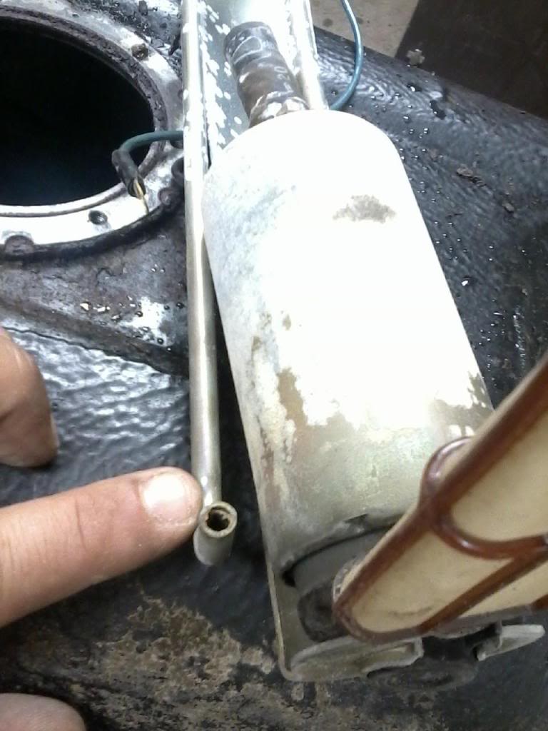

This "J" line likes to get clogged. Check all of them, but most likely this one will be clogged.
