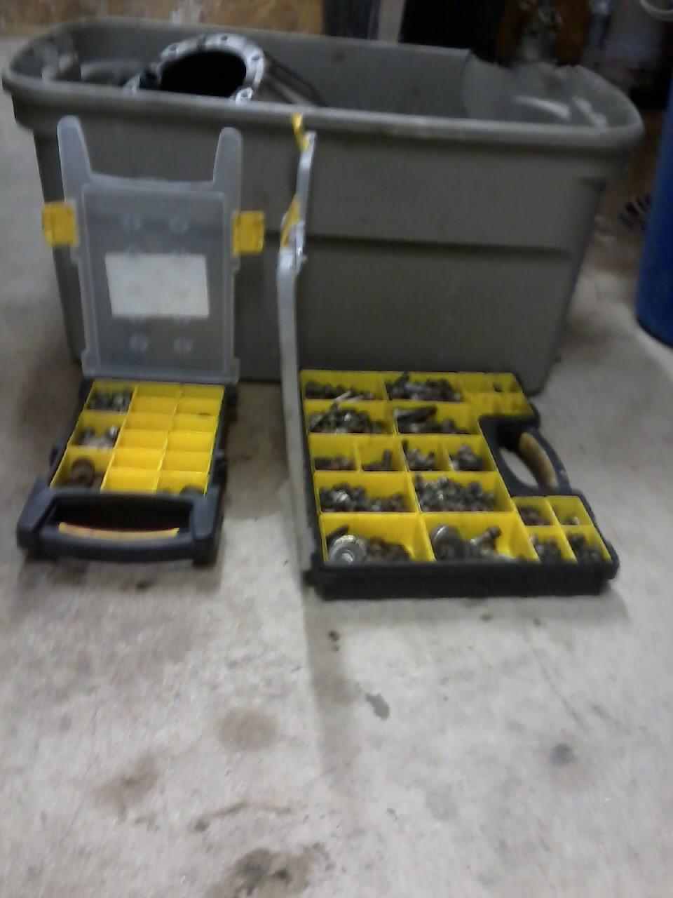

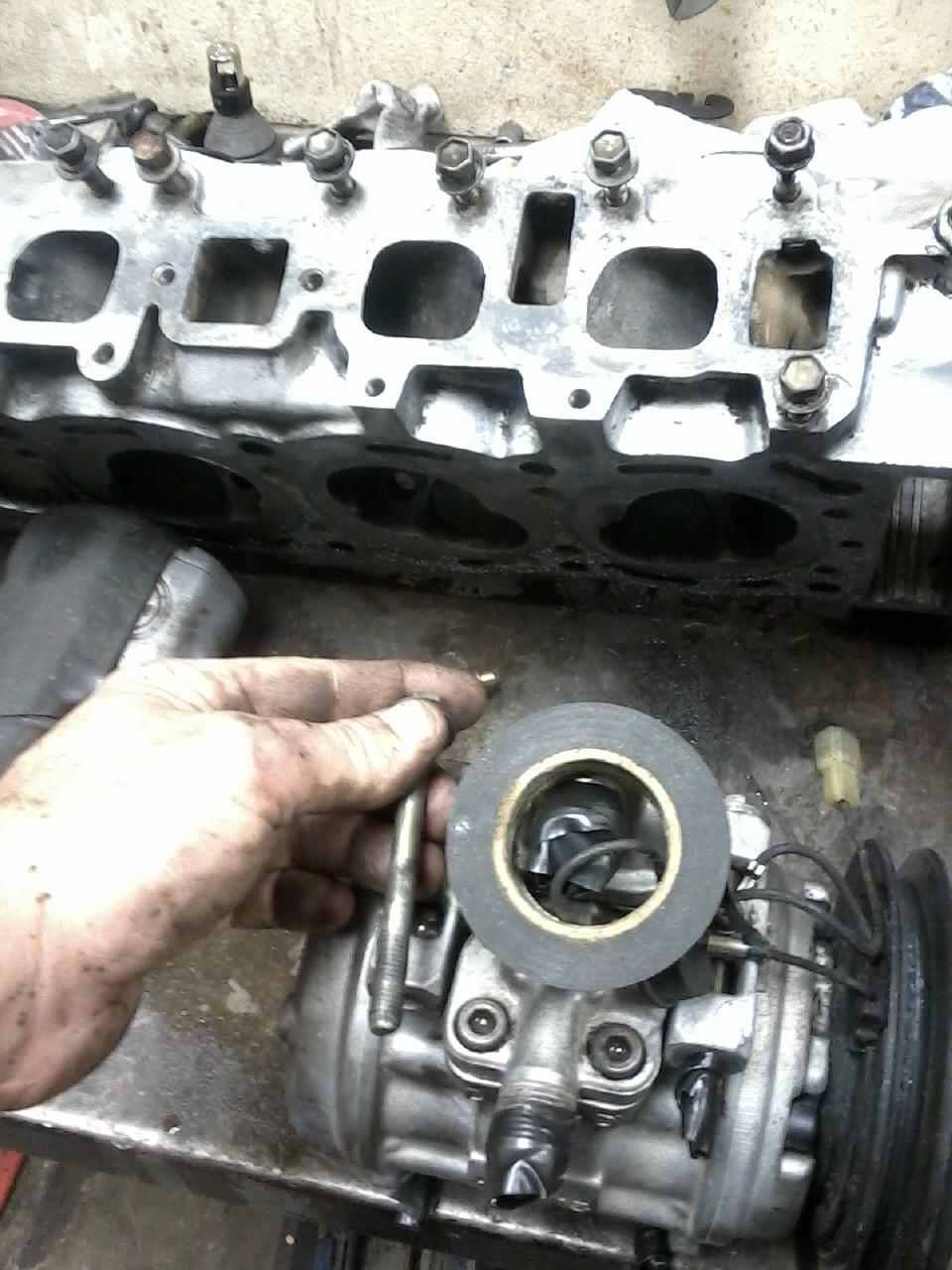

Another part I worked on was the air conditioner pump. Just getting all of the gunk off of it was a job in itself. I wrap the openings with electric tape for cleaning and then storing. It will be awhile before I get the AC but since it will I wrapped the threads of the bolts with electric tape to keep them from getting lost.
I watched alot of car shows and they show them tagging and bagging every nut and bolt. The first time I did that while working on a Chevy truck, I thought it was a really good idea. Figured if the pros did that way, it had to be good. It wasnt. When I went to put it all back together, I had so many bolts that were similar that it took along time to get it all figured out. Wont do it that way again.
Since this truck is my third parts truck restore I have learned some tricks that make it so much easier and thought I would pass them on along. I still have to tag and bag some nuts and bolts but not nearly as many as I used to. Unless the part is going to the machine shop, I put the bolts right back in their place. When at machine shop I sometimes do have to bag them.
Also I keep the engine all in one piece on an engine stand. Keep the old spark plugs in to keep cylinders dry. The PO on the motor I was going to use pulled them and now this block will need to be bored. I am just going to post it on Craigslist.
If you do tear a motor down, you will be surprised at what all you can keep in tote bins. I can keep a block with out the head on it and the tote bins are strong enough to pick up if you get a good quality one. If it is going to be stored for a long time, I coat the cylinder with wheel bearing grease, and spray everything down with WD40.
The head will fit into another tote bin with the fuel assembly. This also keeps nuts and bolts from getting lost. Then I use another tote bin for the accessories and what ever else I want to keep seperate. This also works for alot of interior parts or other projects.
When I am at the boneyard, I get all the nuts and bolts I can find. Alot of people will remove a part and leave them nearby. I have several coffee cans full of nuts and bolts that I need to put into storage bins. I have seperate bins for interior, engine, body bolts and such. Cant have enough and you still need one that you wont have but it makes doing these projects so much easier.
Head getting ready for storage. I will coat it with WD40. Have the intake bolts in. AC Commpressor with bolts taped and hose connections taped up.

Storage bin for whatever assembly I am working on and my Harbor Freight storge bins for bolts. The big one can get heavy for the common bolts. The smaller ones work great for specialty bolts like crank shaft, intake bolt that is an allen head, exterior parts...

This system works great even for normal repairs. When putting everything back together, there are no more lost bolts and makes it alot quicker to reassemble as you just drag up the next part bin you need and start installing it. Just something I learned and hope it helps someone who might want to try a complete tear down or everyday repair. They can be stored in the bed or stacked in a corner with some good planning. I have seen some projects not get completed cause someone get lost on where they were at on a project.

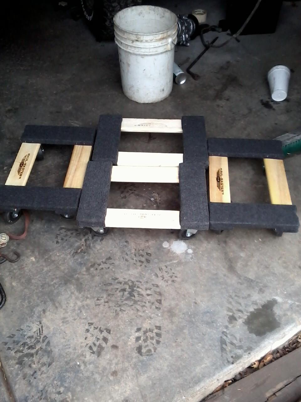

Got tired of the truck taking up some wasted space and to make it a little easier to get to from all different sides, I finally broke down and bought 4 dollies. It is still cold outside but I might get ambitious enough to go get the truck put on top of them. Wont be doing much else today due to the weather. So will be scanning different sites for some deals.
A guy parted out a Turbo runner that was wrecked and wants to get rid of what he has left of it. Has a whole box for $35 that if our schedules work out I will be going to get those parts off of him tomorrow.
Dollies, been wanting a set for awhile and was out in the shop yesterday and couldnt get to the other side and swore I would get some next time I was at HF.

if youve got a smooth concrete floor those dollys can be a blessing ours is 50 yr old farmer concrete spalled an rough as dirt lol ive found in breaking out a useless bit of sidewalk old cans horse shoes an even a 1940's coke bottle

I got a laugh out of the old side walk. I use to help a farmer and when it came to pouring concrete, what ever was in the trash can was what he used for filler. That 40s coke bottle might be worth something. When my brother,sister and me were kids we had A&W Root Beer Mugs. Still have mine somewhere and I went for years not liking root beer and now I am on a root beer kick. Just bought a bottle not even 30 minutes ago. Got my kids a set of A&W Mugs a few weeks ago and now I want to start collecting A&W items.

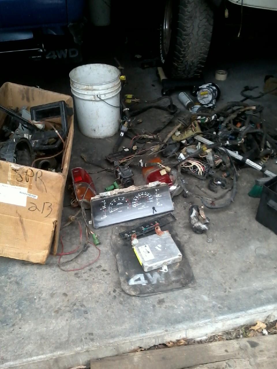

It was to cold to do anything today and I knew where a bargain was on parts so went after it. These parts came off of an 86 Turbo pickup and it has some parts that I need. Didnt have the injector harness but it had alot of other parts.
The guy cut the main harness but other wise it looks all there. I will splice it back together and keep it as Im sure a turbo harness is next to impossible to find. It did come with electric locks, just dont know if it will plug into my harness. If it does I might just add them to have something different. I got an electric antenna and hoping that I can get it to working. A ton of other things that I havent looked at yet.

Hey you got the turbo ECU and those are rare...

Hello aviator..The cluster says Turbo on it as well. Just to bad it isnt the digital guage. I told the guy I was buying it from that alot of the parts was worth quite a bit. He sold everything to me for $35. I think his wife was giving him some " words of encouragement" to get rid of some of his hobbies. He has 3 Toyota trucks and 2 of them are really nice little trucks. Then he has several Ford diesel trucks in various stages. He even said he had to many irons in the fire.

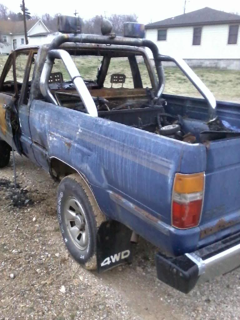

Hello Cyberhorn.. I know where a turbo truck is, what is left of it. A neighbor of mine that I go to church with has/had one of the most fully loaded SR5 Turbo extra cabs I have ever seen. He has helped me quite a bit in the past so I will give him a big jump in his project.
I tried to get a hold of this truck for sometime when it was broken but the he got the engine, turbo, and tranny rebuilt. He bought it new and really loves the little truck. Then one day the drivers electric window switch area caught fire and nearly burnt down his garage. He is determined to get it back on the road and has the funds to do it but finding the parts has been his biggest hold up. He has asked me several times about my extra cab for his truck. I will just let him have the guage,harness and ECU.
I always thought that I wanted a Turbo truck, but a friend of mine took a wrecked Turbo and put it in an 84 Extra cab truck. He is starting to get frustrated with the turbo and he knows alot more about Toyotas then I do so that has taken the excitement out of a turbo for me.
Was fully one fully loaded truck. I know where a couple of extra cabs are so this one might see the road again as he is determined to get it going again.

damn shame to see a truck and a rare one at that all burnt up you are the picture of generosity terry

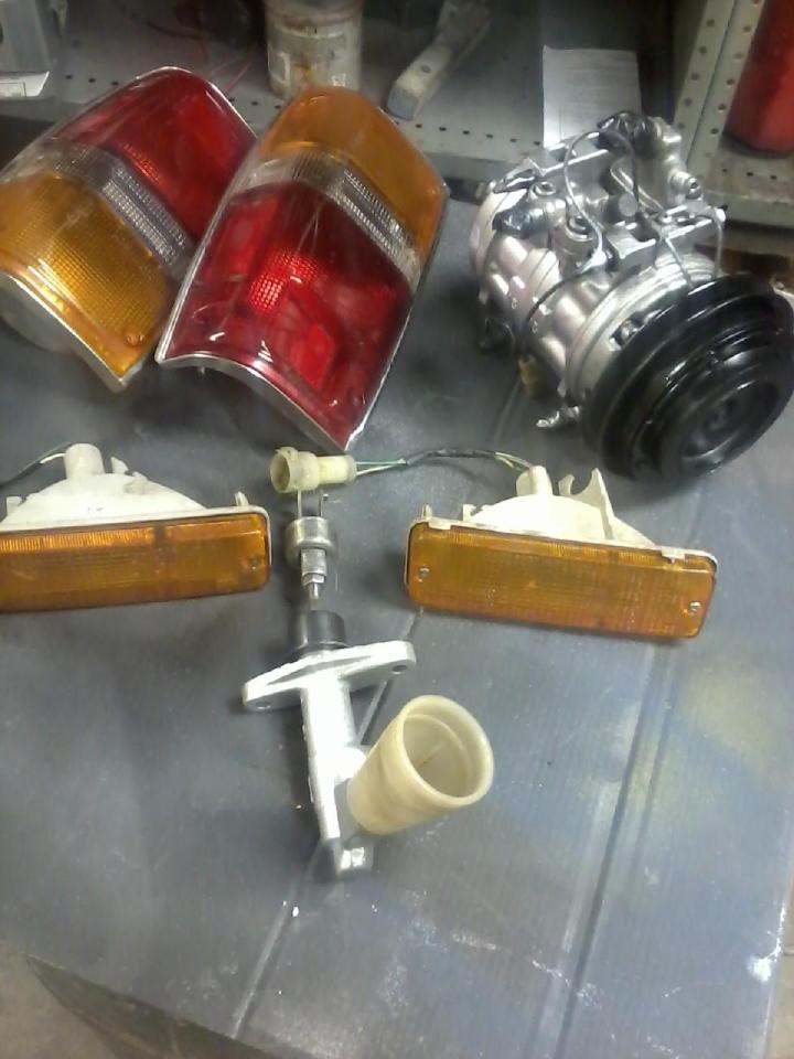

Got a my lights all ready to install. Should be a nice weekend and the weather is starting to warm up so might get out and get them installed. I cleaned the contacts, bulbs, and sockets and have all the electrical connections coated with dielectric grease.
Clear coated lenses and working on AC Pump. Clutch Master Cylinder seems to be good and wanting a clean look under the hood.
