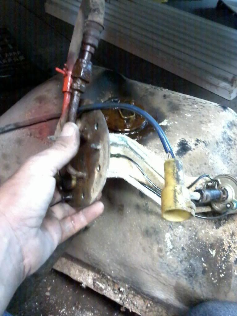

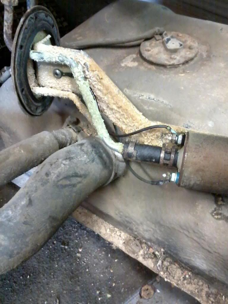

I finally got the fuel tank out, Wahoo!! The tank itself is better shape then most I have worked with. The pick up assembly is still attached to the truck. It is being difficult to get off, so I have it soaking trying to get it to free up.
I have the bed up on block on the truck as I want to pull it, but I still have to paint the 86 extra cab I am working on and it is what I use to put the bed of trucks on to paint so the 85 bed is going to have to wait before I can take it off completely.
The tank on the left is for the 85. Last week or fairly recently, some one was asking about using a truck tank on a 4Runner or vise versa, dont remember which. I told them that they are not interchangeable. The fill neck and vent neck is oppisite on each other between a truck and 4Runner.
On trucks it seems like they have a bigger problem of getting mud on top of the tank and just start rusting. I have seen rust holes, the size of a quarter in the top of these tanks. One reason I spend alot of time cleaning under my trucks as it nearly impossible for the dirt to get out between the tank and frame.
Also the tank on the left is for a fuel injected truck.Bigger opening to allow for the fuel pump to fit in. The tank on the right is carbed and it may not show in picture is but is smaller. This tank came off of a 2wd truck.
This is typical and I have seen alot worse with rust. I try to show in all of my build threads at how bad these tanks can get. Alot of times the fuel lines are clogged as well, mostly the return lines.

A big problem with the pickup assembly is the 14mm nut that attaches to the 19mm hose fitting is stubborn to come off. This can easily twist the metal pipe. Some of these pipes rust up bad and can break. This is a hard part to find and when found is expensive. Seems like around $150 on ebay. Dont get in no hurry trying seperate these two pieces. If I have to, I will clean it on the truck instead of taking the chance of breaking it assembly. The metal line is the supply side and is high pressure. Also the oprange is just a quick reference for me to remeber which line goes where. I will mark them better at a later time.

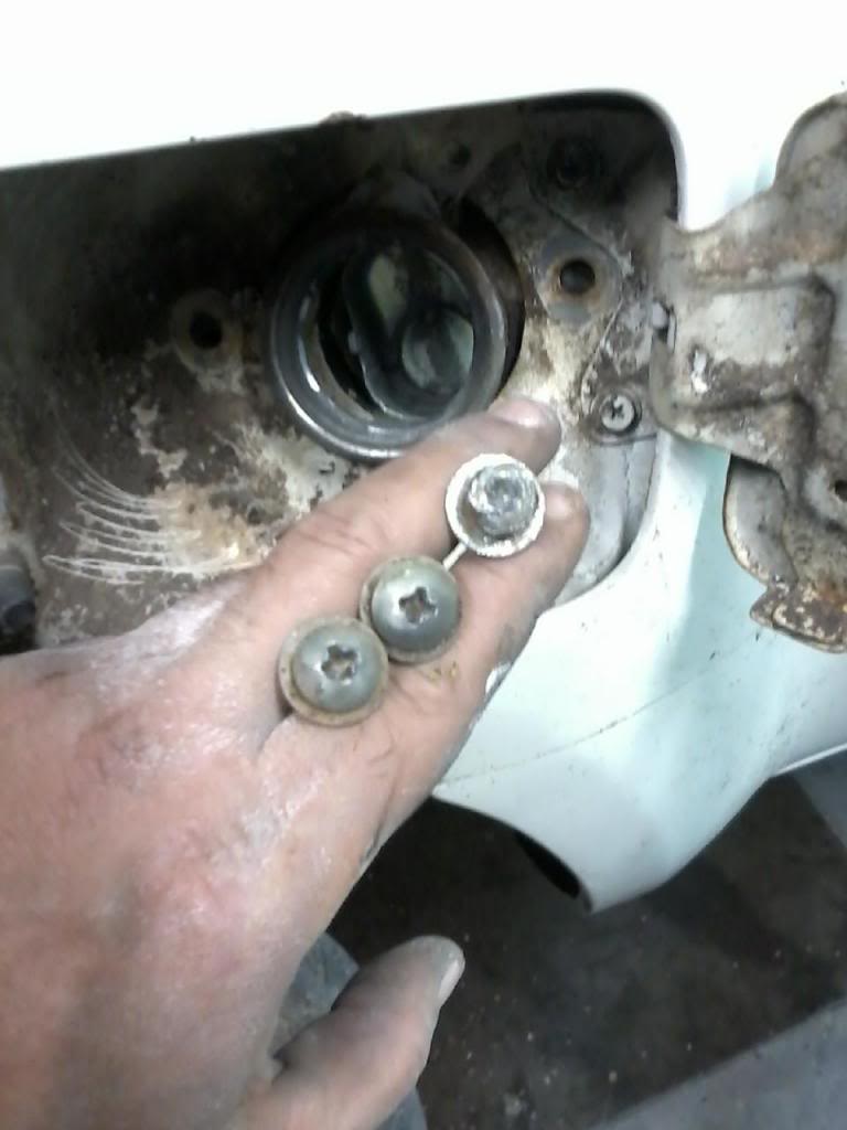

Getting this one screw out took along time. I have been working with it for some time. A while back when I got all of the bed bolts off, I was trying to lift the bed and it was being difficult. My youngest son would of said I earned my Der patch if he had been out there. I forgot about the fuel flll pipe. Doh!!!
Two came out easy, one took forever.

now see terry that tank on the left is whats in my 79 an due to the 1 1/2 body lift under her i was able to navigate the thing out to replace it witout taking the tank totally out
the pickup assembly would do great in the electrolysis tank it'd literally have the corrosiuon falling off fast you'd have to paint it with some kind of fuel resistant paint but its come very clean

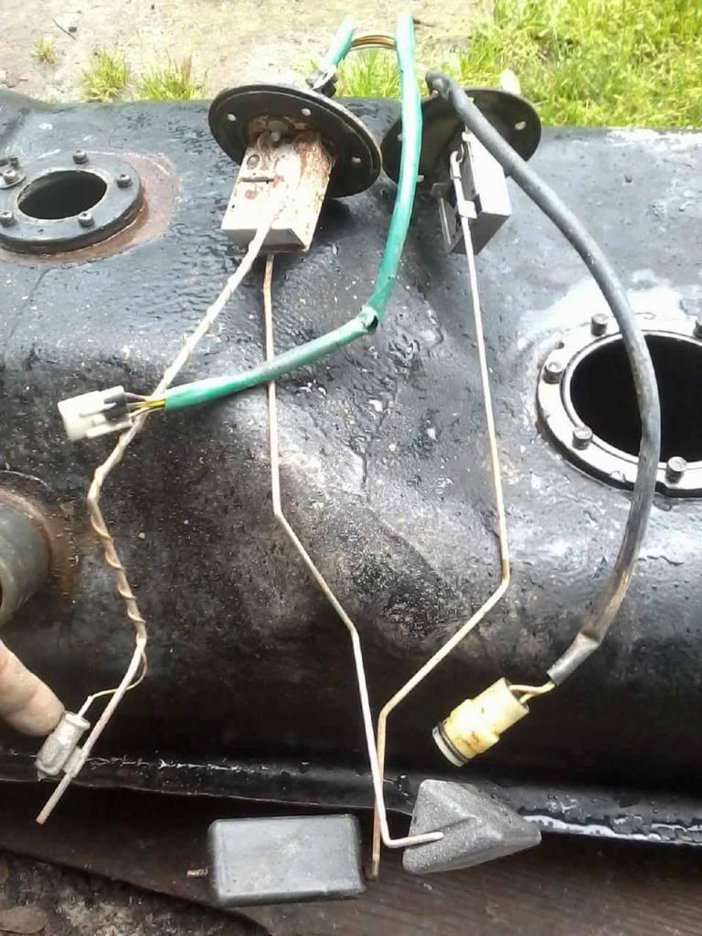

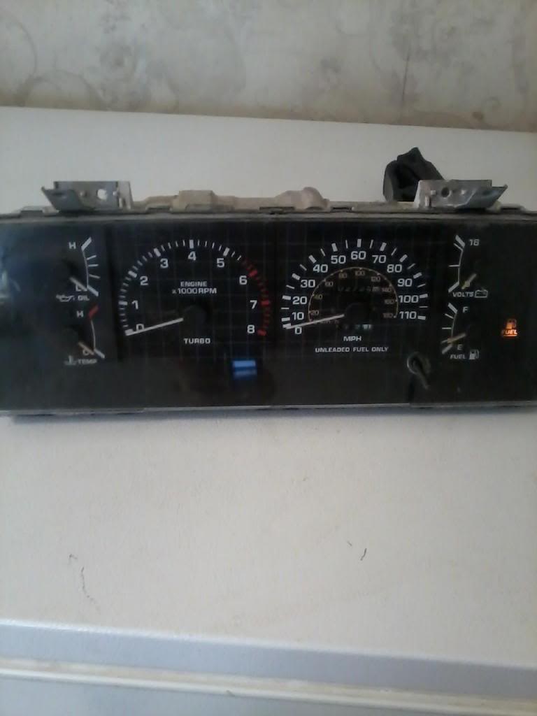

Here is what my tank looks like. This is actually one of the cleanest tanks I have worked with. I have seen alot worse. Sometime it looks like 1/4th inch build up in the bottom in the worse one I have seen. White vinegar will clean it up in a few days. I just slosh it around when I am near it to stir it up. After four hours, it had some large flakes floating around and eventually thosee flakes will dissolve.
I wanted to show the difference between the fuel guages that have the Low Fuel Light Option if I recall everything right. Been awhile since I have messed with the Low Light and it was on my 86 Runner. If I recall right, the trucks are prewired with on the harness but your cluster and tank float has to have the 3rd wire and to show what the 3rd wire operates is where my finger is at.
Seems as I recall the 85s use round plugs and the 86 and newer use the flat plug. My 86 runner fuel gusge doesnt work and I plugged the flat connector into the harness with out dropping the tank to see if it was the guage or the float. It is the float in my 86s tank. I just need to get off of my rear end and drop the tank to change the float on the runner. One of these days it is going to bite me in the butt as I thought I had filled it up and hadnt realized how empty I was and nearly ran out of gas. I was shocked at how much it took and almost went on a 50 mile trip one way. I might would of gotten 5 to 10 miles.

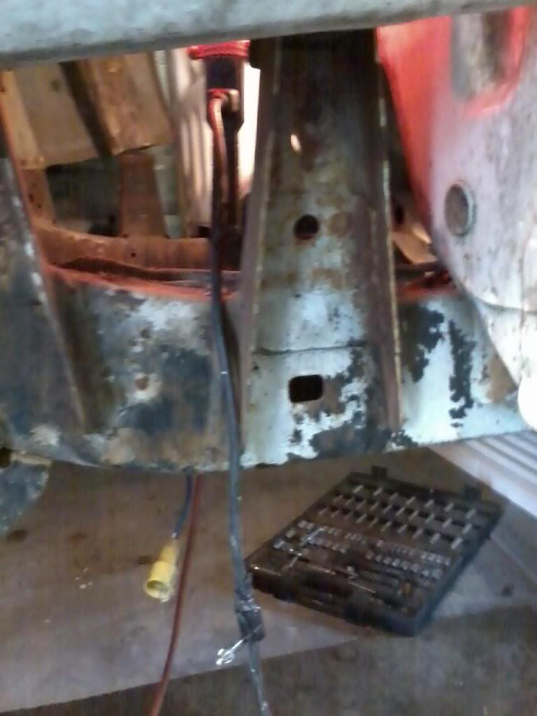

The only good thing on this truck is the frame and body. I have gotten alot of other things fixed on it but still a ways to go. This truck was repainted at one time and has several runs in it and was poorly painted. They also got over spray every where. Could of taken some time to covered it up, but they didnt.
The frame is full of dirt nearly half way up to the inside of the frame. I will eventually pull it out of the shop and use and air hose and water hose to get the dirt out. Luckily the dirt inside is dry powder so isnt causing any harm at this time. It is loaded though. The frame just has surface rust on it and is in great condition. I did do alot of wire brushing on it on the back half. Should clean up nicely when I get the body off and get more access to it.
Bad overspray and dirt is halfway up to the hole in the frame which isnt showing. The quickest way to identify a 4Runner frame from a truck frame is the two post on the front of the bed. Only 1 and a half post is showing on this picture. The 4Runners frame dont have these post. Also there is 4 bolts per side to hold a truck bed if my Missouri math serves me correctly and my eyes seen them all.

Hello cyberhorn... The fuel light is on the right hand side, second from the bottom, just above the Brake Light. I learned a little bit more about the Low Fuel Light but still dont know if just the Guage and Float Unit have everything you need.
Thanks kornhuskerwizard...The whole reason I got my 86 Runner was for the fuel tank and tailgate. Those alone would of been a fortune if I had to by them in parts. If you had to buy the tank assemblies in piecs, it could of cost you alot. You got a deal on the tank. I will post later where you can get a cheap fuel pump if you need one. I have replaced 5 on five different trucks and never had a problem with any of them. Both of my runner have the $25 pump on them. Toyota wants $300 and the parts stores want $150.
When you get a chance, can you post a picture of your 4Runner tank? I want to add a picture of a runner and truck tank to show the difference in my Fuel System Inof page later on to my 88 Runner build thread.

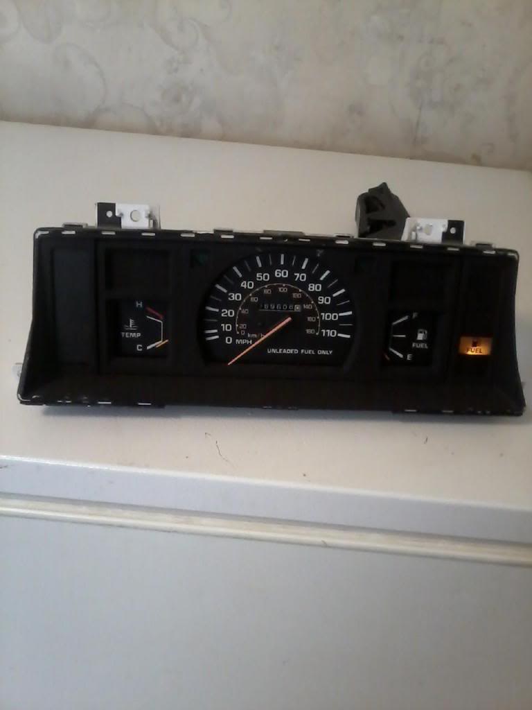

A SR5 Guage has the Low Level Light at about the same spot as the Non SR5 guage. It is just above the Brake Light. I checked both styles of guages to verify. So now I am wondering if you just need the 3 wire guage to get this option?
My 86 orgianal guage light and fuel level worked but after awhile it stopped working. I put in a SR5 Guage to see if that would fix it. It didnt. So then I hooked up the 3 wire fuel level assembley to see if the guage would work without pulling the tank. I just did the electric connection and it started working. So I know the float unit in the tank is bad. I will eventually hae to drop the tank to swap units. Just got to get off of my rear end and get it done. I almost ran out of gas one time not realizing just how much I had driven it.
SR5 Guage Light

Non SR5 Guage Light. I used the face plate off of this guage to fix a broken SR5 Guage lense assembly. With some careful measuring I was able to drill a hole for the tripometer. I reusue alot of old parts.

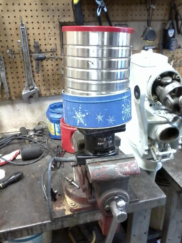

I guy I work with is rebuilding a carburator for his boat. He didnt want to lose the factory paint off of it so he did a search on Youtube and found that using a electric sander, a cookie tin, and a coffee can and filling the coffe can with concentrated Simple Green, he came up with his own sonic cleaner.
He just glued the cookine tin to the sander with a two part epoxy, and clamped it into a vise, added some padding inbetween the cookie tin and the coffee can and filled the coffee can with some Simple Green, then put the coffee can lid on and let it run for about 45 minutes. The parts cleaned up nicely and he still has his factory paint.
I think it is Berrymans Carb, ( If I recall right, you probably know the brand I am talking about) cleaner in the gallon can which is real corrosive. Only thing he had to buy was the Simple Green, everything else was what was laying around the shop. He said he was out $9 for the gallon of Simple Green. I liked the idea.

interesting use for a sander
i could also see putting sand in the can to clean bolts polish them right up
wonder how well the mean green degreaser would do...

That homemade sonic cleaner is awesome!!
I also beleive that if you have the low fuel light gauge from the factory then you have the 3 wire sender,but you probalbly knew this...
I will take some photos of my 4runner tank and senders and throw in my 2cents later after work.
