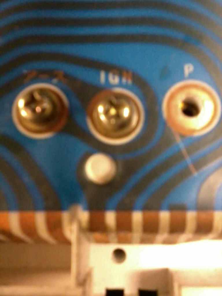

Starting on my tachometer and what is needed to get the tachometer working.
I then ran a wire to the negative side of the coil, on a carburator coil it is a little different then a standard coil you are most used to seeing. This truck didnt come with the SR5 guage so I added it. If your truck is not Plug and Play like some are, you need to run a wire from the negative side of the coil to the little "p" to make the tach work.
Then what I did so as not to short out the electrical run beside it. I placed a piece of electrical tape over the little "p" and crimped a wire to the smallest connector that I could find.
I used tape for insulation and to make my connection to the "p".
Run your wire to this point.

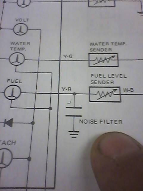

I checked my resistance values with the above picture and they are off by quite a bit. I will check the numbers on one of my other SR5 gauges and see what they read. The gas gauge worked on this before so I am not 100% convinced that is the problem. I have found errors in the FSM before.
My readings.
IG-FU...65
FU-E....86
IG-E....78
I am sure the Engine fuse is good as the rest of the gauges are working and several other things would not be but I will double check. Not sure what this Noise Filter is and will also do a test light on the connector and see if I am getting power to the Sending Unit.
My readings.
IG-FU...65
FU-E....86
IG-E....78

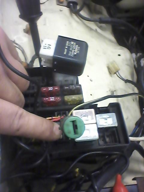

The hot wire to the heater on the carb is not working. Troubleshooting showed I am not getting power to the green plug that connects to the carburetor. The black with the yellow stripe wire connects to the fuse box. Looking underneath the fuse box, it connects over to the relay. It is not showing but I have power to the relay but the relay is not transferring power to the other leg that sends it to the power cable to the carb.
I was able to jumper the pins where the relay connects and it powered up my test light. Looks like Toyota has different styles of relay from EFI to Carb and I don't have a spare relay for the carbs. Got tons for the EFI. I should be able to pick one up this week and have my electric choke working for the carb.
Will do some more investigating on why my fuel gauge is not working. I have some notes posted above from where I left off and is so nice being able to just refer back to where I was at without having to refer back to the manual and where I was at.

I am not getting power to the heater on the intake. I did some trouble shooting and the green plug goes to the intake. Where my finger is the wire comes to the fuse box. I looked under anther fuse box and the black wire with the yellow stripe goes to the relay. I was getting power to the relay and was able to jump to the pin the black/yellow wire and it powered up the green connector. EFI and Carbs apparently use different relays. I have plenty of EFI relays but no carb relays. I will pick one up this week.

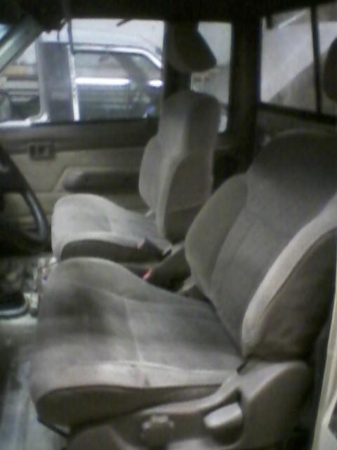

I got some seats out of a 3rd gen runner and the front two bolts will bolt to the front like the 85 seats did. I had to use a spacer on the inboard side and bend the bracket more a little down. The front bolt hole on the outboard side, I had to cut the bolt holes off and there is a square that I was able to drill out.
The rear bolt holes, I was able to just drill thru the floorboard on the outboard side and on the inboard side, I had to cut a notch and add a spacer to level the seat. One thing I do like is the 3rd gen runner seats have the seat belt mounted to the seat so I wont have to mess with that.
These seats are really comfortable, have plenty of adjustment forward and backward, have butt and back support adjustments on them. I think they are going to be some great replacements. In the picture the shadow makes the drivers side look dirty but is just a shadow. The seats came out of a runner with similar interior color as mine but the seats look a lighter brown. I think darkening the plastic trim will make it look more factory. It does look light colored in the picture but is not so light when actually looking at them.
I still want to put on some bed liner on the floor for temperature an noise control and then will install some carpet. Not sure if I want light brown or dark brown carpet but will look on the internet at other trucks and see what they have and make it looks like it all came that way.

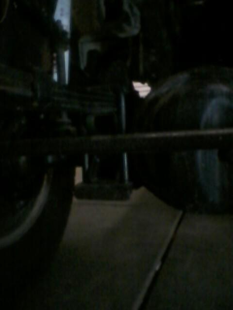

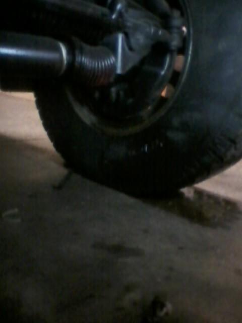

Mostly posting this picture for Mark. Mine is set up a little different. I did get my shocks installed. The front end is stiff. A couple of my friends say to give the springs time to soften up. I will see what that does but if it does not soften up, I plan on going with factory springs and shocks. Another reason I really don't like my Old Man Emu springs and Rancho shocks is that it raises the truck height. I am sliding over the bolster in the seat getting in and don't want to wear a hole in the seat and beside I don't like jumping into a truck.
The above is a bad picture so I will try and get a better picture later. I have been trying to do this build right. I rebuilt the axle, new brakes all the way around, and new caliper. I got the calipers at the part store and now I have a leak. I did not order them off of the internet as I wanted to make sure I got the correct ones. Hope it is an easy fix.
