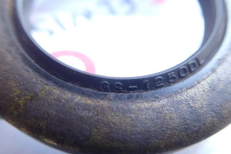

96 4Runner 296,349 miles
Took up the slack in the throttle cable.
Pulled the 4xInnovations rear spare carrier to check the bearings. Most everything was in good shape except the lower seal. The spring has rusted out so I removed the mess and cleaned it up. Going to go ahead and use it, am thinking about drilling one or two tiny holes in the next lower seal so water doesn't sit and rust stuff. Cleaned up the old grease and squished in some new. Cleaned up the bolt and added anti-seize.
TRP seal and bearing numbers in case I need them:
