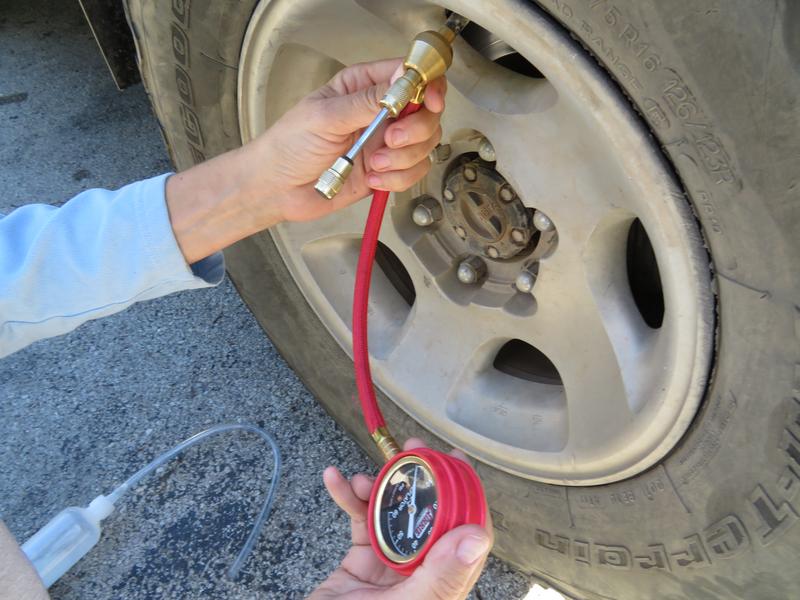

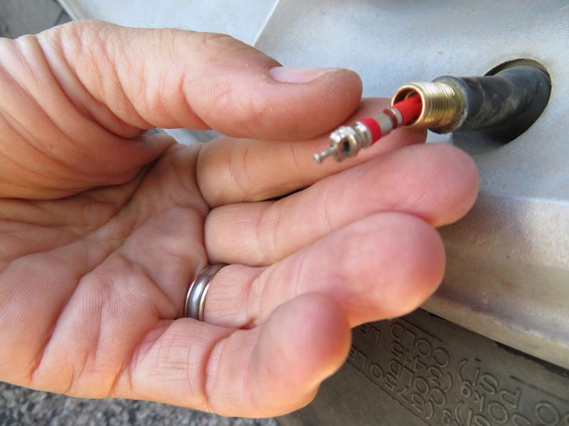

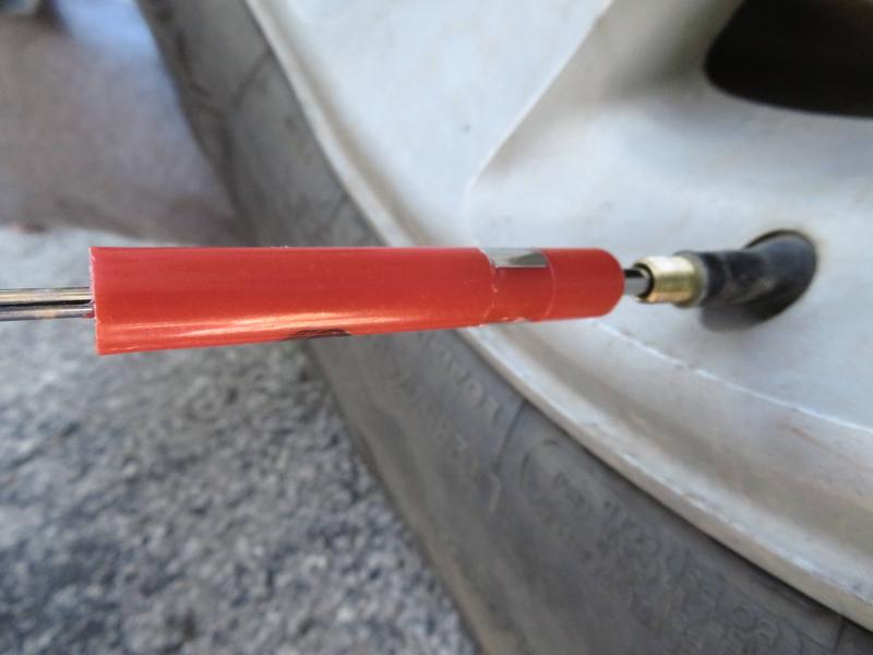

Also added balance beads to the rest of the tires to bring them all up to 6oz each.
When I decided to try balance beads after losing wheel weights a number of time I had a heck of a time finding information about how to do it. Everything I did find said more than a couple of ounces break the bead and throw the packet into the tire. Since I don't have the equipment to do that I had Auto Tire do it for me. They only put 4oz in, which didn't seem to be quite enough. When they balanced it was great, but they spent more time not smooth than smooth. Dropzone mentioned his BFGs required 6-8 oz so I got to thinking more might work better. Starting with 6oz.
How to get them in? Didn't really want to go back to AT....
was browsing Amazon and saw a Counteract balance bead kit. It comes with beads, valve cores, valve caps, installation bottle, hose and core tool.
Okay, let's do this thing!
I lifted the tire I was working on with a jack, rotated the tire's valve to the top, thumped on the tire to shake beads to the bottom, removed the valve core.
Next I rotated the valve to the bottom.

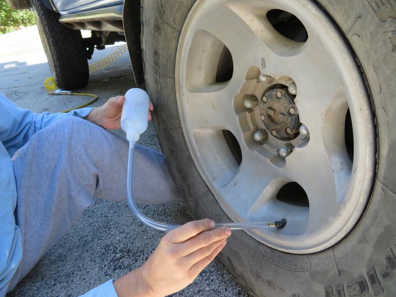

I used the scale to measure 2 oz of beads into the installation bottle,
put the hose on the bottle, and the other end on the valve stem.

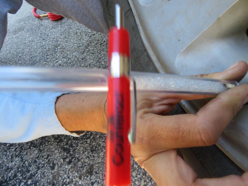

Two methods seem to work best to get the beads out of the tube and into the tire,
1) lightly and quickly squeeze the bottle numerous times to 'floof' the beads in
2) use the valve core (or any small) tool to tap the side of the hose to jostle the beads into the tire.
This does require some patience, it doesn't happen in a hurry.

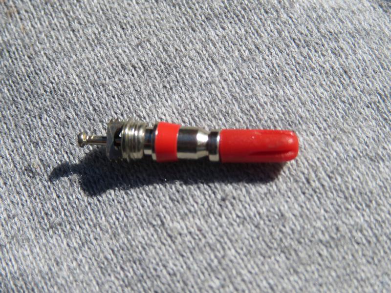

Once you're done install the special valve core and air up the tire.

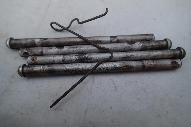

Replaced the broken 'M' brake pad anti-rattle clip. Since the other clip and pins came with of course everything got replaced. The pins had wear spots on them anyway. These don't look like what you'd find on a 4Runner because of the 231 Tundra brakes.
Ordered for year/make/model 2005 Toyota Tundra v8

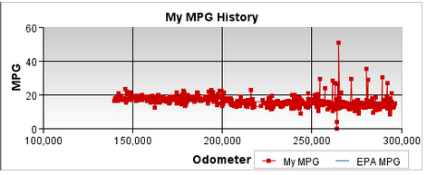

Lift just after 200,000....basket.....armor.....
actually not too bad
mine has been hanging about 15 post lift/tires
it will probably go down after adding the sliders and basket
The basket and BFGs are some of the biggest mpg suckers on the 96.
Old Oct 15, 2017 | 06:20 PM
  #3369
habanero's Avatar
Joined: Sep 2005
Posts: 8,247
Likes: 497
From: mo
Well, that and all that tall stuff. And the heavy stuff too.
